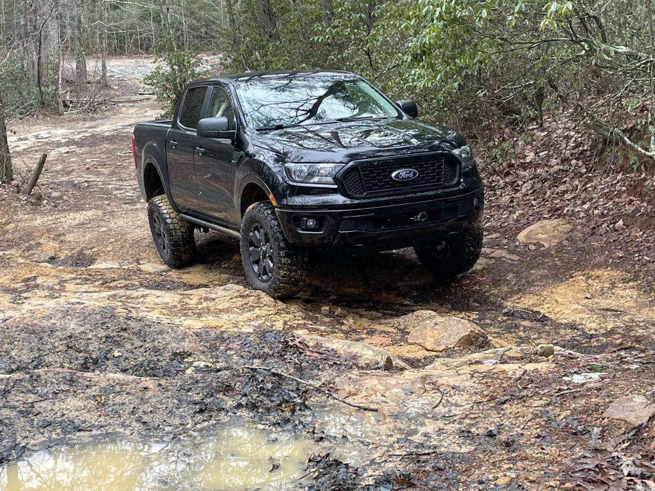

I have the 589 Fab mount and have been using a Rough Country 9.5K synthetic unit for a while now. Have pulled a f150 and empty boat trailer out of the lake, a toyota corolla out of a ditch, another old f150 out of a muddy field, two volvo 740's out of the woods for a buddy, about 20 tree stumps and my truck after high centering on a stump in a creek bed and never once had a problem. Plus I love that you can barely see it.

Sick truck man! Do you have any problems accessing the winch with this hidden mount? The badlands winch I'm looking at has a release lever for drawing out the line. I'm wondering I'd lose that capability with the winch hidden in the bumper.

Hey thanks man!
Space is a little tight in there but can still access everything fine. The rough country has a neutral position to pull line out.

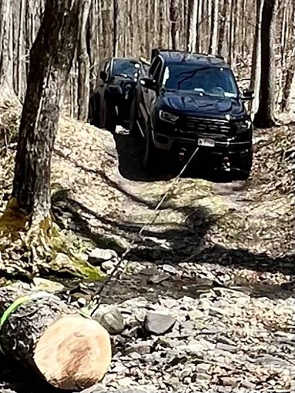

I’ve used my rough country winch about 30 times now and have never had an issue with it. I’m not partial to the brand really. Just stating I’ve used the crap out of it and it’s always done great. Run the entire spool in multiple times in a row on several occasions and it barely got warm. Only prob I see is it is sometimes a bit weaker if pulling gets closer to the limit. Or I could be pulling too much. Not sure really.
But for the money I would say it’s a solid winch. And what was used by 589 Fab at the time which is who made my mount so knew it would fit since it was a relatively new product.
