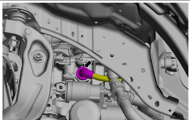

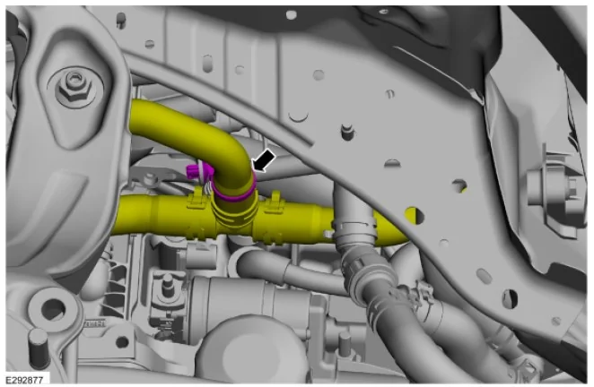

Do you know if they recommend going up by the starter, through the wheel well liner?
airline tech
Aug 24, 2022
4,499
8,592
Midwest - KS
Aircraft Tech
Yes - Same as the Oil Filter (Access)
Just move the coolant hoses out of the way and then you have access to the block heater.
And IF you just want to - Remove it - here is the PN for the Plug to plug the hole:
This is what the current Recall calls out - remove and install this plug - until parts are available.
Plus remove and stow the (Wiring) in the truck (Cab) for use after the new block heater is installed.

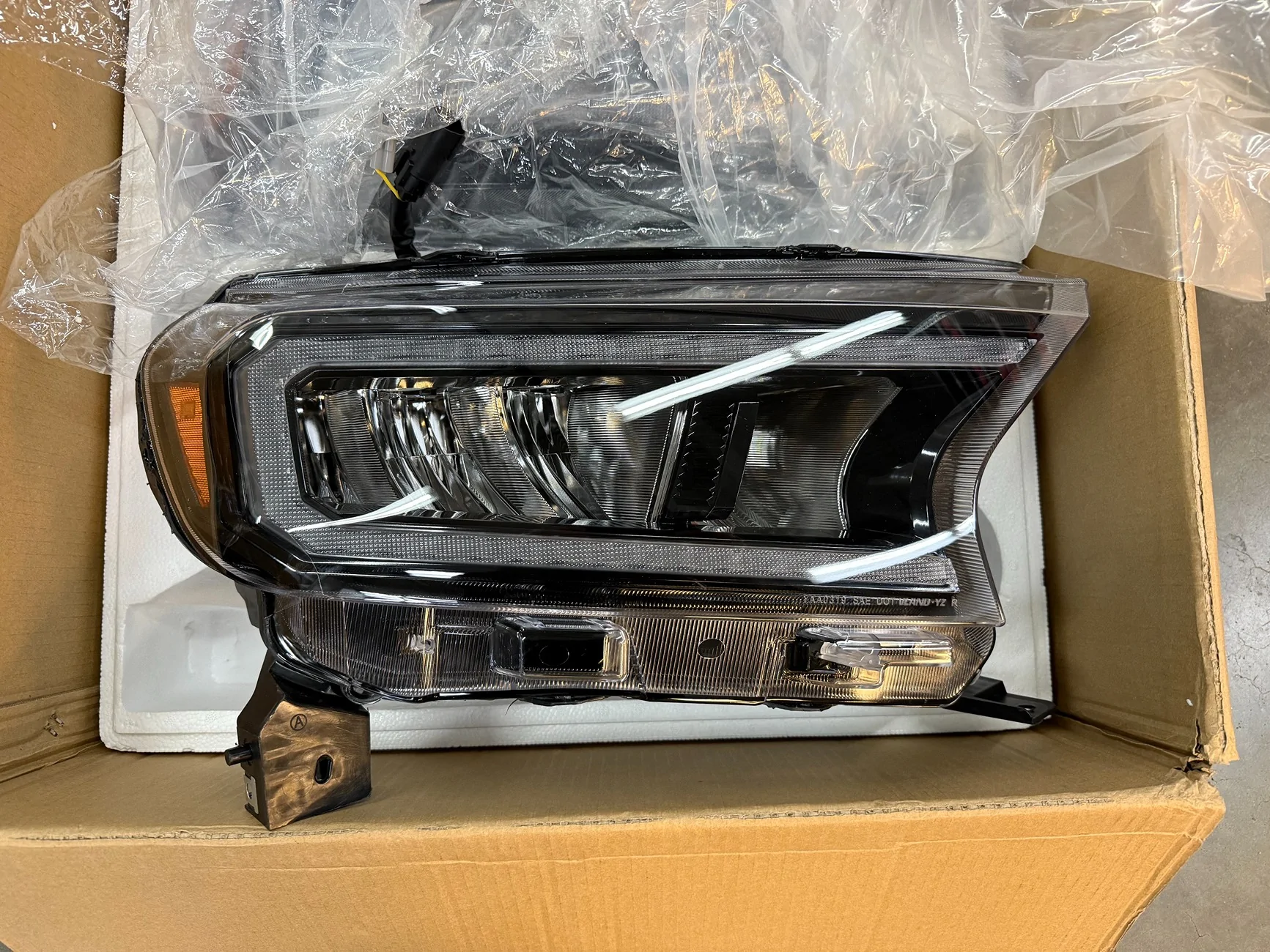

GTR Carbide headlights. My aftermarket low beam LED bulbs were cutting out when used with high beam on my last roadtrip. Replacement bulb I think typically go for about $80+ on mine, and open box Carbide was $320-ish for the set. After reading little bit about this set on this site(possible faulty adjusters), it might be a bit of gamble.,,
