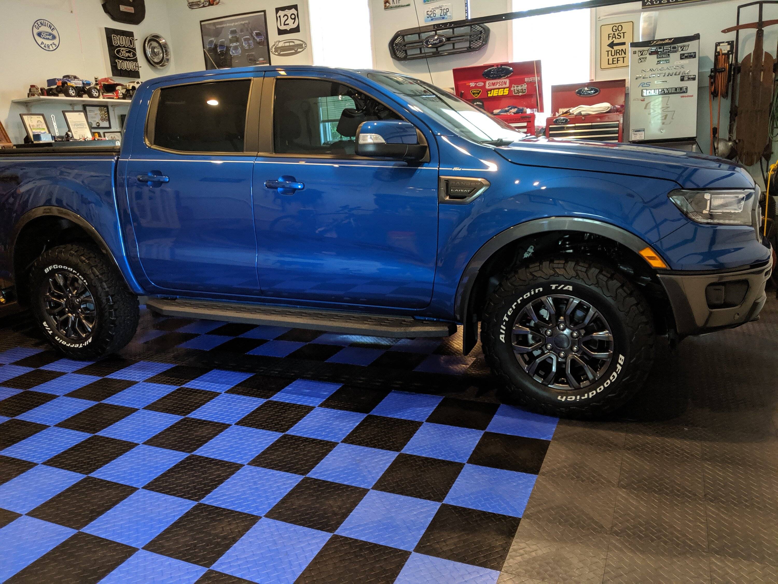

Hey David, The reels look good. That is definitely the way to go. I did something similar.
Also here is an unsolicited endorsement. I went with Race Deck. They are about 5 years old and they still look great. My floor had several fairly big cracks, the tiles hid them very well. Good luck with your choice. I remember looking at SwissTrax and they looked good too. I think a sale was why I chose RaceDeck. You might call them and ask about any sales. They were good to work with.

I think RaceDeck is US, so I'd like that but I thought they were not as flexible as SwissTrax.
But it sounds like it does well for you with cracks. Our floor has a raised crack and that's my biggest concern.
Any more insight would be greatly appreciated.

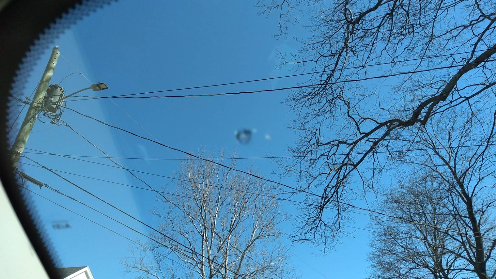

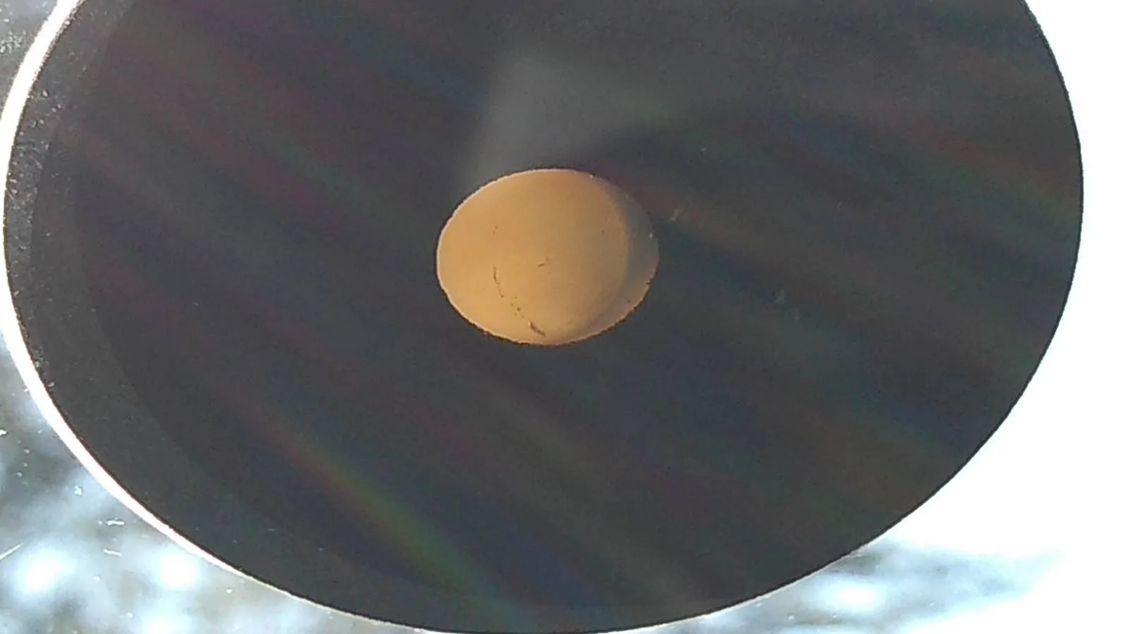

Then on the way back I watched a rock make a 1/2" chip in Soupie's windshield! Bah, that sucked.
But as sucky as that was. my yet-to-be-affixed 2023 dump sticker blew out the window from the center dash tray thing. I even pulled over to look for it, but it was sooo windy and cold.
But no worries, swung by Public Works and got a new one (I'm kind of surprised they don't have a parking spot reserved for Soupie).
Dropped the Cheech off at home, goggled chip windshield kits, watched a ChrisFix video and went to O'Reilly's to get one for $15.
Despite it being 36°, the sun was out and it did a decent job.
what an awesome parking job ...
oh doh! sorry little tree ....
fresh from a mani-pedi!
bah!

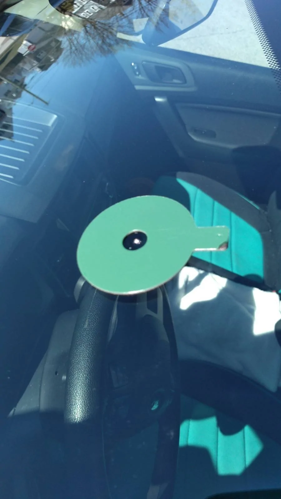

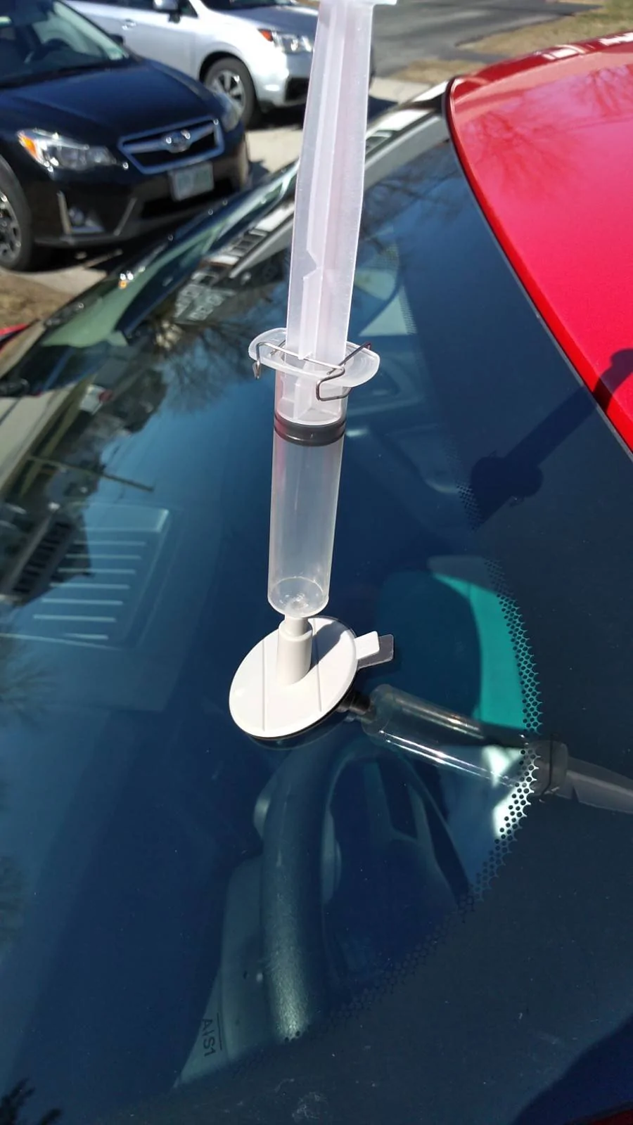

stick a double-back dealio on the windshield

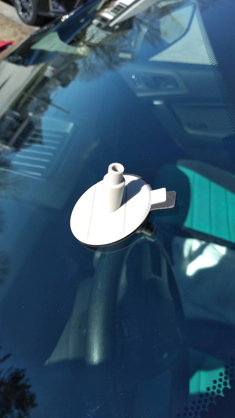

stick the "pedestal" onto the tape
squirt some resin in and then channel your inner junkie - this pulls a vacuum on the resin

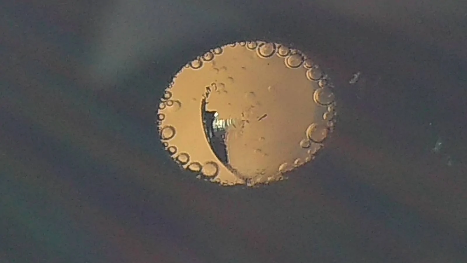

this is what it looks like from inside
remove the syringe to let air in, put it back in and push down to apply pressure (a clip holds the syringe in the proper position) - this is what it looks like after 10 minutes

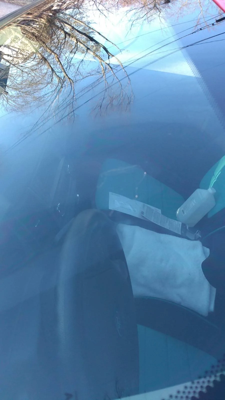

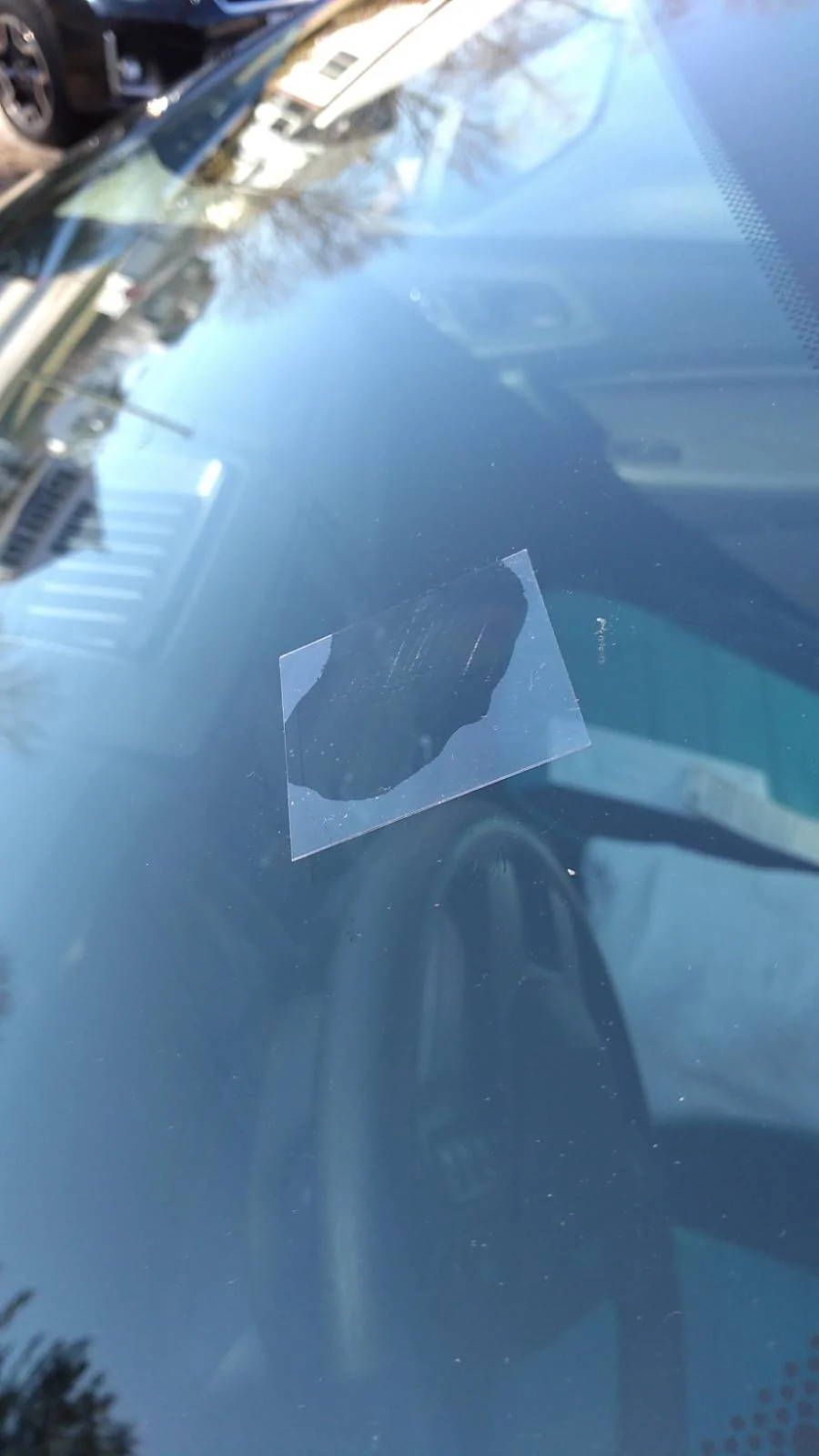

remove the syringe, pedestal, and double-back tape - add some resin and cover with a plastic UV activation something-or-other
voila! no chip but there is a little outline of the resin, I was able to remove some with rubbing alcohol and a razor blade (again, channeling my inner junkie). I think it's so cold that it probably didn't fully cure, but it will. I was extra worried about the chip because I have State Inspection next week and was either going to cover up the chip with bird poop or fix it. I think it'll pass (unless it starts to crack - only time will tell)

Thanks.
My floor was pretty bad with cracks and many years of stains and paint spills etc. I chipped the edge off of the worst crack with a hammer and chisel, then filled the cracks with grout. The tiles were fairly easy to install. They suggest that you stomp on them to lock them together. It didn't take long for my old knees, ankles and hips to tell me that wasn't a good plan. A rubber mallet worked just fine and saved me some pain.
One minor draw back. If I leave the overhead door open in the summer and the sun heats up the tiles, they expand some and buckle up in the middle. You are supposed to leave some space around the perimeter edges to prevent this. I did that, but I have some heavy tool boxes and things that kind of hold them from moving. Not really a problem for me because I have a ductless HVAC unit in there and normally keep it climate controlled.
During the winter I usually have two cars (garage queens) :LOL: hiding out on them and there are no bad effects. A few years ago I rebuilt the suspension on an ATV in there and all the grease and mess cleaned up easily and left no stains. All in all I am very happy with them.
My garage is attached and was insulated and drywalled when built. I think if I was insulating now, I would look at spray on foam, and then some sort of paneling. Your idea of a water proof lower section sounds like a good idea.
