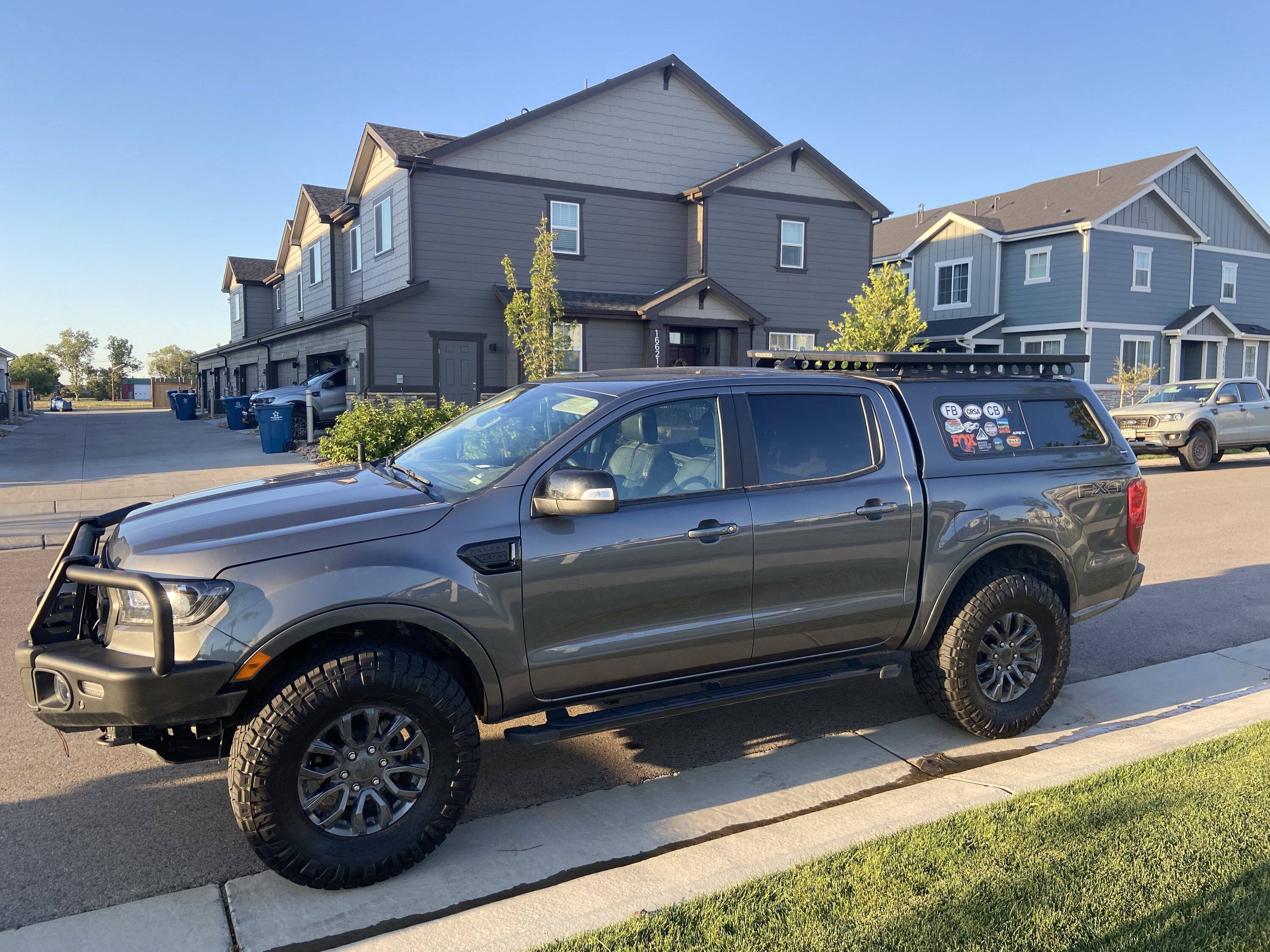

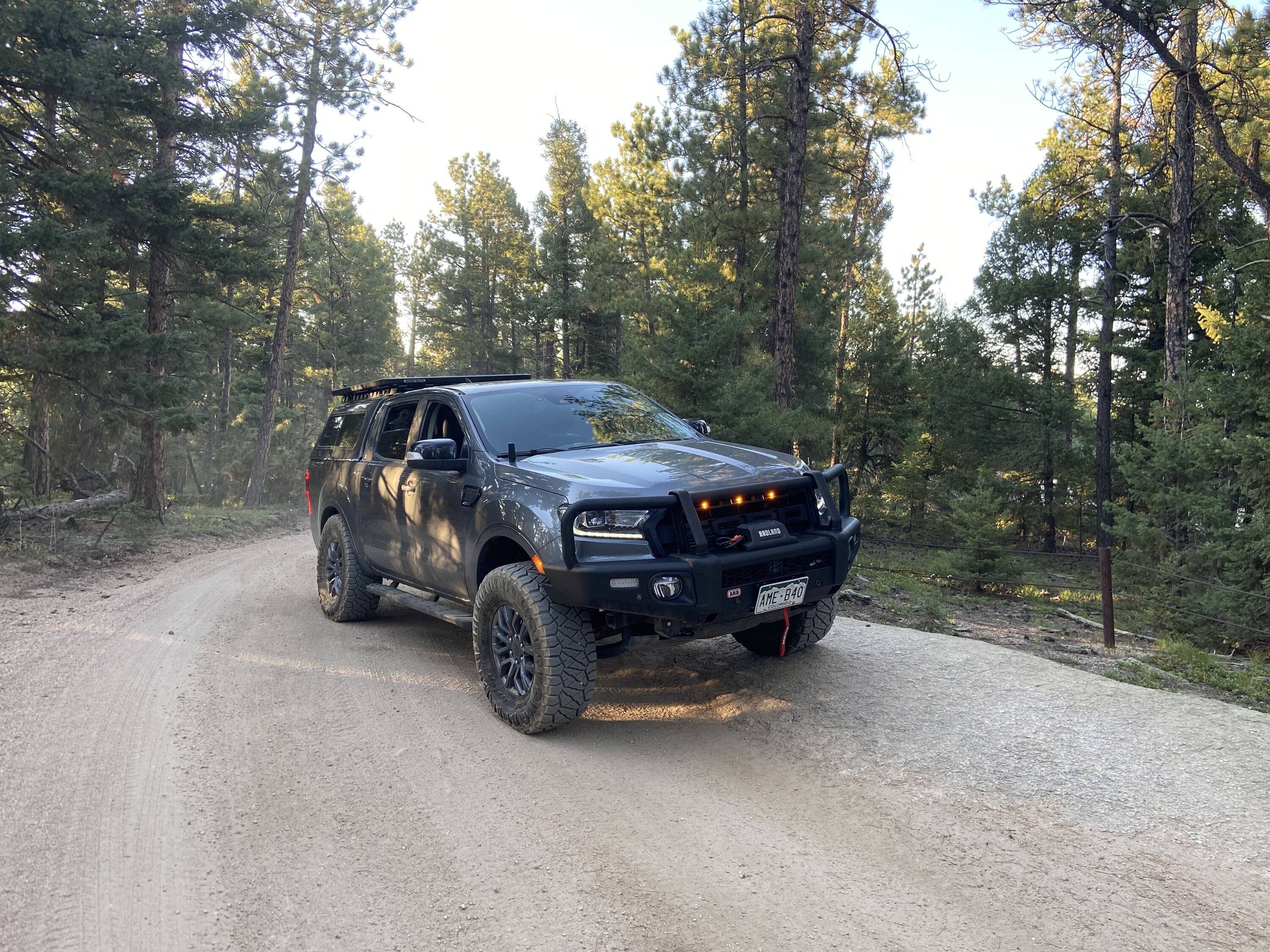

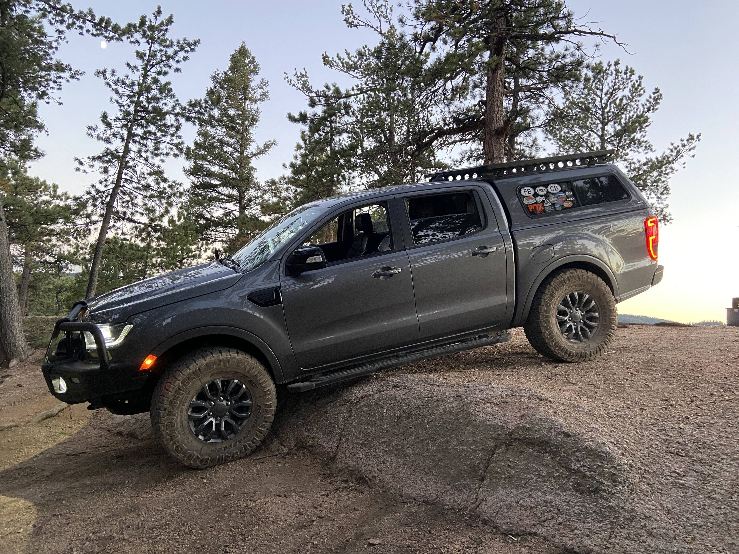

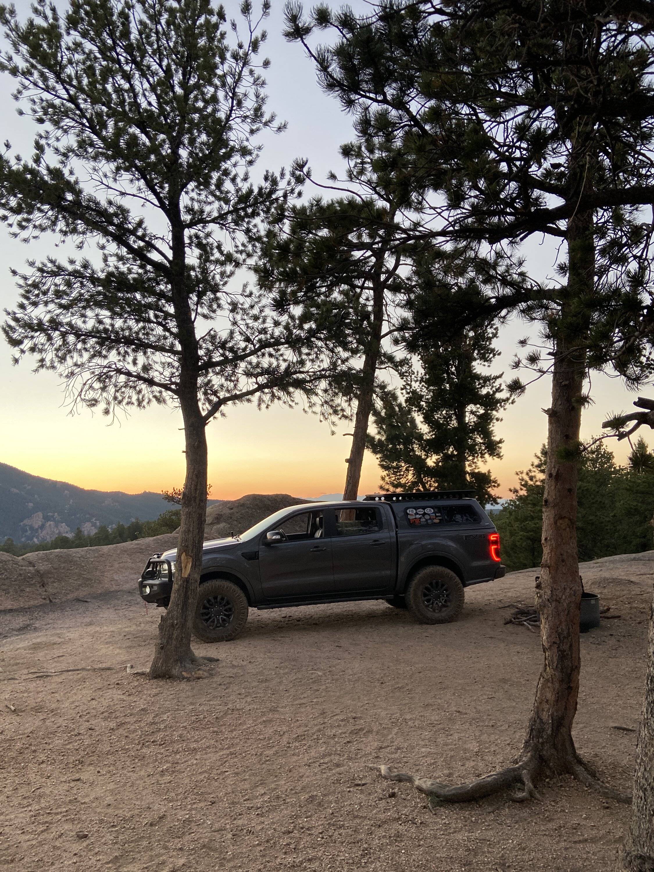

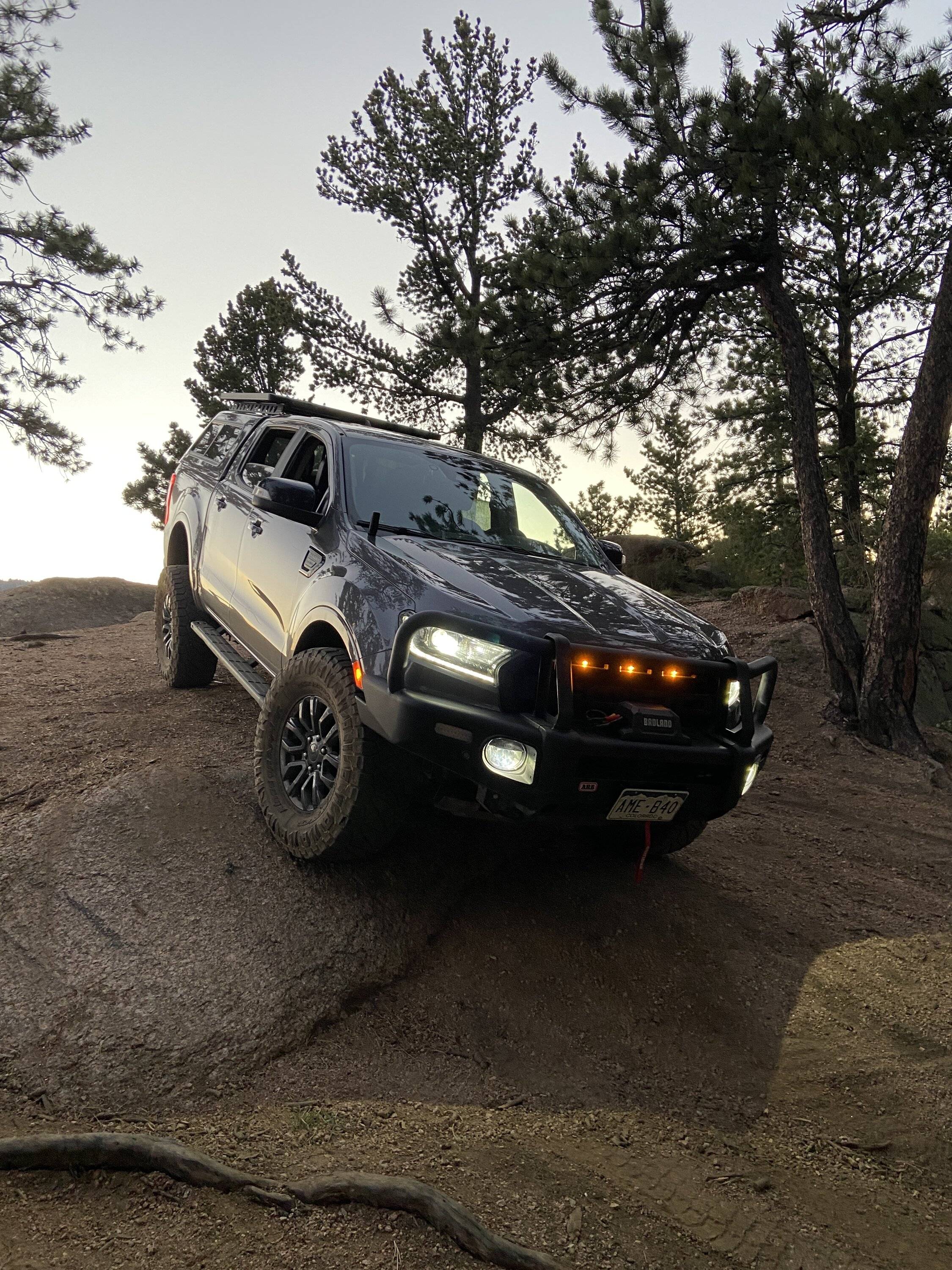

This weekend I took a leap in tire size from 265/65/18 to 35x12.5R17 Nitto Ridge Grapplers. These are mounted to stock sport wheels with a 1.5" spacer. A decent amount of trimming has been required so far, as has removing the rear crash bar. I already removed the front crash bar when installing my ARB Summit Bumper. I just took it on a shakedown run this evening and have a bit more trimming to do, but I am optimistic I'll get it to the point that there will be no rubbing when off road.

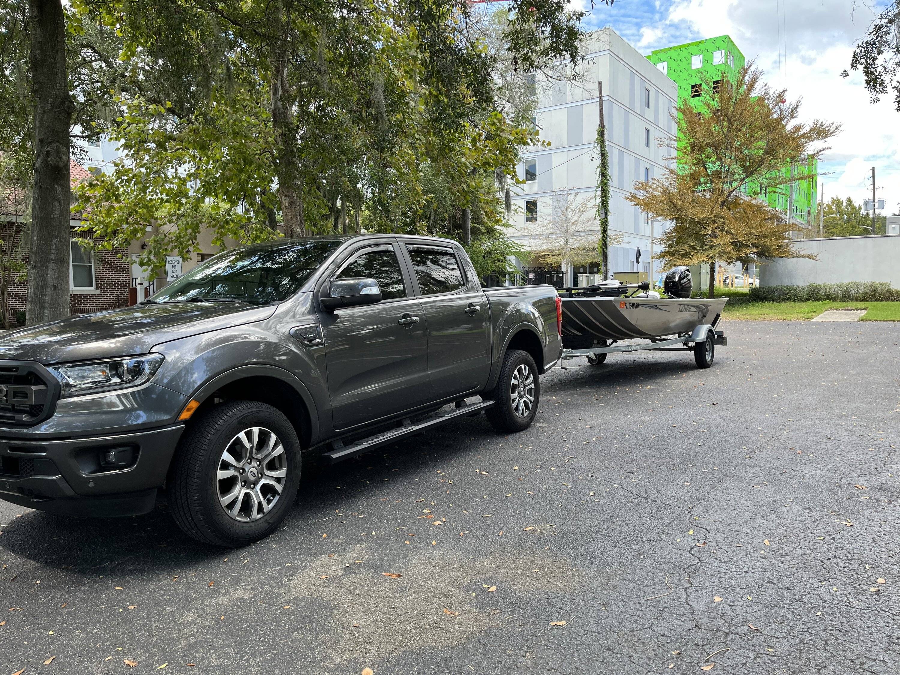

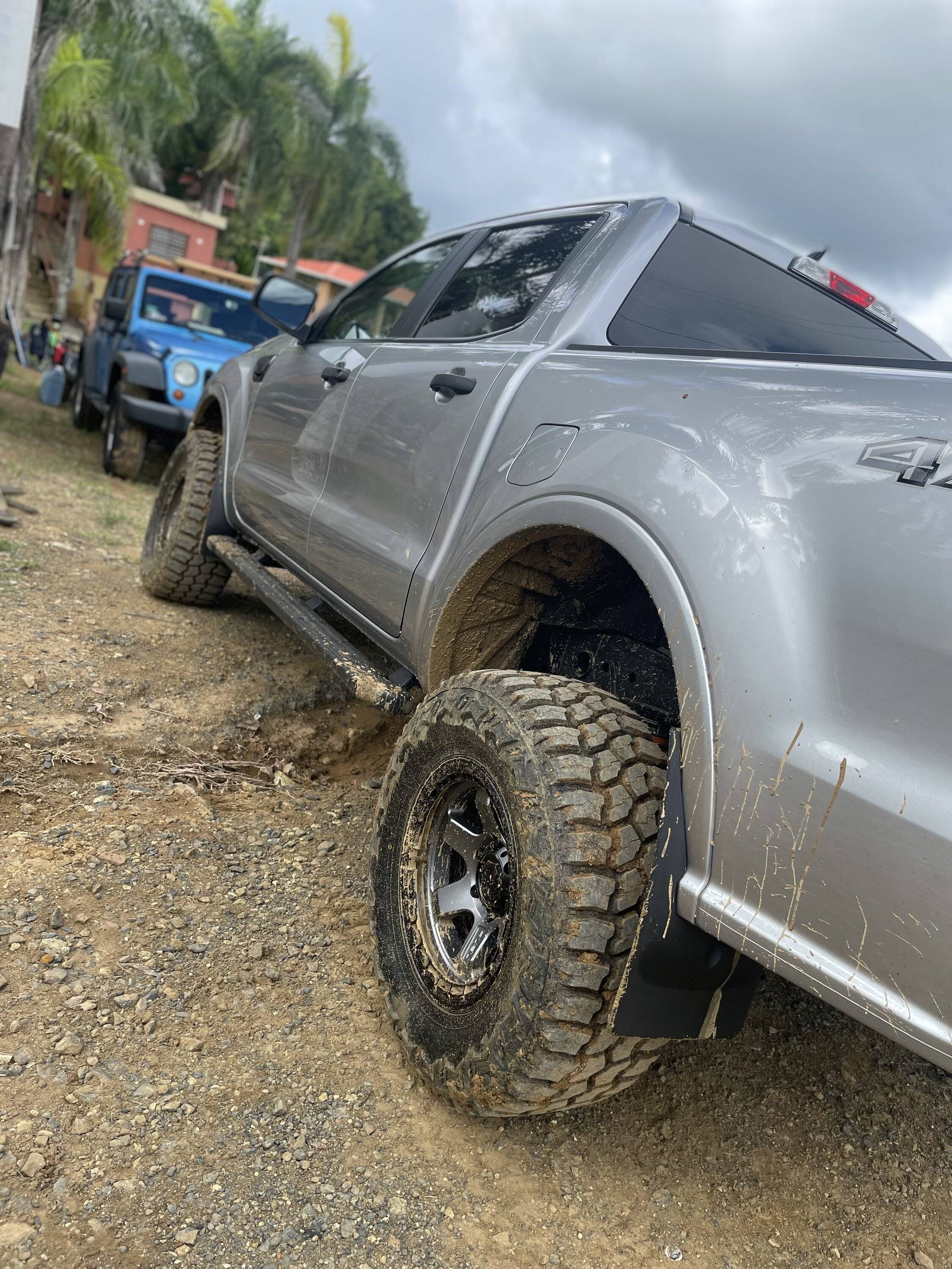

Priced new tires recently and just about fell out of my chair. The $625 set of 265/70R17 General Grabber tires I installed in 2019 are a whole lot more expensive now. Plus, although they were one of the more aggressive AT tires I could find at the time they didn't hold up to the abuse I put them through. All that considered, I opted to pick up a set of Jeep takeoffs (255/75R17 Firestone Destination M/T2) with under 1k miles on them for $400. They seem to ride decent and not as noisy as other MT tires I've ran in the past, also hard to complain at $560 installed.

The price of new tires is crazy!

Love them 35s ,I like the way they fill the wheel Well :)

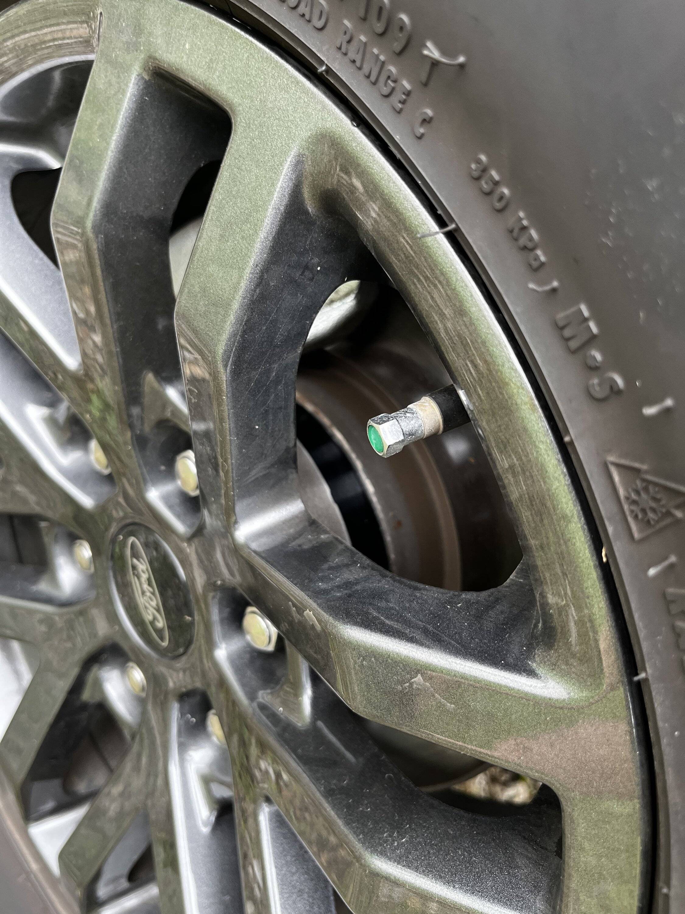

These are the lug nuts I use. They match up dimension wise with the OEM nuts. Which is important as most aftermarket nuts do not have the same surface contact area as the OEM nuts do. The tapered section is smaller in outer diameter. Fine for steel wheels not so good with factory alloy wheels.
https://smile.amazon.com/Wheel-Accessories-Parts-Factory-Style/dp/B08429TQZ5/ref=sr_1_10?keywords=ford+ranger+lug+nuts&qid=1660789328&sr=8-10&th=1
These are the lugs I purchased as well, installed them today. Really like them so far, will see how they hold up. Truck is now 100% chrome free!
Looks great, love that hot pepper red!

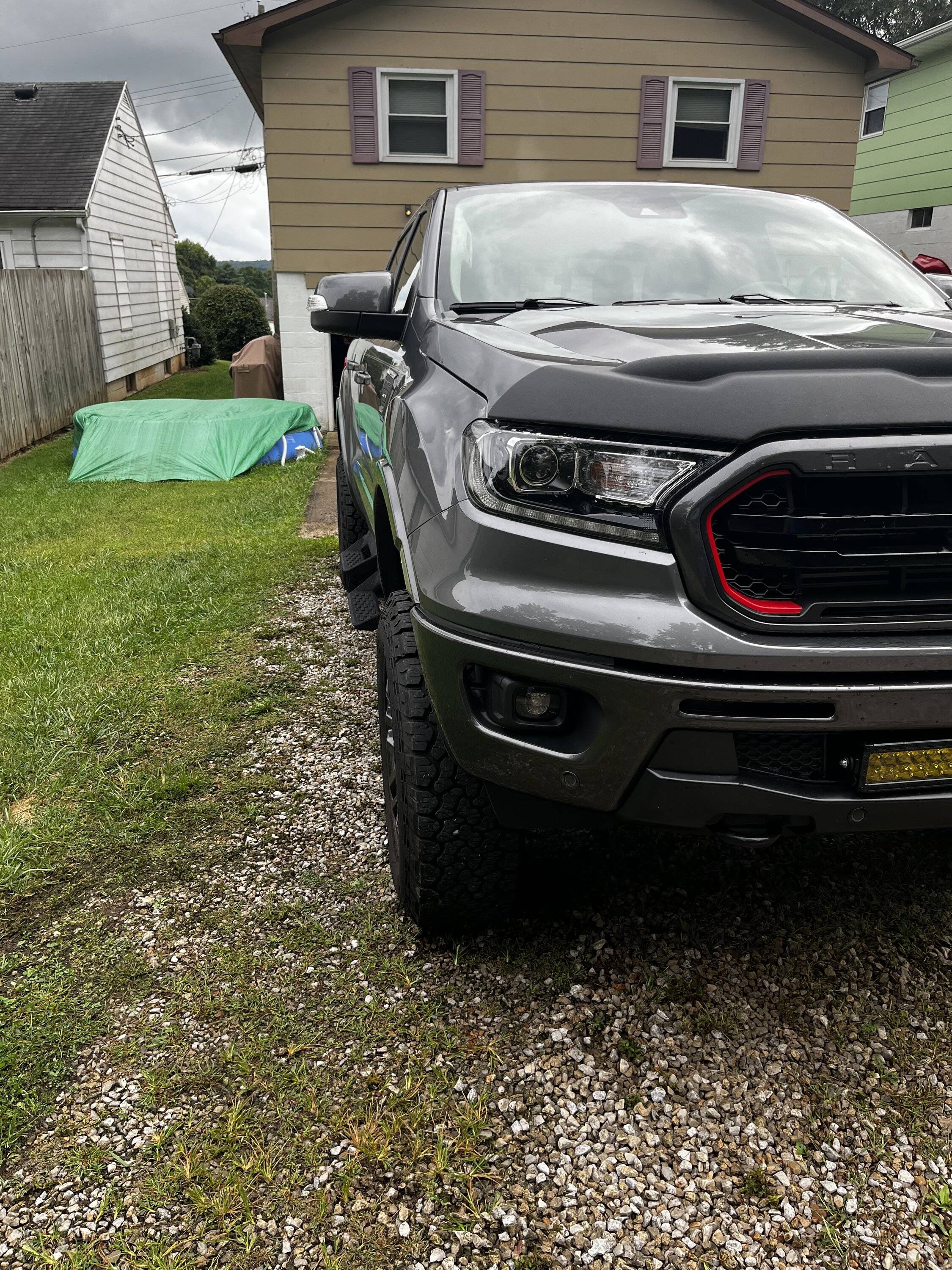

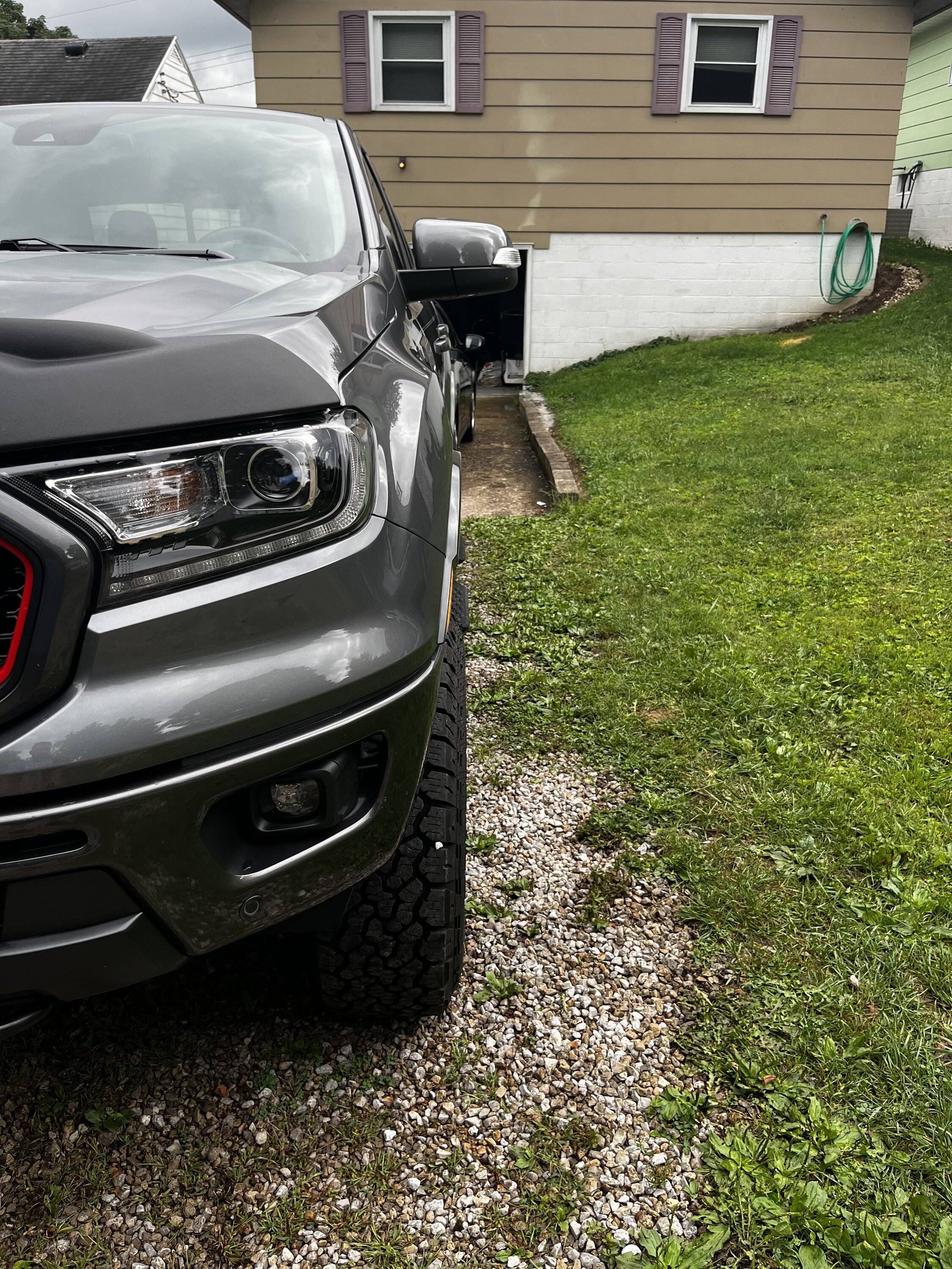

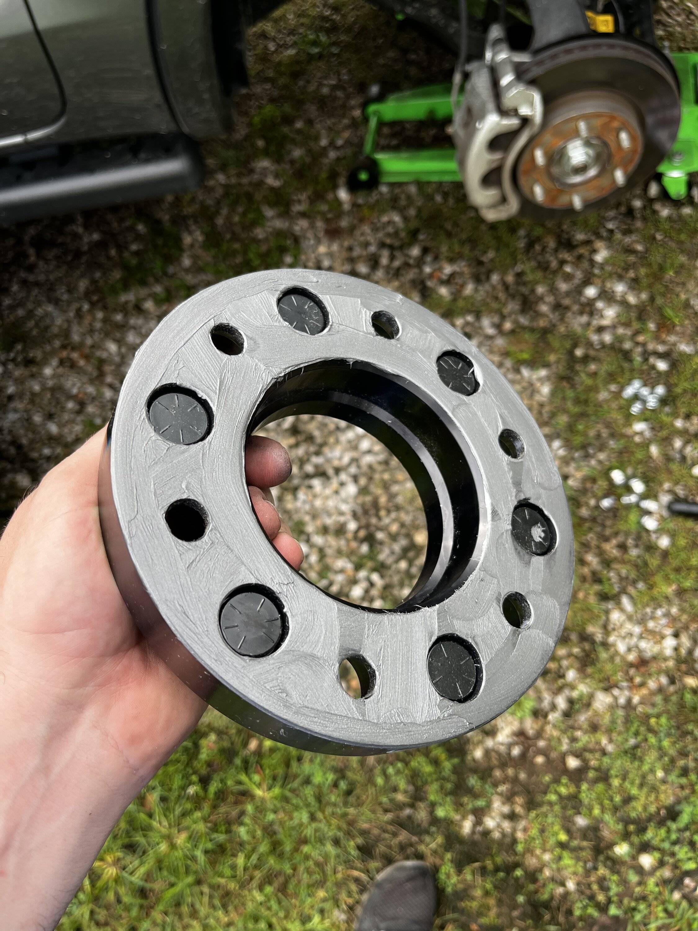

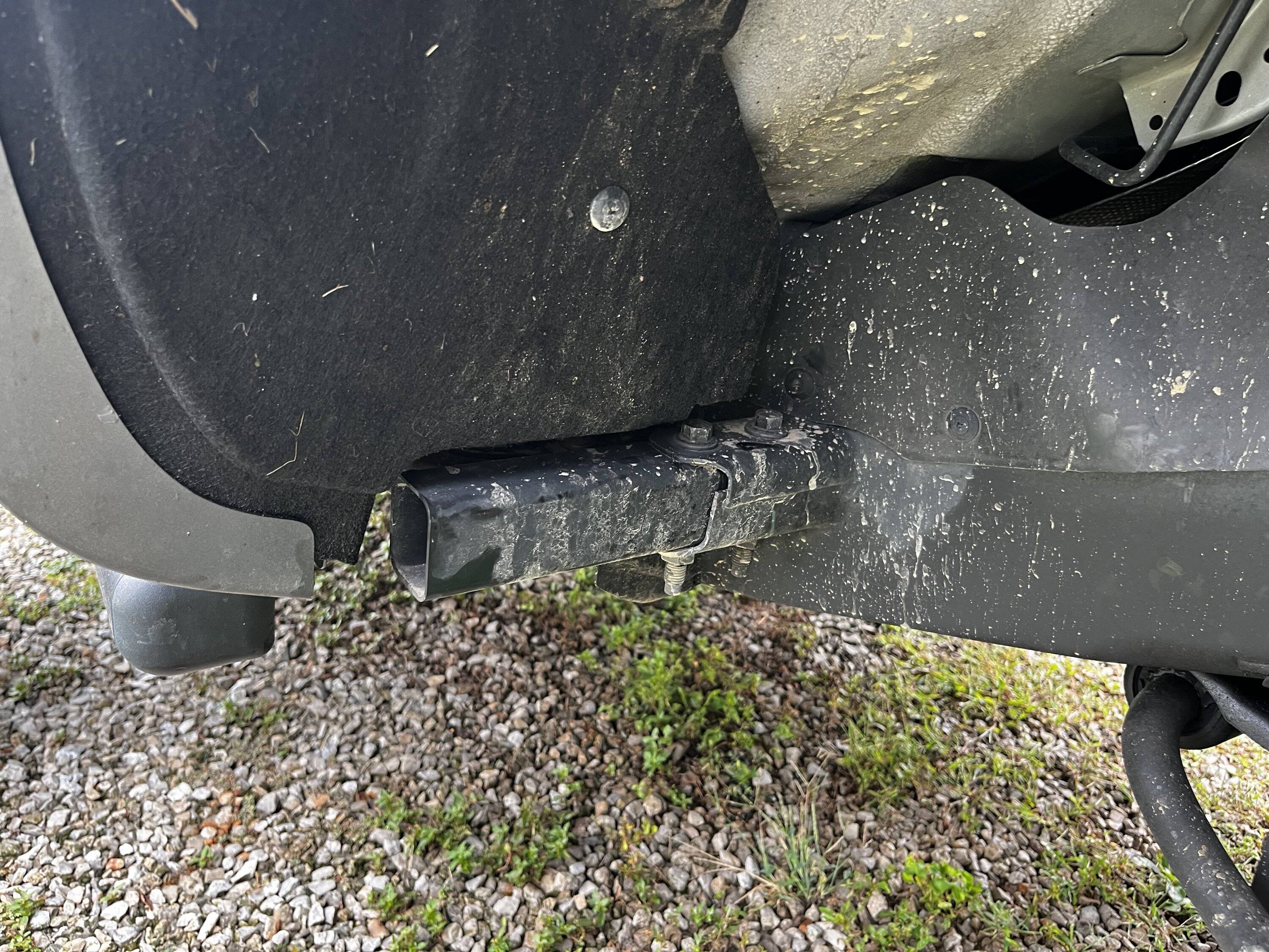

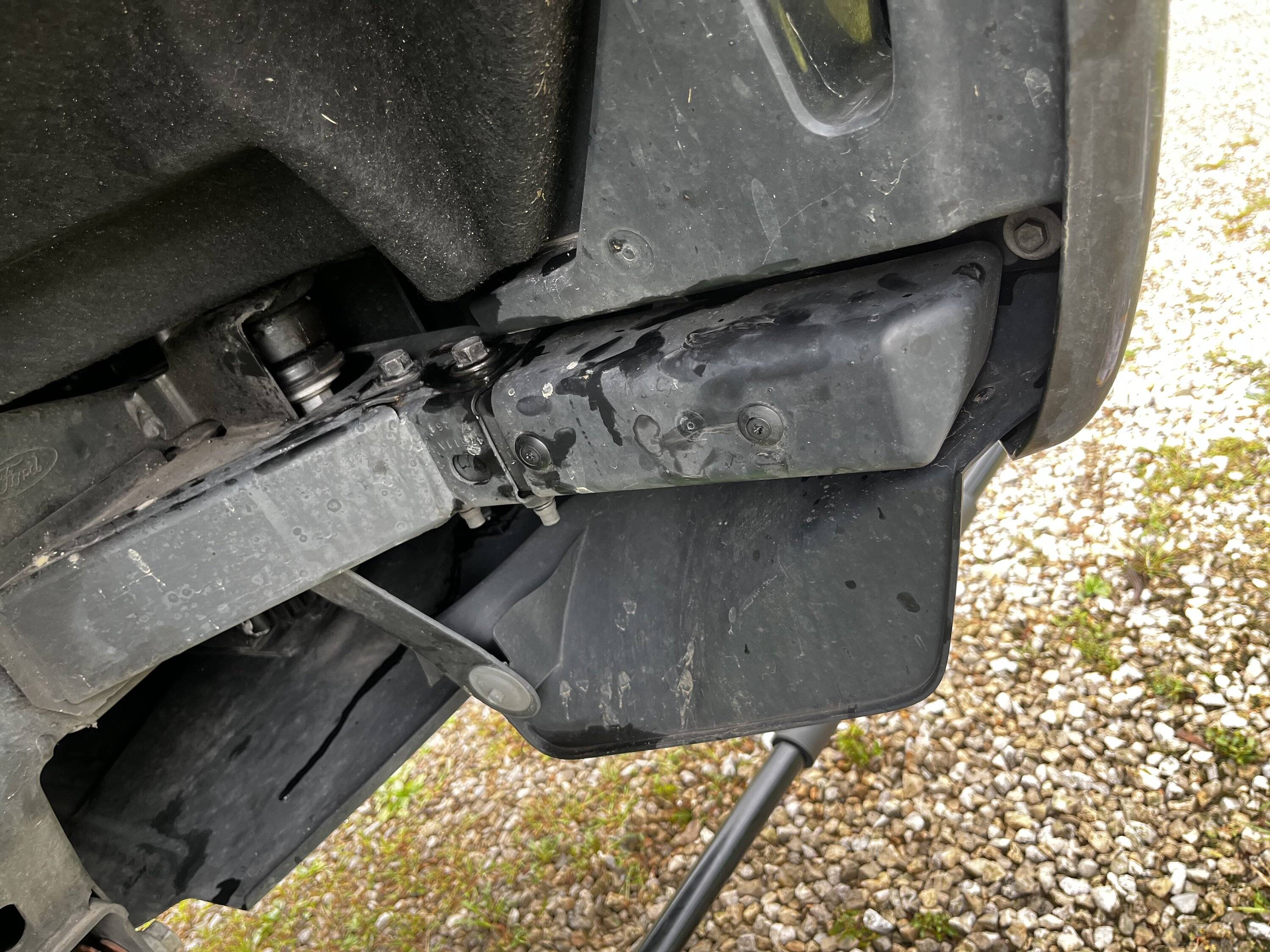

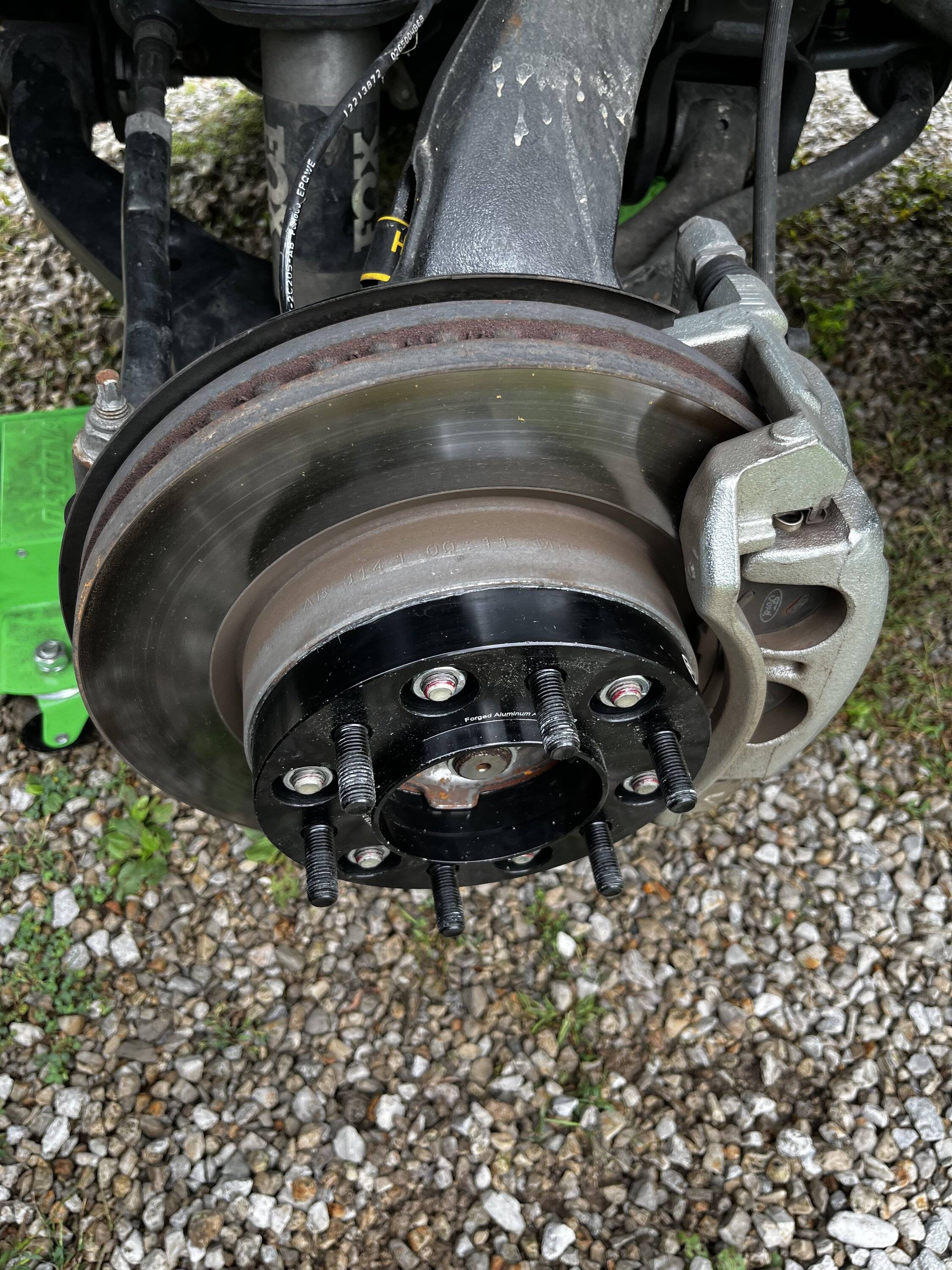

Finally installed my 1” Fabtech wheel spacers this afternoon. Used nickel anti seize on the back of the spacers and a drop of red loctite on the acorn nuts. Torqued to 100lbs per the ford tech yesterday during my oil change. Also took some tips on here and bumped the crashbars out.

they look great!
