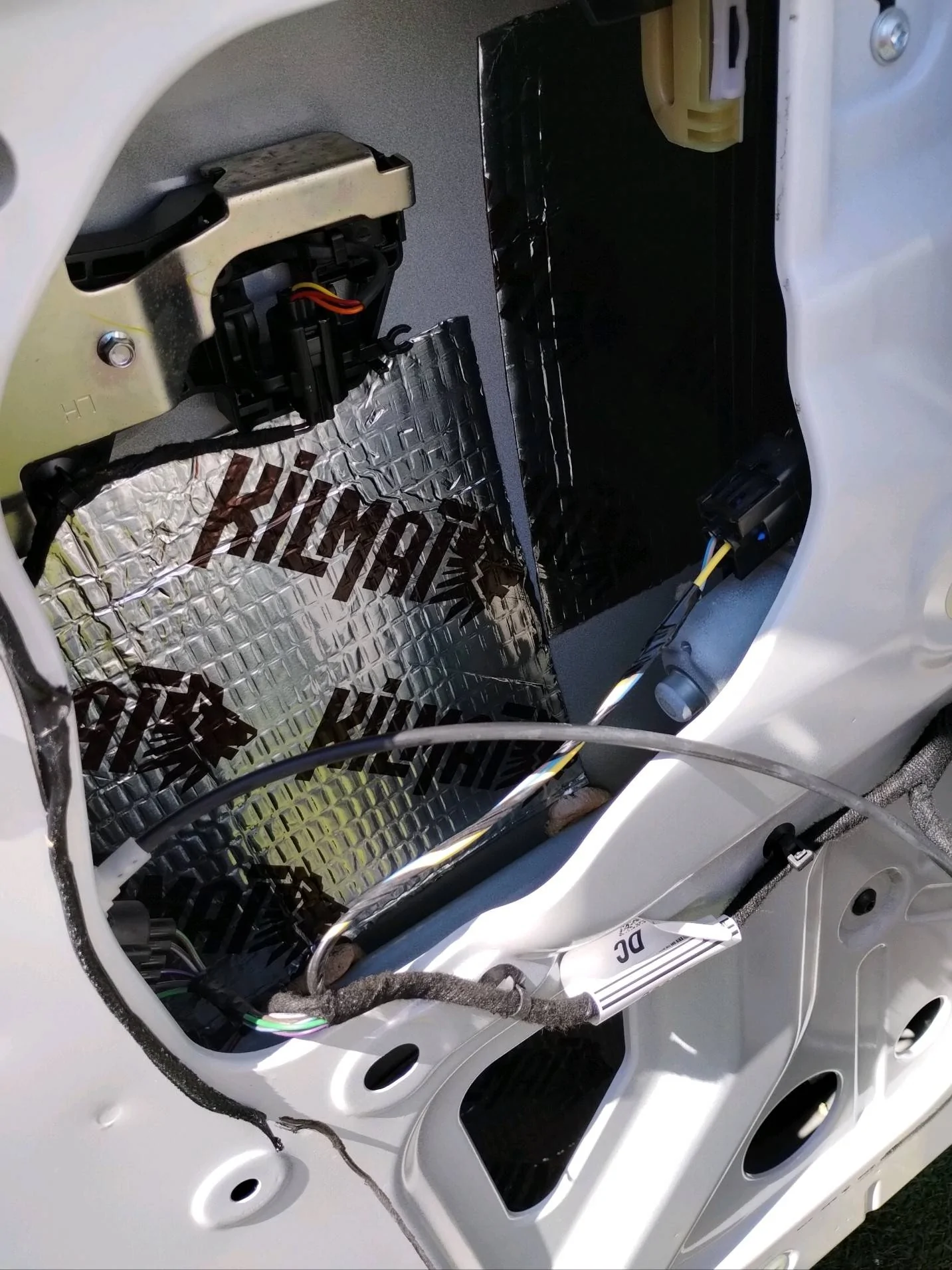

Added Kilmat 50 mil sound deadening to all 4 doors today.
Holy cow - what a difference.
Bugged the crap out of me how the doors sounded like a tin can when you close it. There was no sound deadening in any of the doors. Now they close with a solid thud.
Minimal weight added.
Each front door took 4 sheets and the rear doors were 3 1/2 sheets.
I didn't do any deadening on the inside panels, they have the factory foam sheet/vapor barrier. I'm sure the door panels could take a little to improve them but I was working to eliminate the cheap sound when you close the door.
I did mine early on for the same reason, but it also notably improved the stock stereo performance too!
Still planning my sound system upgrade, but this made it liveable.

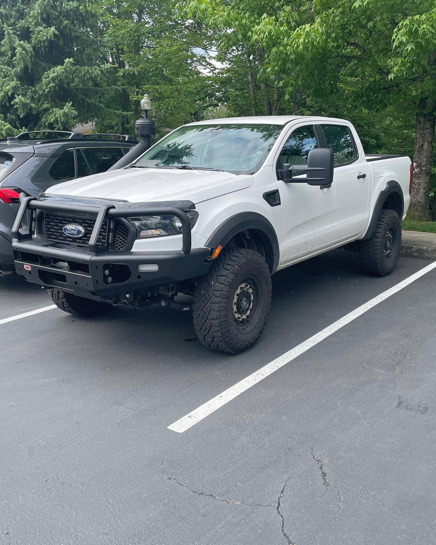

Well it’s mostly installed at this point. Will need to come back off for the little bits and bobs, and to install my winch when the relocation kit arrives, but I’m super happy with the fit and finish.
I love the look you've got going on here. The whole truck just works. What wheels are you running?
Joined the thicc trok club
What wheels are those?
8,802
42,032
Here
XLT
Looks great - how tough was it wiring in that light? How freakin’ big is the relay?
I drove around the block with the A/C and radio off last night.
It's eerie how quiet the truck is now.
Now I want to do the floor and the back wall!
(I only have like 45 sheets left) :)
