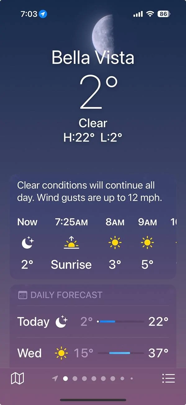

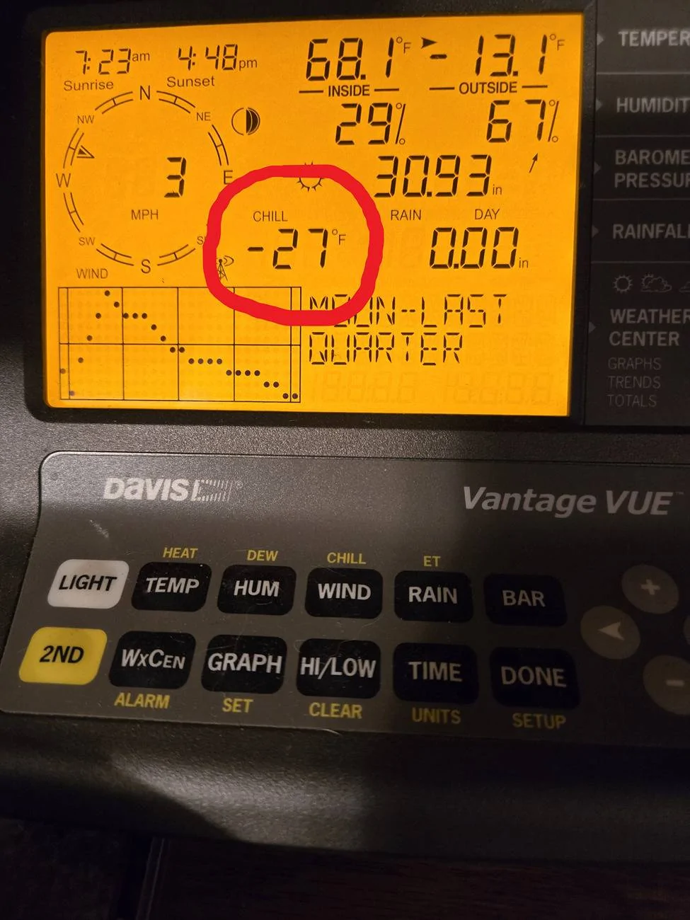

The temp at my place this morning.
As much as we both love SD this was a major reason why we couldn't live there. It's such a beautiful area and while we don't mind a little snow (you get more than a little lol) we just can't do those sub zero temps anymore. It's 2* right now which is pretty rare here but by the weekend it'll be back up to the upper 40's lower 50's. Stay warm my friend!! ?

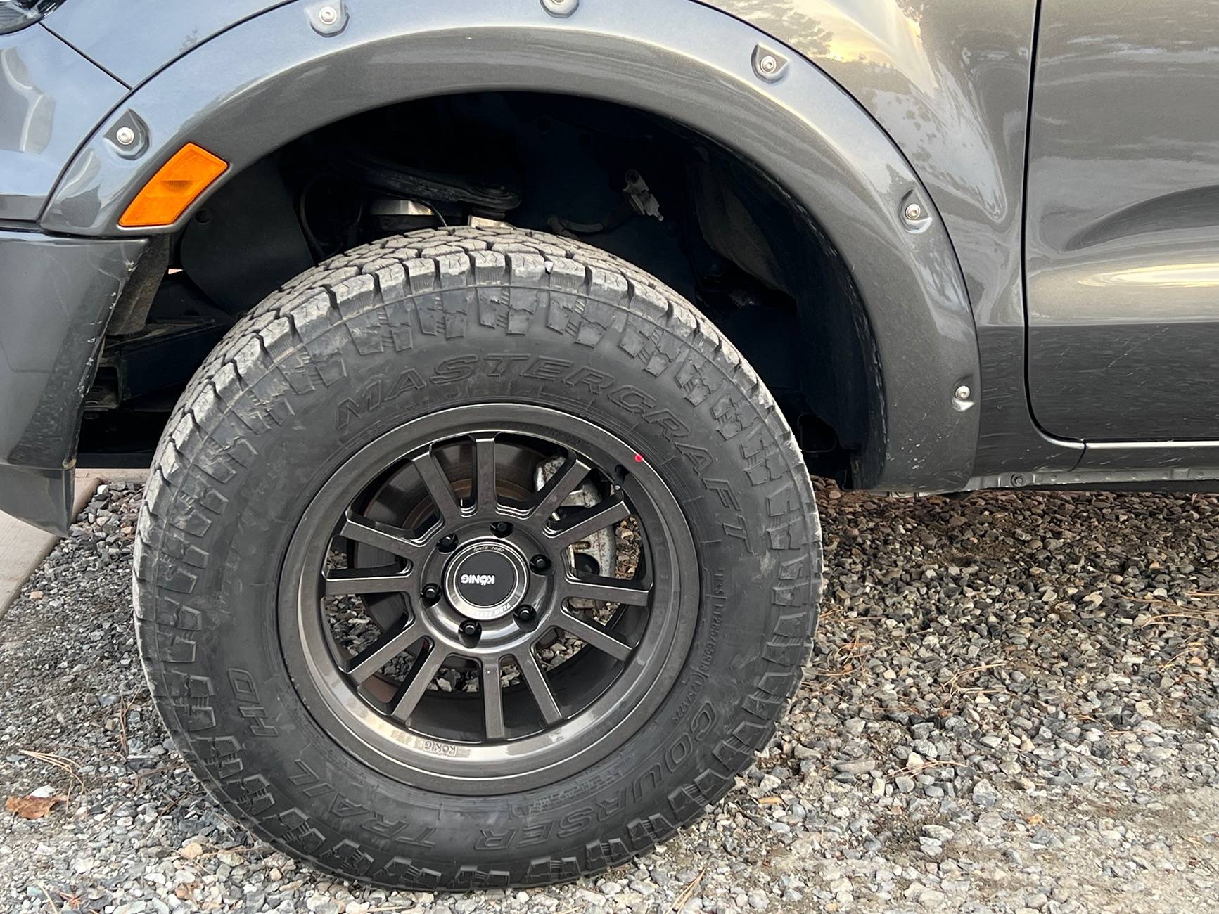

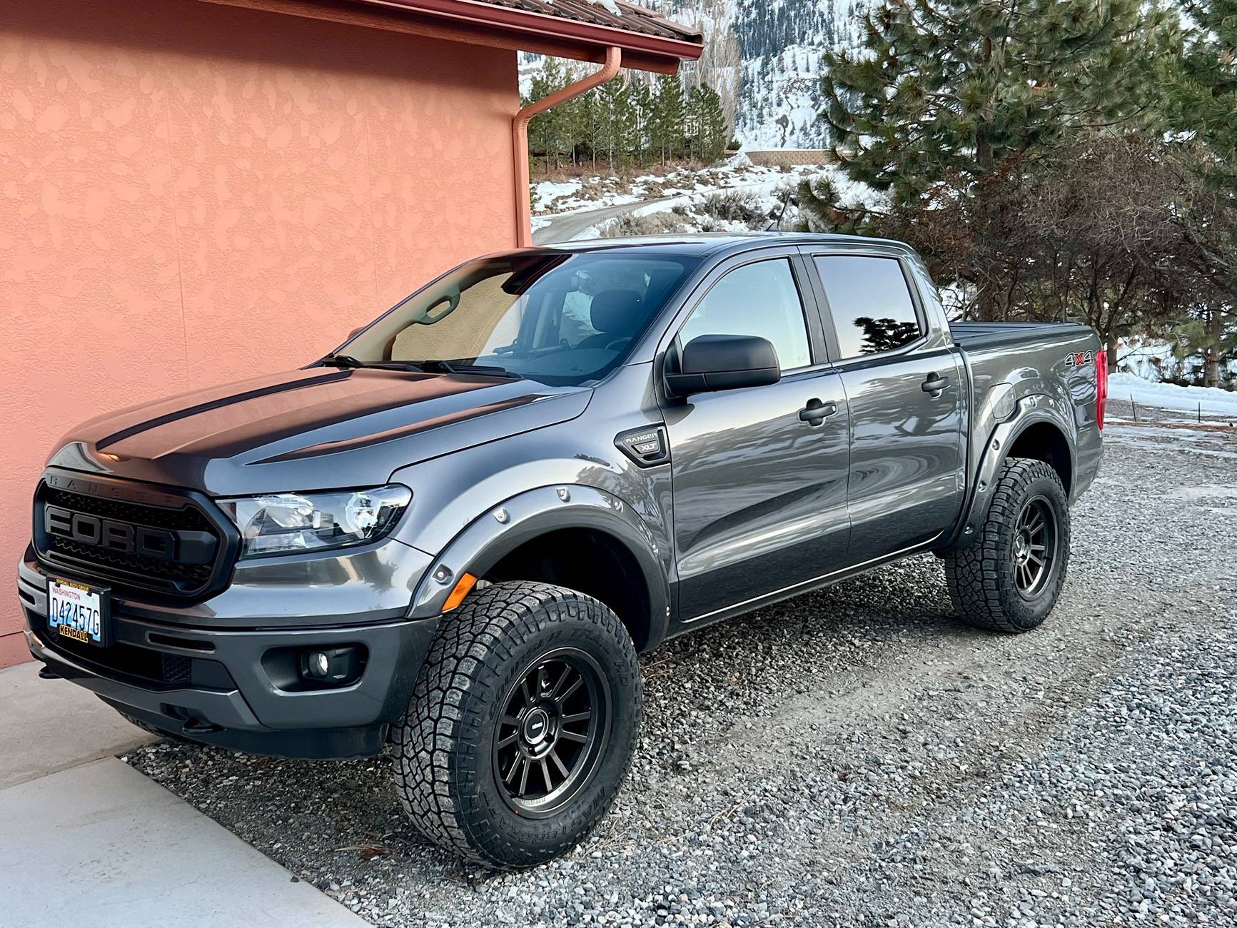

Well I cannot tell a lie… or keep a secret, so here it is…
I exchanged what I thought were god awful Fuel Assault wheels 18x9 -12 to Konig 18x9 0 offset wheels. In gloss anthracite. A middle ground between black or machined looks. The increased positive offset is a huge benefit too.
Stealthy but cool for me anyway.
I shopped quite a bit for wheels with wheel weight being first & foremost.
I saved 15 pounds per wheel!!! And I do believe I can feel better response.

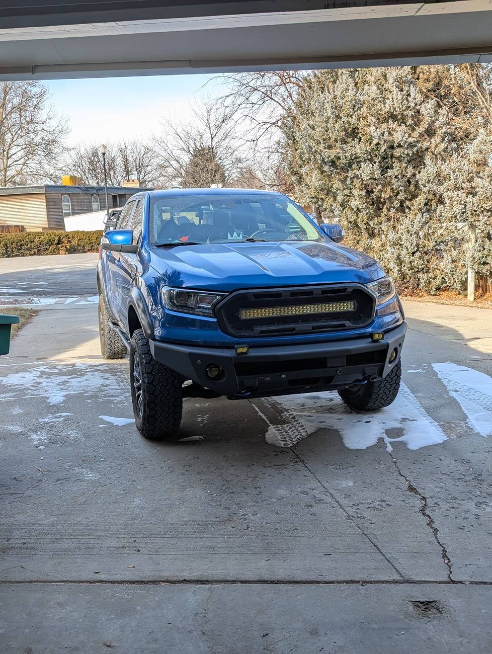

Added a Ranger Lifts 2" level kit and a cheapo Aux Beam 22" Light Bar with Amber/White DRL to my bumper. I am done spending for a while. Though the lightbar is $103 right now, pretty decent deal.

Konig much improved look.

Those look great and I’m sure there will be both a power and mileage difference.

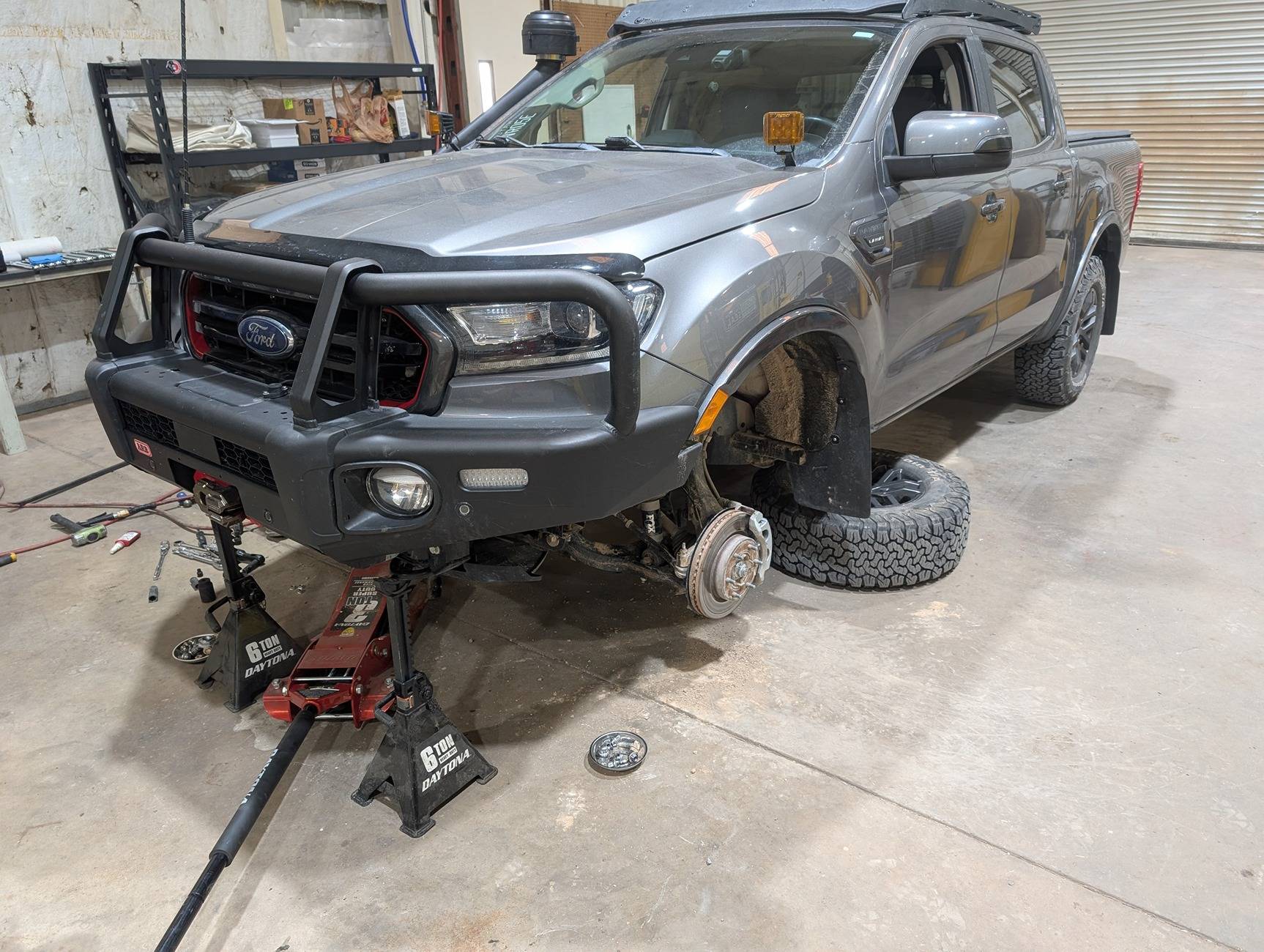

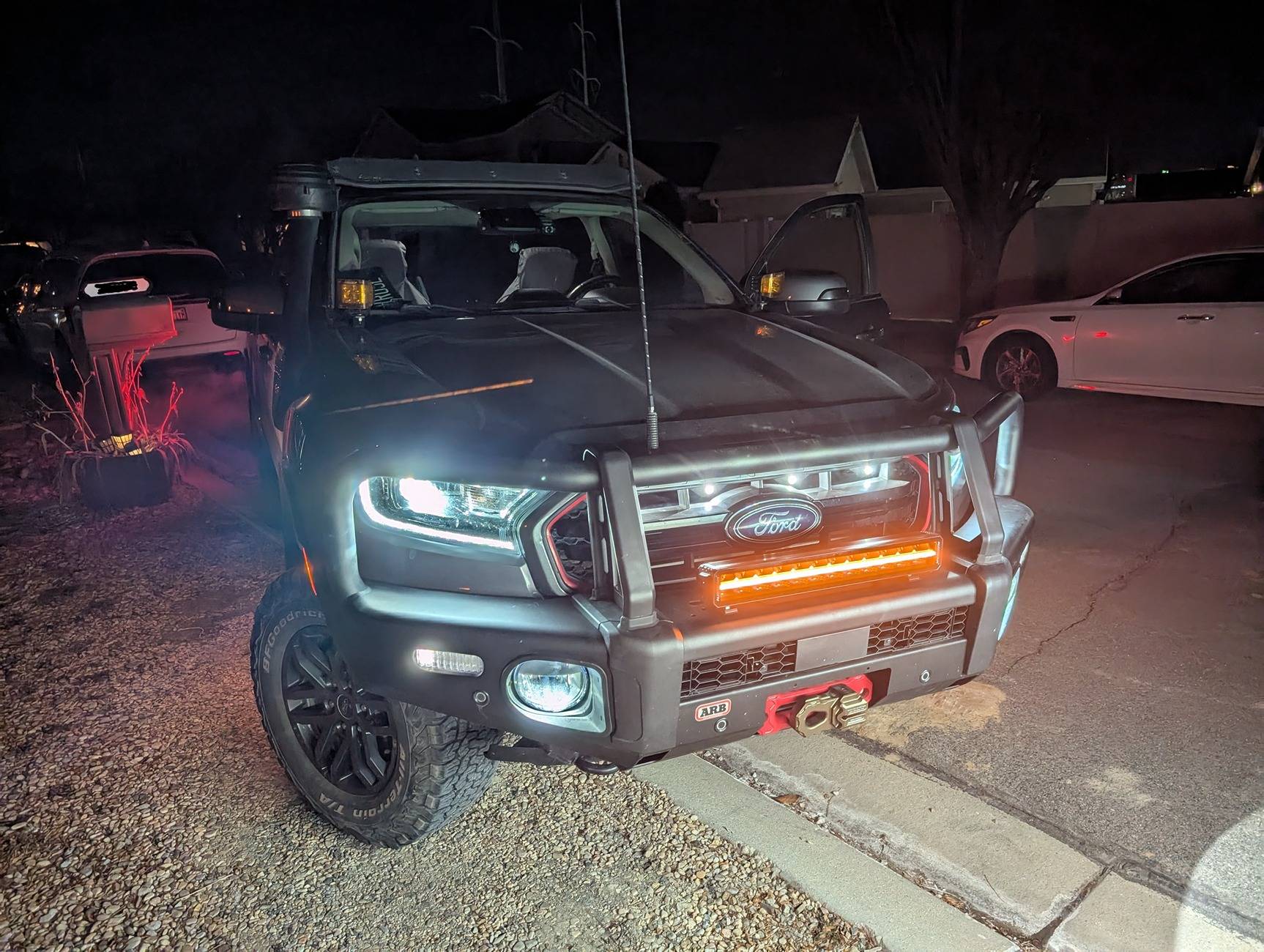

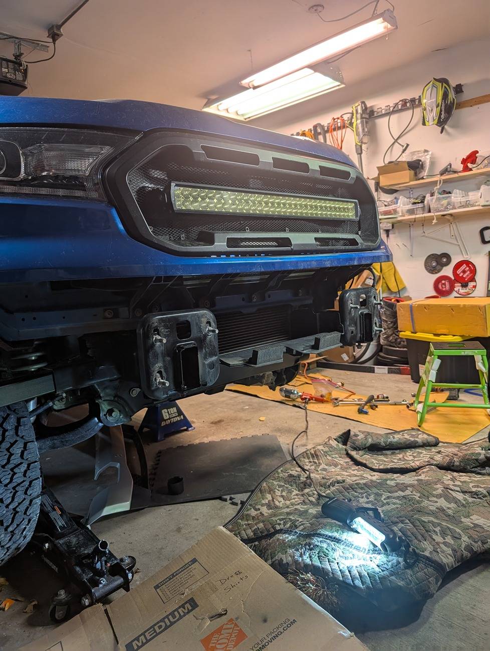

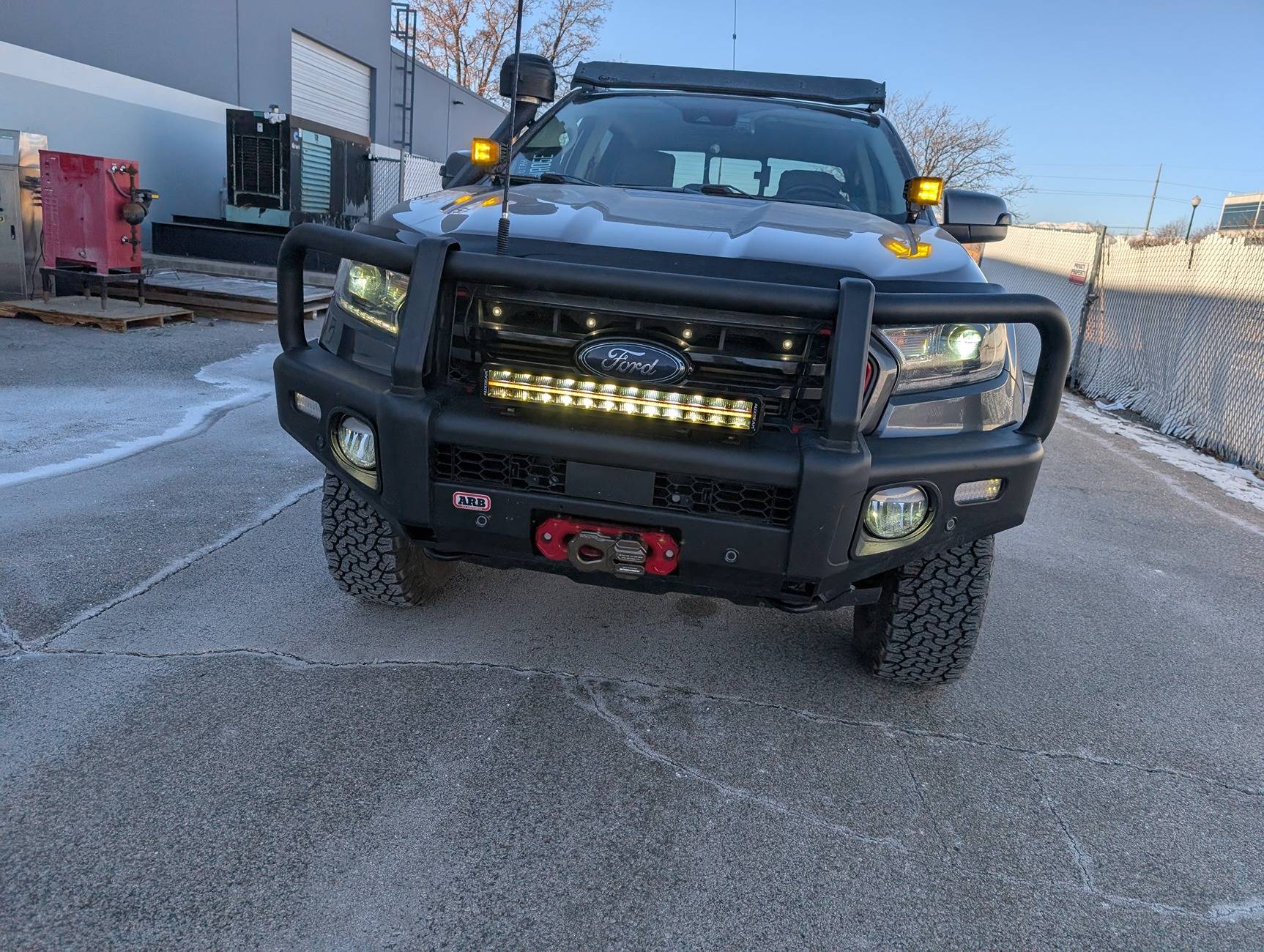

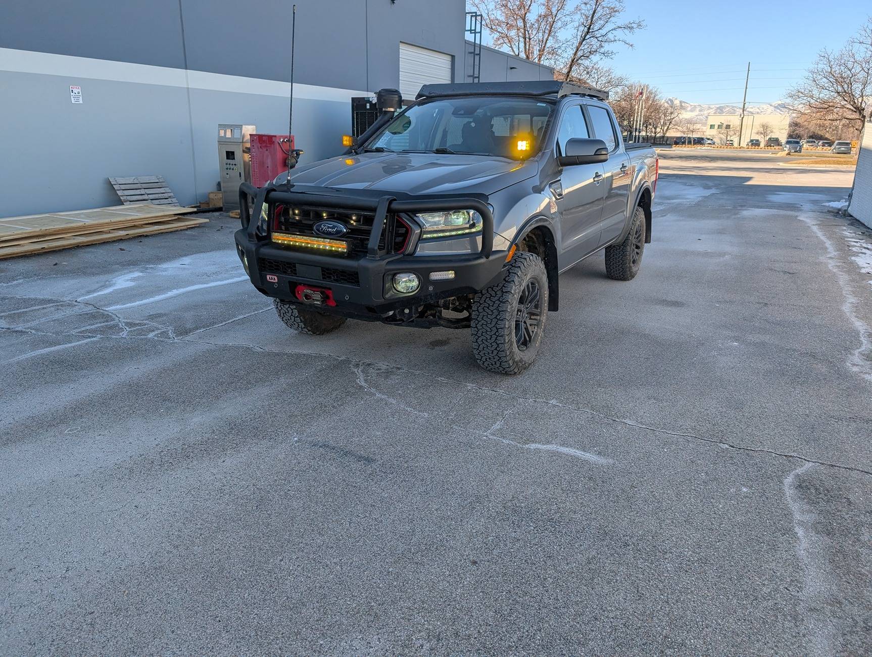

Finally got around to putting the ARB bumper on. Still need to finaggle one of the parking sensors. Got crash BDS bars in as well so no more rubbing when I put 33s on ?
Now for Fox 2.5s up front and a diff drop to go 3" lift.
Then went to Antelope Island to bike. Bumper didn't fall off so I'd call it a success.

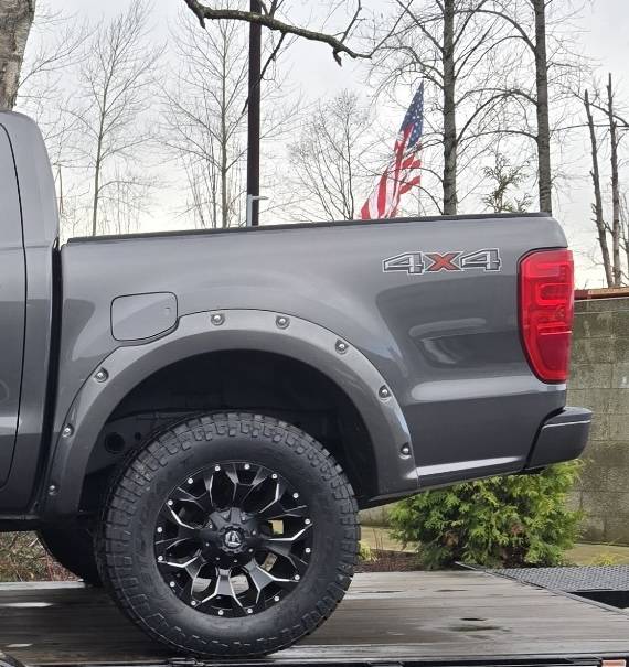

My rubber air damn is trimmed with a graceful curve, plus no crash bars.
To fit 285/65-18 (32.6”) 18x9 -12 offset originally.
I believe my spacer lift is 2-3” - I say that as I bought it used this way. Pretty general info I suppose.
No detectable rub to this point.
