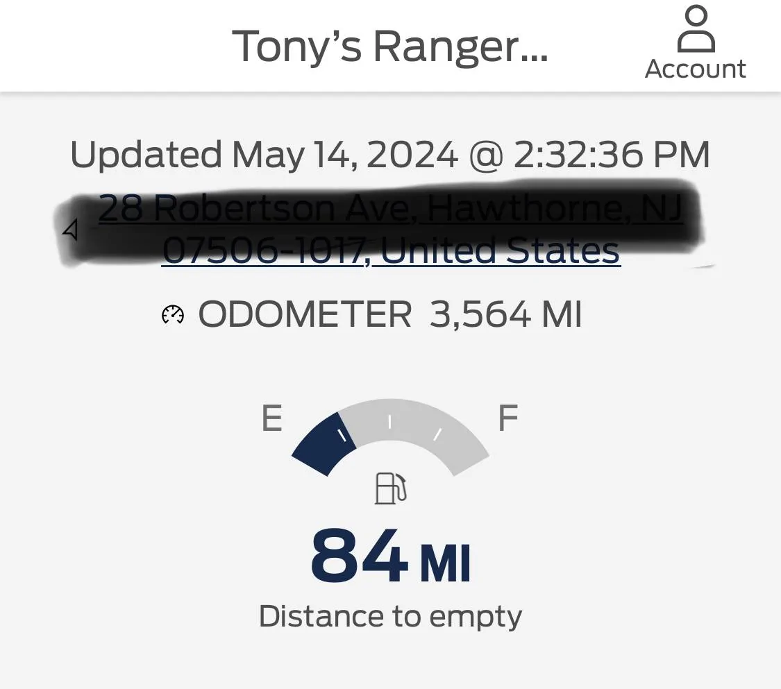

Got the warning, Oil Change Soon. It was down to 5% so I changed the oil and filter. I have changed the oil 6 times in 5 years with 20,300 miles. It seems like only yesterday I got the truck.
I feel the same way, times flying. We must have purchased around the same time. I changed my oil for the 6th time last week too. Only mine has just 3,564 miles.
