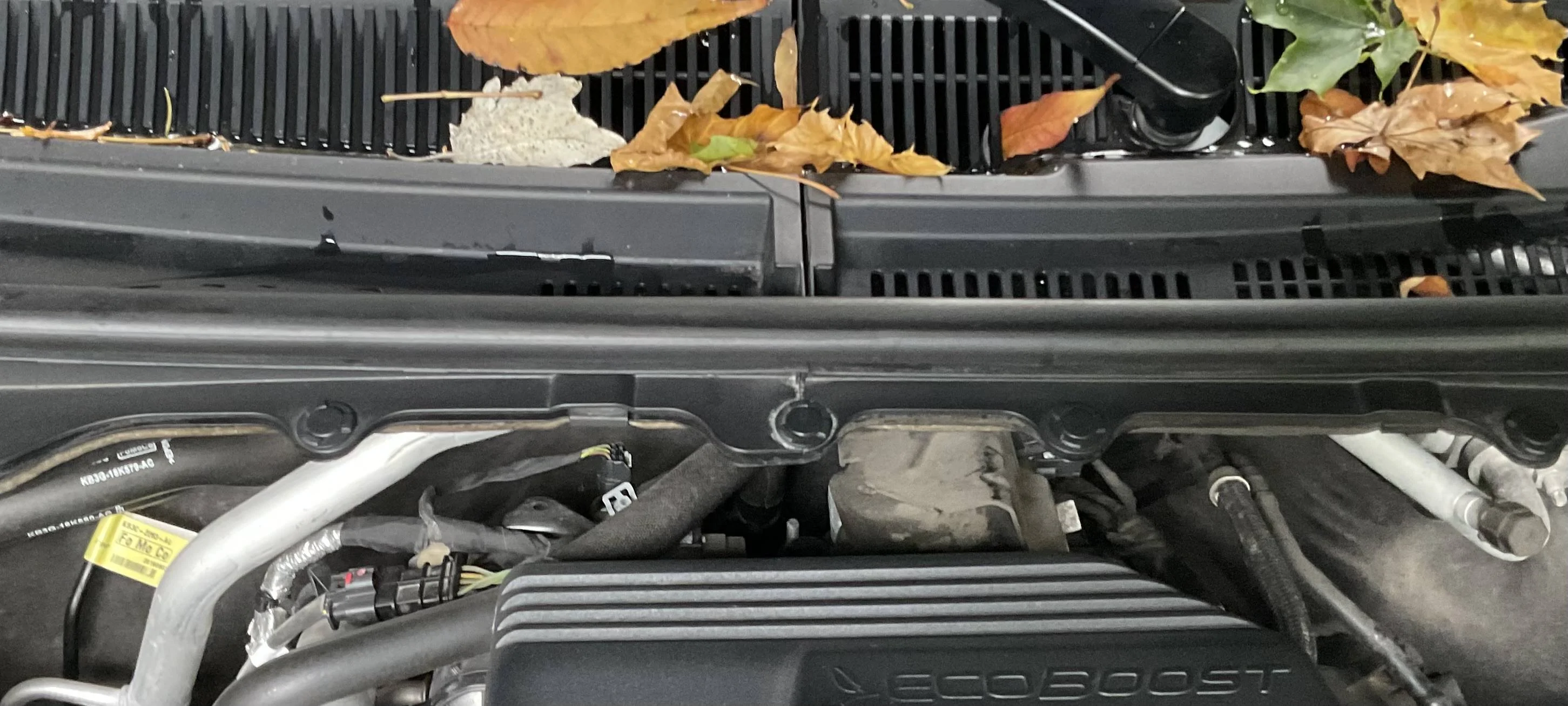

Here’s my 2019 @subquark
David, I doomed. :wink:
Gee, I have a hard time seeing the difference?
Looks like there's a thin foam layer under the gasket thingie (so techie, I know) that raises it a bit?
Are you going to add a pool noodle Duke?
If I do, it'll be the cheapest mod I've ever done since I have a metre-long piece of pipe insulation that fell off in the basement. =D
Of course, if someone's selling a hundred dollar Ranger Engine Pool Noodle, I may have to order it! =p

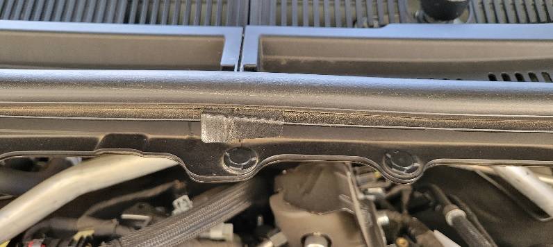

Is that duct tape ?? That is already falling off ??
Some kind of tape yes. And it's falling off because after I wash the truck, I pop the hood the wipe all the residual water and dust. I wipe the cowl all the time, but this is the first time noticing the tape, probably cause it's falling off :crackup:

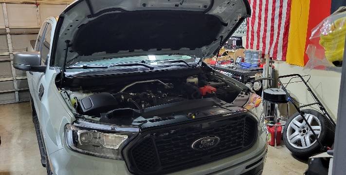

I installed the hood struts I ordered last week :clap: .
*Word of advise, always read instructions on something you've never installed before, especially something this simple. :rolleyes:
One little detail almost ruined my day. I've installed numerous gas struts on hatches and hoods, NBD. Installed them no problem quickly "glancing" at the instructions. On the bottom on the fenders, the attachment clips need to be on the top when closed. I failed to read that and mine were on the bottom. Closed the hood and I heard them pop off and the clips bouncing off the sheet metal in the bay. Luckily, (after 30 min) I found both clips sitting on the frame rails. Re-installed properly after READING the instructions, all good. :like:.
On a side note, according the the TSB on the "water in spark plug hole" it only covers 19-21 models. I found that odd until I noticed Fords "fix" to the problem while installing said struts :facepalm:.
In Jan 23, the TSB was updated to include the 22MY, and FYI my 22 does not have the tape.
Will have to see if the TSB gets updated to add the 23MY, I suspect they also added RTV at the seam and then covered it with tape to keep the RTV in place.
Is there a part # on it ?
Covered by warranty, of maybe a recall if it comes off ? TSB ?
Inquiring minds want to know !!!
This is one thing I still want to investigate on mine and determine what can be done at this location.
I have added the engine cover for the Low price of $56.00 last year so I will either look into a better seal like the tape add or the Pipe Insulation (Mod) as I have some extra leftovers from a house insulating project.
I added a little more RTV for my own peace of mind. I'm looking into the foam fix but I'm looking at different options to that solution. Something a little less obvious looking.
