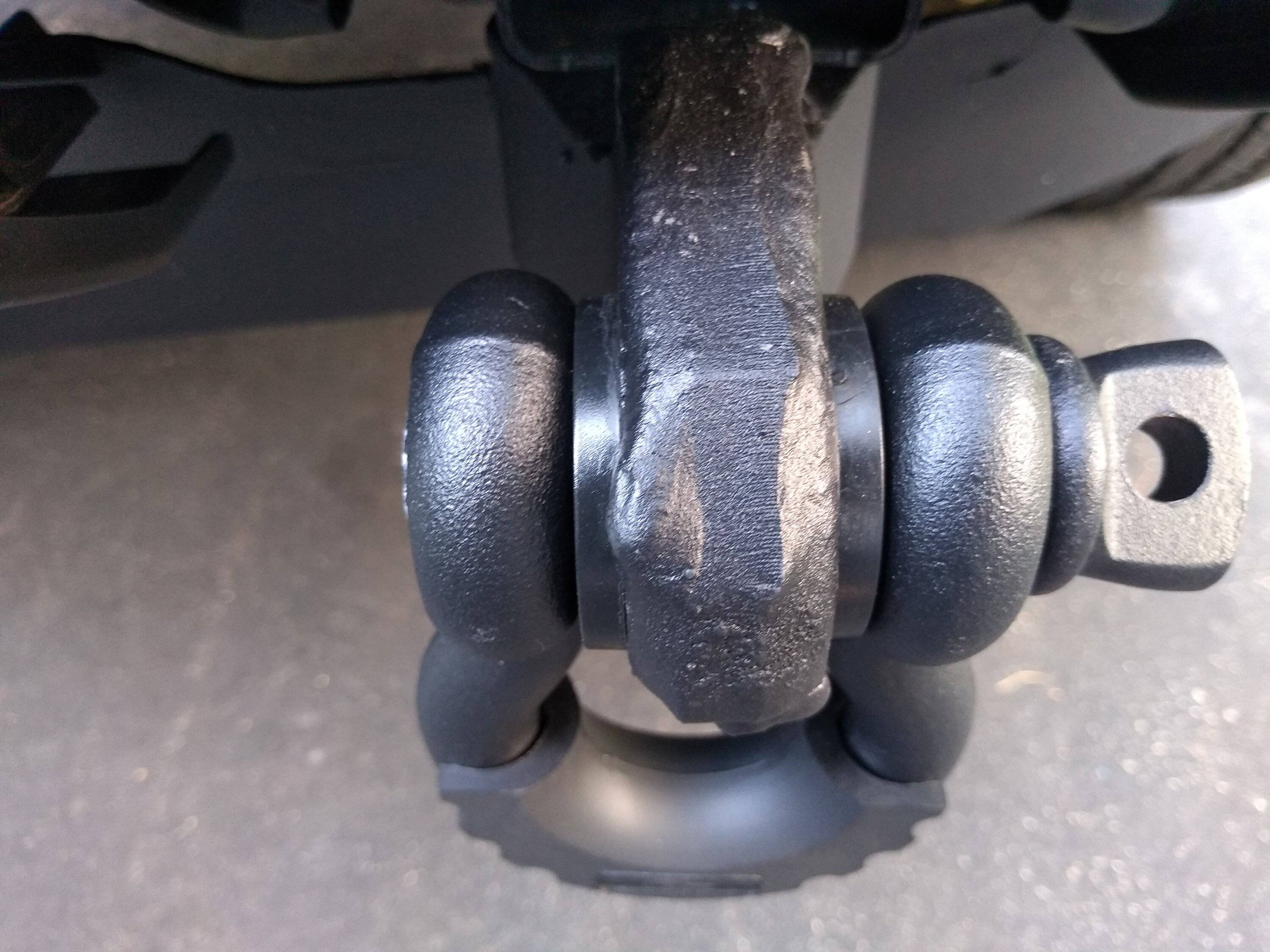

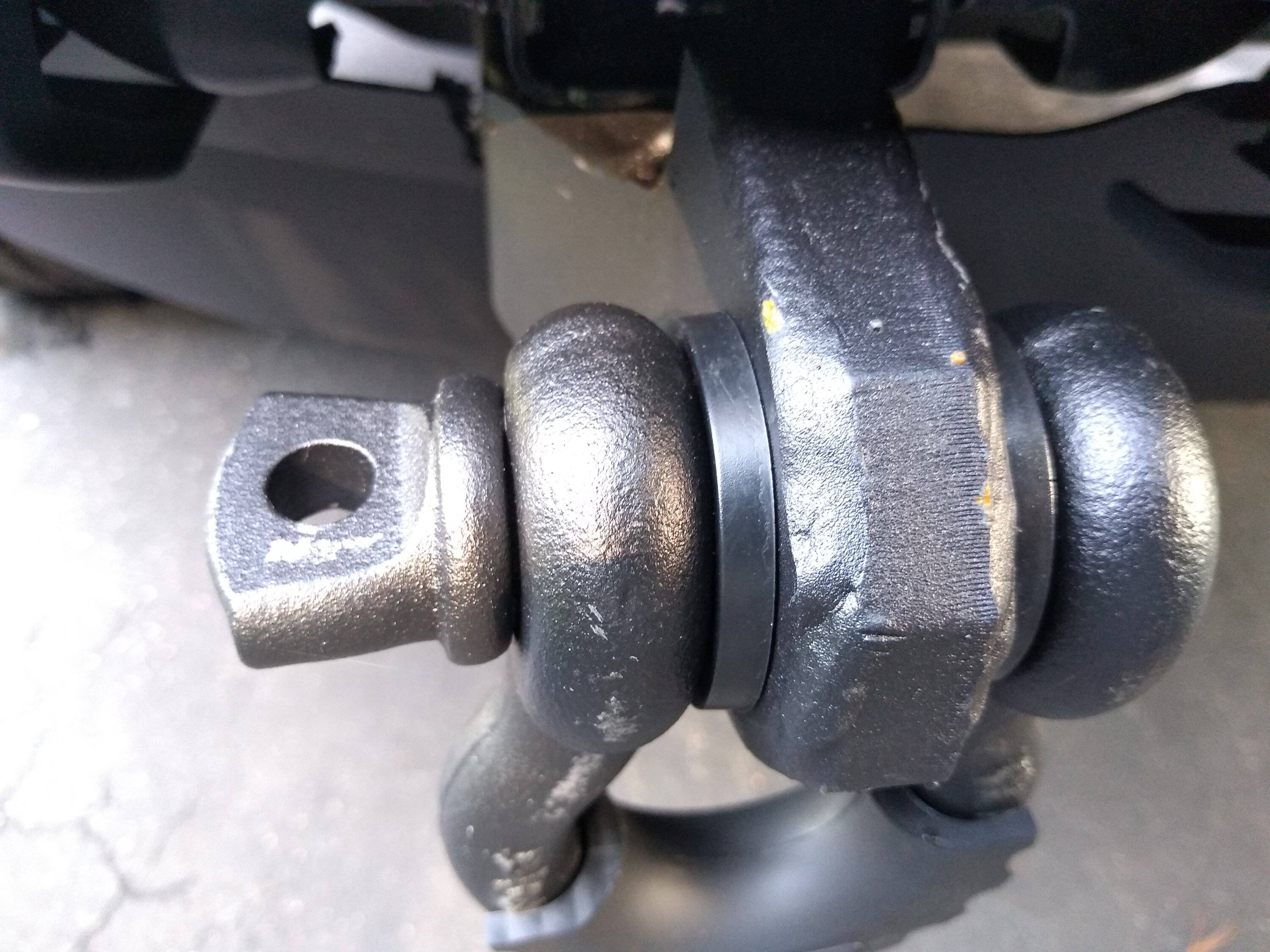

I did a customer service request and also posted a review on their site about the issues I mentioned above. That was Monday and so far crickets. No nothing.
And the "powder coating"? LOL, already got some surface rust.
I'll repaint them myself and need to grind out that one side a bit more, but for what they are, you do get what you pay for.
Too bad they just go silent. Unless I hear from them (ever), I'll never buy from them again. =(
light surface rust (after a rough week of being parked in the driveway)
still can't get over this blob of a bead - maybe it's to hook a rope?

Seems to be typical quality from American companies these days. Can't believe they have zero quality and no support for getting issues like this fixed. I bet they didn't properly clean and prime before the top coat of powder. I would yank them off and send them back. Totally unacceptable for what they charge.

I'd grind that blob down, shoot some rust reformer then add 3 coats of Herculiner.
(Herculiner takes a few days to cure heads up)
As mentioned, American companies are a joke these days. My $200 engine cover from jrc offroad came full of scuffs and chipped off powder coat.

One reason why I don't get aftermarket bumpers. Here in the Salt Belt every truck and Jeep I've seen with one is shot full of rust within three years.

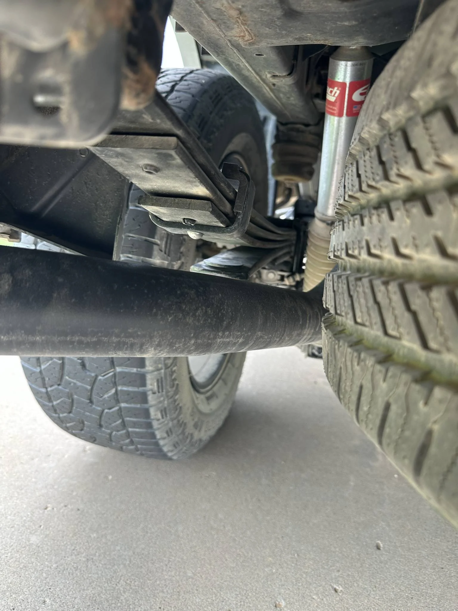

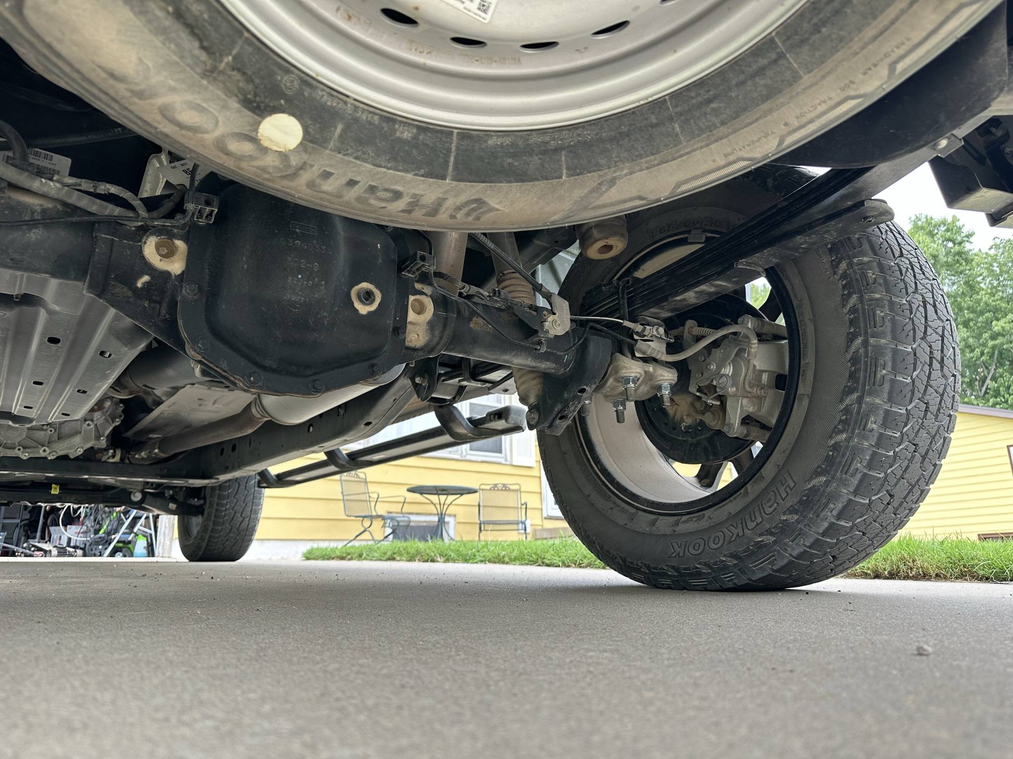

I installed my Wildtrak/global leaf springs today. All I can say is, WHY DIDN'T THE TRUCK COME THIS WAY?!
It's a night and day difference.

Only thing extra I needed was longer U-bolts. I opted for the Rough Country 7604 set. They're $40 for a set of 4, whereas the Tremor U-bolts are around $20 each. I forgot to measure the rear ride height before I started, so I'm not 100% sure. Most others have ended up with around 1/2" of lift in the rear. I think that's probably accurate, but like I said I haven't measured.
  1. Jacked up the rear end by the pumpkin, put jack stands under the frame, let the axle down until the springs were almost all the way at full droop, and removed the lower shock bolts (in retrospect I might not have needed to do this since I have Eibach shocks).
  2. Unbolted the U-bolts on one side and let the jack down a bit to let the axle drop away from the spring.
  3. Unbolted the rear shackle and slid it to the side to let the rear of the spring drop and then removed spring-to-frame bolt. (Make sure to keep track of the original shackle bushings, you'll probably need them.)
  4. Removed the spring, reused the factory driver's side shim, and knocked the saddle off the factory spring to reuse on the new spring.
  5. Placed the new spring, got everything lined back up, and loosely bolted it back up. Final torque should be done with weight on the suspension so the bushings don't get twisted.
  6. Repeated 2-5 on the passenger side.
  7. Put the wheels back on (100 ft-lbs.) and dropped the jack quickly to let the suspension bounce and settle a bit.
  8. Torqued everything to spec.
    1. Lower shock bolt - 52 ft-lbs.
    2. Spring-to-frame bolt - 119 ft-lbs.
    3. Shackle bolts - 76 ft-lbs.
    4. U-bolts - tighten in a cross pattern in four steps
      1. 26 ft-lbs.
      2. 52 ft-lbs.
      3. 76 ft-lbs.
      4. 98 ft-lbs.
  9. Go enjoy your truck that no longer tries to throw you through the windshield on dips and bumps.

As others have said, these must have a much lower spring rate than the USDM springs. The ride is massively improved to me. As soon as I dropped off the curb on my driveway, I could tell it was better. I went and drove around town and then headed towards a friend's house that has a poorly grated/washboard dirt road. It still rides like a truck, but the springs actually absorb it instead of transferring all of the energy to the truck. Highly recommended.
My Eibach shocks were a huge improvement over the stock non-FX4 shocks, but this is another level.
