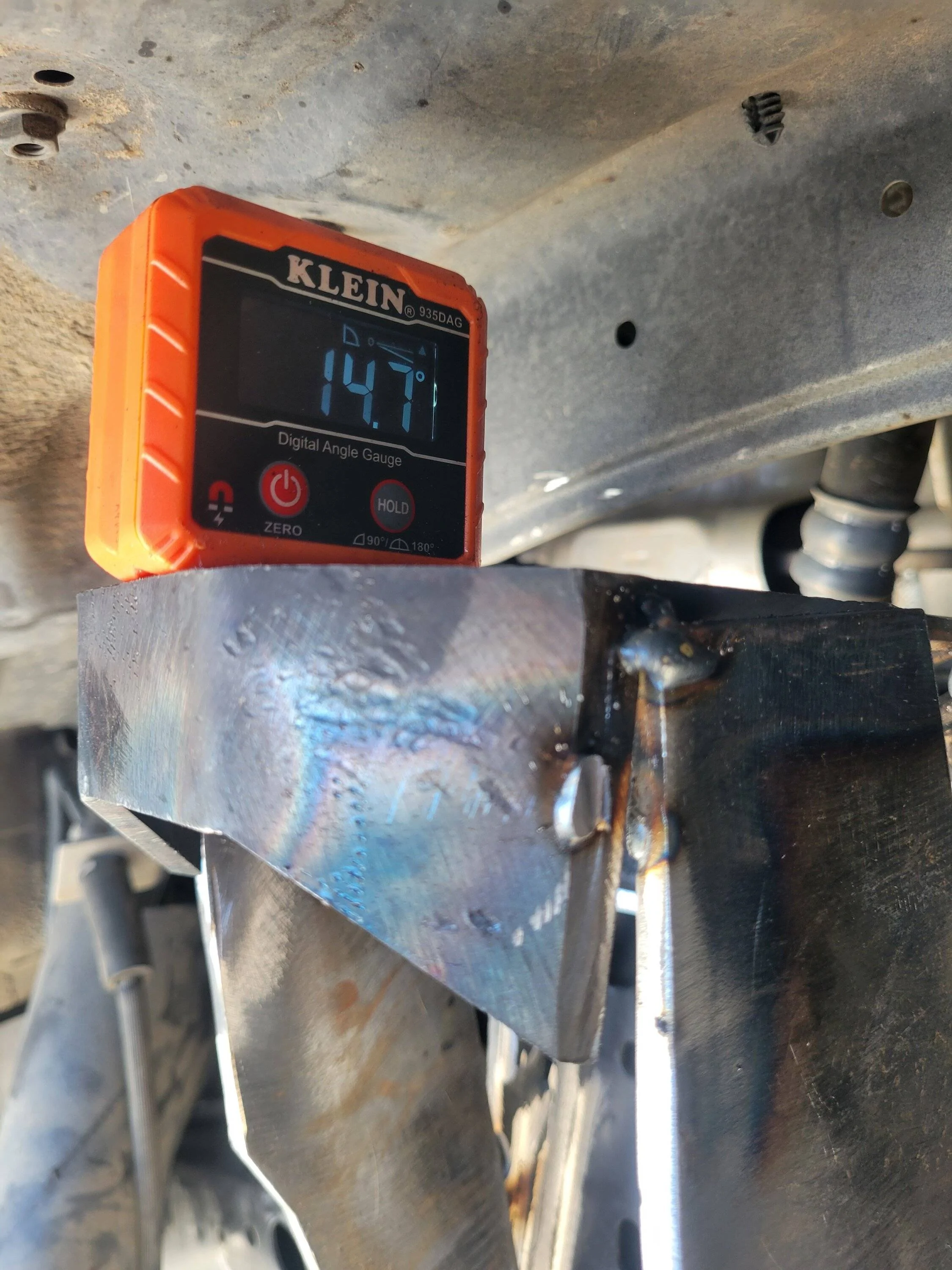

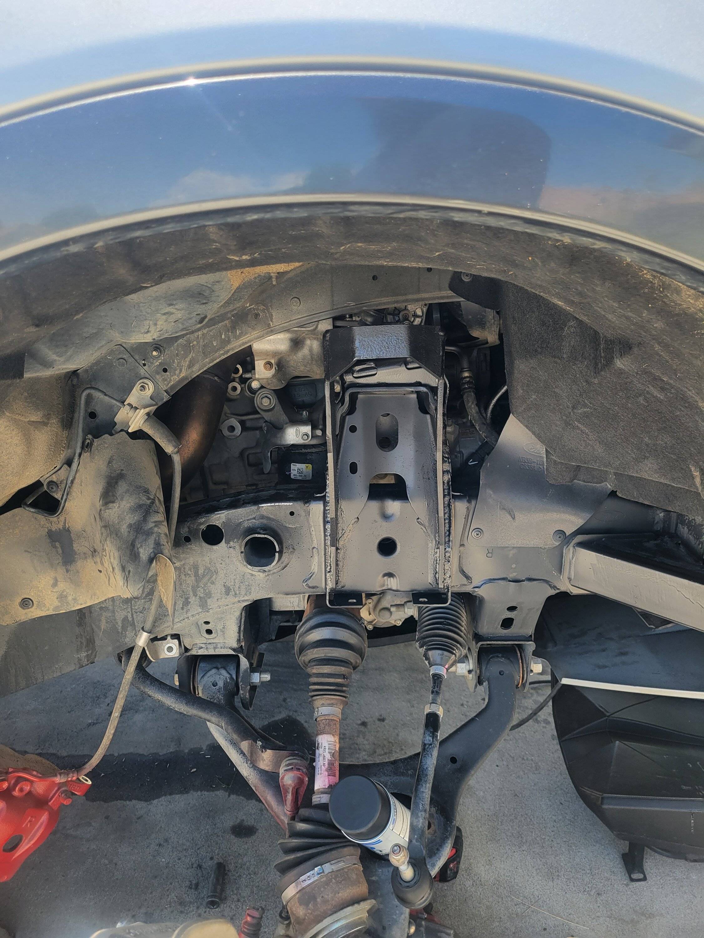

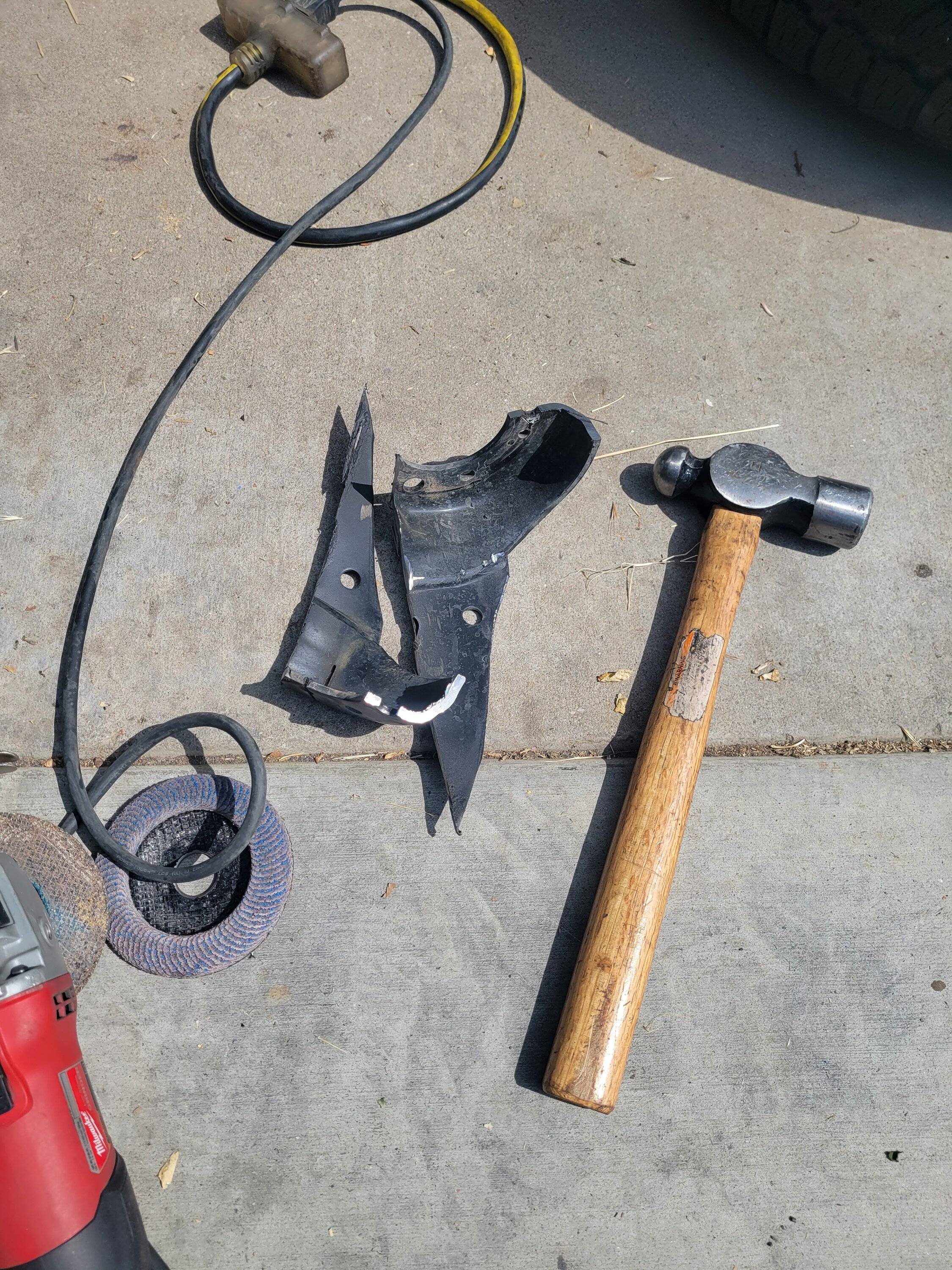

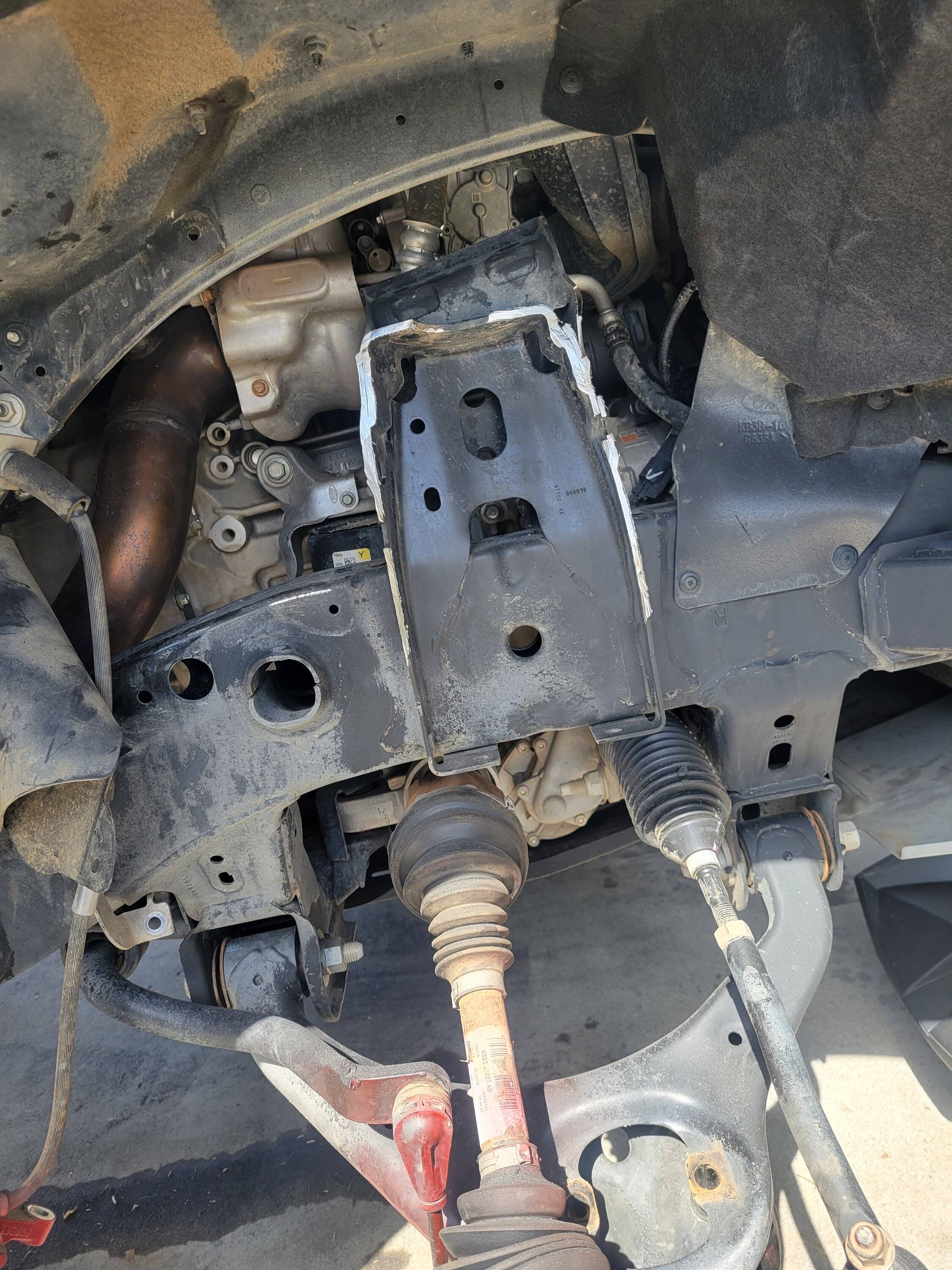

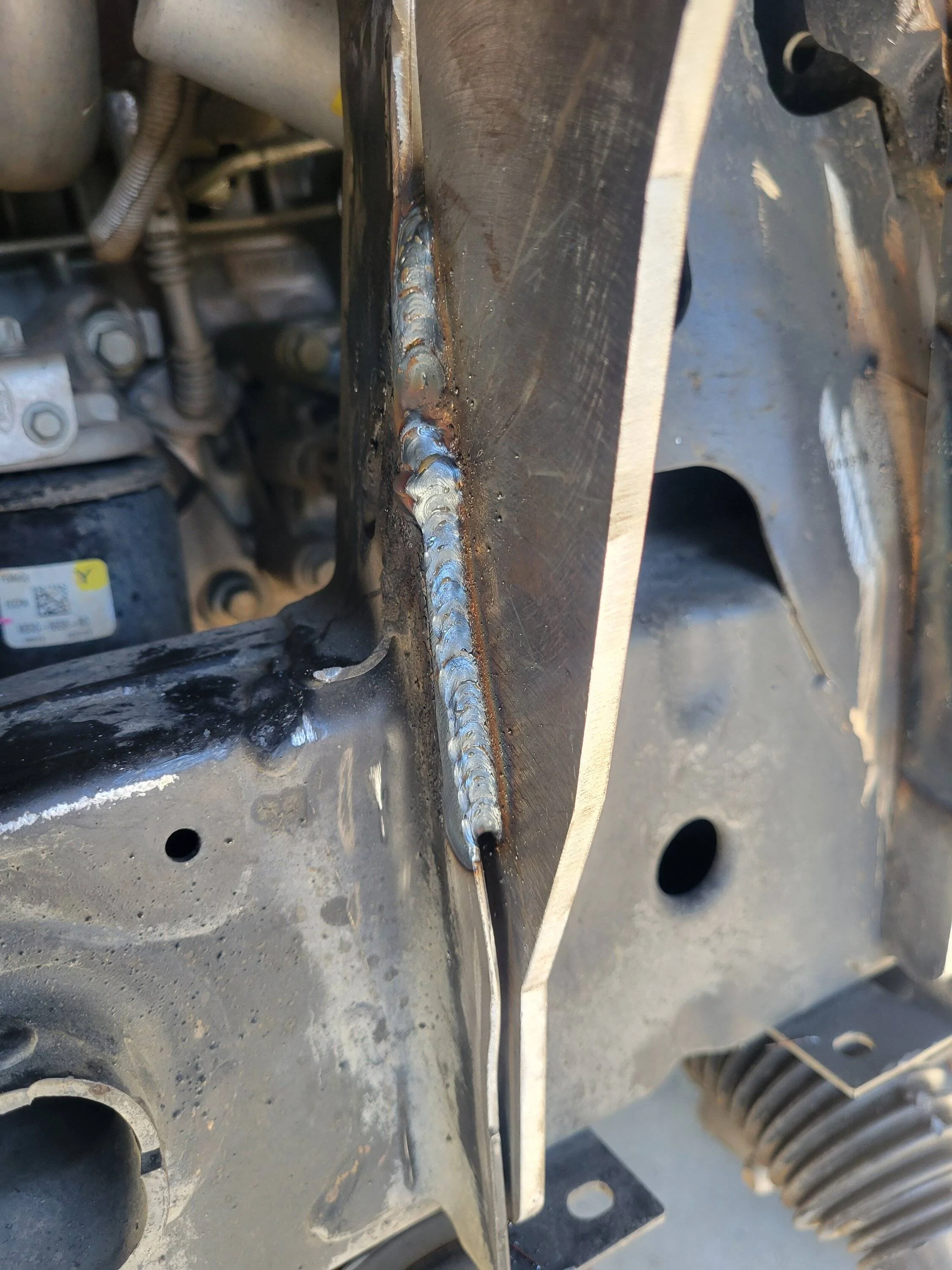

Started on passenger side. Cut out shock tower already. Taking a small break damn sun won't let up.

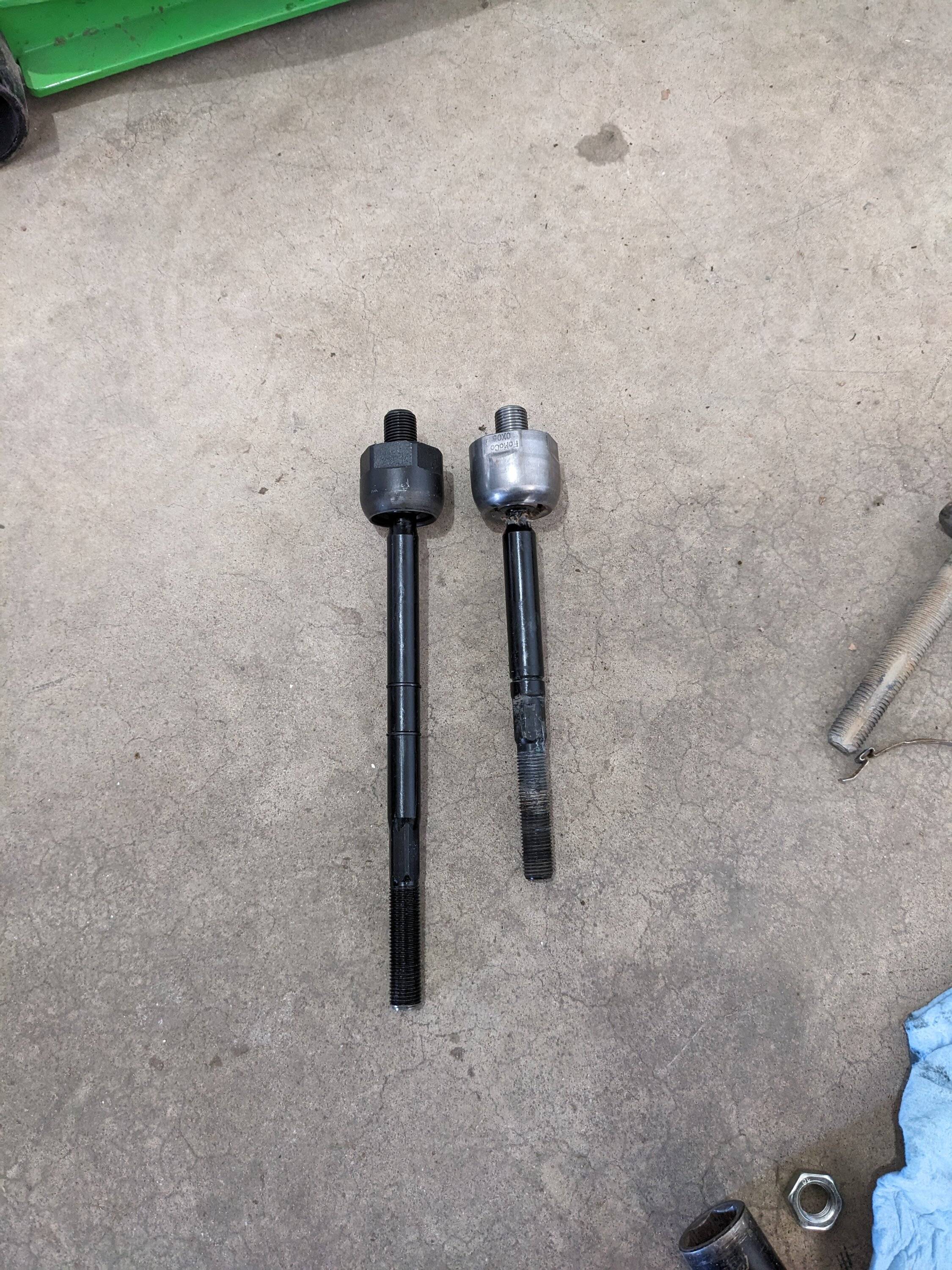

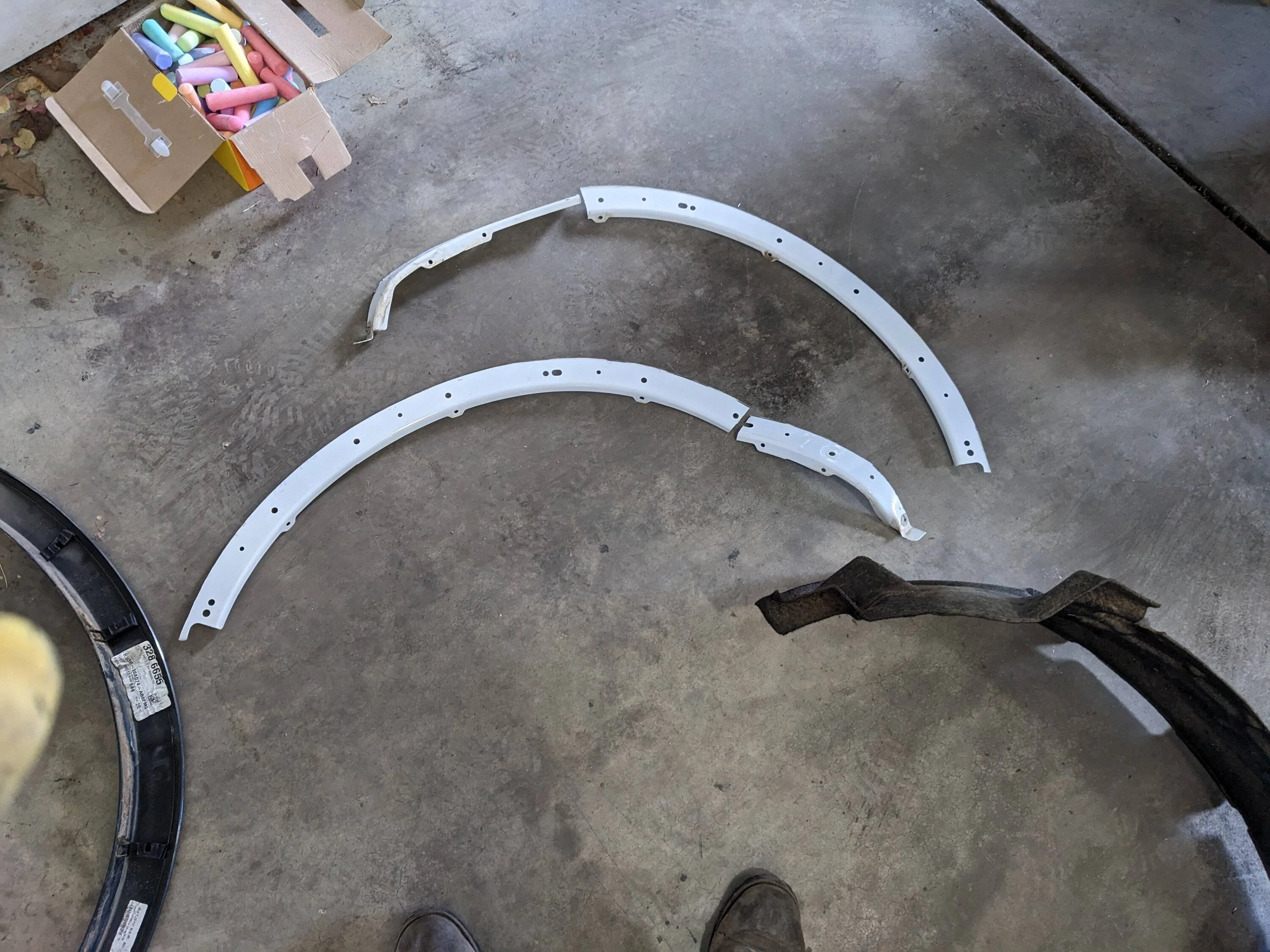

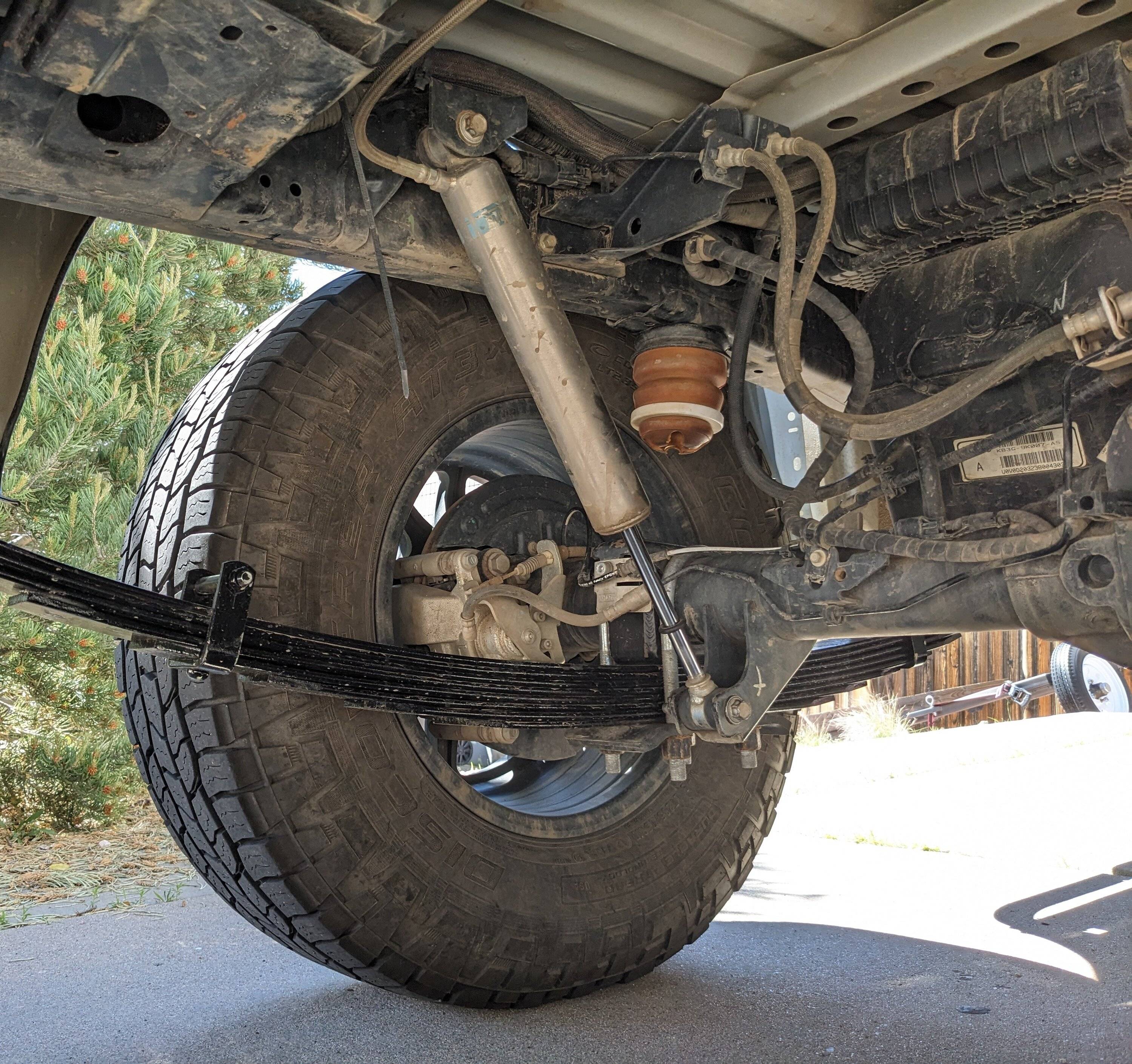

As for me, I threw on some Bronco front control arms, cut fenders and went spring under on the rear:

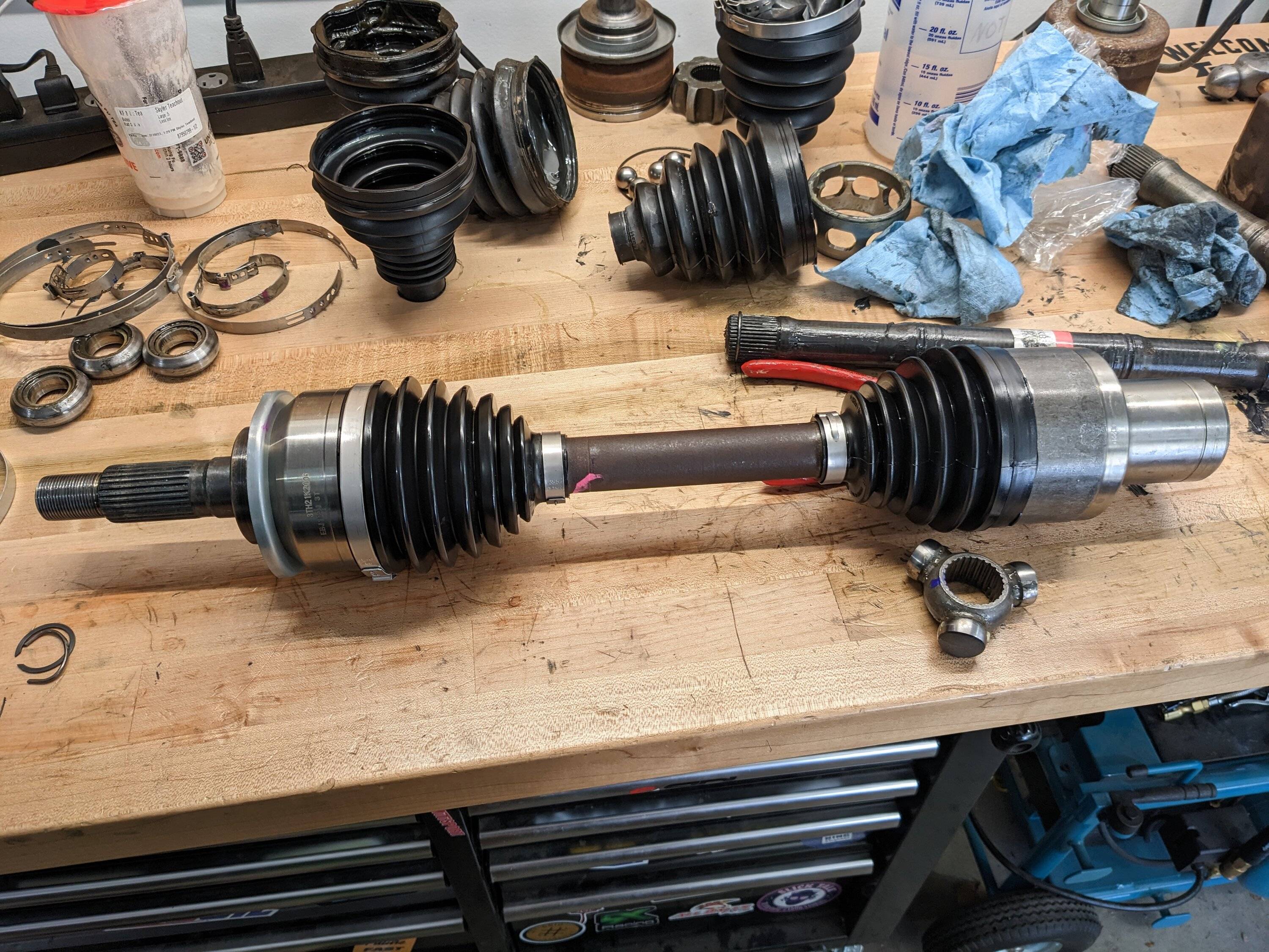

Lower arm bolts on, upper needs a tapered reamer through the upright/spindle and the frame side is wider than the Ranger. Bronco upper arm ball joint is sweet; lots of hangulation. I think I had to find a 2005 Mercury Mountaineer inner tie rod that was the right length, too. Also pulled all the internal spacers out of the Ranger spec Bilstein 6112's to get shock travel decent for the Bronco control arms. CV axles are Frankensteined from Ranger and Bronco M190 parts. Jonesing for an M210 diff one of these days...
Only on 34's at the moment, but this helps quite a bit when flexing about.
Mostly for grins, but an XJ lift leaf pack and some laser cut shackles do allow more bump travel for a given ride height with the short body Bilstein 7100's.

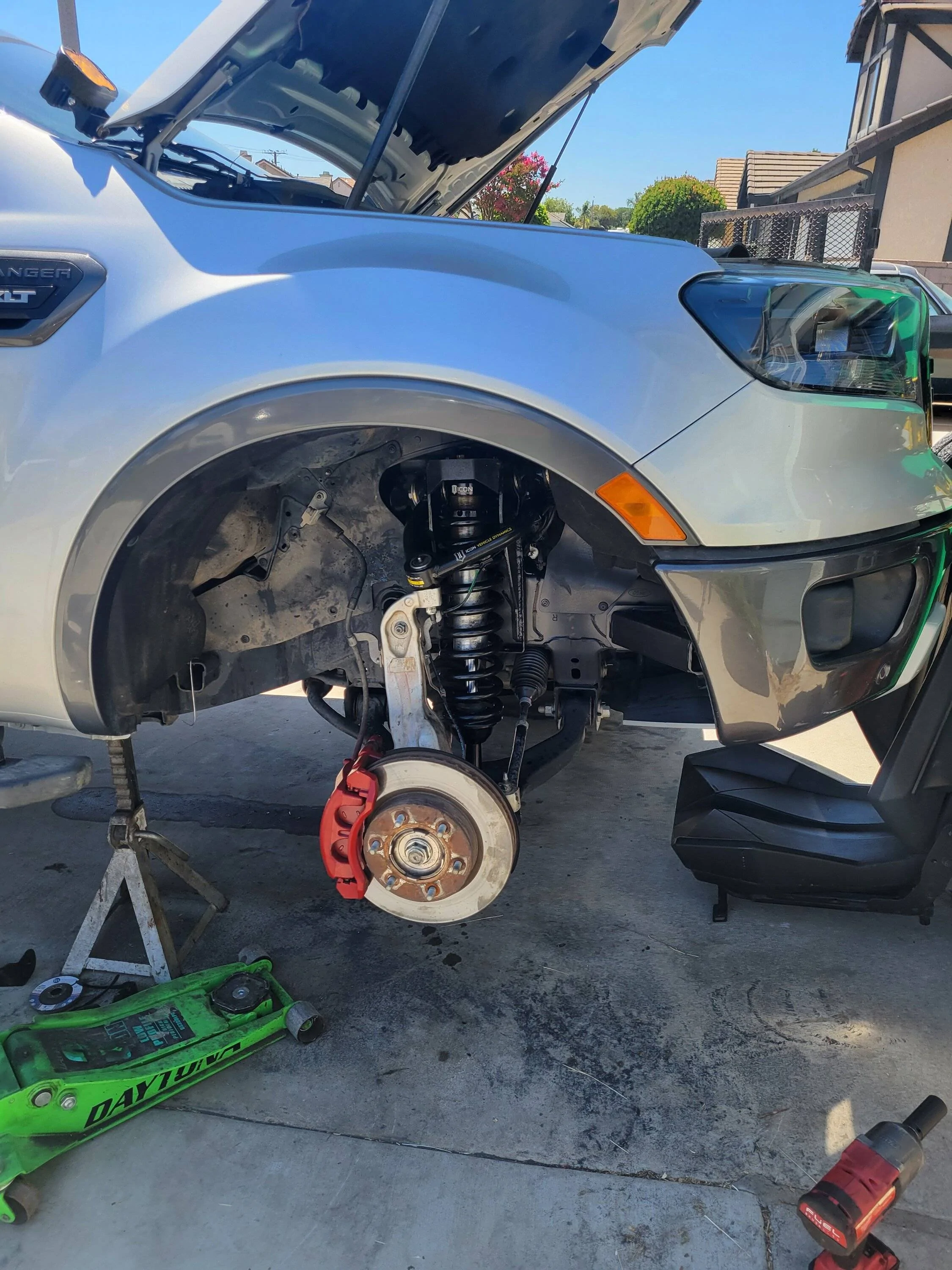

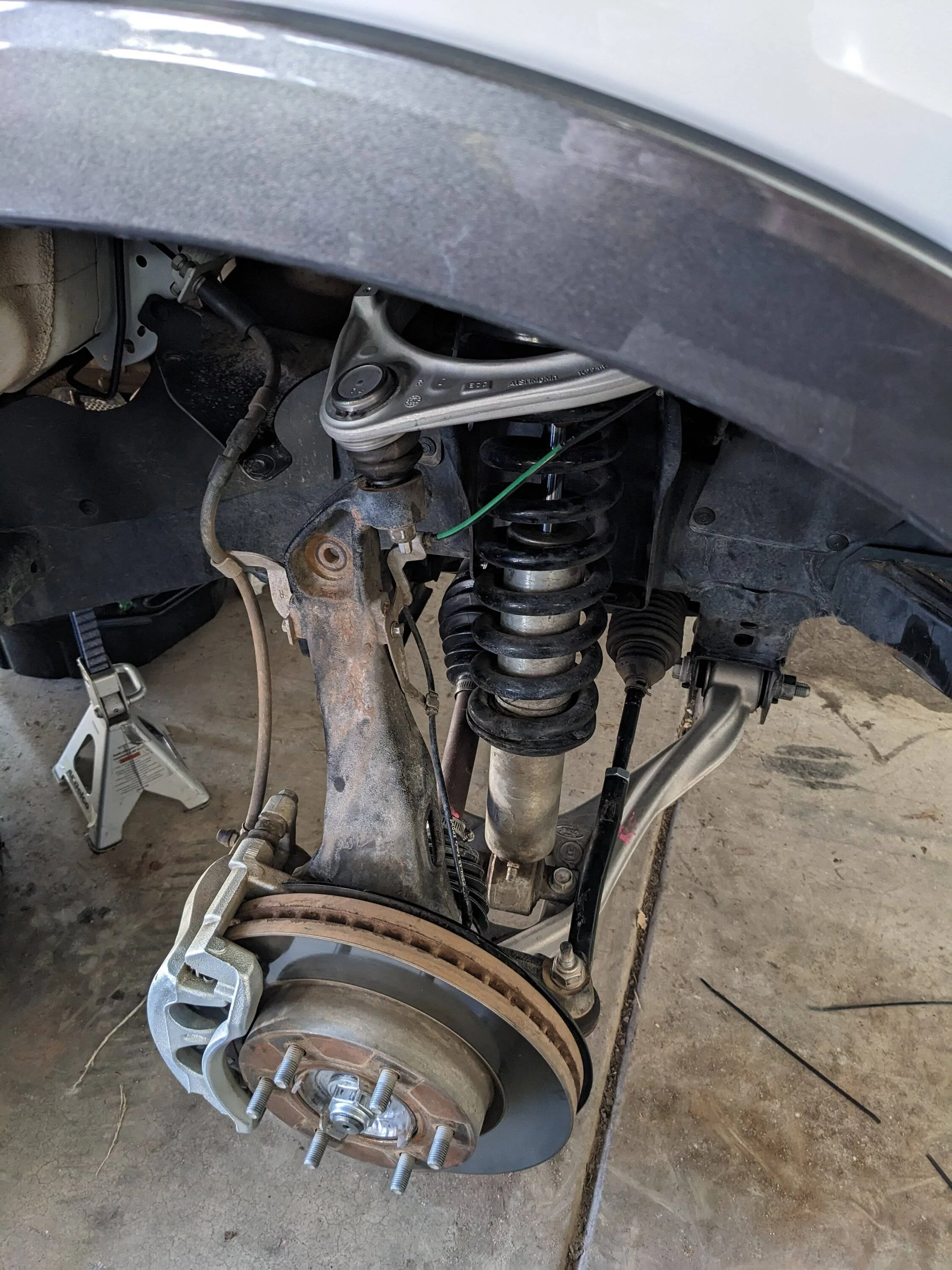

Bronco coilover swap now done.

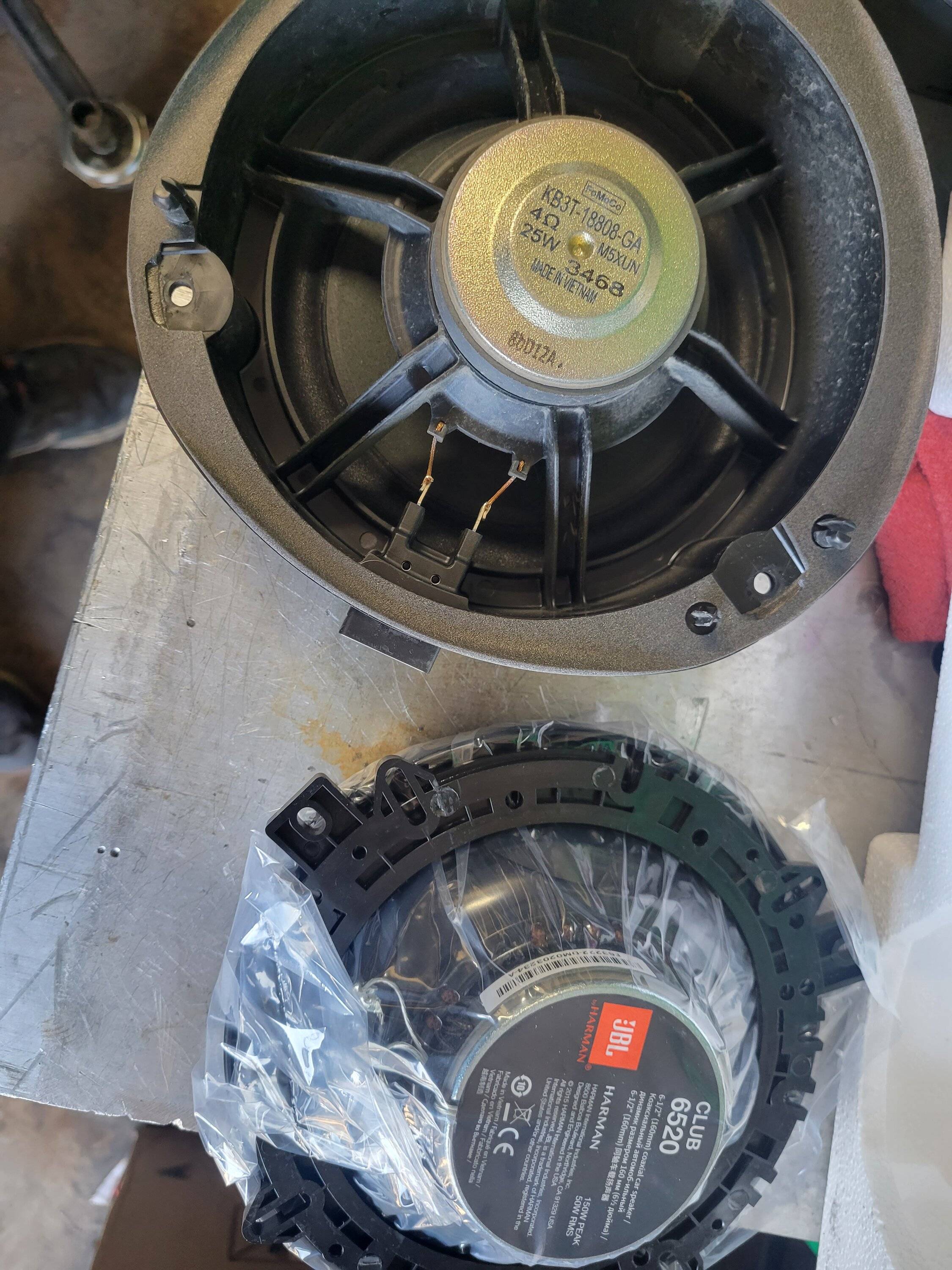

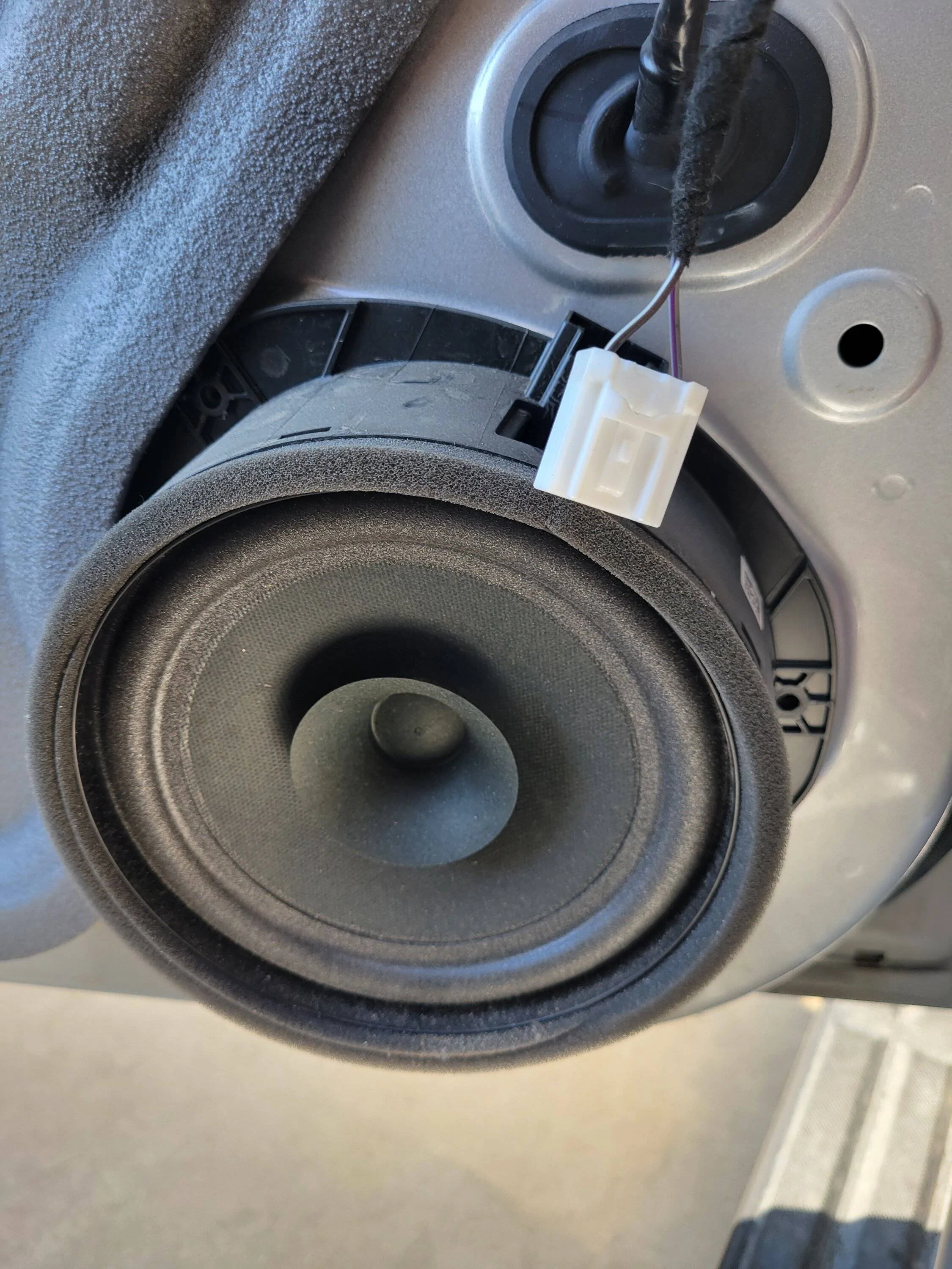

Had a tad bit of daylight still so threw on some jbl club520 speakers i was gifted from work. Not a crazy difference but it does sound better.

@TerraMechE playing devils advocate do you remember what changes you had to do to axle shafts between both m190?

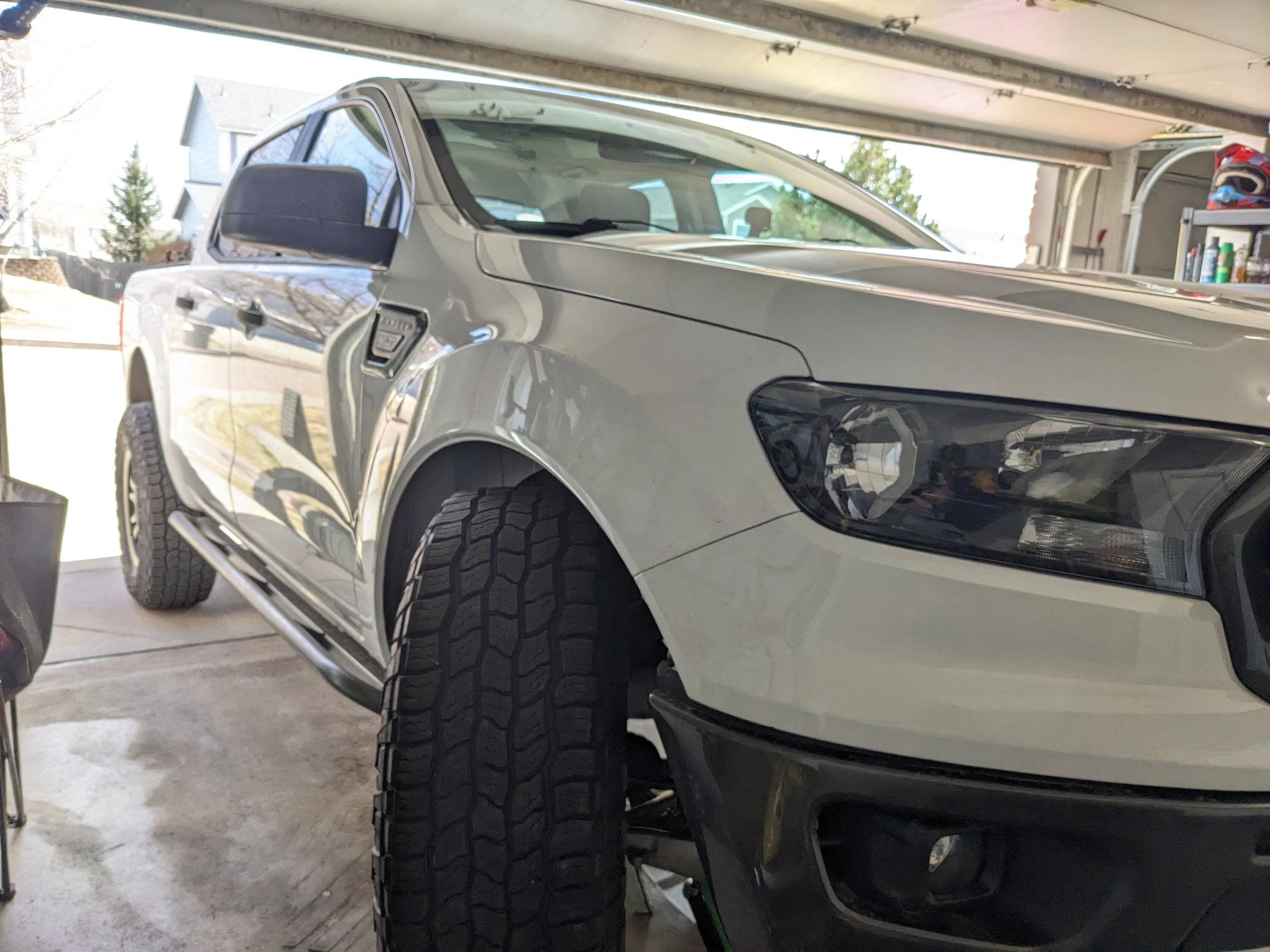

Dude that’s pretty sick!! I’ve always wondered if the bronco control arm would bolt up to the ranger!!! That’s nice to know. I just cut my fenders this weekend as well!! Might have to start looking for some bronco control arms for a little wider stance until I go all out on long travel!!

That’s pretty sick man!!! Anymore travel out of it? You still using ranger upper control arm? What other benefits by swapping that out?
With eibach pro shocks and icon uppers i got 9 inches of travel with this new set up i am at 11 inches of travel. Benefits more abundant shock choices i was originally going to run 2019 f150 shocks theyre same length as bronco and bolt in too just needed to use ranger top hat. Im at lift height i want without being heavily preloaded to achive that height. This also saves the shocks from possible over extension.
