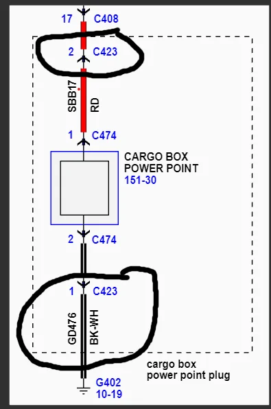

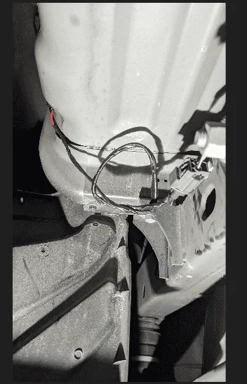

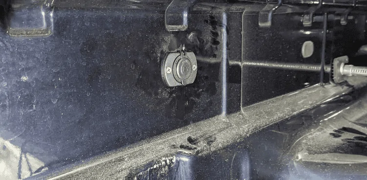

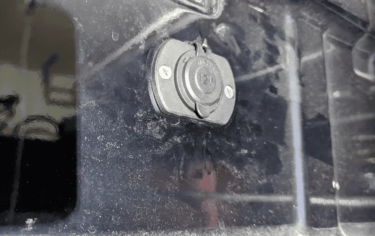

Installed a 12V plug in the bed. I used a ford male connector and a $8 12v plug from amazon. I had to Dremel the hole slightly bigger to get it to fit and I used some right angle spade connectors on the back otherwise it would hit the inner fender. I was originally going to use the top square hole but it wasn't deep enough, I still might move it to a lower position but my hole saws are at work. The pig tail cost me $25 with my employee discount and the out let was $8 on amazon. link for the plug https://a.co/d/dIMqtO3 I also attached the wiring diagram for the plug C243 is the connector under the truck and the connector that is needed.

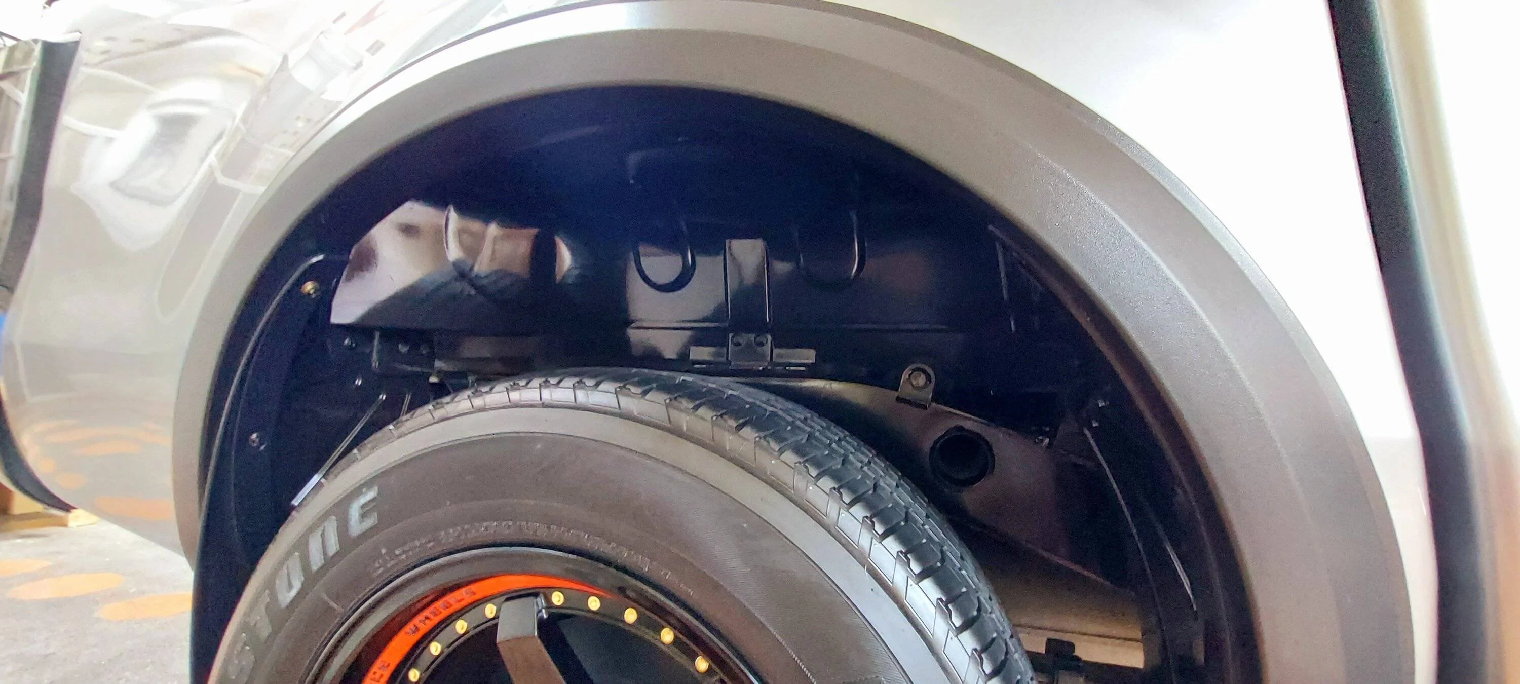

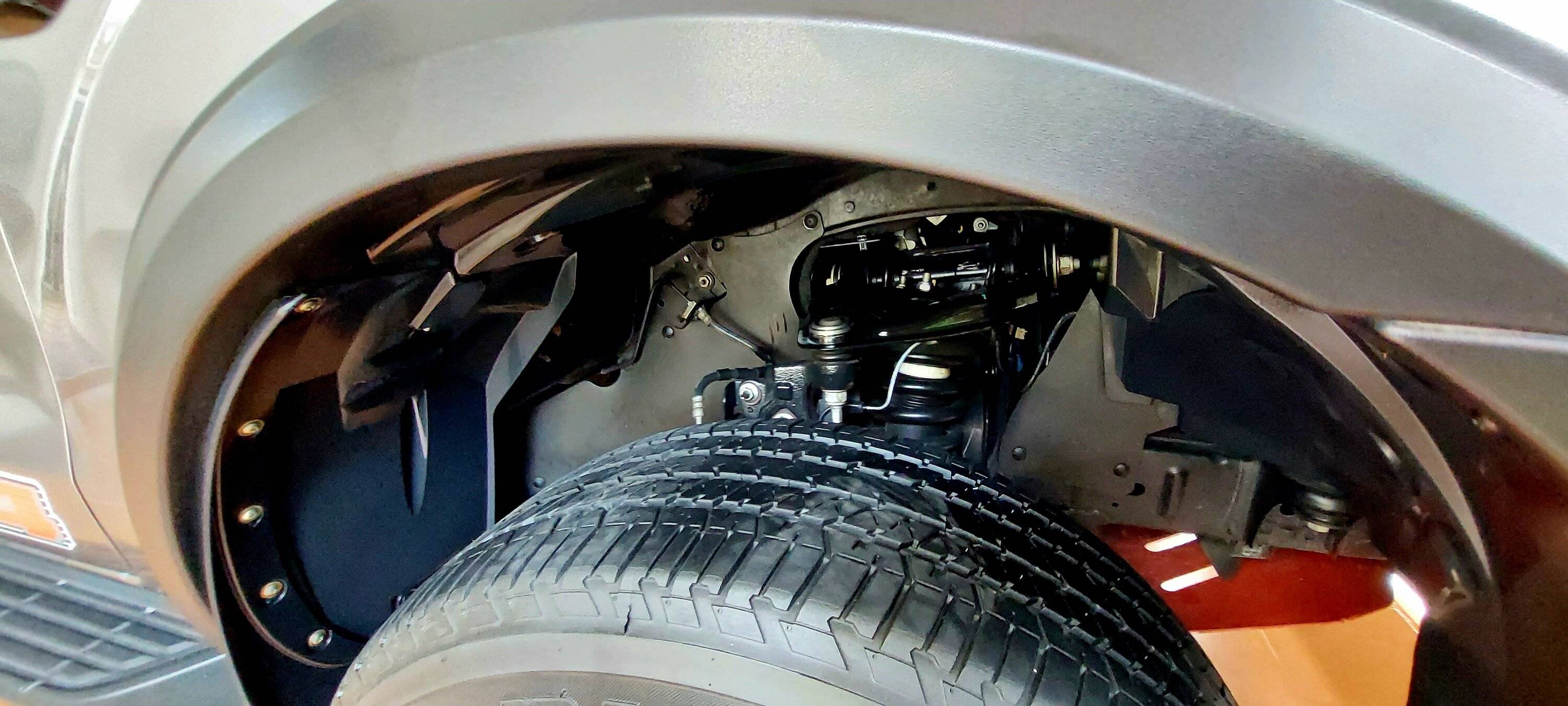

I gave it a very thorough wipe down and cleaning everywhere. The wheelwells, suspension, under the hood, and of course body. As I am getting my 2nd oil change tomorrow. They do a thorough inspection on intake. So if all clean makes it easier to see I have no scratches, or damage.

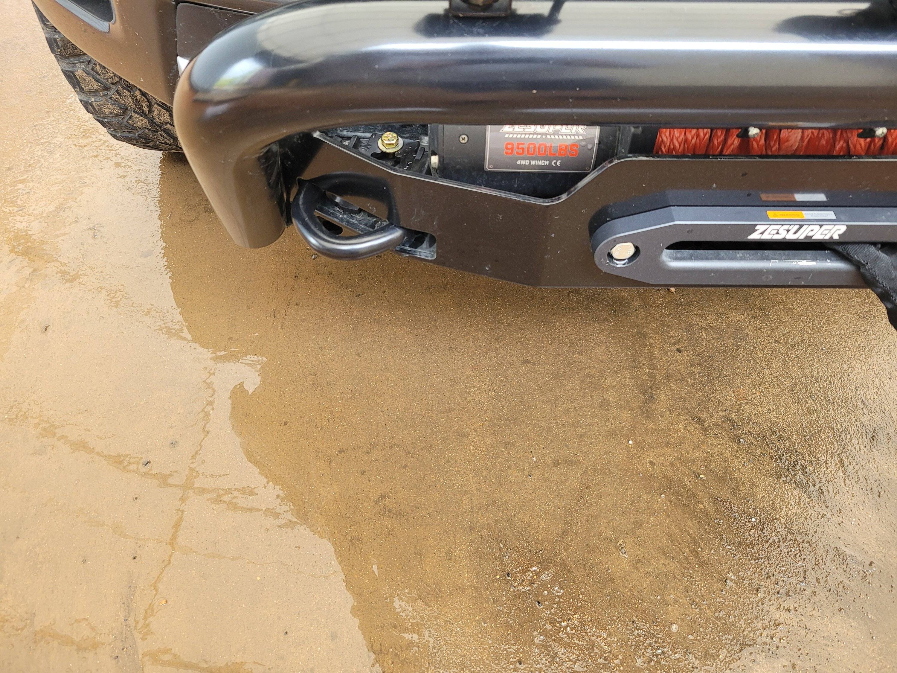

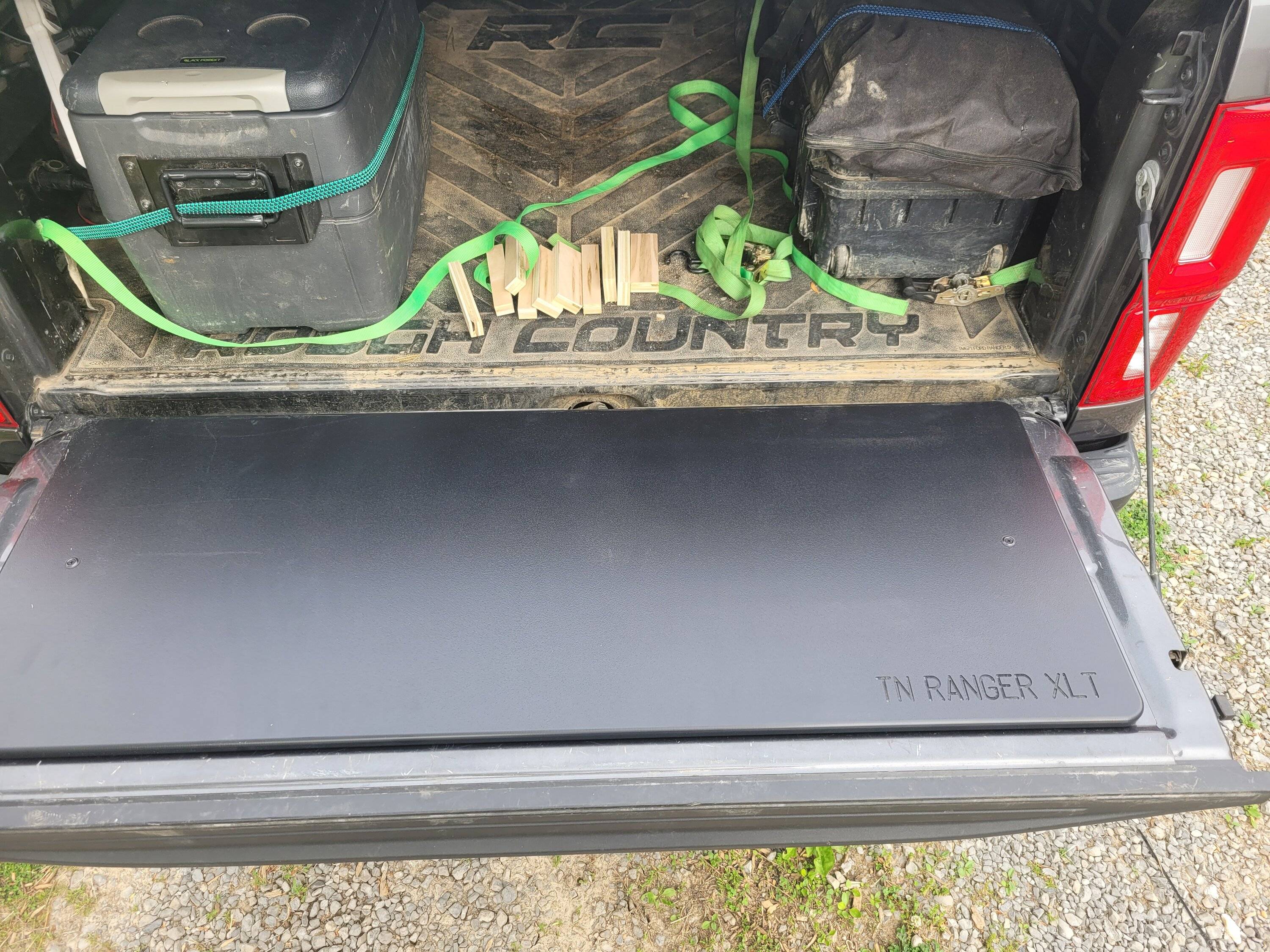

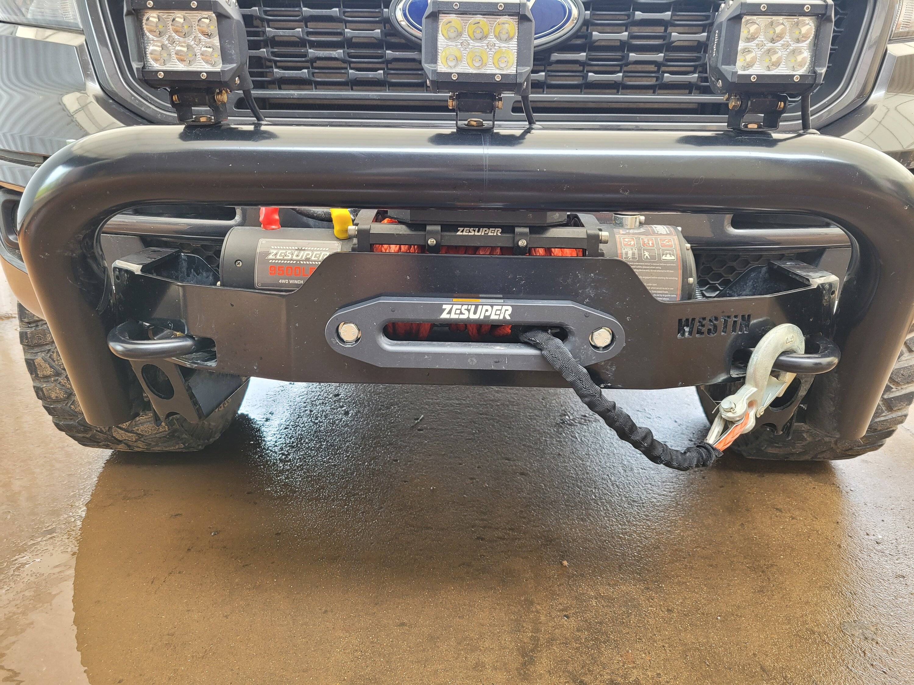

Electricain

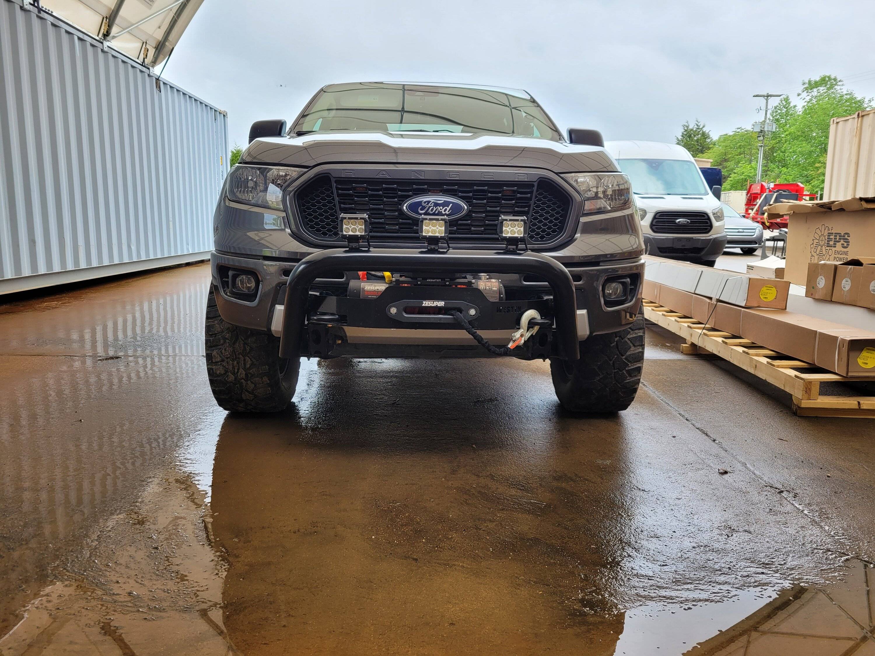

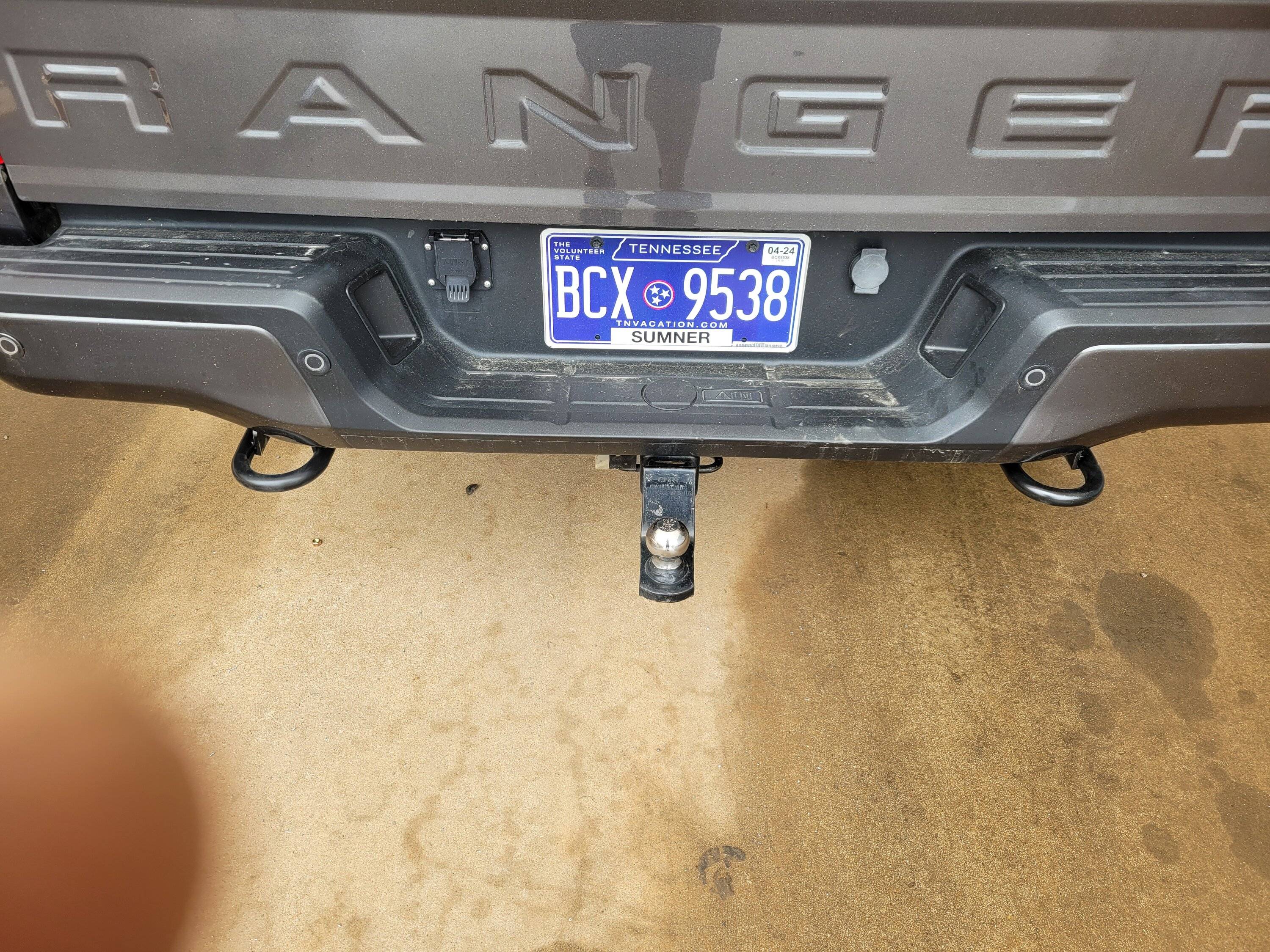

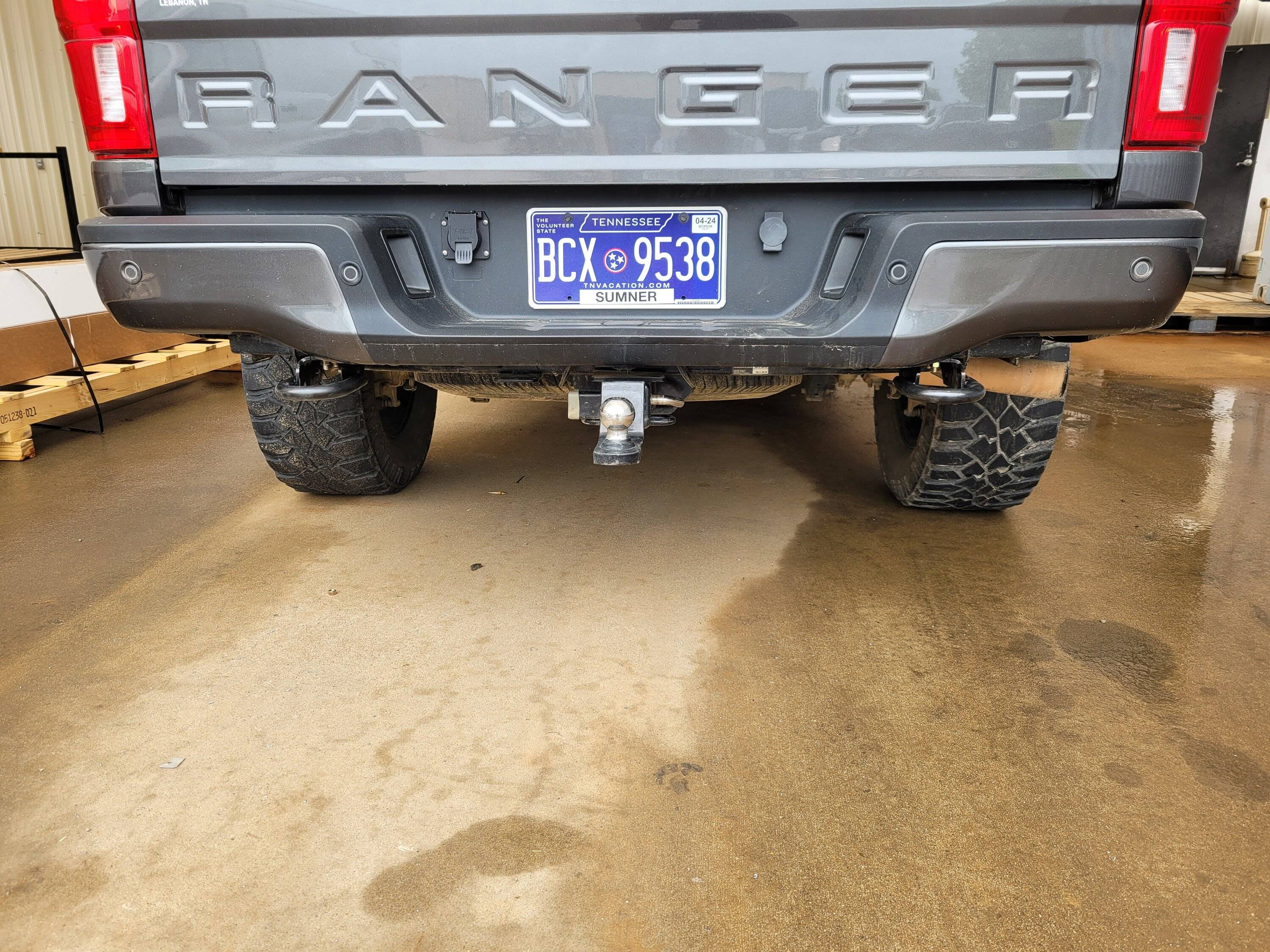

So when I got my Westin winch tray I add the RC tow hook conversation to the bottom of the tray. Liked it bout was not too happy about the overhang. So I decided to modify the factory ones and istall them in the spaces provided for the tray. Also found some tow hooks from a F350 laying around so bolted them to the rear bumper supports for some rear recovery points. Found some cutting board material and cut me a tailgate table as well.
