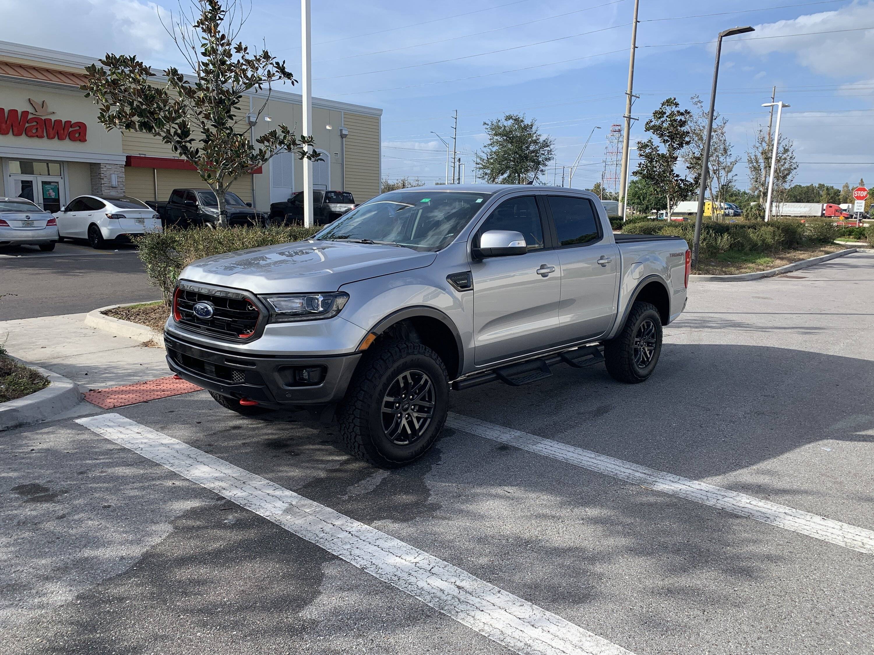

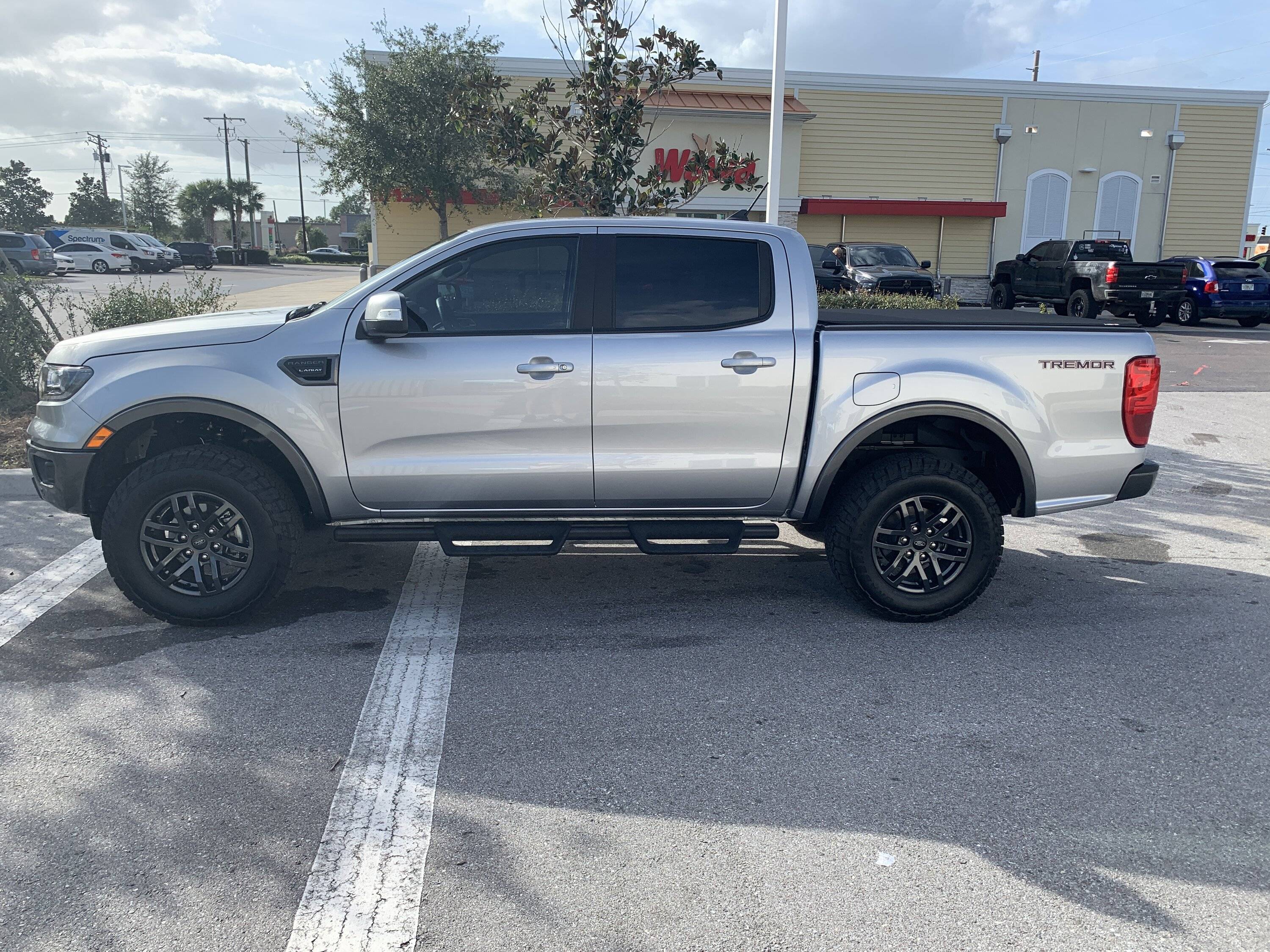

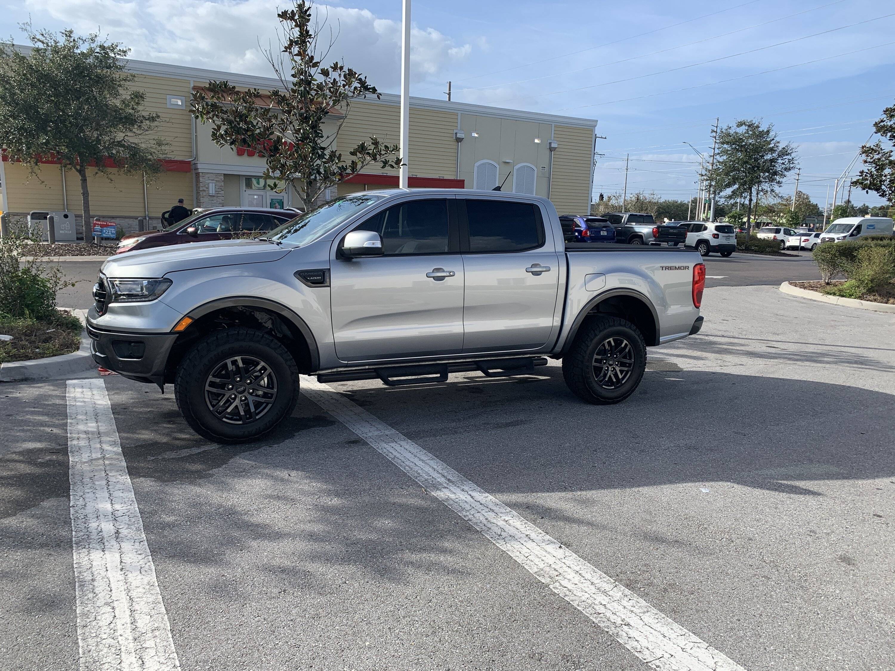

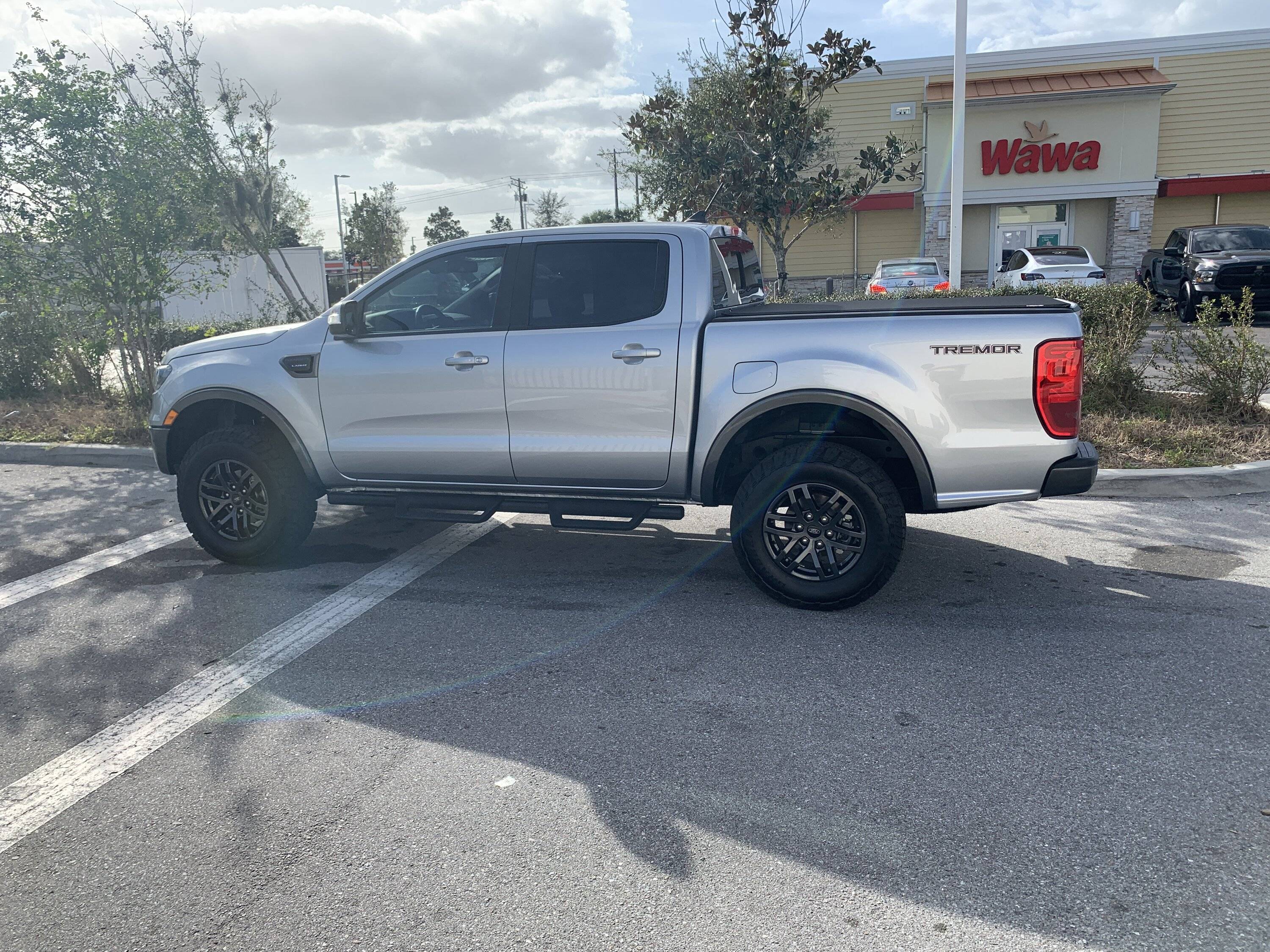

I installed a ¾” level kit today. I got a Zone 2” level kit $60 (made by BDS). It is a 2-piece kit with a 3/8” above the strut spacer and a spring compression spacer.
2" Leveling Kit | 2019-2021 Ford Ranger 4WD – Zone Offroad
It took about 2 hours (the frustrating part was getting the upper control arm and sway bar link tight enough to torque without the shaft spinning as I did not have a metric hex for the sway bar link). I actually like this spacer better because it has a provision for the locator pin. I know it shouldn’t but I think it rides different a bit firmer (different weight distribution maybe?) it’s probably just my perception.
The 3/8” spacer gave me an exact ¾” lift.
I have been on the fence with a leveling kit since I bought the truck as I felt it sits right and rides right and I swore I would leave this truck the hell alone but the devil made me do it… I am not sure if I will keep it, try a ½” from Ebay or remove it yet before I go to the expense of alignment.
Yeah I am that flakey and have commitment issues LOL
Ohh and I washed her today, I got it back from the windshield recall work and the Dealer had washed it but they put that black shit on the tires that flings everywhere (in the wheel wells and down the side of the truck) what a mess…
LB
Edit; ok I just went out to the garage to look at it, I think I will keep it :D
What size and brand tires do you have on those rims? I just ordered those rims for my Ranger. Thanks,
