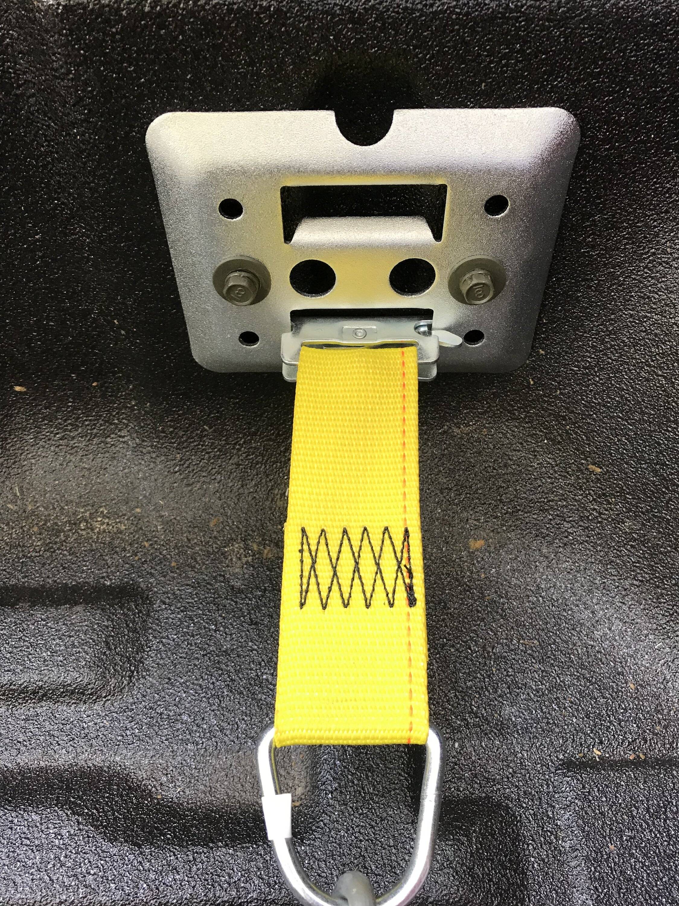

Added an E-Track tie down from Harbor Freight. Almost perfect fit for the factory tie down in the bed behind the wheel well.
Nice idea! I like that. Any chance you could snap a picture a few feet away or of the whole bed? I'd like to see the overall look. I know, they're only $6 and I could get one and try it out but I don't have a HF close to me.

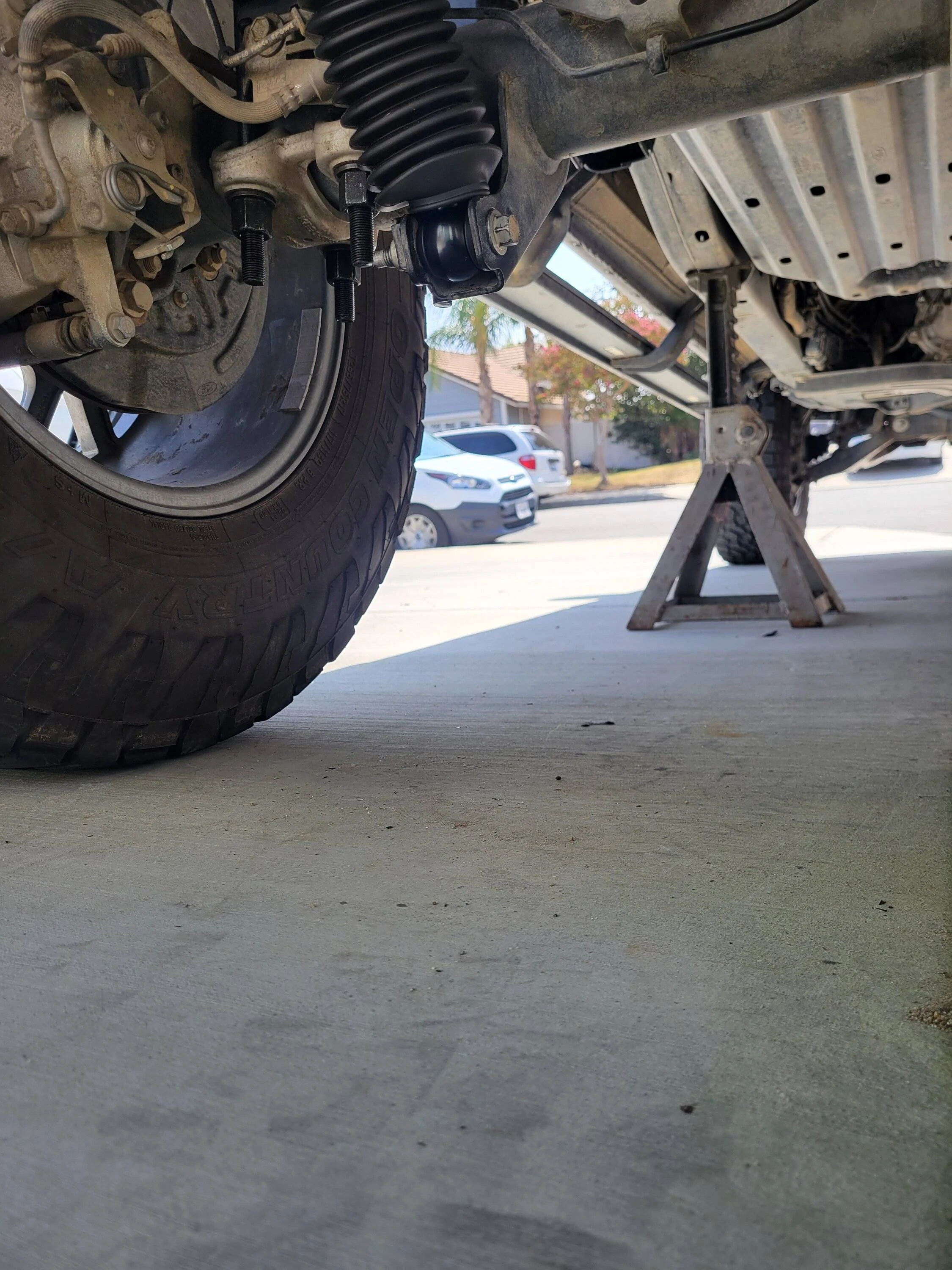

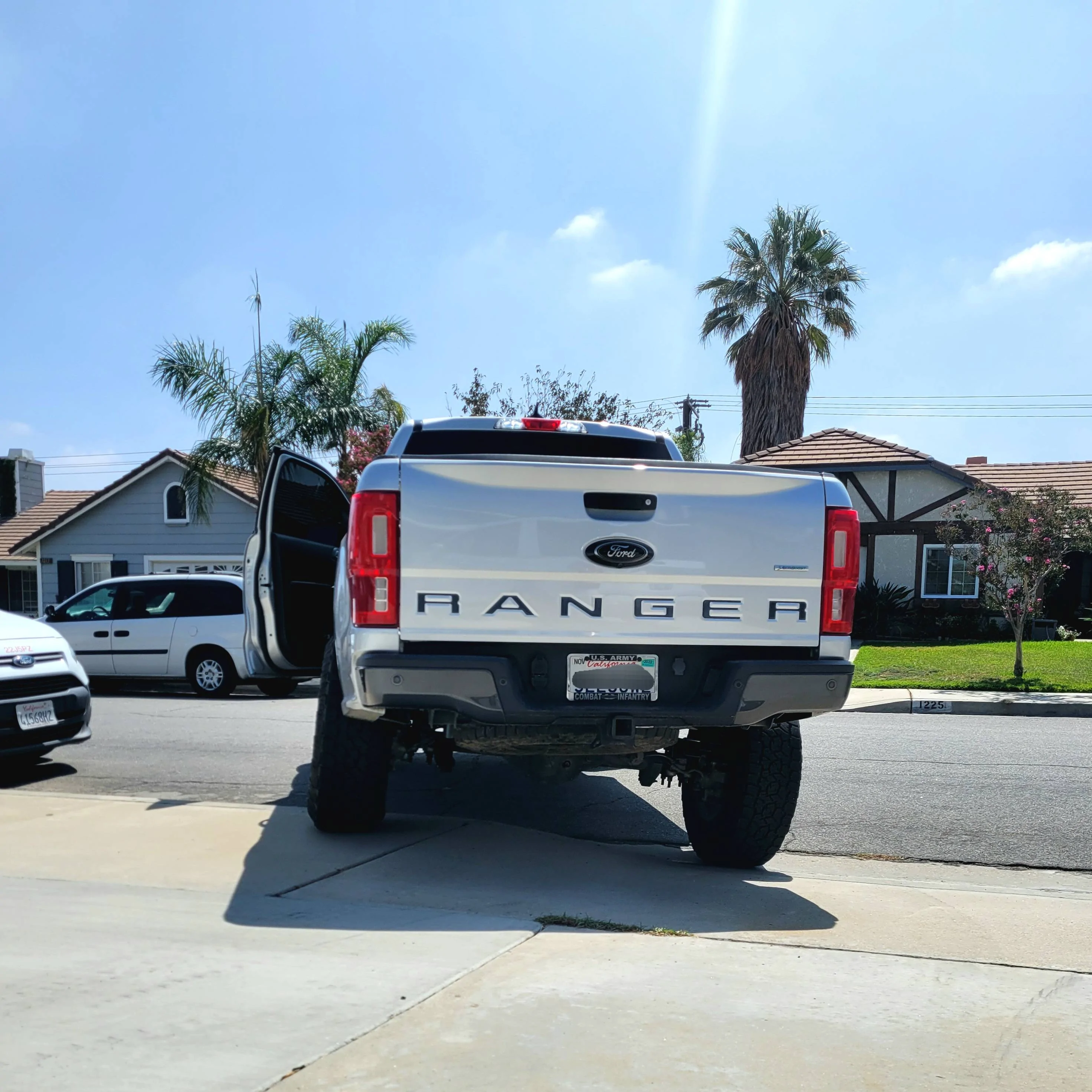

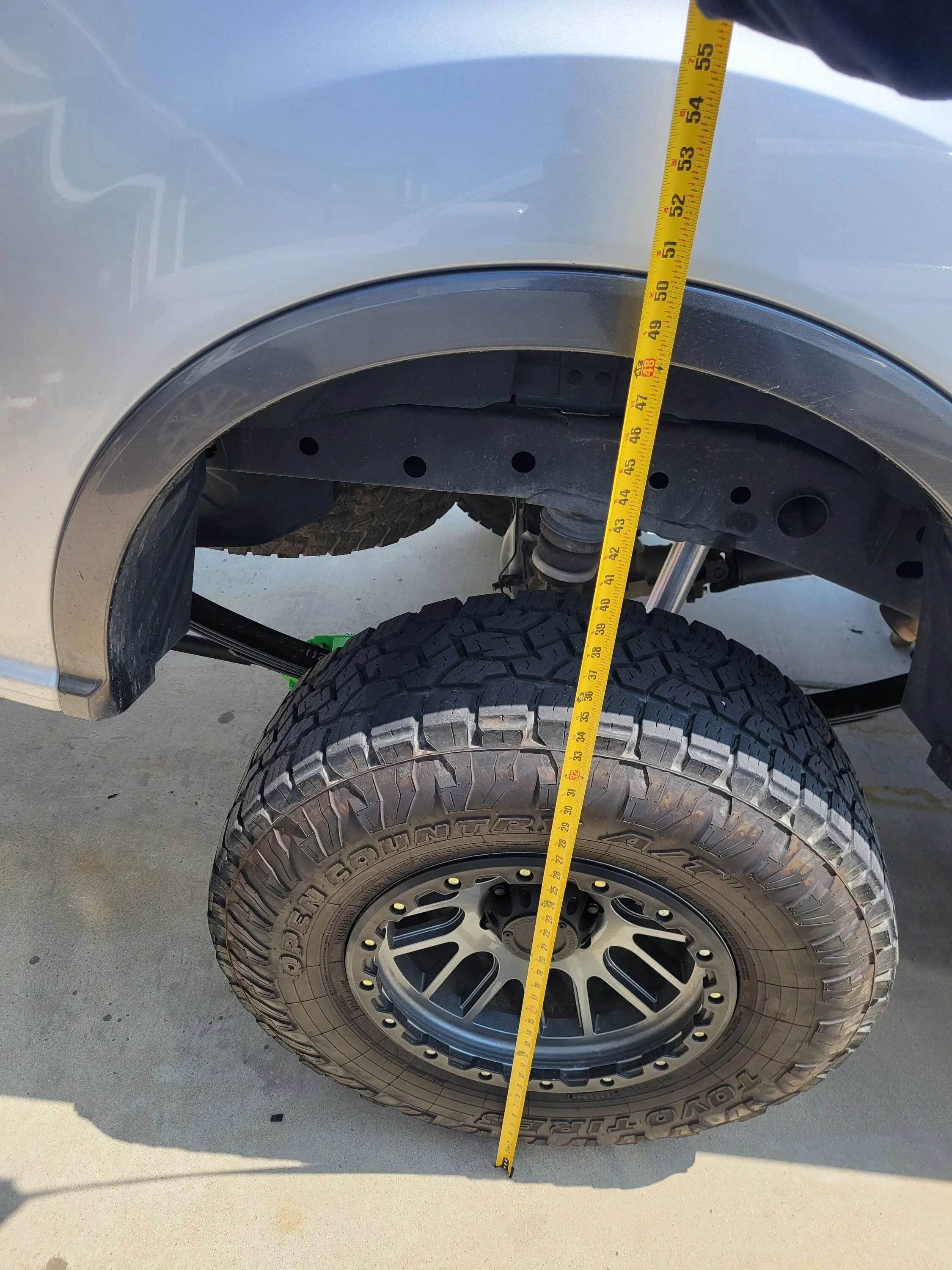

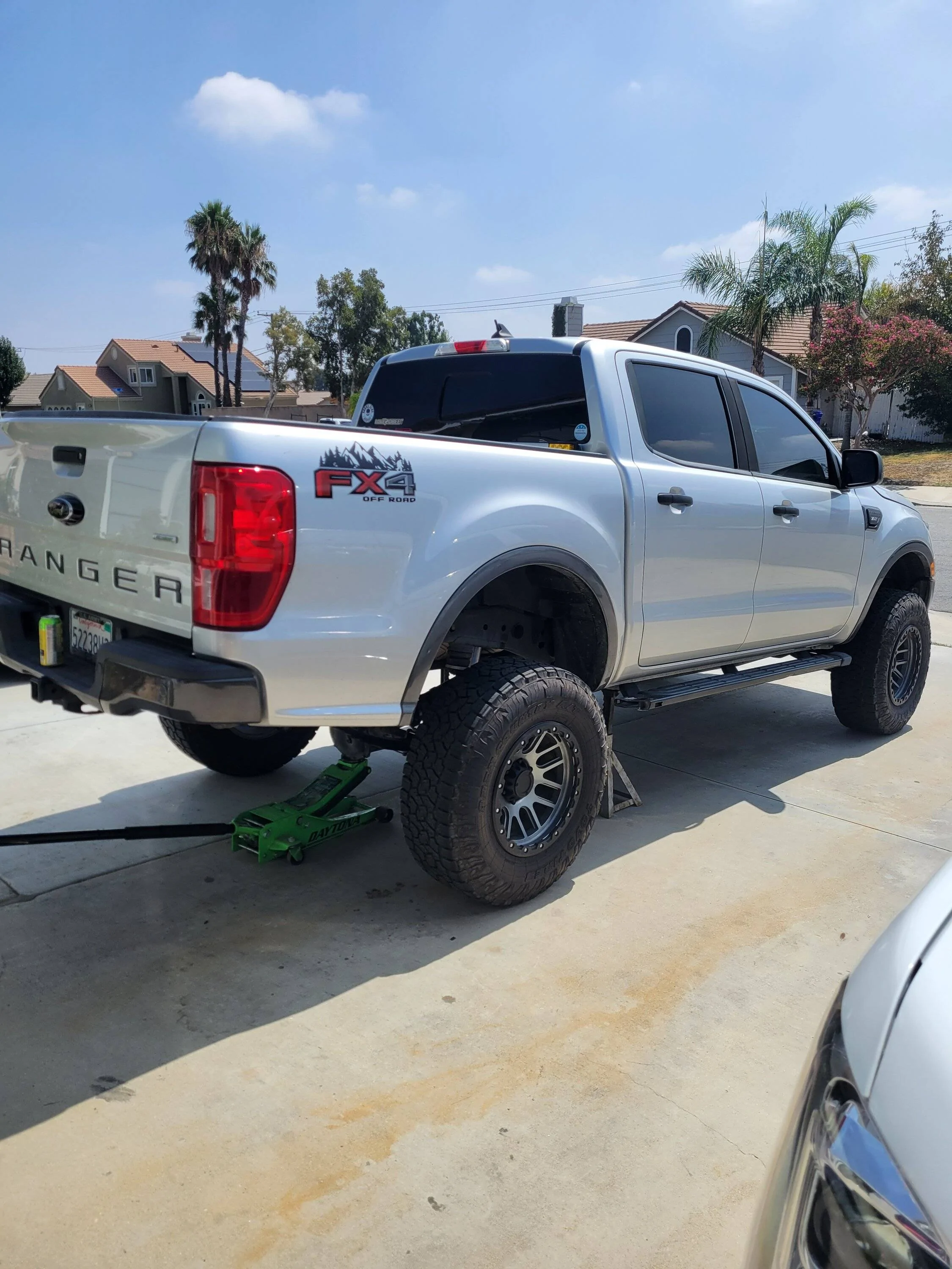

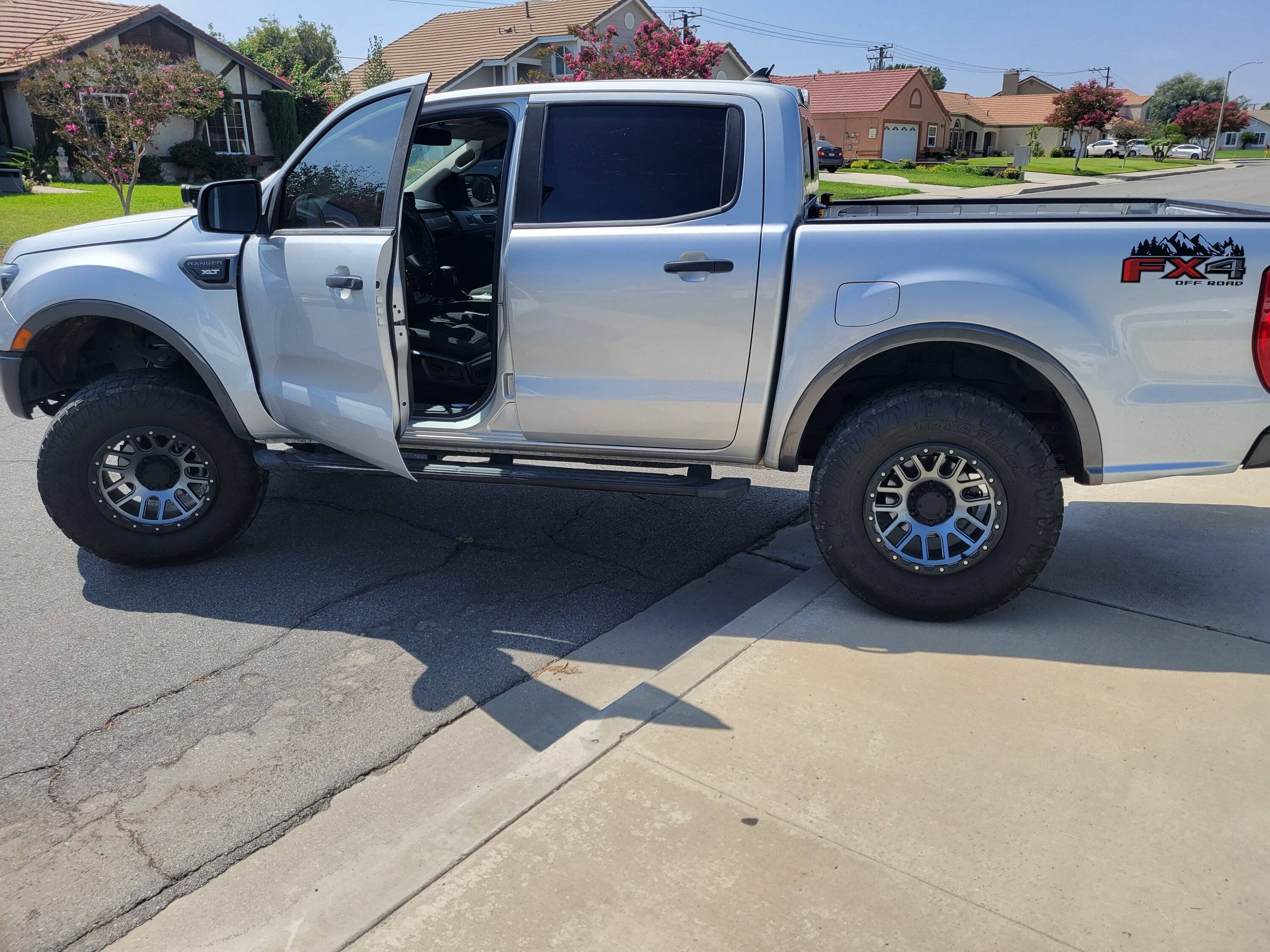

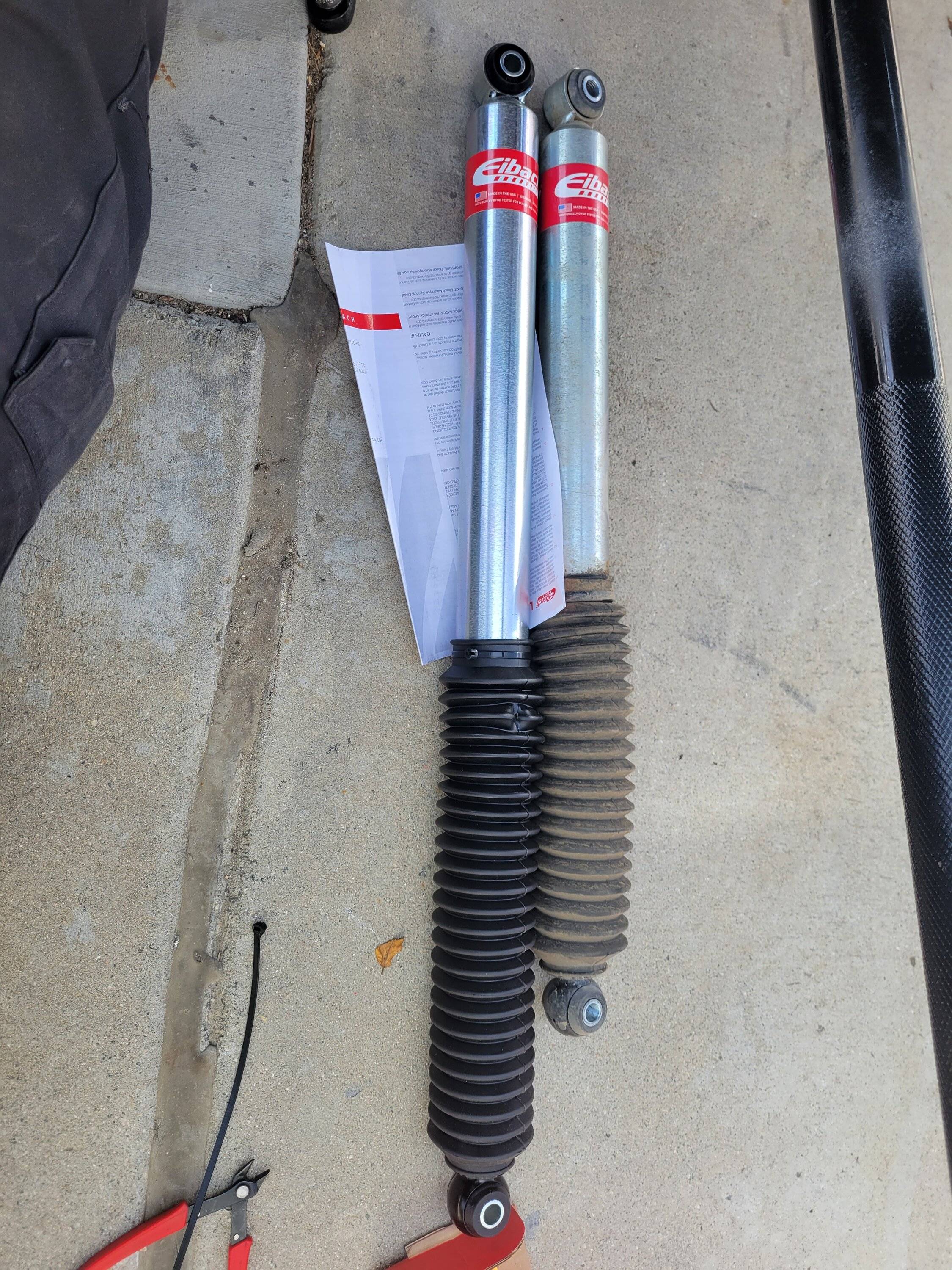

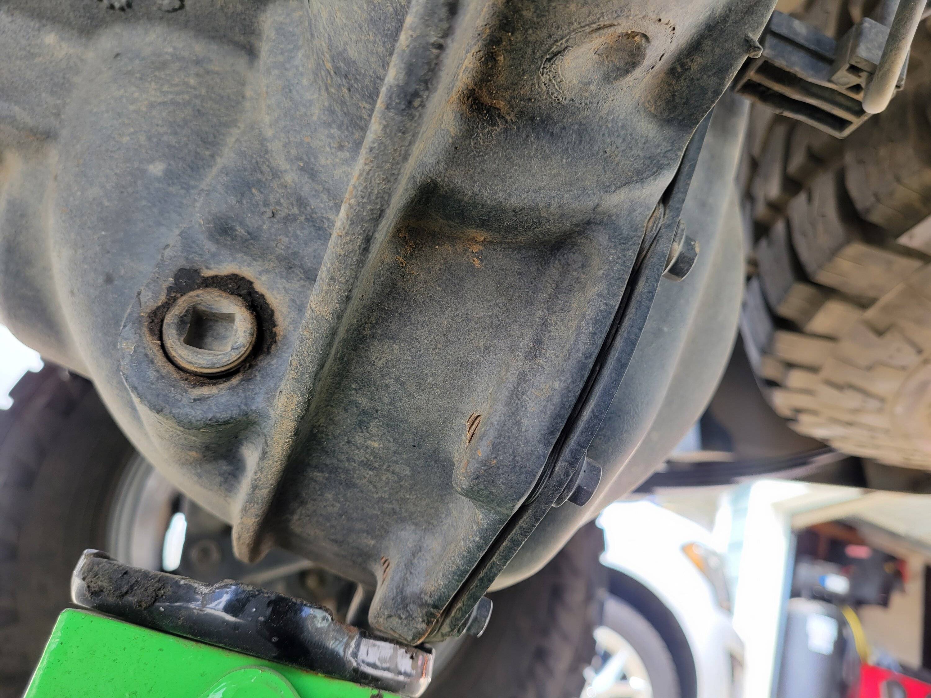

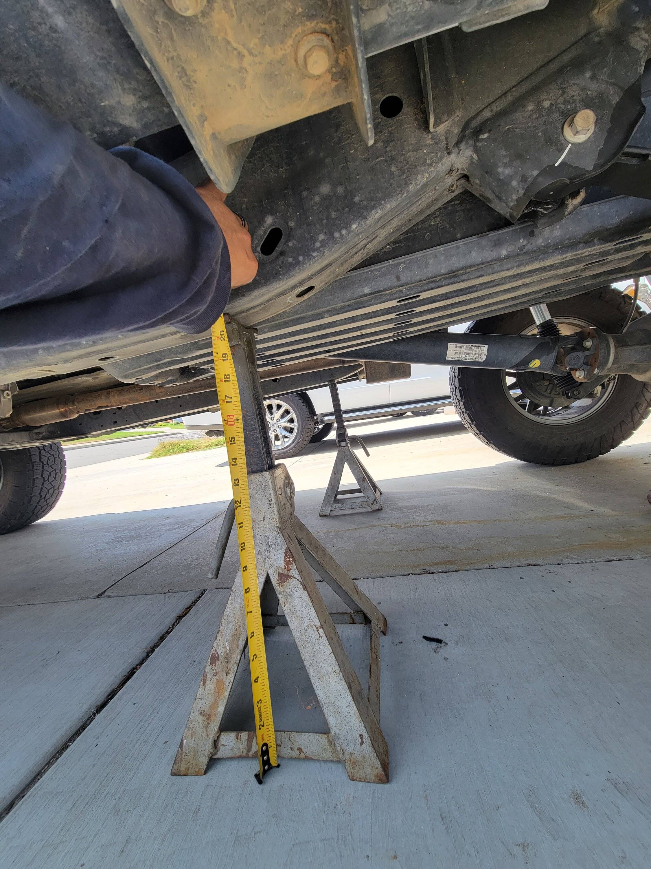

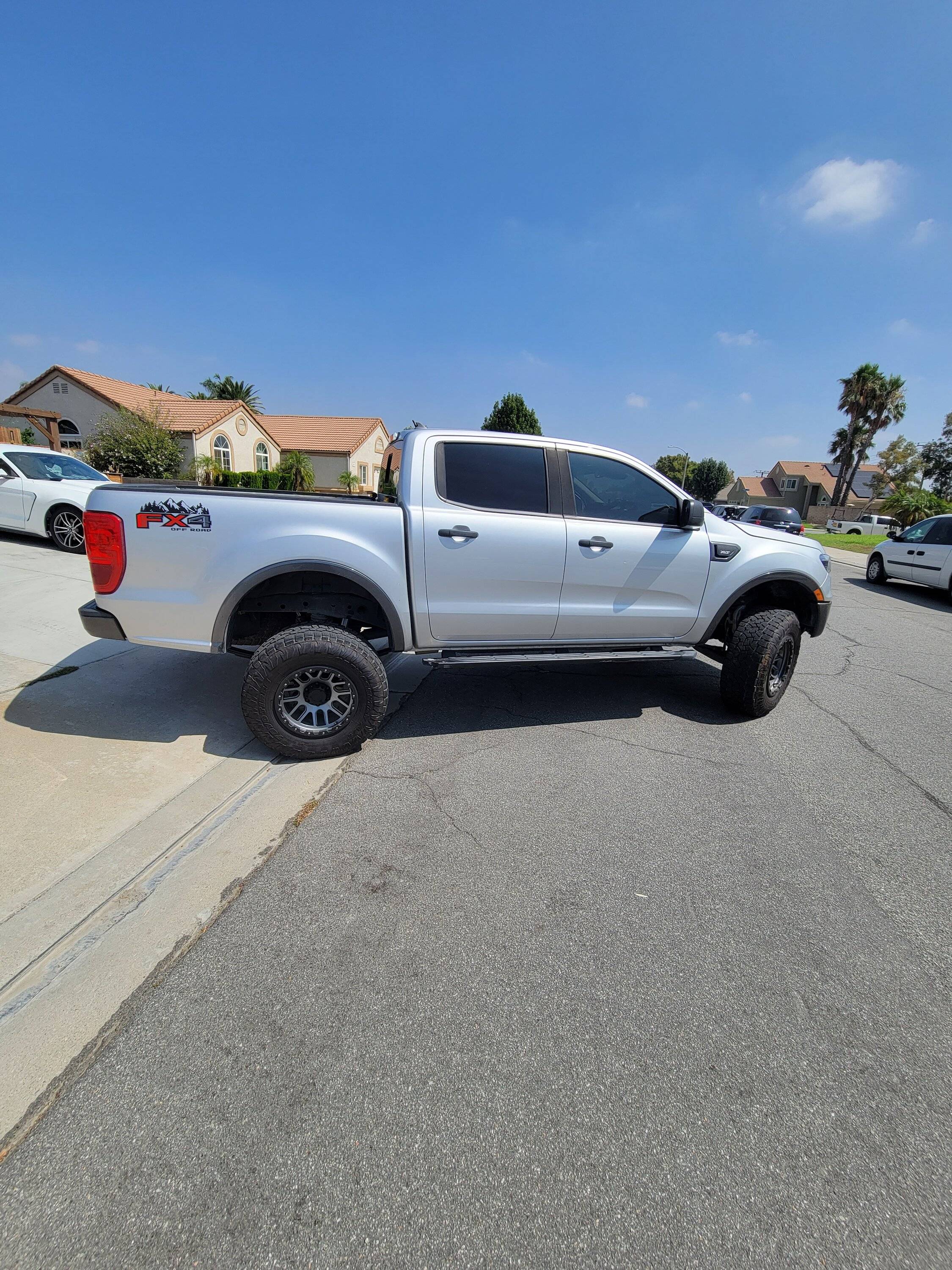

@Colo_Ranger @Rhino installed the f150 shocks. I definitely will need limiting straps for any hard wheeling. I can have the jacks at 21 inches from ground to frame and I'm still firmly planted. from ground to bottom wheel arch 48.25 inches from bump stop to top of leafs 10 inches. ride feels smooth I have a few more inches of travel but I can't due to brake lines, parking brake lines, and wheel speed sensor lines. Also someone on here said the axle doesn't have a drain plug which it does.
