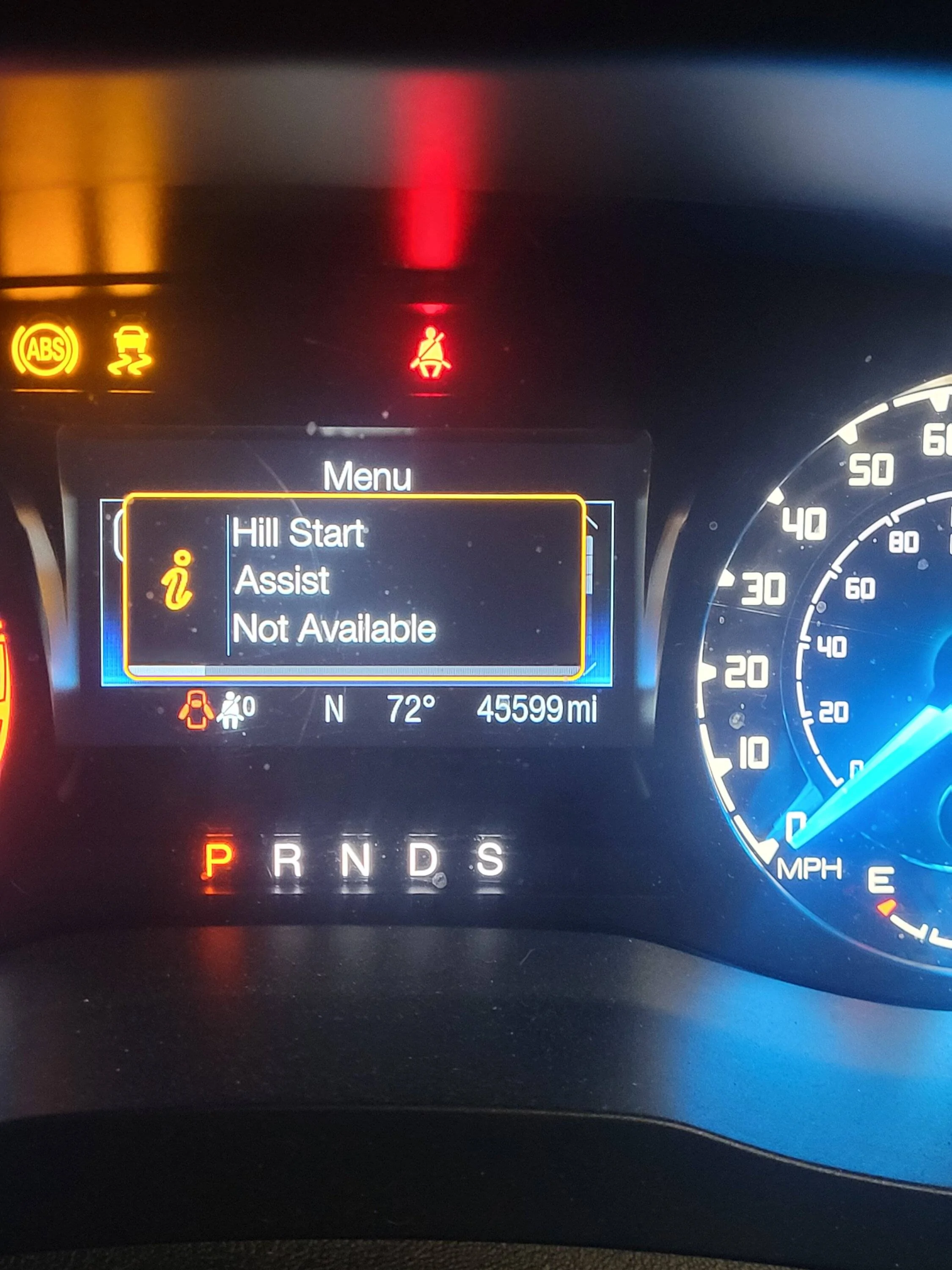

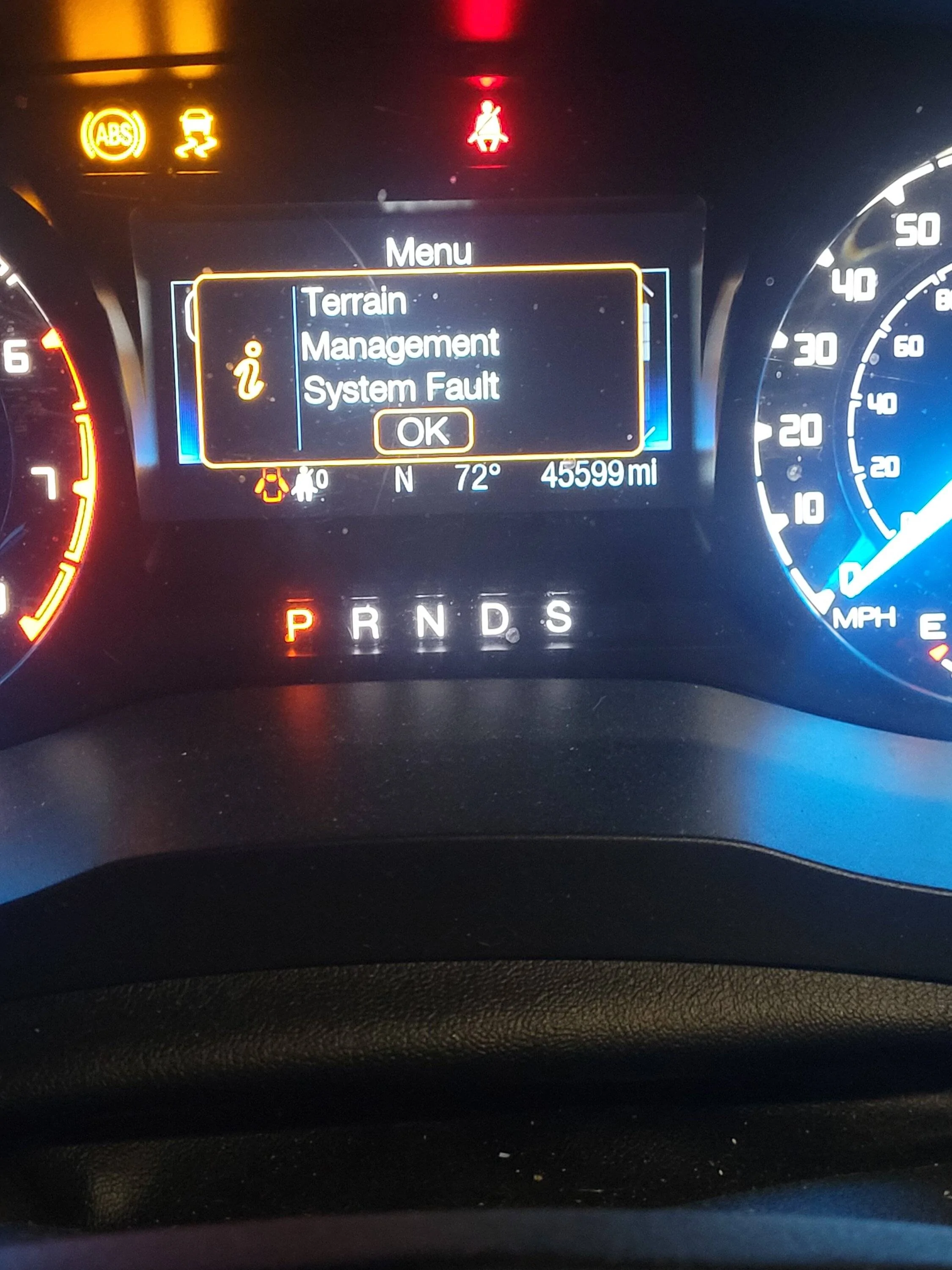

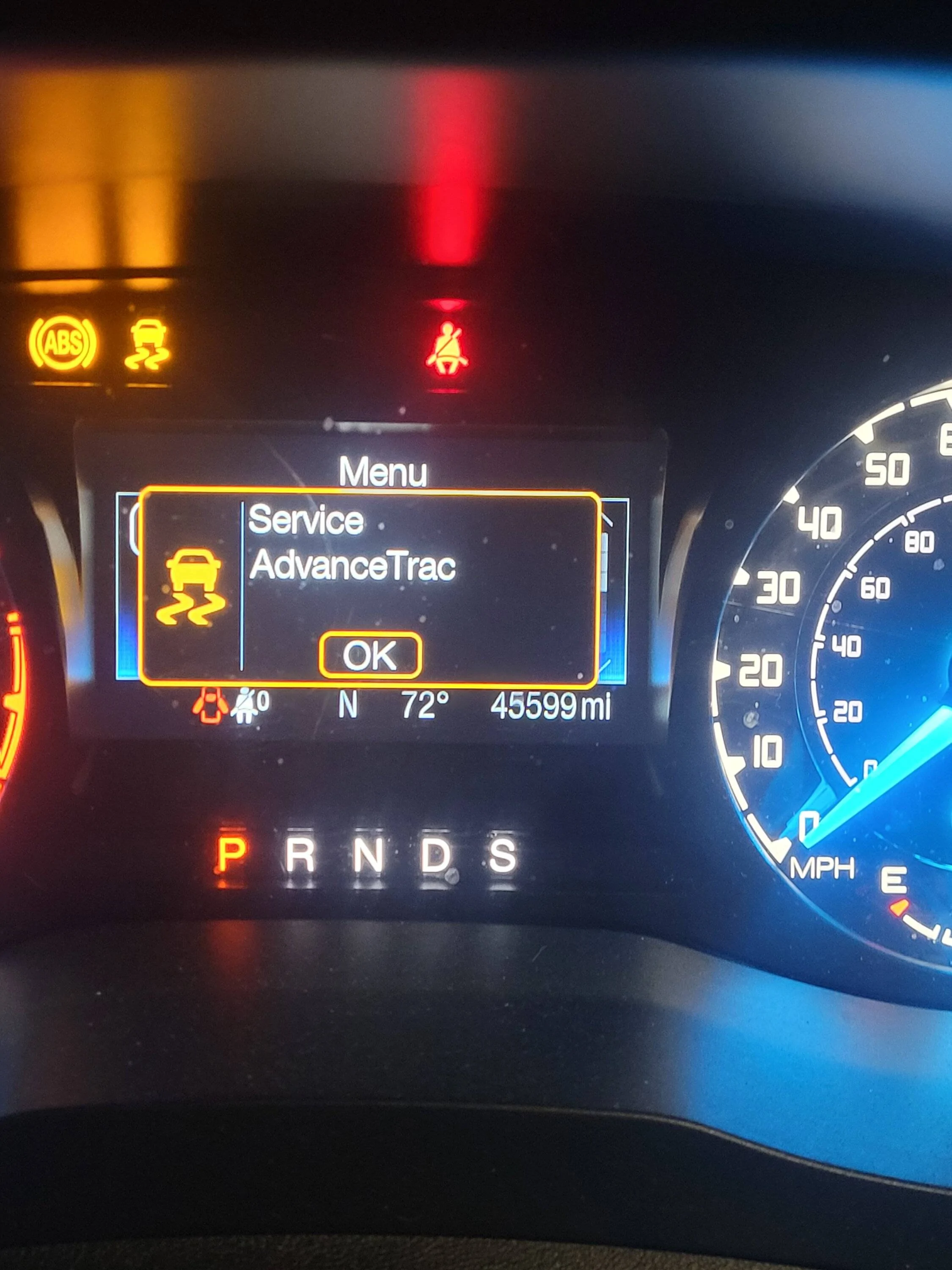

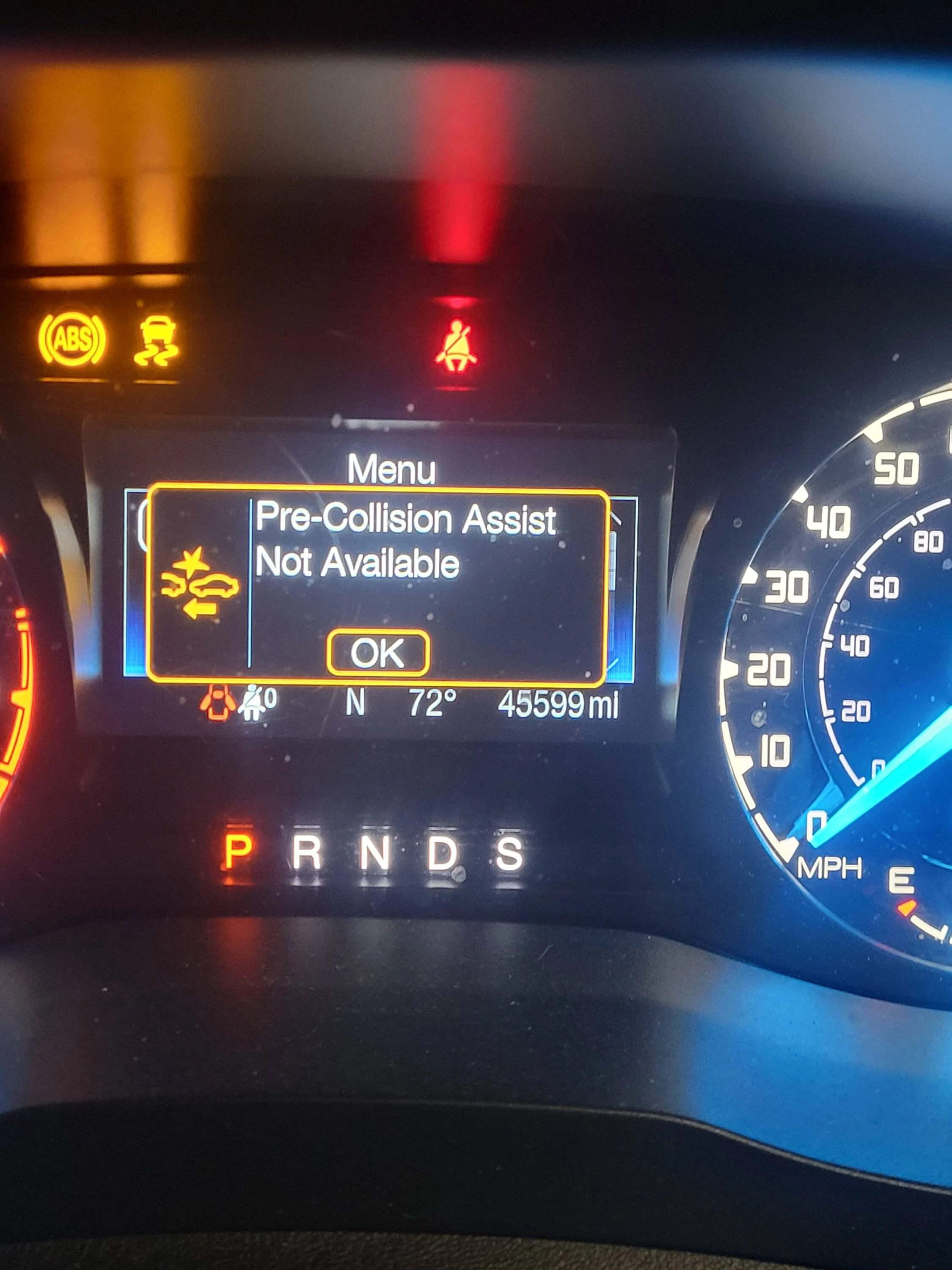

well I did a little oops lmao. fuck I'll trouble shoot tomorrow but if anyone has any pointers on where I should look first would be of some help. short story long I caught some major air and set of the dash like a afghan jingle truck or Christmas tree lmao. advance trak is saying there's a fault, hill assist fault, pre collision fault, terrain management fault. I'm almost willing to bet it has to do with front half shafts maybe one popped out slightly but what I don't understand is why would it set off other error codes. maybe i do need to do the differential drop sooner than later. o and I have an abs light on too which may be from over stretching rear.

My guess is that you have an issue with one of the wheel speed sensors. All those faulted systems rely on input from your wheel speed sensors. Check and see if you’ve still got 4x4 or if it defaults to 2wd. I think the bronco will do that if it loses a wheel speed sensor (not 100% sure about that.)

I'm stuck on 2wd no 4wd. my guess is that too or popping am axle out. I'm going to check fuses too. visibly I don't see any wires pinched nor stretched but I did accidentally catch some air with it ?. thank you for input

so I checked real quick with a meter and all my fuses are good both under dash and under hood. although I had a weird reading on fuse 32 under dash it was negative ohms for a moment and fuse 33 had a high ohms as well when I went to re check and replace they were reading fine go figure

Good luck! This guy has similar issues due to abs sensor:

nice I will look at that tomorrow morning. I may have pinched the lines on either driver or passenger when I caught some gnarly air or I could have over extended the rear ones but I would have expected the brake lines to go with. Again thank you so much.
