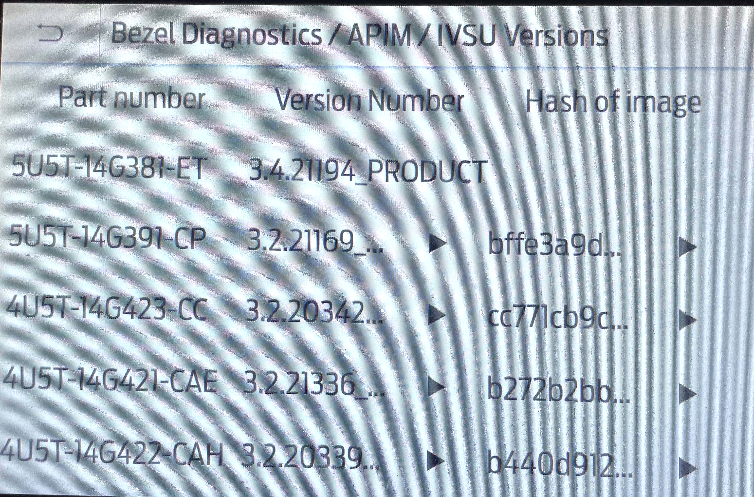

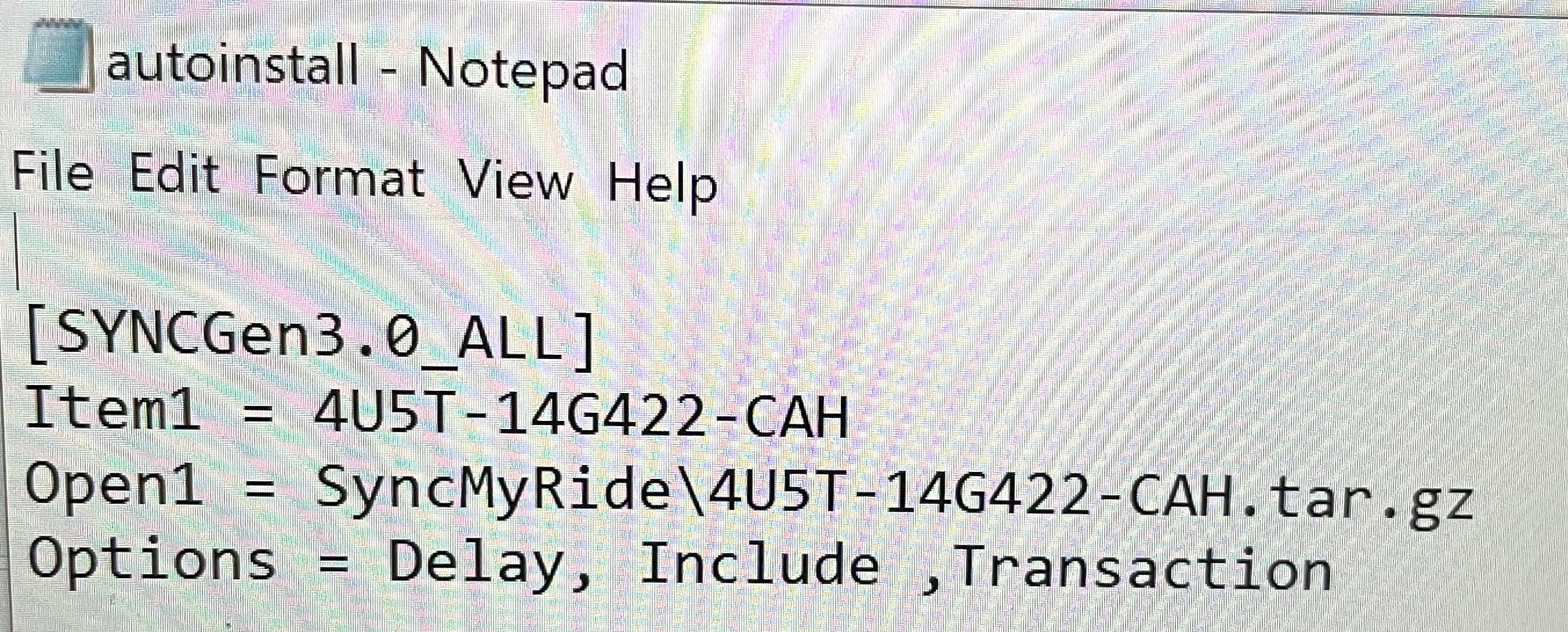

I think I'm there...
I downloaded the 424 package UofM linked to earlier in this thread (post 89).
I put that in the SyncMy Ride folder (discarding all of the other update files).
I opened the autoinstall file using notepad, modified it as shown in the picture, and then saved it (this did not change the file extension).
Then I pluged in the USB and it went to updating system software almost immediately. 20 minutes (roughly) later it popped up with a screen saying everything went fine, restart, yada yada, and I had to dismiss it.
Crap, the IVSU screen did not show any change.
I did a Soft Reset (thanks Rp930). The IVSU screen is shown in the 2nd picture....:)
Not there yet...the system does not list any navigation commands. I wonder if a master rest would fix this??
