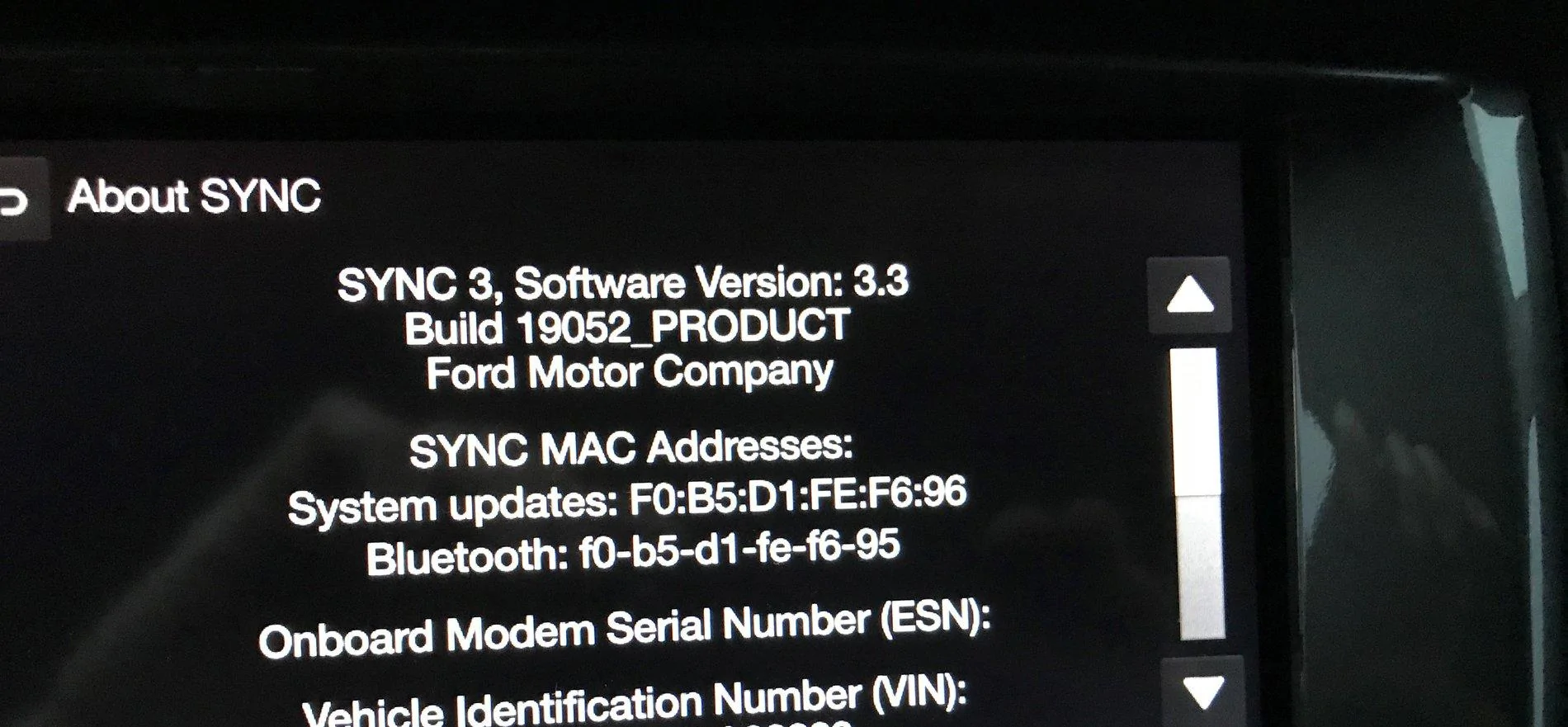

Mine still isn't working - try every other day...waiting for a miracle to happen. It worked last on Jan 3rd! Will have the dealer look at it on my next oil change.
I THINK my problem (according to FordPass Support) is that I'm not able to turn on (center dash menu) "Connectivity Settings" under "Settings" > "FordPass Connect" I get an error saying it could not connect and to report to my dealer if the problem persists.
Can someone check who's FordPass app works if the can get to the "Connectivity Setting" through the center dash menu. Would appreciate that.

If your Sync head unit will not turn on and connect in the “connectivity settings” then Ford Pass will not work. That setting is required for Ford Pass to function. Sounds like you may actually have a bad modem that will need replacing.
Factory reset your stereo through the settings and then check the setting again. If it still wont turn on and connect then it needs to go to service.
Thanks for the info. So maybe FordPass support DID know what they were talking about. I'll try the factory reset.
Tried the reset again but still cannot turn on the "connectivity setting". Notice that my modem does not have a serial number - maybe my modem IS the problem. About due for an oil change and will have the dealer check it out at that time
