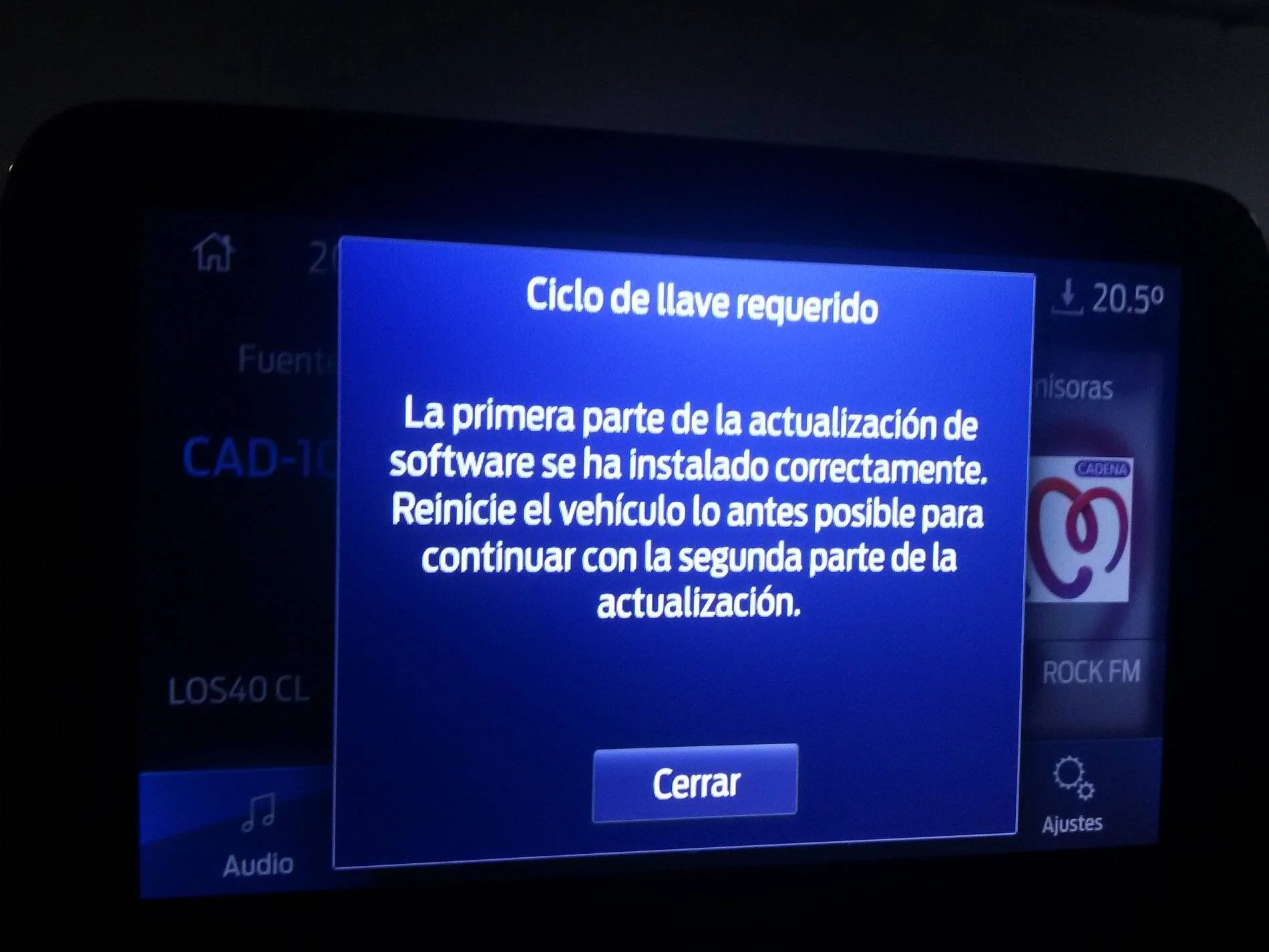

If it went through the map update completely and they still don't work, then it could be that the images didn't mount post update. A master reset will get it going. Not sure if you / the dealer tried that?
SYNC will restart itself as needed. Leave the vehicle alone until it gets through all of the self restarts and that pop-up message sticks on screen. As in it has sat there for 30 seconds to a minute just to be safe. The update can take a while. Normally it's been 50ish minutes for me, but some have reported longer times depending on USB drives.
Hello,
I'm writting from Madrid (Spain) just to thank you all (especially UofMEngineer) for finding solution to the problem: navigation commands do not work after map update. Root cause: map install shows a pop-up asking for key cycle but actually installation has not finished yet. Solution: "Leave the vehicle alone until it gets through all of the self restarts and that pop-up message sticks on screen". The same screen is shown several times but only once it has finished, it sticks permanently on screen. For my Ford Focus (2018 model) FULL maps update took 1 hour and 53 minutes. In mi case no need to restart any setup.
Thanks for making me so happy as I was very dissapointed/angry because I had lost navigation commands while trying to update maps.
I have attached key cycle spanish screen.
Some explananation on spanish so they can find also solution, as I didn't find solution in Google in spanish.
Si te han dejado de funcionar los comandos de búsqueda por voz de sync para Ford después de actualizar los mapas, el problema es debido a que se muestran varias veces la misma pantalla solicitando que se haga un ciclo de llave completo pero es falso; la solución: hay que esperar hasta que el mensaje se muestra de forma permanente (no se reinicia sólo). El proceso en mi Ford Focus modelo 2018 tardó 1 hora y 53 minutos, pero después se solucionó sin tener que hacer nada más.

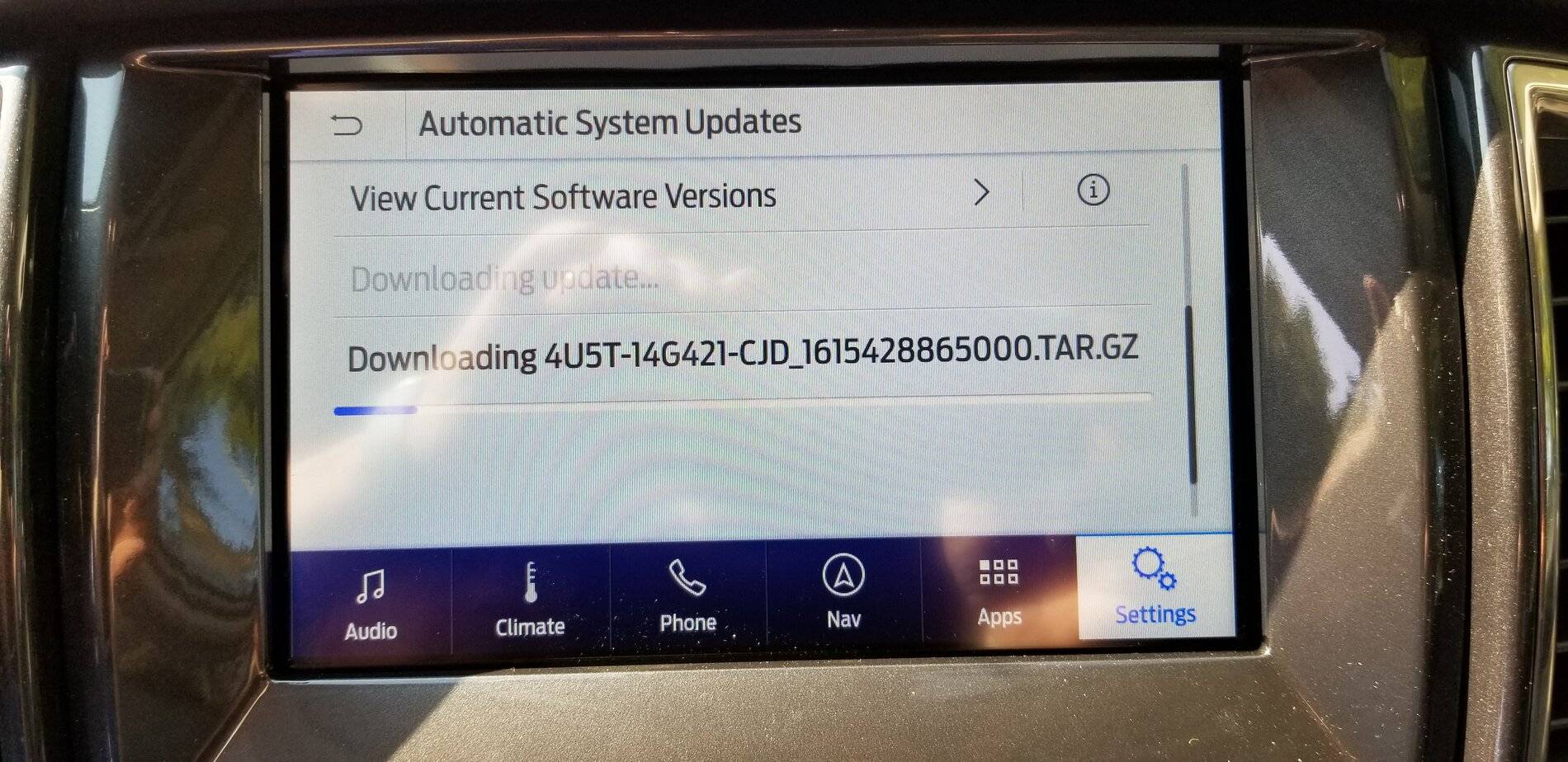

The problem I have is I did a manual "check for updates" over wifi to confirm my sync install update and It found a new map update and started DL. Prob is I can't leave my truck on for two days waiting for it to dl such a huge file over wifi.
Suggestions on my next step? Do I have to do a master reset to get my voice nav back? Will I lose my sync updates?

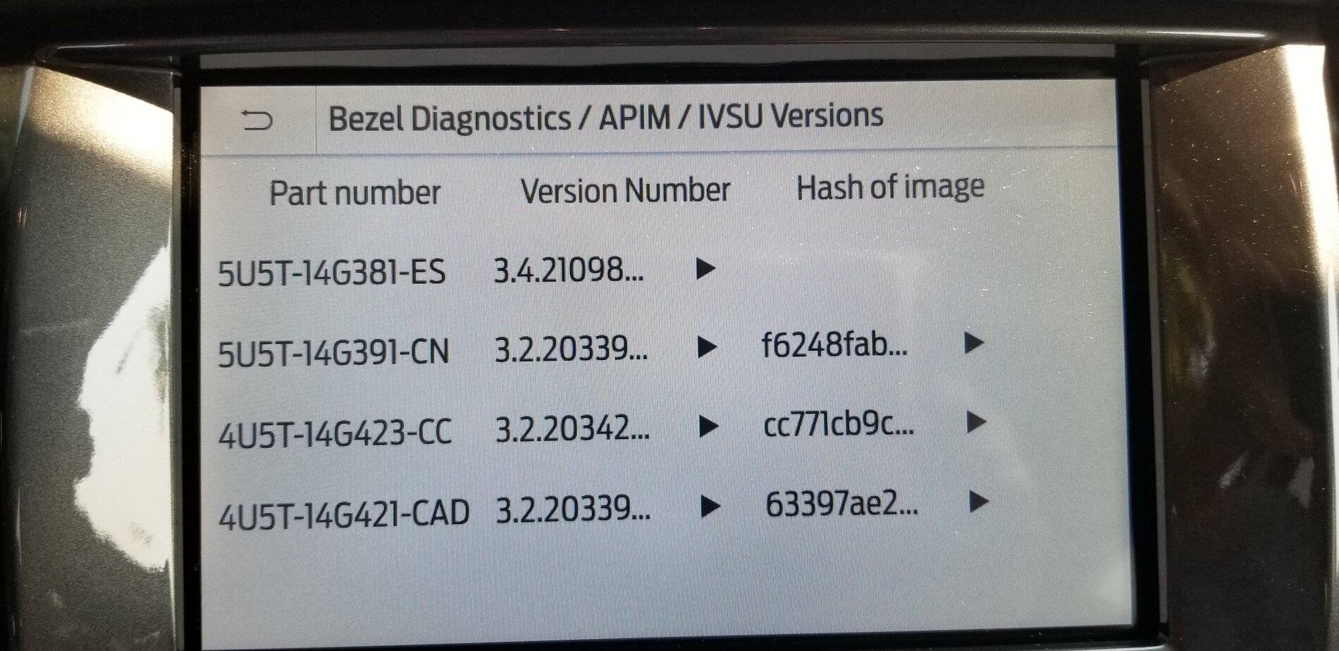

I worked on this last night, even ended up doing a MR but the voice commands just don't work. "find an address" then just closes. Nothing.
Do I need to have to spend $50 on nav update usb? Ridiculous you don't get free updates for X years or whatever. I took a number of pictures from the Diag window on versions so please let me know if you need anything else. Its running 3.4 - 21098 build.

Yeah, the voice nav pack is missing. You can pull the matching US English one and do a manual update to get it working again. On the latest build, it will prompt you to complete the map update for those commands when the file is missing instead of dropping out. One guess why that was added...
Also not sure why the 20Q2 map update isn't available from the USB map update site yet. It should be free to download like the 19Q1 when it does roll out.

I've tried a number of times but it just seems to be stuck on trying to dl the OTA version of the upgrade.
Frustrating.. I can't dl the old version, the new one costs $50 cad and stuck in the middle. MR didn't work so..next suggestion mate?
Cheers,
Yeah, that's another chunk of the map. You can let it go, or create your own installer with the file I linked above and install the voice pack that way. Worked fine for one other person that had the same problem (missing nav voice) after the map update OTA.
