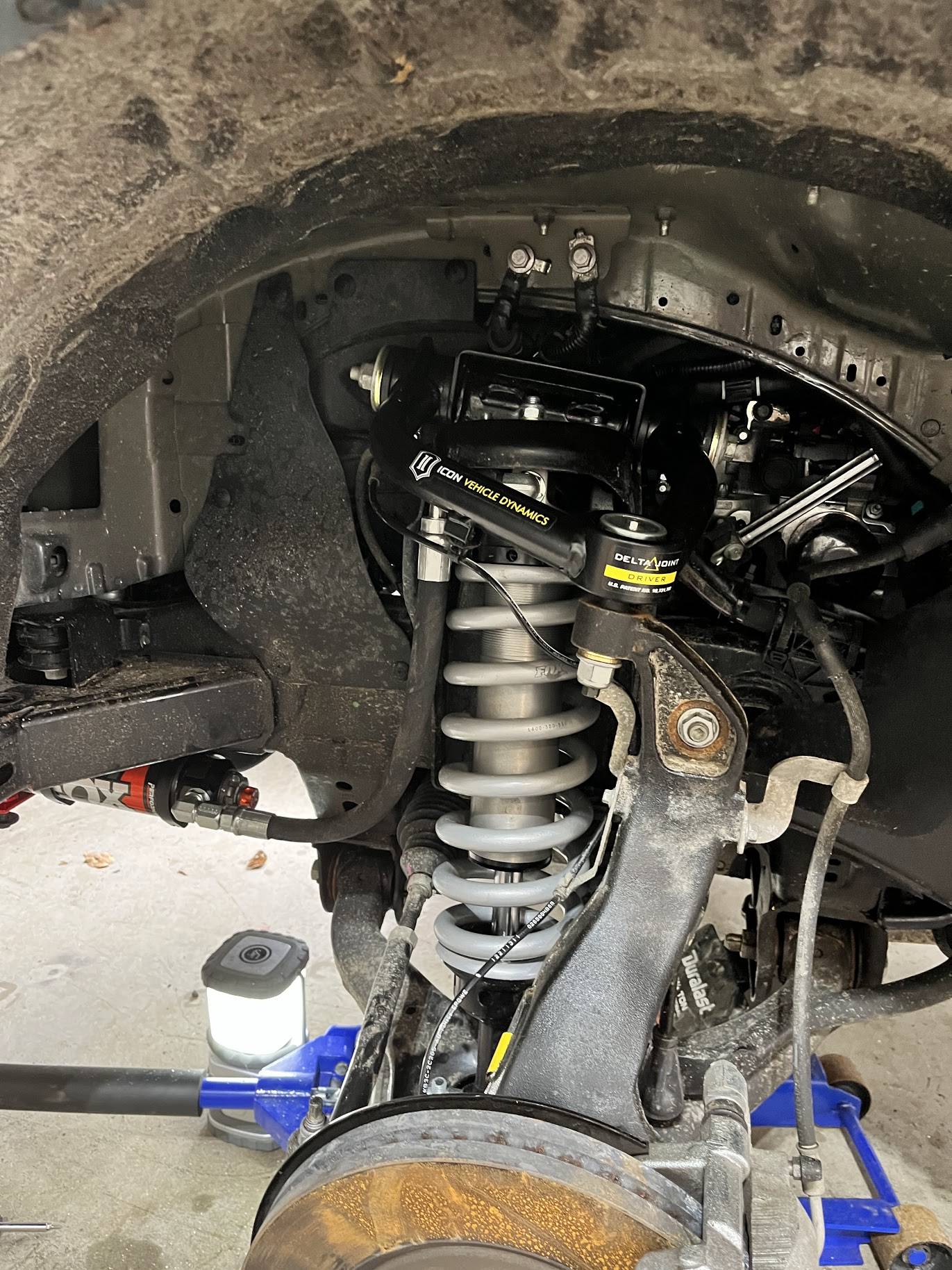

Got the Icons for Steel knuckles on the group buy from the great guys at Stage3 and can highly recommend them. No adjustability but these fixed my positive camber situation after level, camber specks out perfectly now. Great product!
