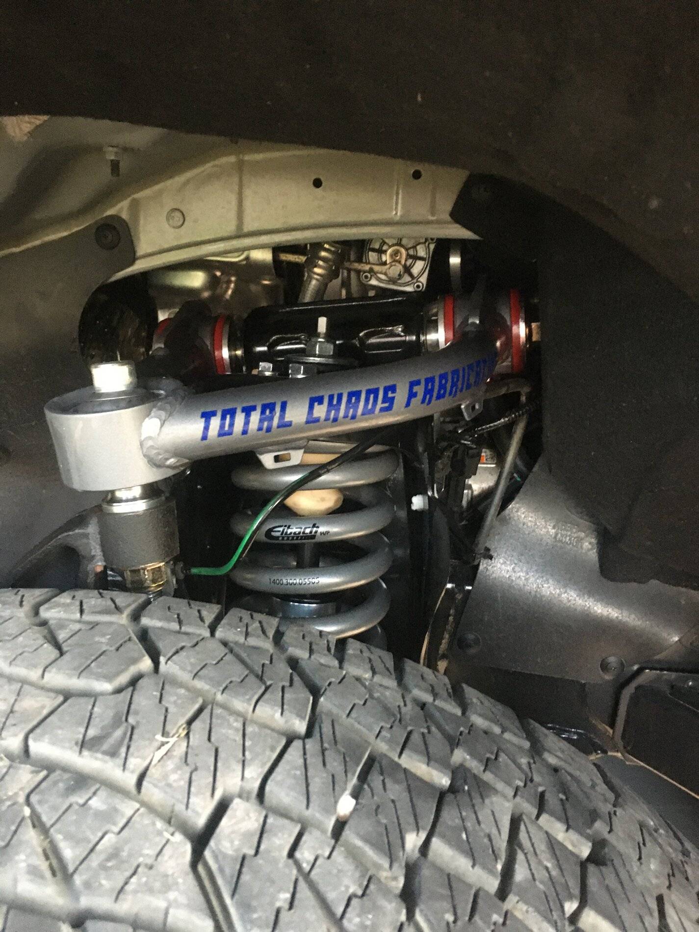

I’ll be installing the total chaos upper control arms on my 2021 ranger with cast iron spindles this week.
