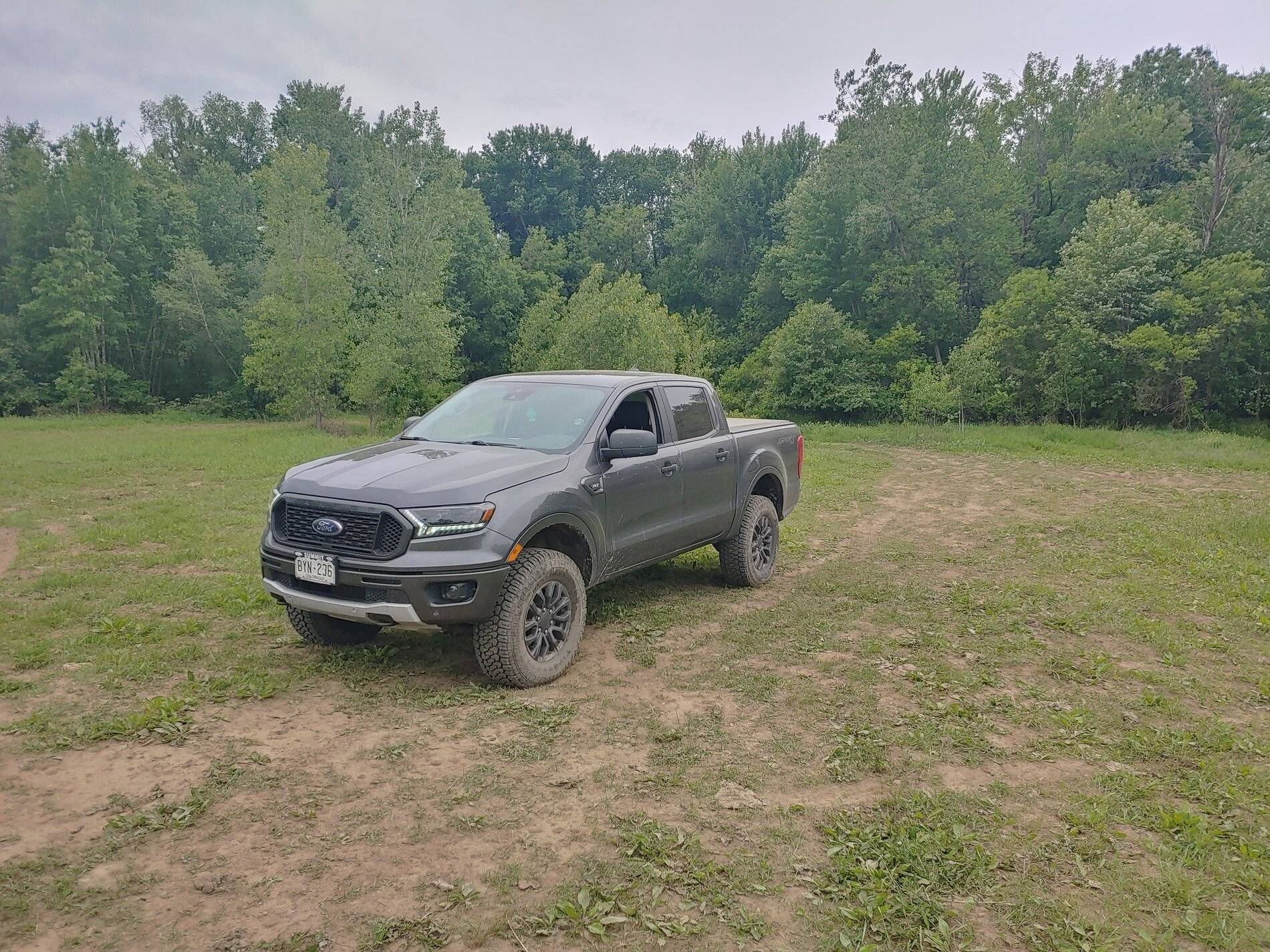

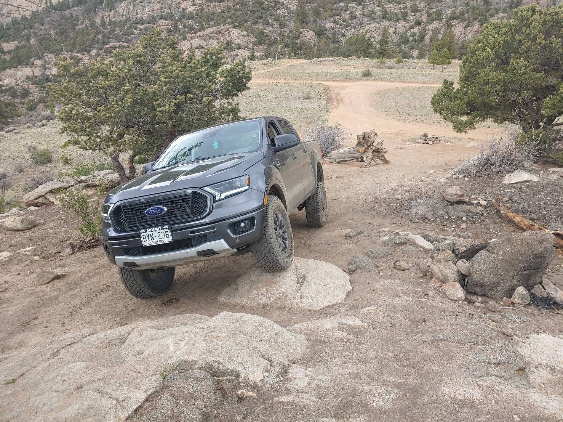

You know you could just go woth Old Man EMU!!! It foesnt touch the control arms what so ever(except with alignment) so it wont matter wich spindal you get!! Front lift is 2.4 and rear is 1.6
And you can fit 33 inch tires on stock wheels(no spacers) with little to no issue!!!!!

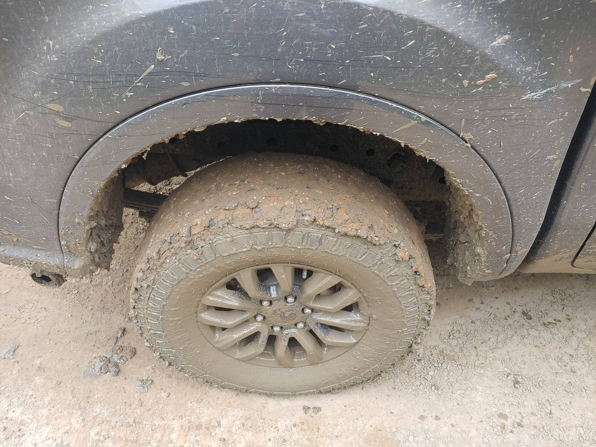

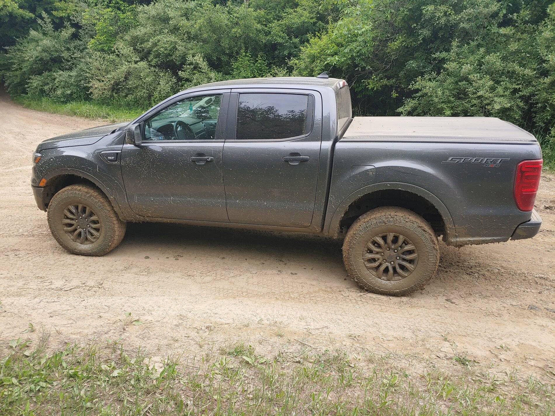

I dont have the BP-51's at this time but plan to in the future. As for the tire it is 285/70-17 Firestone Destination XT.

Nice thanks! Did you have to trim the crash bars or just pound them forward? (Or neither)?

Neither. I removed the plastic covers, loosened the fronts and pushed them forward. The only rub I have is at full lock on the sway bar and it isnt enough to scare me
