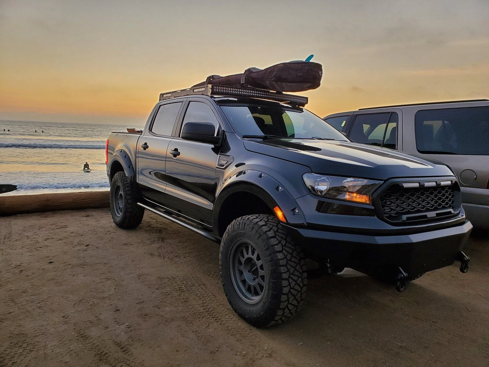

APG is the answer. During my build they found this out and had to machine it inhouse. Took a few extra days; but, in the end glad i went with them. Excellent service and have continued to help out when i need it. Getting the new HD leaf springs installed in a few weeks when my rack gets back from powder coating.
Just be sure to call and specify so you don't order online with the wrong ones.
Or just go all out! The HD tie rods are beefy! ?
https://automotiveperformancegroup.com/product/apg-midrunner-suspension-package/
62
4,785
28,120
GA
Off topic, but what roof rack is that?
Looks great!

Side note sweet truck, and looks like you're at San O haha.
