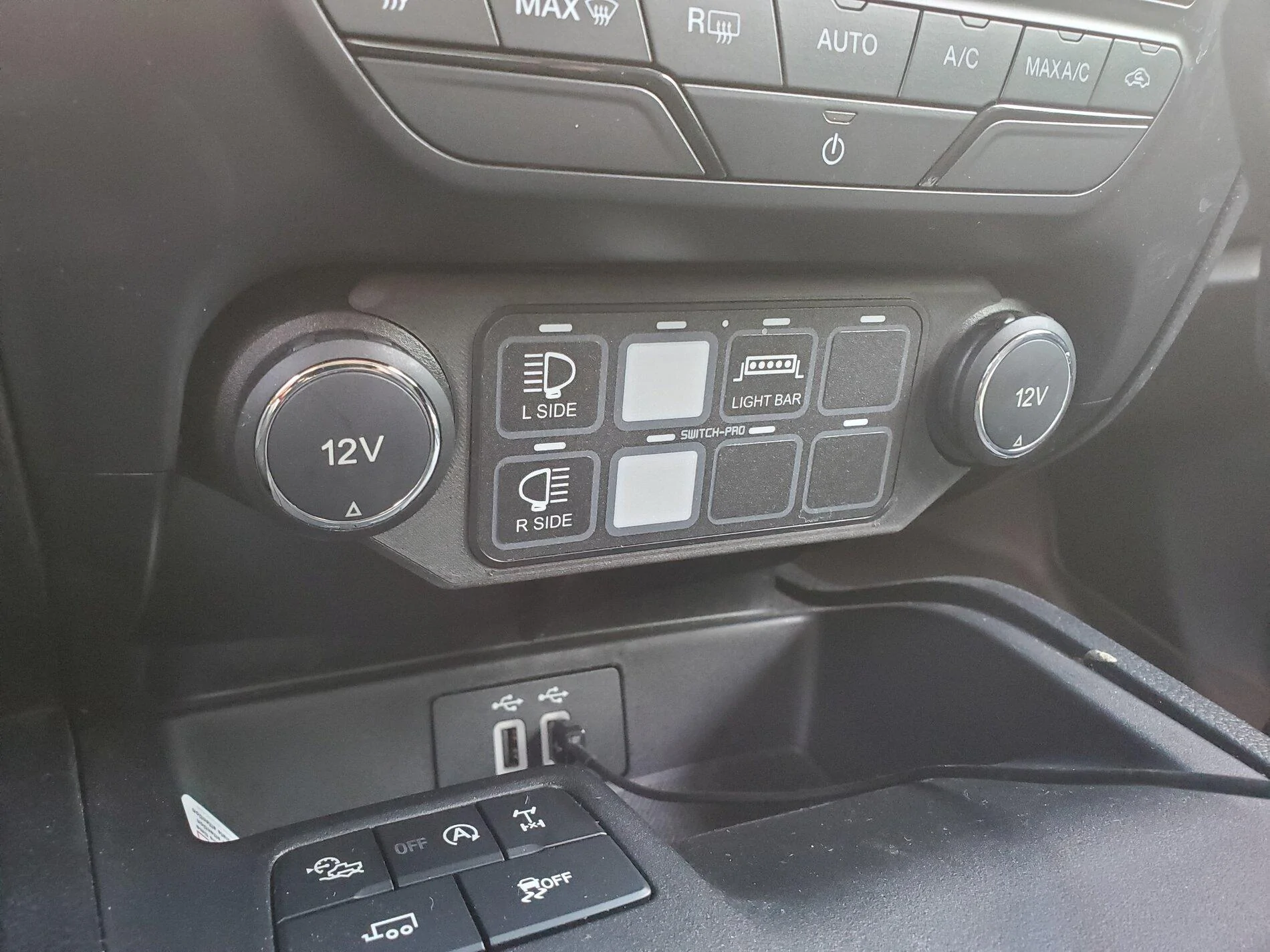

Ok maybe i would have gone with a different MOD for that price. Another picture of the inside setup.

Once you get it installed it makes other accessories easier/cheaper to hook-up since the wires are already ran and under the hood. Plan accordingly as power output vary based on each button.
