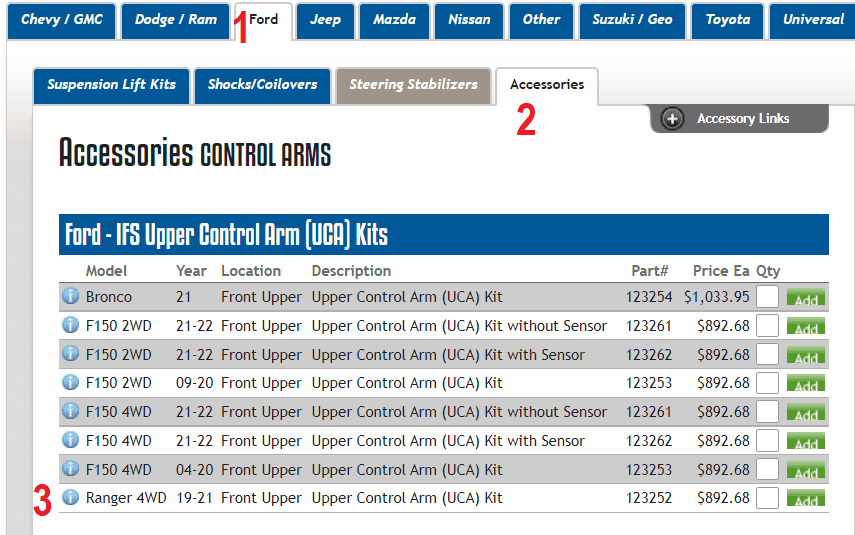

Hi, I have 2022 FX4 and Fox 2.5’s to install front and rear. Would really like to hear your opinions on which upper control arms are best to buy and if possible why. Thanks again.
BDS Makes a sweet set of UCA's. They only work w/ aluminum knuckles.
https://bds-suspension.com/product-display?all
123252 Upper Control Arm (UCA) Kit FORD RANGER 4WD FRONT UPPER 19-21
