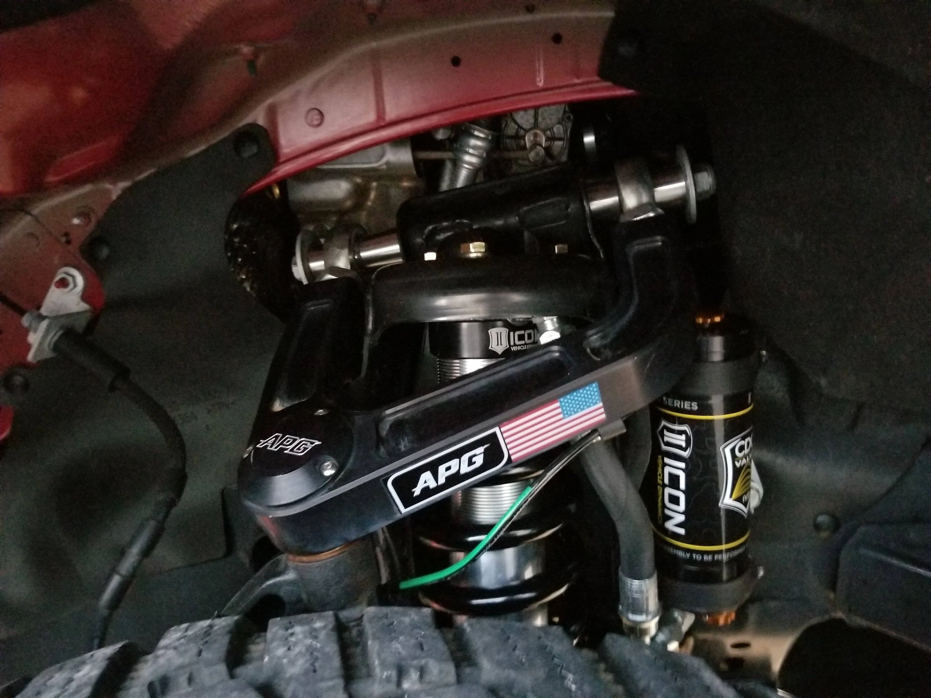

in April 2021 choices were very limited....APG was the only company making a UCA for the steel spindles.. Billet with uni-ball and adjustable Heim joint ends..bushings are solid milled no grease needed...the no deflection construction does allow more "road feel" to be transferred into the chassis , but better steering response...as for maintenance I just occasionally clean exterior with brass brush and give them a squirt of WD- DryLube....I have never experienced any squeaks..

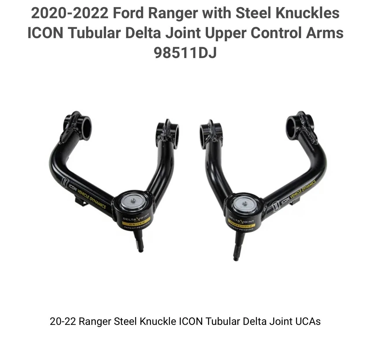

Icons have the zirks on the bottom side.

Those are serviceable too. The joint is replaceable which is cool. Alot of people like icons, except one guy on here says they are garbage. I forget who he is but he really dislikes them.
I have seen that there’s more than a few people on here that do not care for them because of the squeak, but that’s why I am asking for clarity to better understand what the Hecks going on with the Icon’s.

Avoid the Icon UCAs. Mine fouled the shock towers on the first Ranger, damaging both components and limiting down travel.

A little more info about the ICON UCA's ....wheel size and back spacing are critical to proper performance of the ICON's if a larger than stock (265)
width tire is going to be used.....must have 4.75 backspace for a coilover with stock travel, and 8.5" wheel with 6" of backspace for the extended travel 2.5 coilovers.. and they recommend caster to set in the upper range of spec( 3+ ). Failure to follow their guidelines can cause binding and component failure...

Great info there, Thanks!
