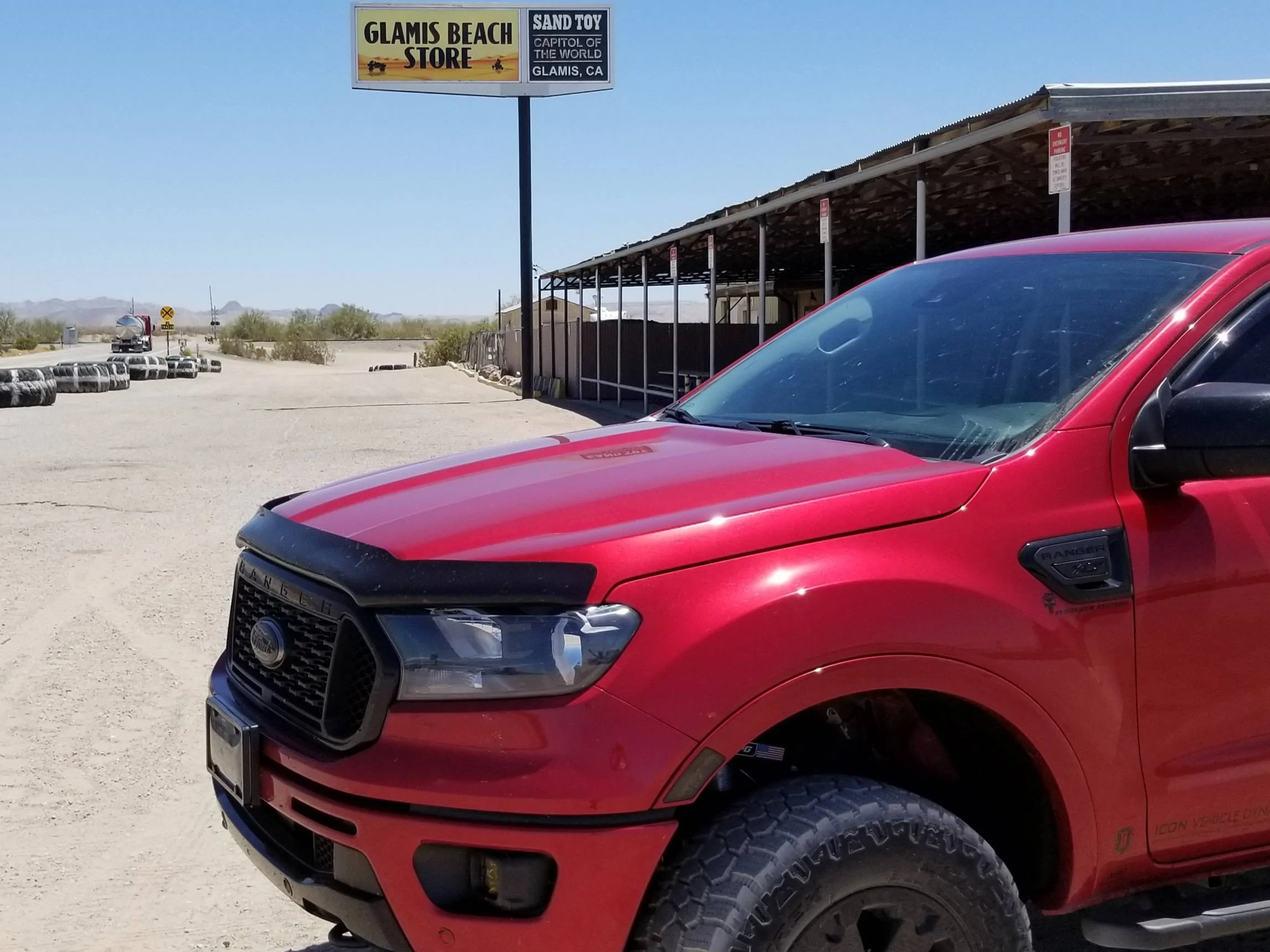

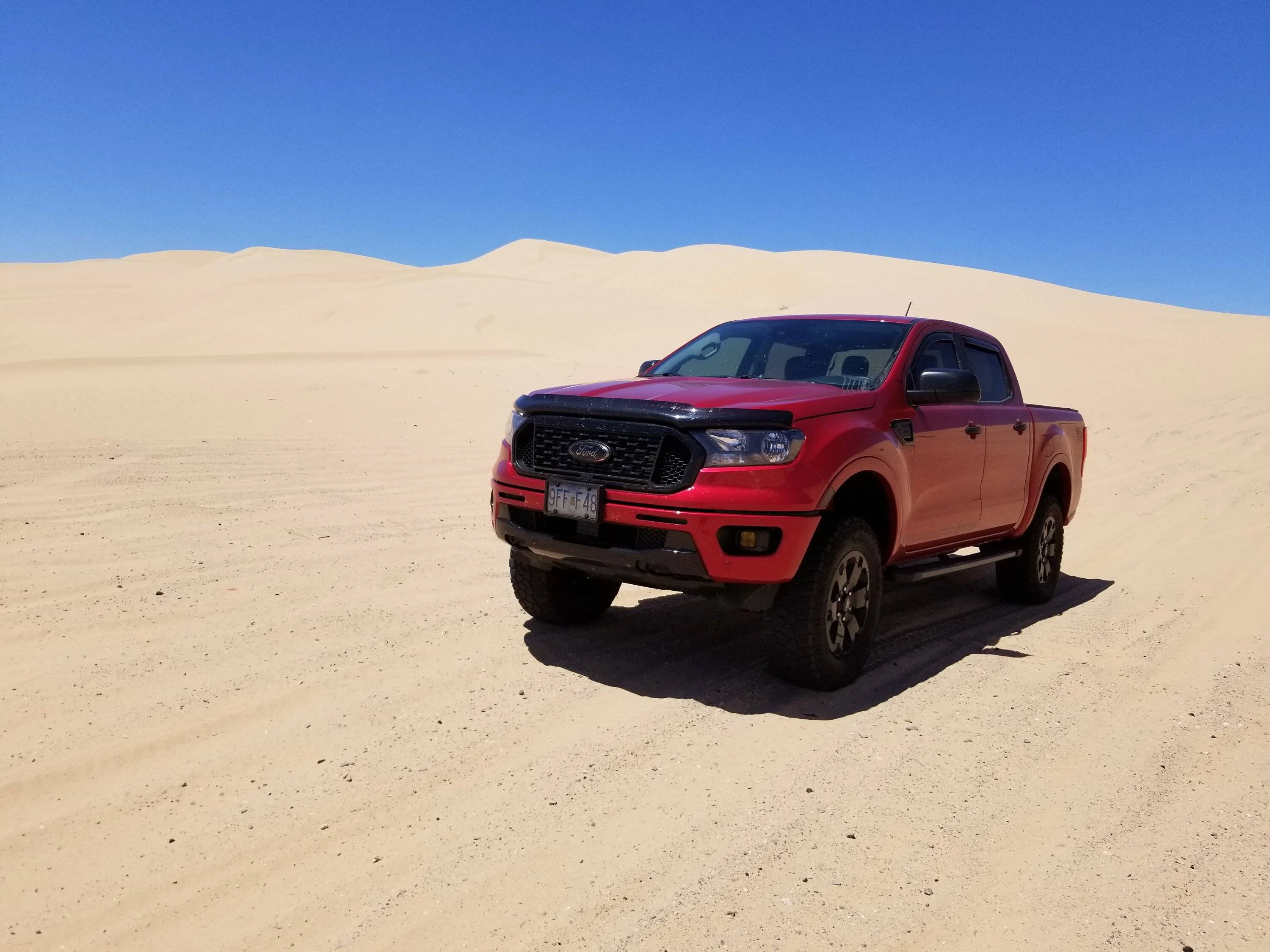

Me at Glamis this past summer....Over 40 years of Glamis experience here...
