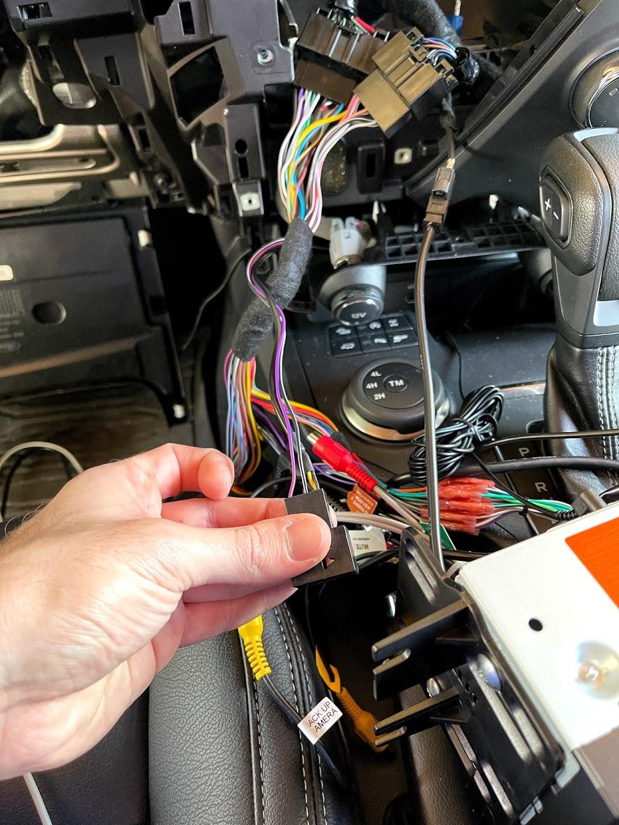

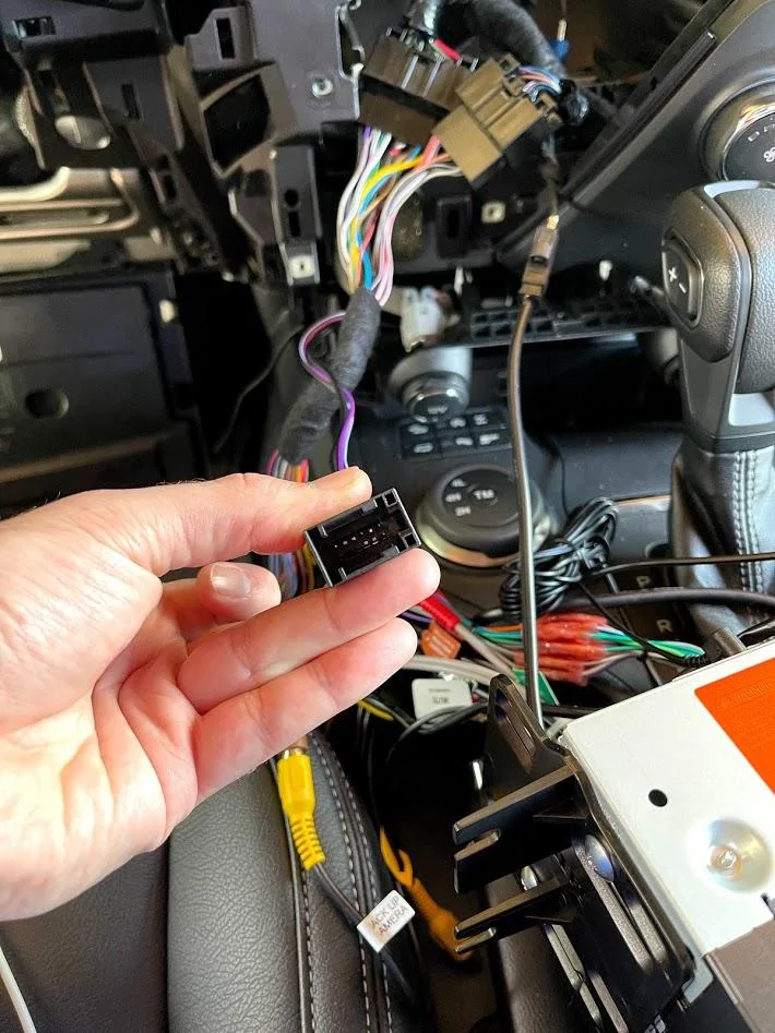

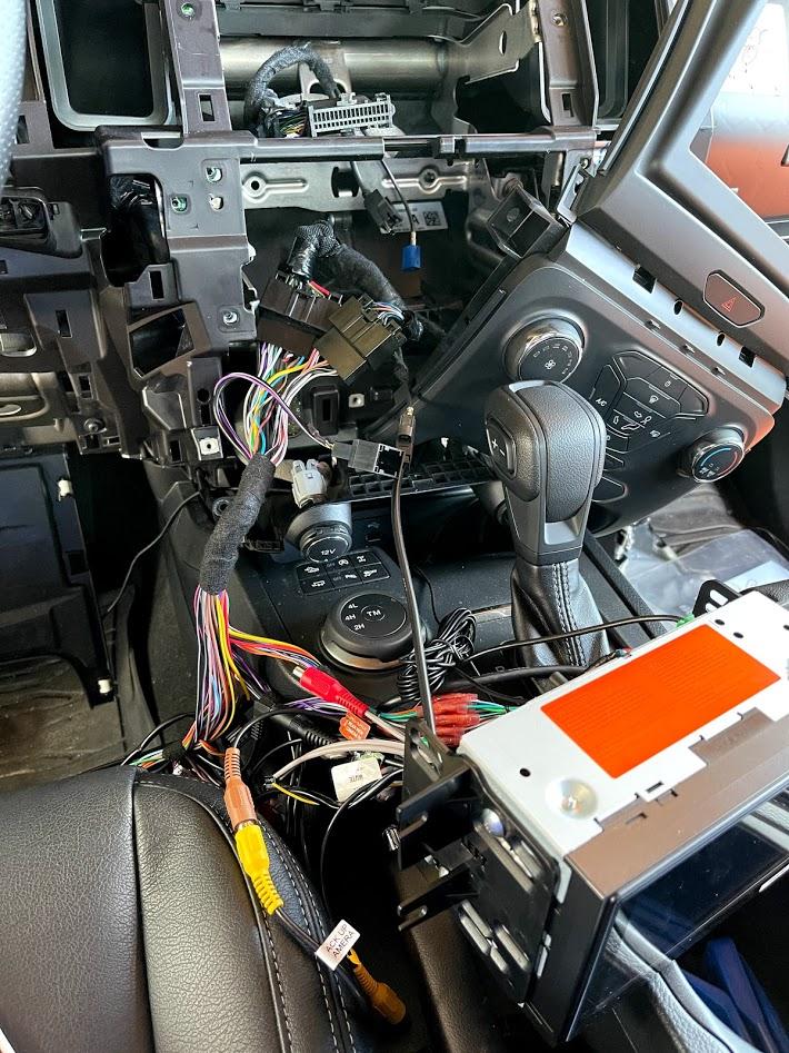

Hi all,
So I bit the bullet and tore apart my dash to install a Pioneer DMH-W4660NEX and I'm happy with it thus far except that I cannot get the backup camera to work with it (puzzled currently).
Here's my part list for anyone interested:
1. Pioneer DMH-W4660NEX
2. Metra 99-5857B Dash Kit (Matte Black)
3. iDatalink Maestro RR Interface Module
4. iDatalink Connec HRN-RR-FO2 Factory Integration Adapter
5. Metra 40-EU10 Antenna Adapter
6. Crutchfield "ReadyHarness" service.
I thought that with the iDatalink FO2 factory integration adapter that the camera would work out of the box, but unfortunately that is not the case (at least not for me).
Below is a picture of the backup camera connected to the input on the radio. The yellow RCA cable comes out of the adapter harness that connects to my Maestro RR module and I have it plugged into the aftermarket headunit.
Interestingly, the large connector that is at the top of the photo below does not connect to anything post-install (and it used to connect to the factory 4" screen).
And I did notice that my harness had an unused connection (which I thought should connect to what used to connect to the 4" screen, but they are completely different sizes), which I suspect may have something to do with the camera not working. Picture below where I have it in my hand.
Another picture of that unused plug (I think this is the power for the camera that is currently missing).
I'm planning on calling iDatalink Maestro tomorrow to see what they say as I could not find any Ford Ranger specific documentation, though I wanted to post this here to see if any of you had run into this issue with the backup camera with the same adapter and had found a solution.
On my old pioneer unit in the settings you can turn it on and also change polarity. Chances are that’s what’s going on. BTW camera uses 3 wires, positive, ground and signal out (yellow RCA connector)

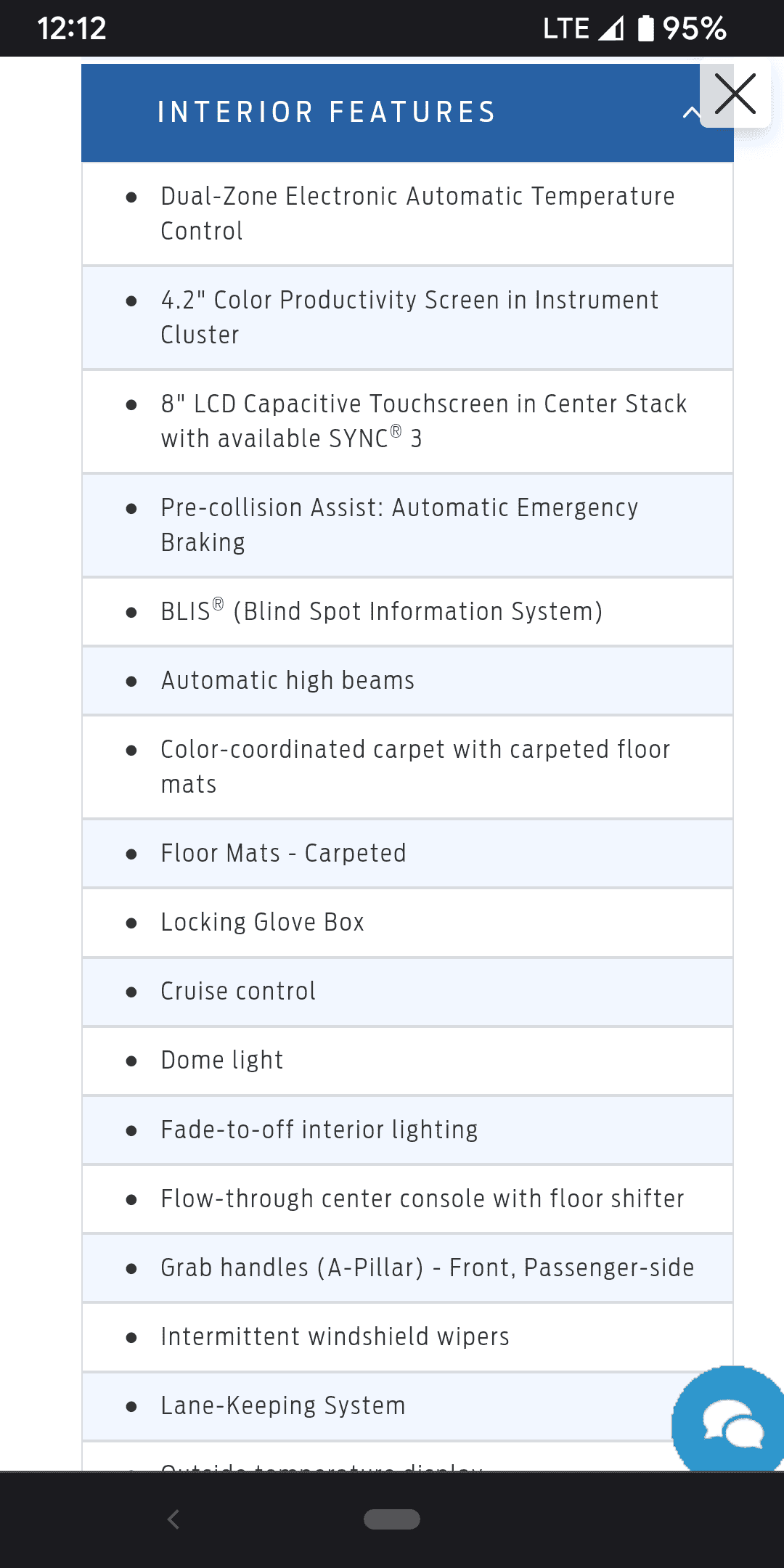

I guess I'm confused.
I thought the XLT with the 300A did come with the 8 inch center display.
Could someone confirm?
