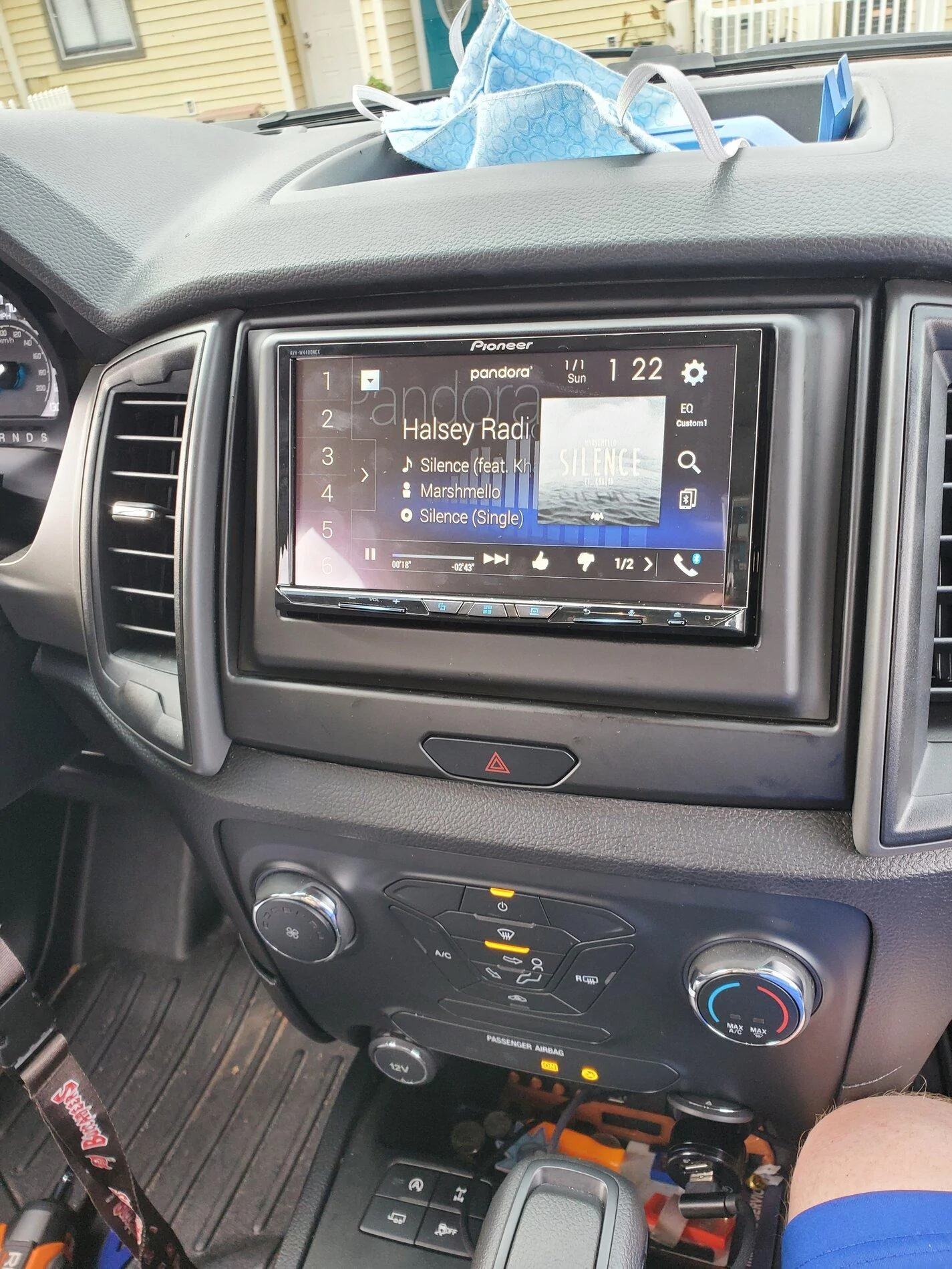

Yep installed and fully working, including backup camera and steering wheel controls.
Would you be a pal and share a list of materials used on your swap? Thanks in advance
Looks like
Metra - Dash Kit for Ford Ranger 2019 and Up Vehicles - Matte Black
Model:108-FD9B
Directions for the above dash kit state it was designed for Pioneer DMH-C5500NEX 8-inch radio
Also needed to retain factory controls/function
Wire harness: • AXTC-FD2
Antenna adapter: • 40-EU10
