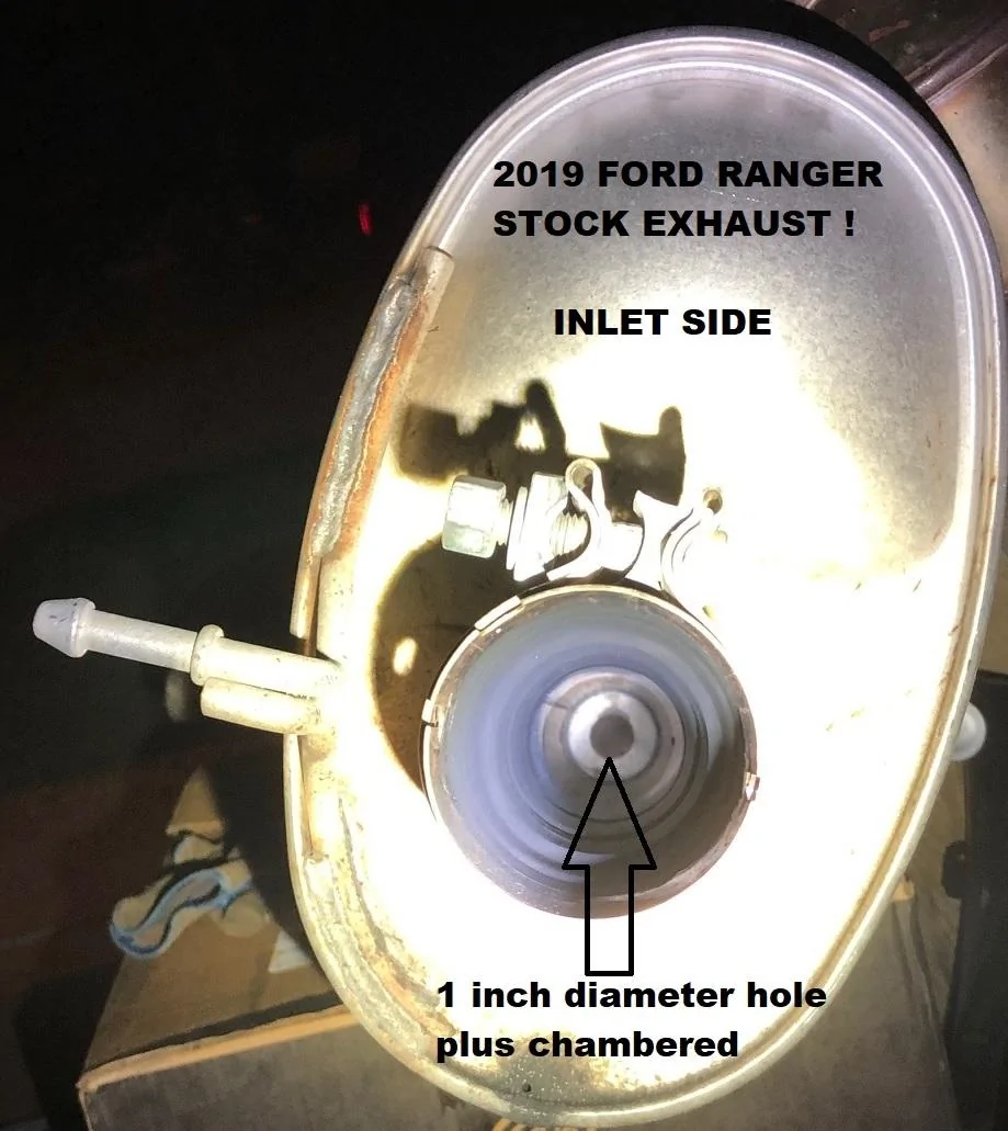

Has anyone figured out what parts should be changed in order to easily increase the power of these Rangers? Obviously a tune is the big one, but from there, what should we be changing next? Downpipe? Exhaust? Intake system? Intercooler piping?
I'm very interested in some bolt ons after I get a tune installed. One thing I don't want, is a loud exhaust system. My Ranger is my comfy/nice daily driver and winter beater so I want to keep it that way. I would definitely be open to adding an electric cutout in the exhaust if the cat-back is a big restriction. This way, if I wanted max power, I'd press a button and have open unrestricted exhaust.
You can do anything that comes to mind, but take a look at the muffler first. This was posted by a fellow ranger owner. After seeing this I had the muffler removed, (and mine had the same restriction), and just ran a straight pipe to the factory resonator. And yes, removing or replacing the stock muffler did make a big difference.
