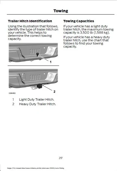

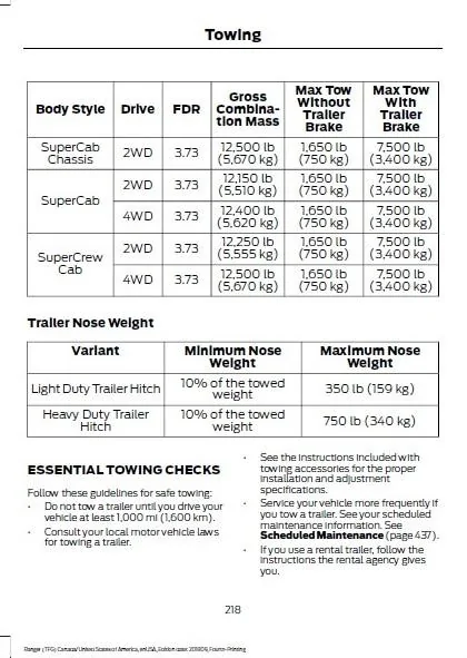

All he needs to do is remove the threaded rod / hex nuts and use a Grade 8 Hex Head Cap Screw. That will exceed the capacity of the bumper hitch, which should be plenty for a lawn tractor on a small trailer (see below).
But your point is on the mark if he wants to tow more capacity than the bumper hitch can handle.
