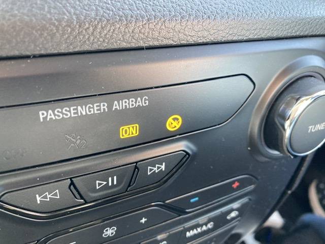

One light shows that the passenger airbag is on, and the second light shows a circle with a slash across it. Does this mean airbag is on with a problem?

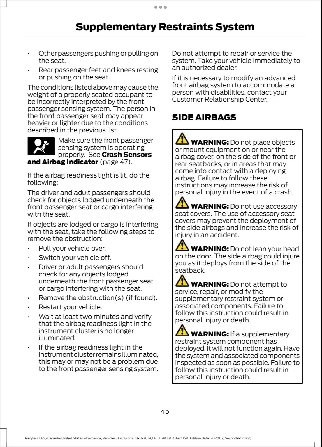

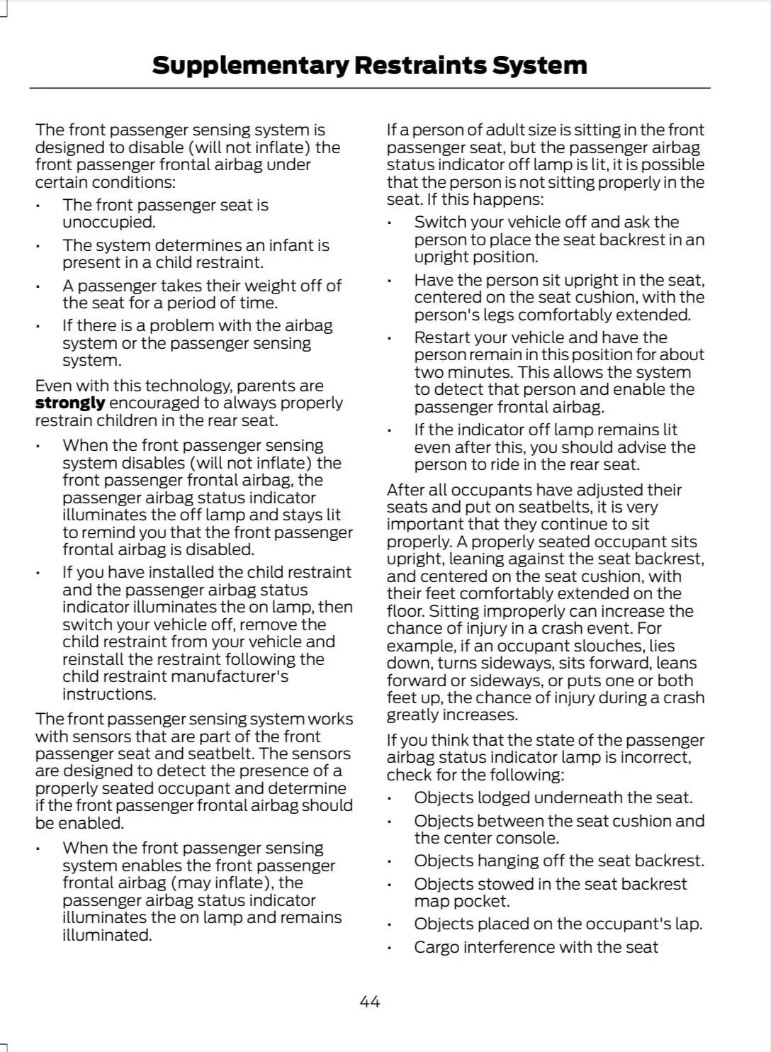

Pages 42 thru 48 address this, I’m going to post 2 pages that have you do various checks. I have not seen this.

Is anything on the seat?
Thank you for this. I am going to do the checks shown in this supplement, and post my results.

I did all of the checks recommended in the instructions above. I did find a water bottle under the seat and removed it. I turned the truck of and restarted it after a few minute the "on" light for the empty passenger seat was now off theh the warning seat belt icon light was on.
My wife then sat on the passenger seat and fastened her seatbelts as per instructions and the seat bent icon remained on.
