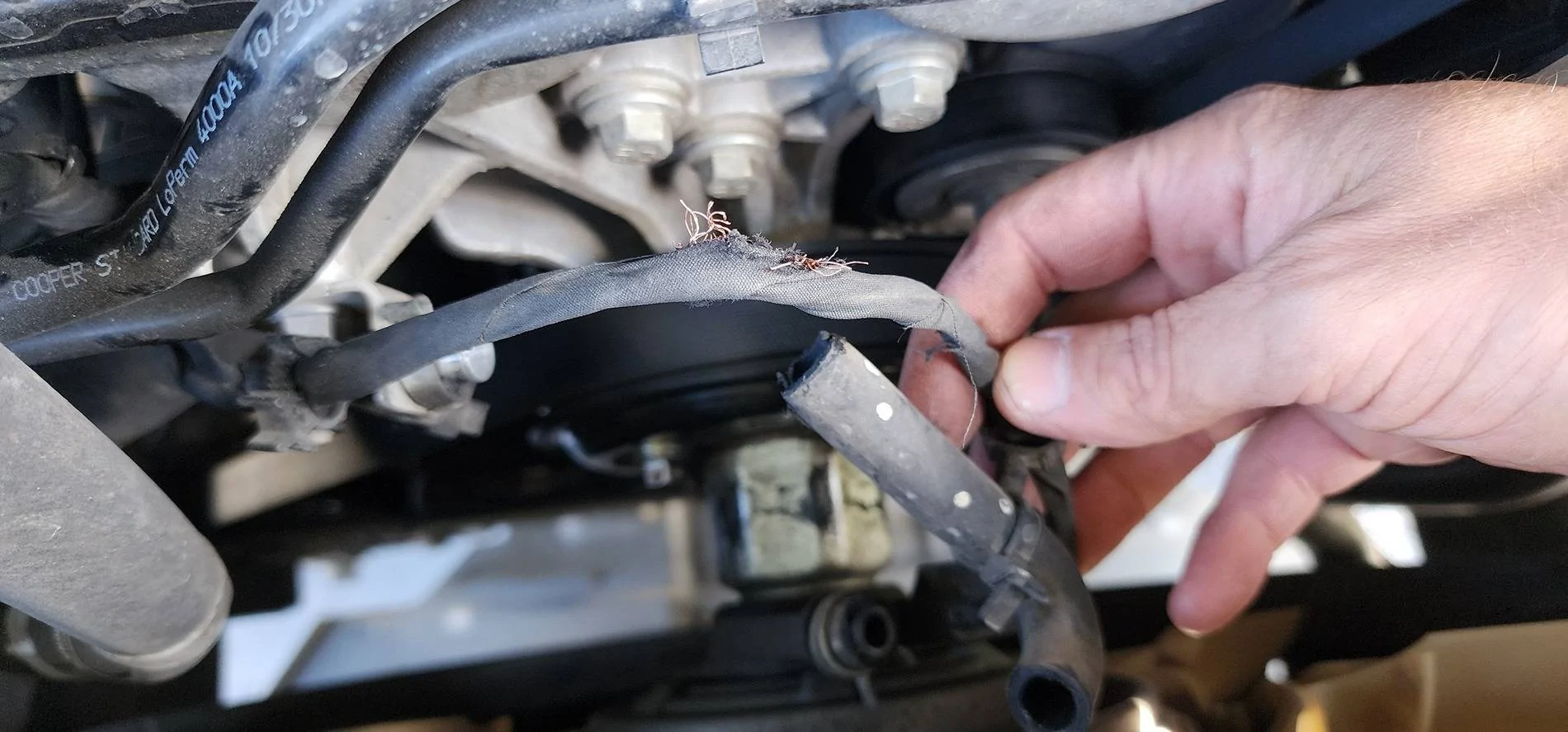

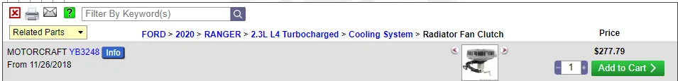

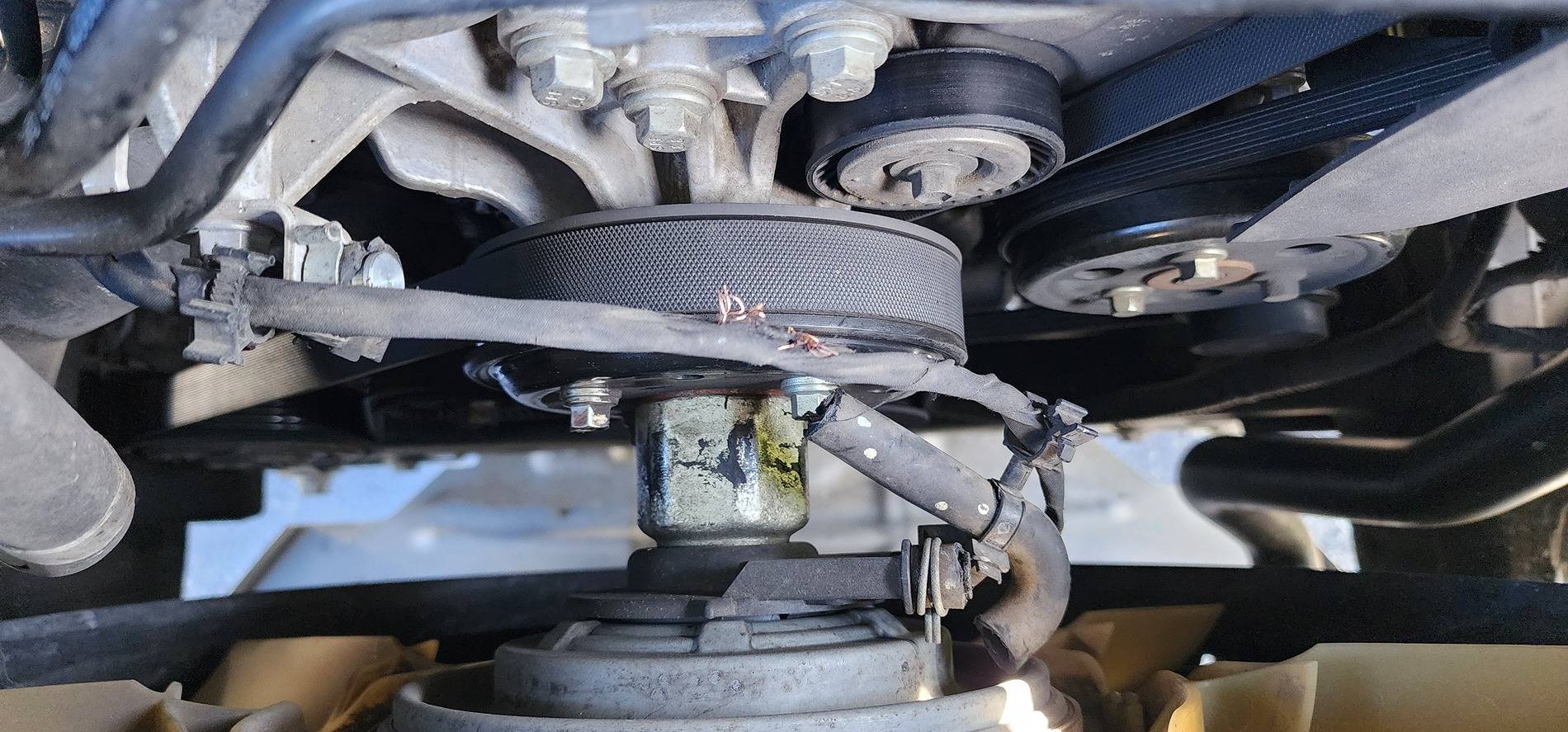

The hose is not available separate, I got it from another tech
Airline tech sound like you are right on point that is where I would start
airline tech
Aug 24, 2022
4,667
8,952
Midwest - KS
Aircraft Tech

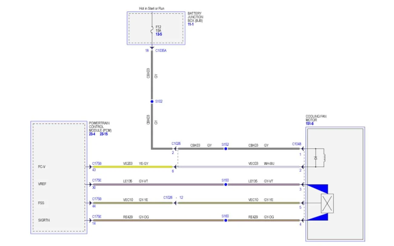

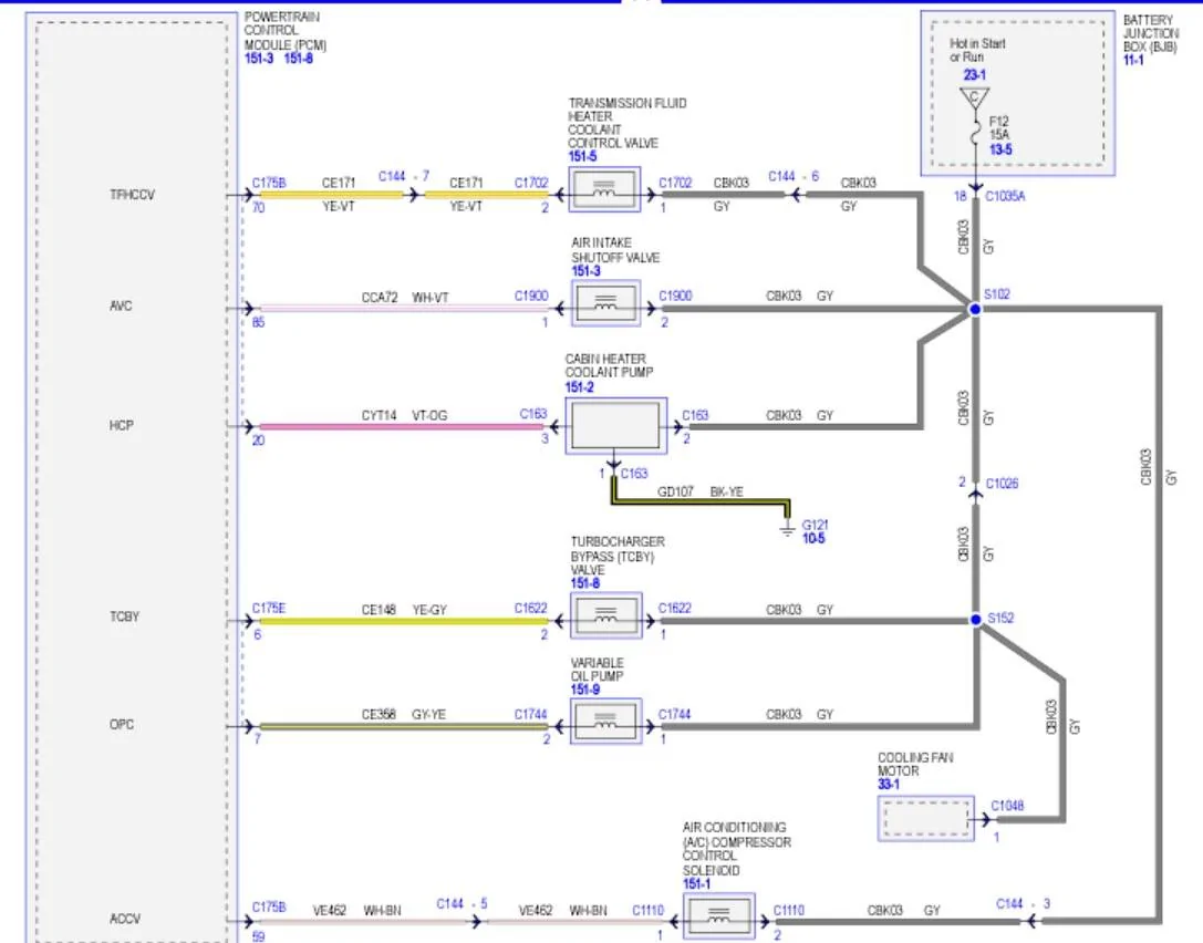

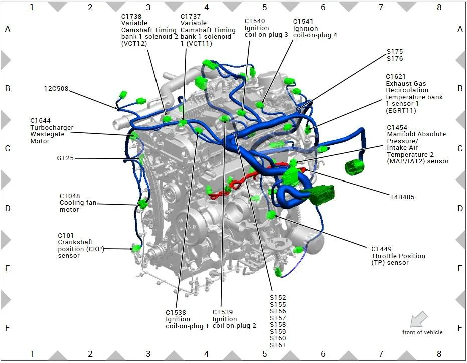

And for a ref - to S152 Location, in that harness run with multiple splices there are 2 wires that have grey in the color
S152 - Grey
S160 - Grey - Orange Trace
If you do venture down this path for the splice, the manual location pics are not the best, and a Tone Tracer might help in locating the splice (position) in that harness.
