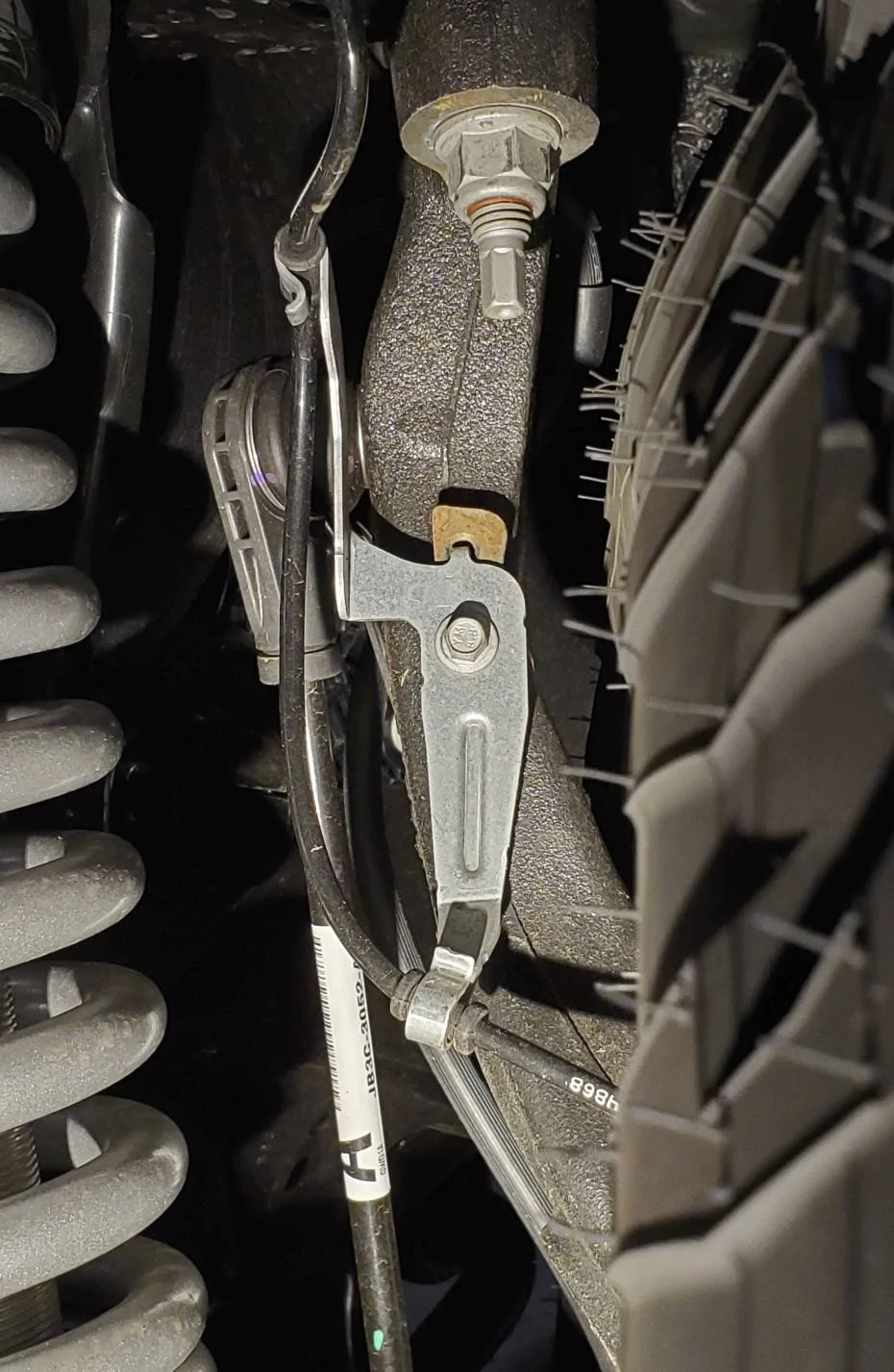

The easiest way to find out is to get a magnet and see it it sticks to the steering knuckle. If it doesn't then it is the early aluminum. If it does stick that. You have the late steel knuckle

Won't matter as it depends on what it was equipped with
It was a year and trim package thing?
I thought it was like tremors got one everyone else got another. Maybe not that specific...
I read about it on here at some point... I think. ?

It was a change during production. I want to say the change started for 2020 model year trucks

I just googled it. Lol
Looks like that was the year of change over. Stage motorsports has uca's for 2019-2021 and 2020-2022 listed differently...
https://www.stage3motorsports.com/9...el-knuckle-icon-tubular-delta-joint-ucas.html
https://www.stage3motorsports.com/98510dj-19-21-ranger-icon-tubular-delta-joint-ucas.html
Perhaps cast is post covid plant shutdown. Mine are cast and was built 6/20 shortly after restart.
The easiest way to find out is to look at the color.
Cast=black (+rust), Aluminum=unpainted.

Mine was built 03/11/2020 believe it or not(google that date).Mine are aluminum.
