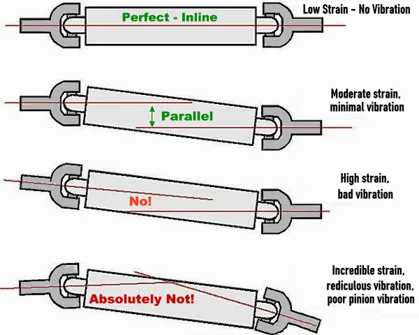

I had the shudder when WOT on stock leaf springs, but I knew how to fix it, I was just lazy. After getting around doing the OME 1.7in lift springs the shudder is completely gone. The lift kit removed pinion angle. My pinion is now parallel to the output on the transfer case, or ever so slightly below parallel. Now under a bounce, weight, or acceleration the pinion moves up slightly but still remains pretty much parallel, at least more than factory.
You do not want a lot of pinion angle. If you have a shudder and the TSB added more angle, it's wrong. You could spin the shim around? I believe we have CV type joint on the driveshaft at the transfer case, so that gives more flexibility overall but clearly the driveline in sensitive in the ranger.
Hot rods and Jeepers have been perfecting this for literally 50+ years.
https://www.hotrod.com/articles/change-pinion-angles/
