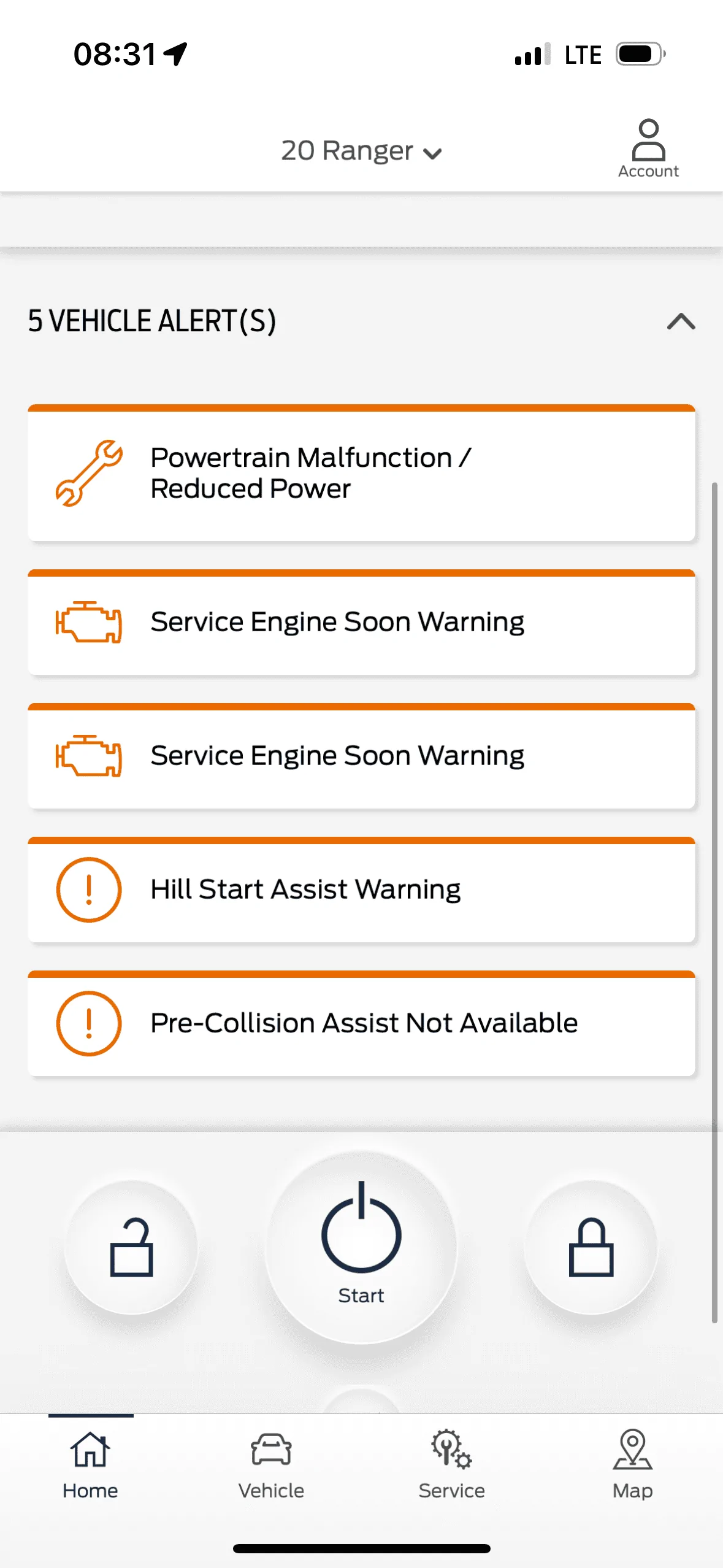

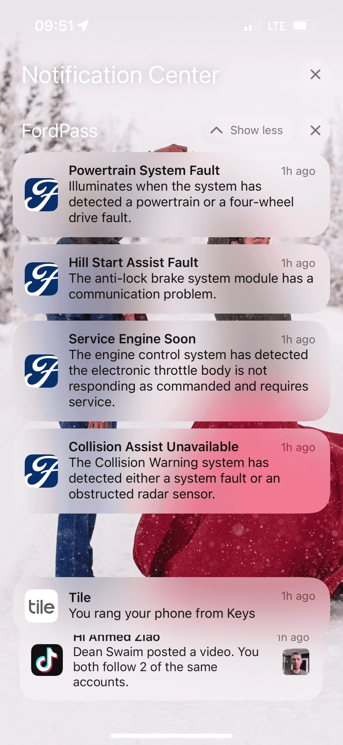

Was able to pull code P2112 “throttle body plate is stuck closed” I’m guessing it probably got frozen?
Possible. Just wonder how enough moisture got in their for it to freeze. Are you able to take the intake off and look at the throttle plate? Phone a friend who can?

Throttle body was able to free itself started it up and reeved a little higher than what i was comfortable with, truck is not running rough anymore but shift points were really off on the drive home. Cleared all the Christmas lights. Gotta do the Throttle body re-lean. Does anyone use/recommend an intake system cleaner that’s safe for the 2.3L? Thank you all for your help, I appreciate it very much.

Here is the Pinpoint Test for it, if resetting does not fix it
Plus clean the throttle plate with some carb cleaner & pull and reseat the connector and if you have some spray some elec cleaner on the connector / maf cleaner will work also
Never use carb cleaner on a throttle body. Most throttle bodies have a coating on them thst prevents sticking and carbon build up. Use throttle body cleaner.
