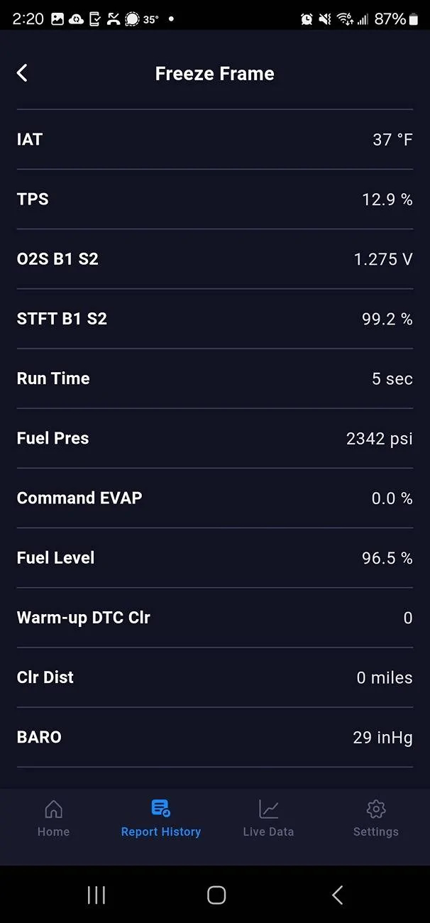

Hello;
I have been spending a lot of time reading as many threads in this forum as possible to help with my issue. I am finally at wits end for the moment and looking for some guidance.
2019 Ford Ranger Lariat at 138k miles. I have been in the process of back and forth drives between Michigan and Nevada to finish my relocation to Michigan. During the last drive to Nevada a solid check engine light came on with a P0301 without any symptoms. Because I was in the middle of a trip across country with just a gig bag of tools I pulled the plugs and checked them, everything looked good. I swapped 1 & 3 COPs just to see if I had a week COP and there was no issue. Still had P0301, solid CEL, but no running symptoms. I had a tight schedule to get back for work, so I drop with the CEL to finish the trip to NV, spent a week in NV driving around without issue other than the CEL, and then on the trip back to MI, at highway speeds the truck started bucking and I had a flashing CEL. Stopping in Wyoming I found that I now had a P0301, P0302, and P0300. Again, checking all of the plugs and swapping the COPs on the side of the road everything looked fine and swapping the COPs around net no changes. I was stuck having to get home so I drove with the truck bucking at low speeds, but at higher speeds it seemed to smooth out. Just shy of getting home the truck went into limp mode and I barely made it home.
I am stuck without my OTC Gensys and most of my tools where I am at now so I have had to do most with basic hand tools and a cheap OBD2 scanner that at most will grab freeze frame data, so I have no live data for checking.
All COPs and spark plugs have been replaced.
All the plugs that came out looked to have normal markings with nothing glaring.
1 & 2 did smell strong of fuel from not firing.
No signs of water in the plug valleys or any rust/corrosion
Noticed that the fan clutch had broken its position tube and two wires had worn through and grounded out.
Replaced the fan clutch and rebuilt the wire harness
Replaced the fuel in tank lifter pump assembly
At this point now I received a code P2282 for air leak between throttle body and Intake Valve; and when just moving the truck forward and back I lost brake assist as though there was a vacuum loss.
No external sucking leaks heard and checked the normal areas with some starting fluid with no RPM change showing anything being sucked in.
Replaced the Throttle Body and the P2282 code is gone but I am still getting P0301, P0302, and P0300.
Really looking for some guidance. Currently life has me unable to afford just running it down to a shop, any warranty is long past gone, and I am really limited on diagnostic equipment at the moment.
What are areas that I should be focusing on
What next steps does any have as recommendation
I have combed this site and have checked about as much as I can based on other peoples issues.

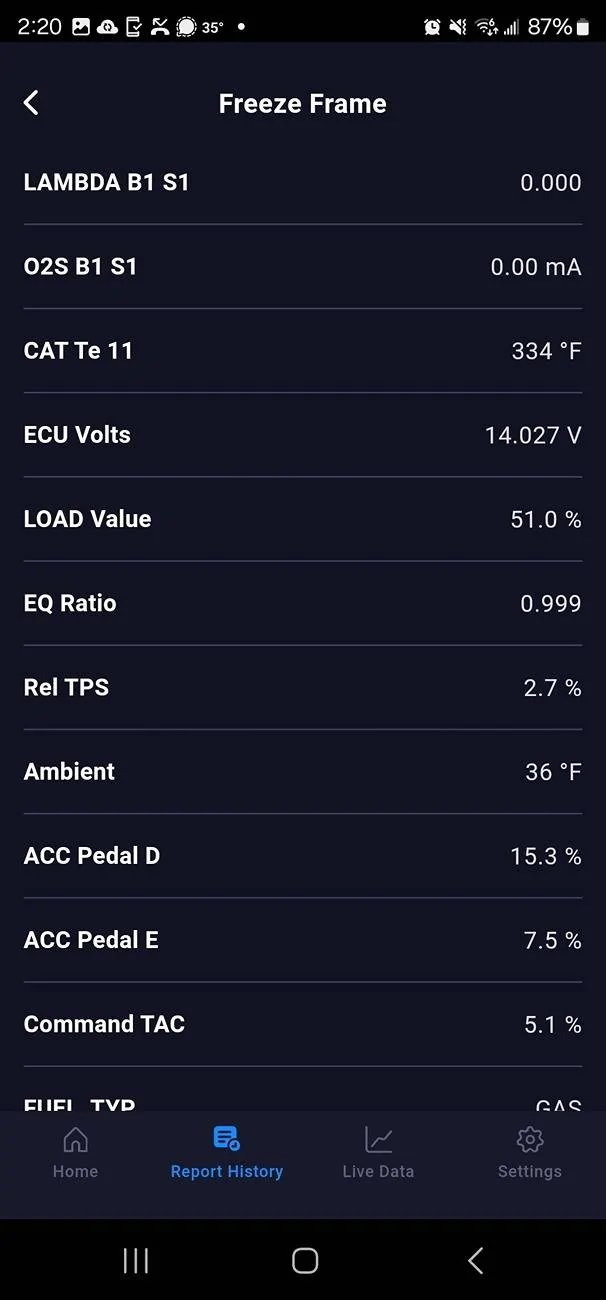

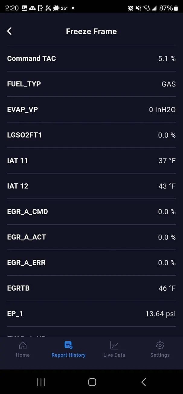

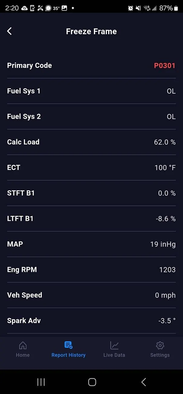

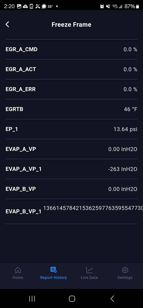

Attached are screenshots of the freeze frame data.
Thanks for anything at this point.

Ref: Posted PID's
The ones that stand out
Note: These were taken after (5-Seconds) of engine run time
Was this a - True Cold Engine?
As some PID's stand out
ECT = 100 Deg - after only 5 seconds of running while all others
IAT11=37, IAT12 = 43 and Ambient = 36, so either the engine was still slightly warm or the ECT is not reporting correct temp.
On a true cold engine all sensors should match within a few degrees.
Not shown is the CHT on your PIDs
Engine RPM - 1203 RPM is rather high, need to see what it is when the engine is warm, a higher RPM than normal can be a sign of bad injector and PCM compensating for it, same goes for a vacuum leak.
But this was taken only 5 seconds after start-up, and you are still in (open loop)
Normal Idle RPM - Engine @ Op Temp = around 900RPM
It needs a Relative Compression & Power Balance Test to check Fuel Injectors
This test will disable each injector, and you note the Fuel Press Drop and RPM Drop
The Firing Order = 1-3-4-2
I suspect either Cyl is bleeding over to the other generating both cylinder misfires.
If this was circuit related you would have injector circuit codes, but however the scan tool you have may not pick up the enhanced code
Relative Compression Test - Will show if you have a compression loss issue in the cylinder it uses starter current draw as a measurement while cranking, if a cylinder has low compression it will display as a (% Difference)
Power Balance Test - Wil show a injector issue as you disable the injector for each cylinder you note how much (initial=RPM) drop you see, the cylinder with a low RPM drop indicates a possible bad injector.
So, if the Relative Compression test good, and you have replaced the plugs and cops
(Including the BOOTS?)
Then all that is left is the injector itself or control circuit wiring for the Coils or Injectors.
To test the Injectors (Ohm Test) Internal - Pin to Pin should be between 11-18 Ohms and should be fairly equal between the 4.

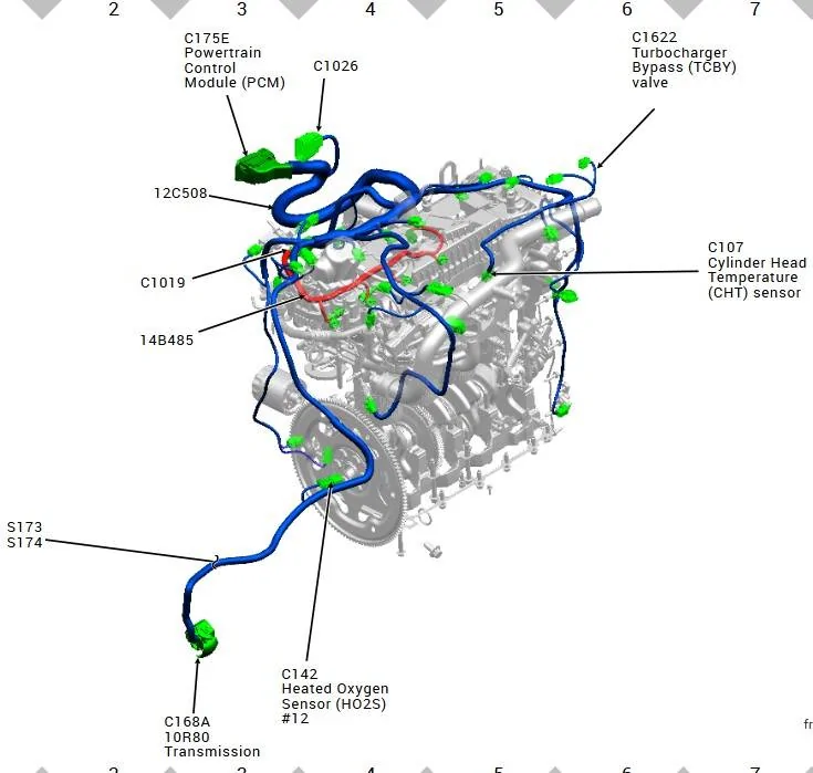

There is 1ea (Inline) connector between the PCM and the injectors and that is C1019
You may try disconnecting - inspect & clean and reseat.
It is a 16 Cavity connector, and it is near the HP Fuel Pump on the driver's side of the engine.

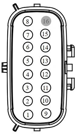

Due to limited access to the actual injector connectors as I would actually have to physically check - I believe they are buried so to Ohm them out it would be easier to use the C1019 connector that is accessible.
Male Side of the Connector - Feeds the Injectors
Female Side feeds the PCM
To Ohm the injectors: Ohms Scale & Pin to Pin (Male Side)
#1: Pin # 1 (Green/Blue) & Pin# 9 (Yellow/Blue)
#2: Pin# 4 (Grey/Yellow) & Pin # 12 (Blue/Orange)
#3: Pin # 5 (Violet/Grey) & Pin # 13 (Green/Violet)
#4: Pin # 6 (Yellow/Orange) & Pin # 14 (Blue)
If you measure out of spec resistance its either the injector or the injector connector, again without looking I do not know what kind of access there is to those.

This truly needs a Live Data look to see what is actually happening, but it APPEARS to be injector related or that ECT sensor (if this engine was COLD)

Ref: Posted PID's

Thanks for all of this information.
The ECT should be good. At the time of the freeze frame I had been back and forth with the engine running and not, so it grabbed on initial after it had sat a few minutes from the last run.
RPM is generally good as well. Sits around 1100-1200 for cold start and drops around 950 once warmed up.
Ended up using a BT Dongle that my neighbor had to get a bit more information beyond the lacking OBD scanner I was using. Along with the P0300, P0301, and P0302 it is also showing a P0316 for misfire within the first 1,000 revolutions. It also seems that once up to temp the P2282 code is coming back as pending, but never confirms.
I have a friend back from my previous home getting into my storage container to mail me my compression testing kit and his OTC Touch to actually see live data. The dongle that I borrowed does show some select PIDs, but of course not really much that helps. I have been able to at least verify FRP is looking good.
Not sure what is considered bank 1 and bank 2 for the STFT and LTFT, but bank 2 for both did show -95%. 1 & 2 spark plugs are showing slight wetting with fuel smell, and when running raw fuel can be smelled as well. The 1 & 2 COPs both have hot and ground, but I am not getting a flicker for the signal wire to collapse coil field, like I do for 3 & 4, which has had me chasing trying to find what could be causing the PCM to limit those two coils.

I think with the code P2282 & taking a second look at the posted PID's, I am thinking a major vacuum leak. Most likely in the intake manifold or gasket between Cly's #1 & #2. This can throw off compression readings.
The PCV system can also tie in, but I suspect that would affect all cylinders.
As far as a PCV valve stuck open - issue
Ref: MAP PID: 19 in HG - Converted to PSI = 9.33 PSI
Granted this was @ 5-Seconds after start, might want to doublecheck that PID @ hot-idle.
Normal MAP @ hot-idle should be about 4.93 PSI
Ref: Crank Press PID: Not posted - should read about 3.3-4.3 V or close to (-0.2) PSI @ hot idle
this would possibly show a stuck open PCV valve or damaged hose.
A Intake leak (noted by P2282) will cause a high MAP reading
I would check for these things before I lock in a Head Gasket or Internal Engine issue, sometimes Compression Test will mislead, and I think the P2282 code just may be trying to tell you something.
