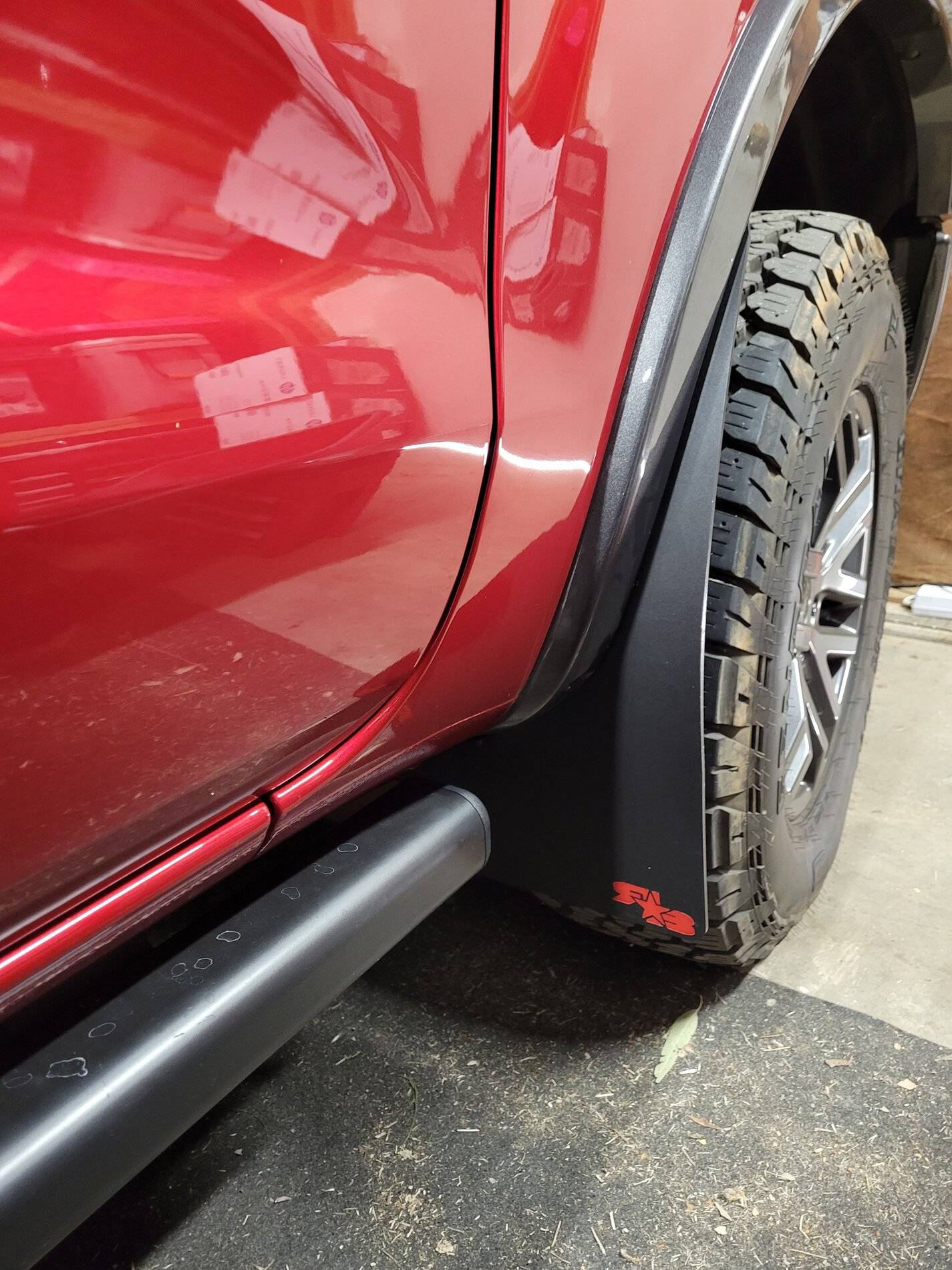

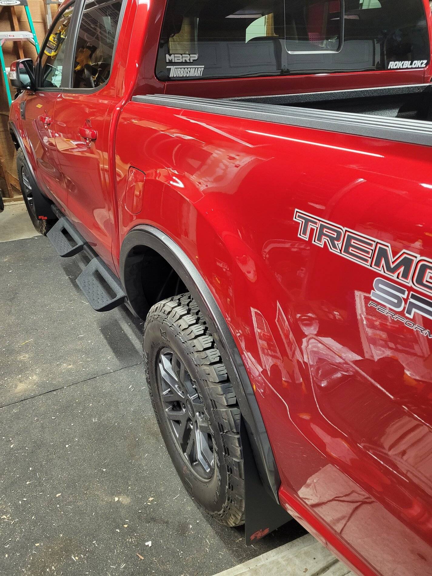

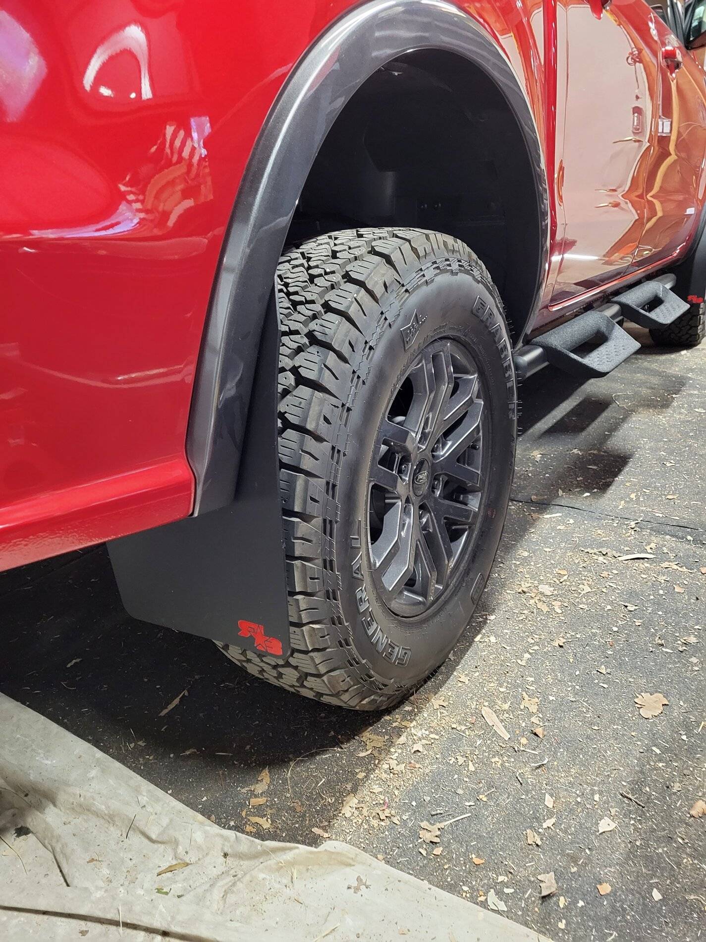

I installed a set of RokBlokz today. I agree there are no modifications needed, but I will say that the spacer used for the bottom screw in the fronts needs to be about twice as thick for the deeper flares. Fortunately I had a pair of spacers that worked perfectly.
Ultimately though, I don't think I like them. I think everything about them is poor quality. I'll keep them unless something better comes along. I figure something is better than nothing.
I would not buy them again though or recommend them to anybody.
Just installed mine and they are a good fit and will do the job. You are correct about the spacer in the front needing to be 10-12mm. I had some longer plastic ones that I cut down to roughly 12mm and they were perfect. If you don't use the longer shim it is harder to get the flaps level as it tends to draw the bottom in.
