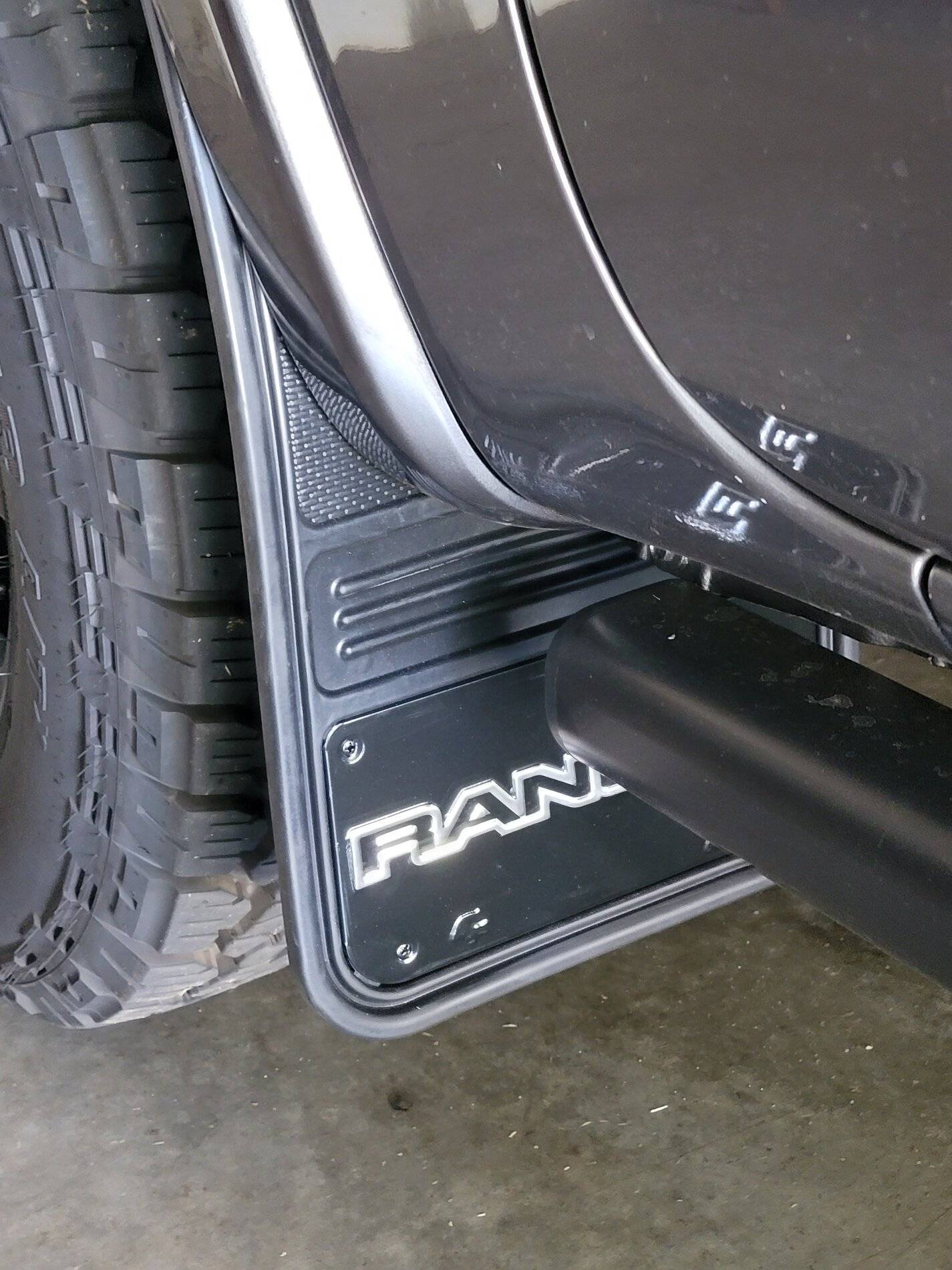

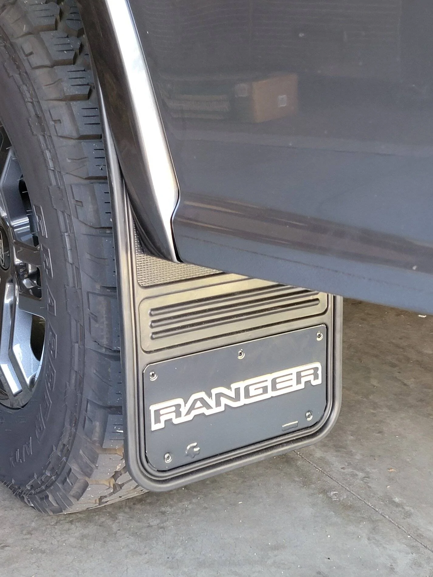

Gatorbacks installed and went on easily and they fit fine in spite of the flare difference on a Tremor. Very heavy duty rubber and metal mudflaps with a significant metal framework that comes with it for them to bolt into. Made to last and hold up and very well thought out. They make the rokblokz that I had purchased before look like flimsy throw aways. Glad I switched. Very expensive, but worth the $ to me.
Ranger looks white in pics, but it is chrome on a black metal background.

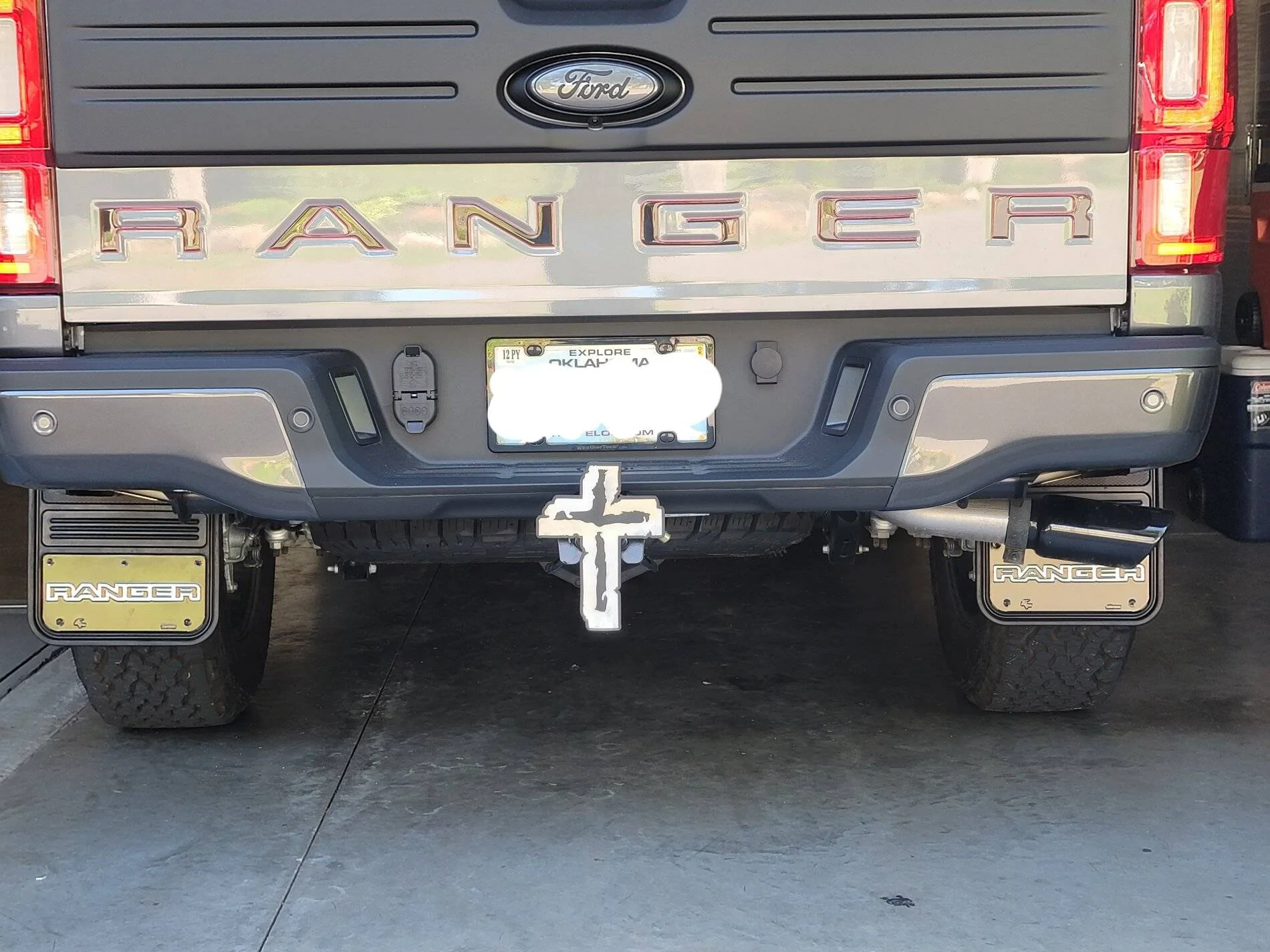

Actually just like yours though without the name plate. Same color truck too!

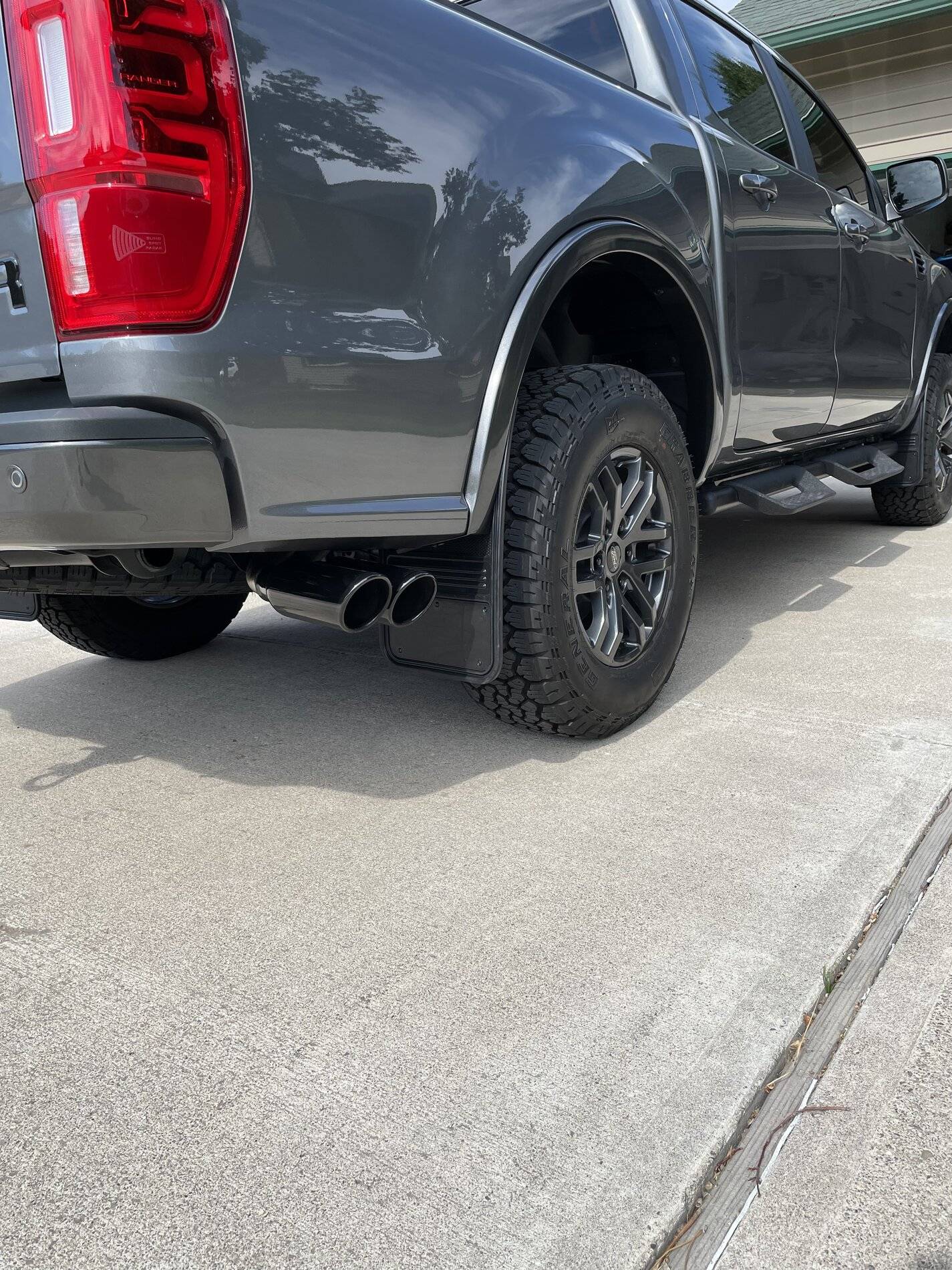

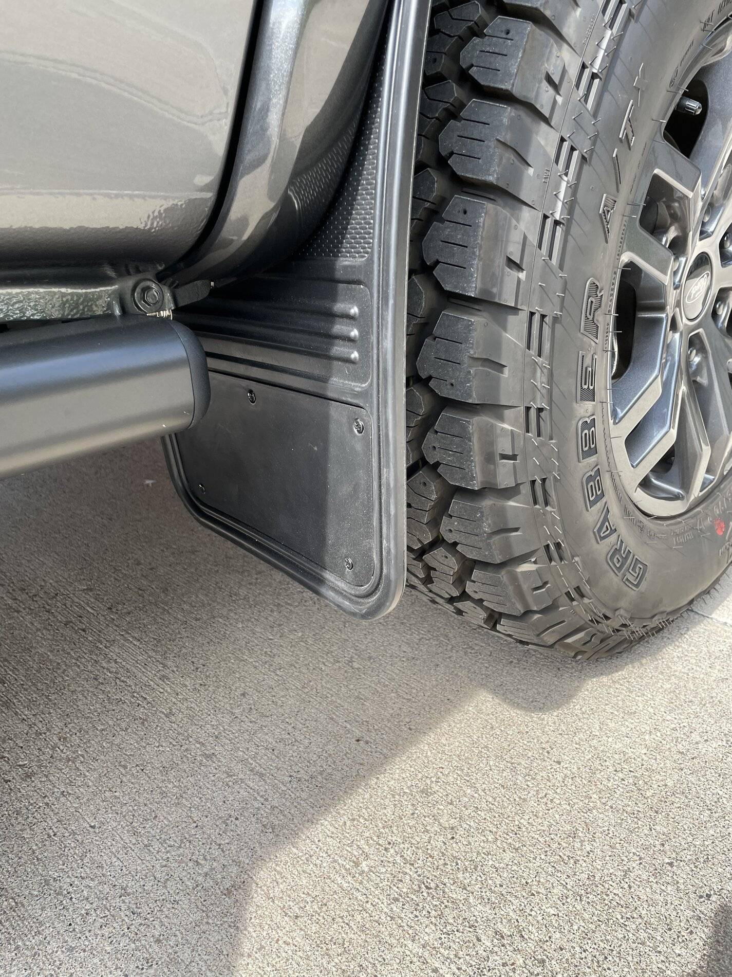

Finally got a chance to take a couple photos. I hate seeing crooked mud flaps so I’m a little anal about my own.

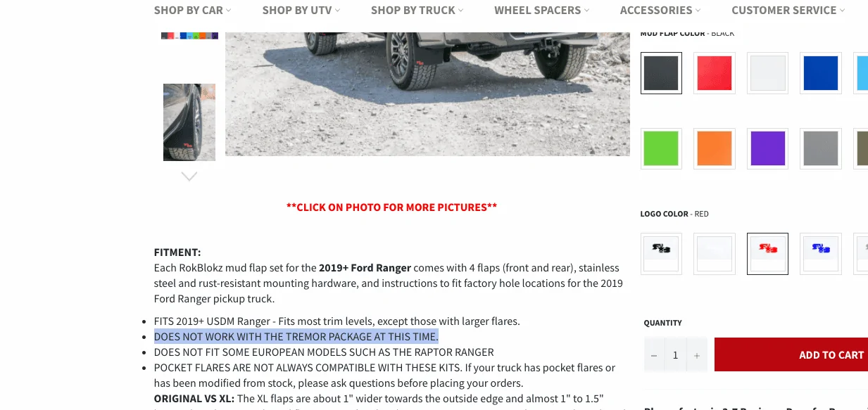

Didn't like seeing this on the site when i went to buy the rokblokz but I'll give em go based on your guys word and experience.

Just be prepared that you'll need 10mm nylon shims vs. the 5mm ones they provide for the bolts that go in the bottom side of the front fender flare. If you use the 5mm ones, you'll have a hard time getting the fronts leveled properly as it tends to draw in that bottom tab. I am very satisfied with mine. The XL width is perfect for the Tremor.

Mine rub the front tires in hard turns. I am taking my Tremor to Rokblokz HQ in a couple weeks to have them design a set that does work.

I had the same issue and sent them back. I hope it works out for you!

No rubbing at all even in the hardest turns and articulating suspension. I did bend mine back a bit so they don't curve with the radius of the wheel.

hmm ok maybe i'll wait, don't have any chips that i can see now... but a good wash may reveal otherwise.

Thanks maybe i'll wait for the Tremor specific design... we'll see.
