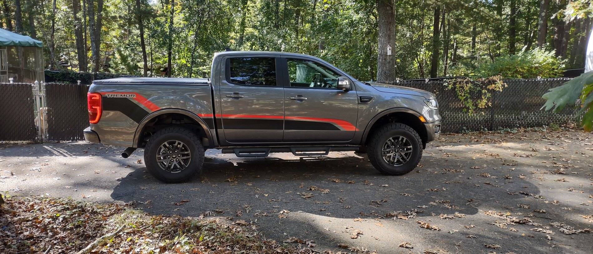

here is my Tremor with the 2'' lift kit.
Sweet truck! I just got my Carbonized Tremor and ordered the 2" kit.

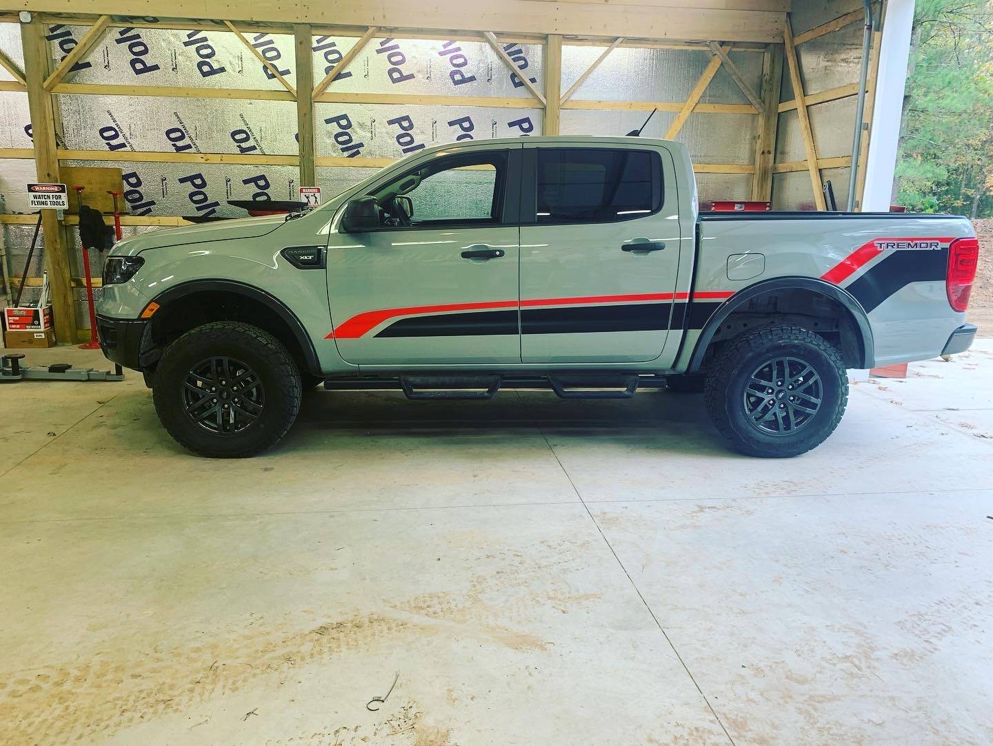

Got my 2” installed this weekend, along with 1” Eibach blocks for the rear. What a difference in front clearance. It’s subtle until you get right next to it and realize how much bigger it is.
