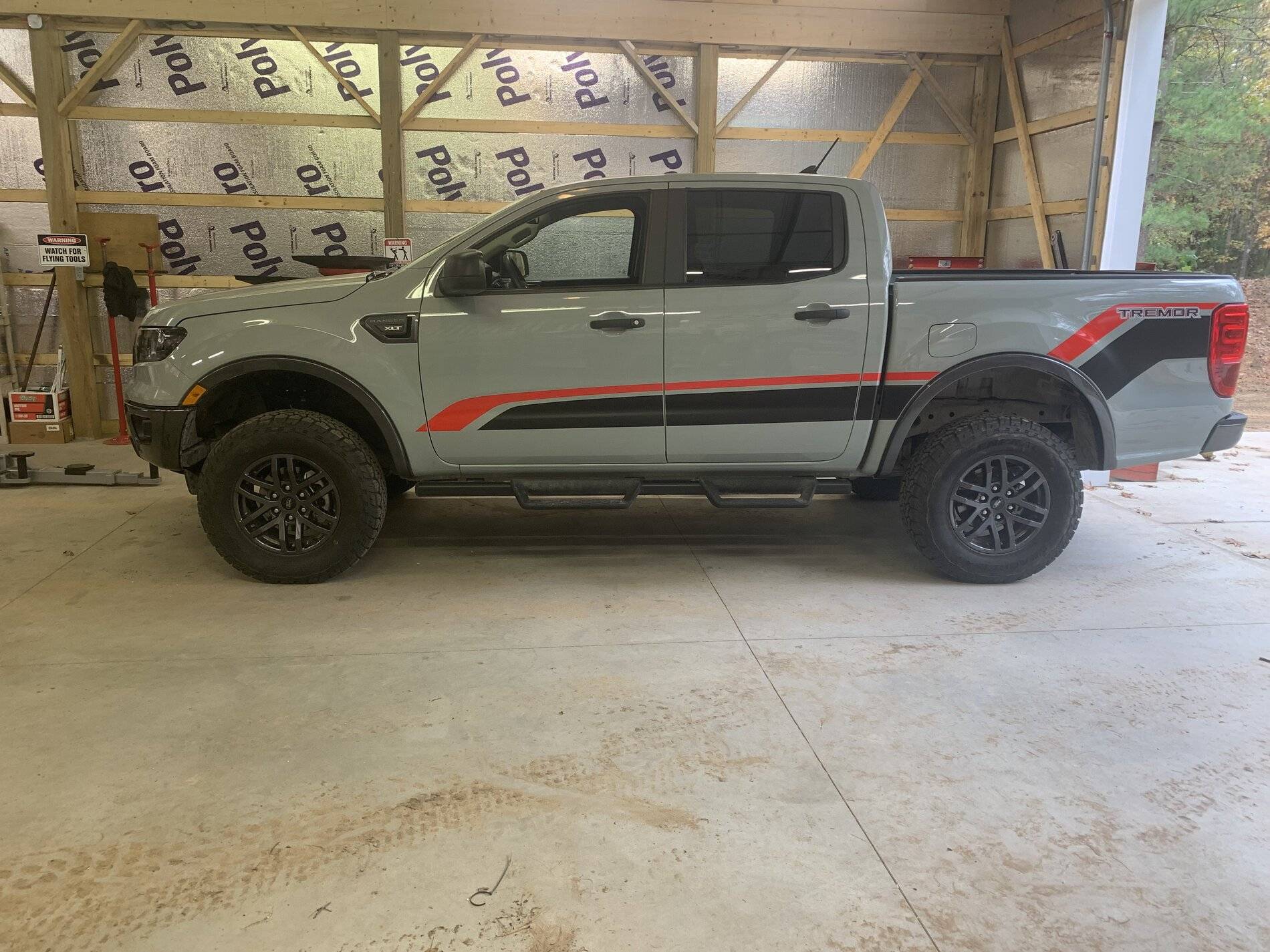

Ok, so first off, no. The tremor rides .8” higher in the front than a standard Ranger, to allow the 265s to properly clear, 2nd, you can go up to 3” higher on a standard ranger & 2” on a tremor before you start to compromise cv joint angles. All you’ve accomplished is trying to state why OME is better, and it isn’t working.
The rake is easily corrected with a 1” block in the rear.
In response to the original question asked, follow the steps EXACTLY as FRL gives and you won’t have issues. We tried to shortcut the drivers side and it took 2 1/2 hours vs 30-45 minutes on passenger side following directions to a T.
Below is 2” FRL with a 1” Eibach rear block.

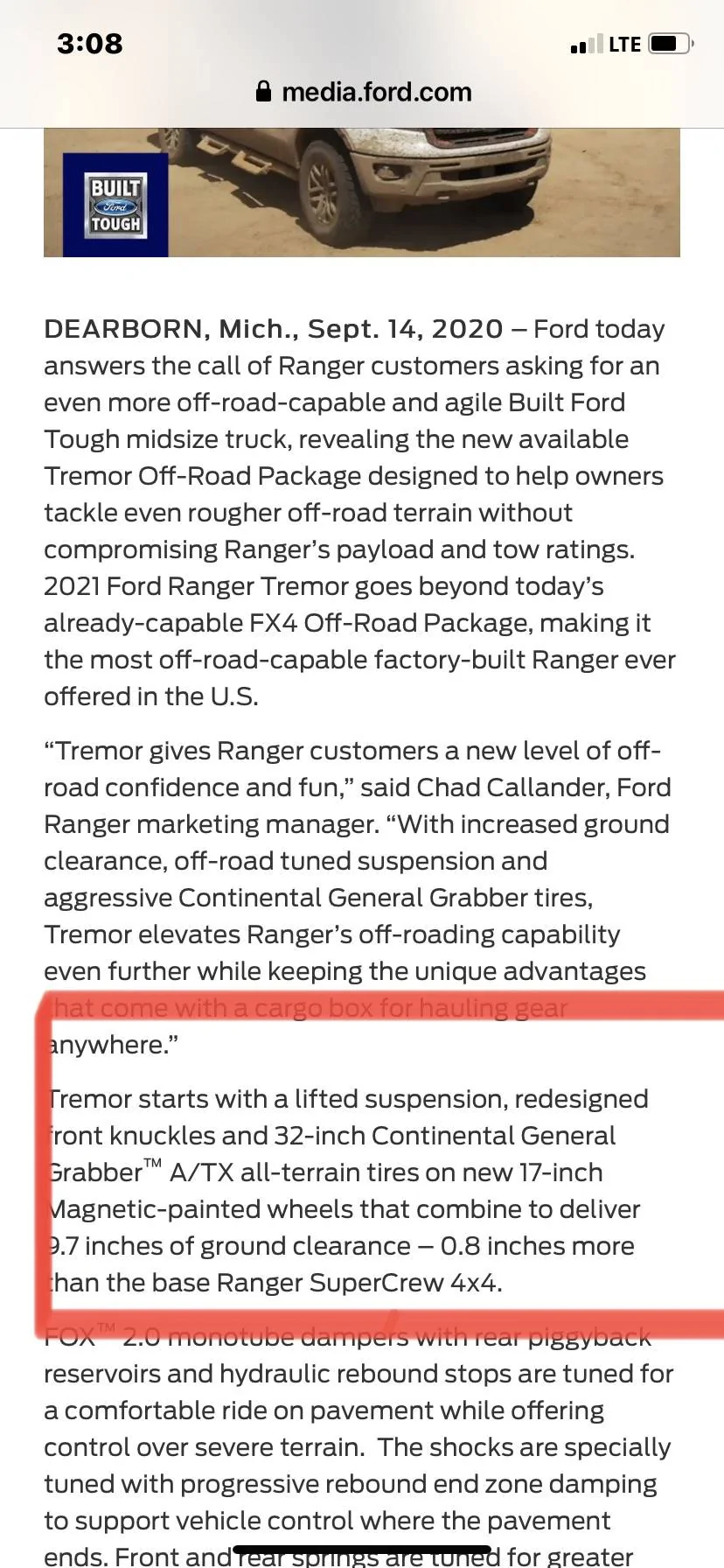

I'm not stating why telling me is considered better. Also the Tremor has all the same mechanical components with the exception of front and rear shocks along with front and rear springs of a non trim Ranger. Yes the rear is lifted by a very little bit and you're not wrong about that. The front is also raised by 2 in compared to a factory Ranger. But I'm simply stating which is true is that if you add an extra 2 in upfront on a Tremor package Ranger you have a total of 4 in of lift up front from the factory compared to a non Tremor Ranger and because of that you will actually cause CV angle finding problem. You may not want to believe it but it is the truth. That is why I came onto this thread to begin with. Why did I bring in the old man emu? Simply as example of how it's still Within a manageable amount for a CV angles aren't compromised. Yes there are other kits that still allow the CV axles to be within okay ranges but adding a 2in spacer kit to the front of a trimmer without a diff drop is asking for big problems.

Where do you get the additional 2”?
This is directly from Ford. Exactly the reason FRL only offers a 2” for the tremor and it’s specifically stated on RC that the 2.5-3” will not work on a tremor. What’s your source on the height difference?
You are incorrect about the differences in a Tremor and a Standard Ranger......
"The Ranger Tremor's suspension features stronger upper and lower front control arms separated by a revised knuckle plus 2.0-inch Fox dampers at all four corners." Ground clearance amounts to a decent 9.7 inches, which is 0.8-inch more than the standard truck's. Front and rear suspension travel—6.5 and 8.1 inches, respectively—are up slightly over regular four-wheel-drive Rangers
Thats from Ford itself.

Alright so after taking some time I do stand corrected but I could sworn that when the Tremor was being released the front was being raise by 2 inches with the Fox shocks. If anything its by a smaller amount(more like .9 at best). Obviously the bigger tires make a difference as well. Now if improvement for offroad was the goal then go a different route with the suspension but clearly not what the OP wants and let's face it, if you bought a Tremor you are not looking to modify it that much anyways.

The funny thing is the ground clearance is ony at the rear diff. As for travel they dont state what the non tremor ranger is so that part does have me a little curious but also looking at the specifications on the Ford website recently the overall height is roughly 1.7 inches higher(combination of tires and suspension of course).
