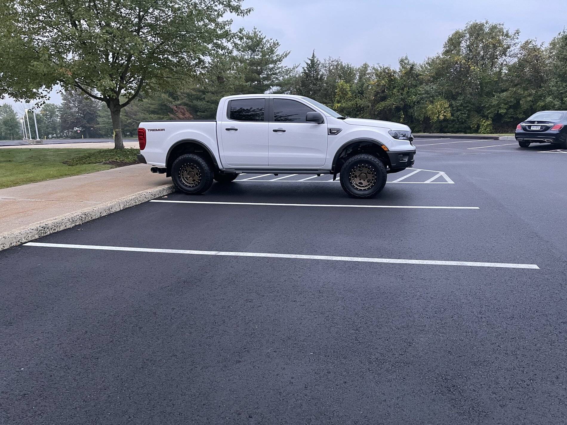

Your tremor looks great with the 2" level, & yes Robby has been awesome everytime I spoke with him. . . Did you remove the axle nut for install ?
Did not remove the axle nut... I did this same thing on my XLT sport but was not worried since it was the 4x2 version... on this one I was concern, but now I am confident that the little vibration is a tire balancing issue, which I will get them balanced this Sunday and hopefully that quiets down a bit... I know the factory tires are not a quiet type... I really like this truck, much better than the XLT Sport I had for 2 yrs.
