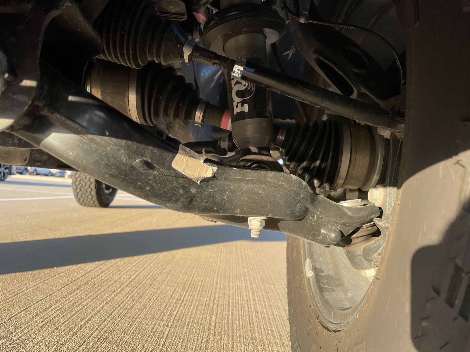

took this after work front front.
The cv angles are not bad at all. I see lifted f150s come in all the time with cv angles way worse than this.
not seeing any front end issues from it and no 4x4 issues either. Functions good and looks good.

I am surprised that a 2" lift on the front of a Tremor doesn't make the truck look nose high.
The other day I dragged my jack out to the truck in the driveway. I first measured the height of the top of the front wheel well to the ground then jacked the front up until the truck looked level using the rocker as a reference then measured the new height to the top of the wheel well. It was exactly 1" more.

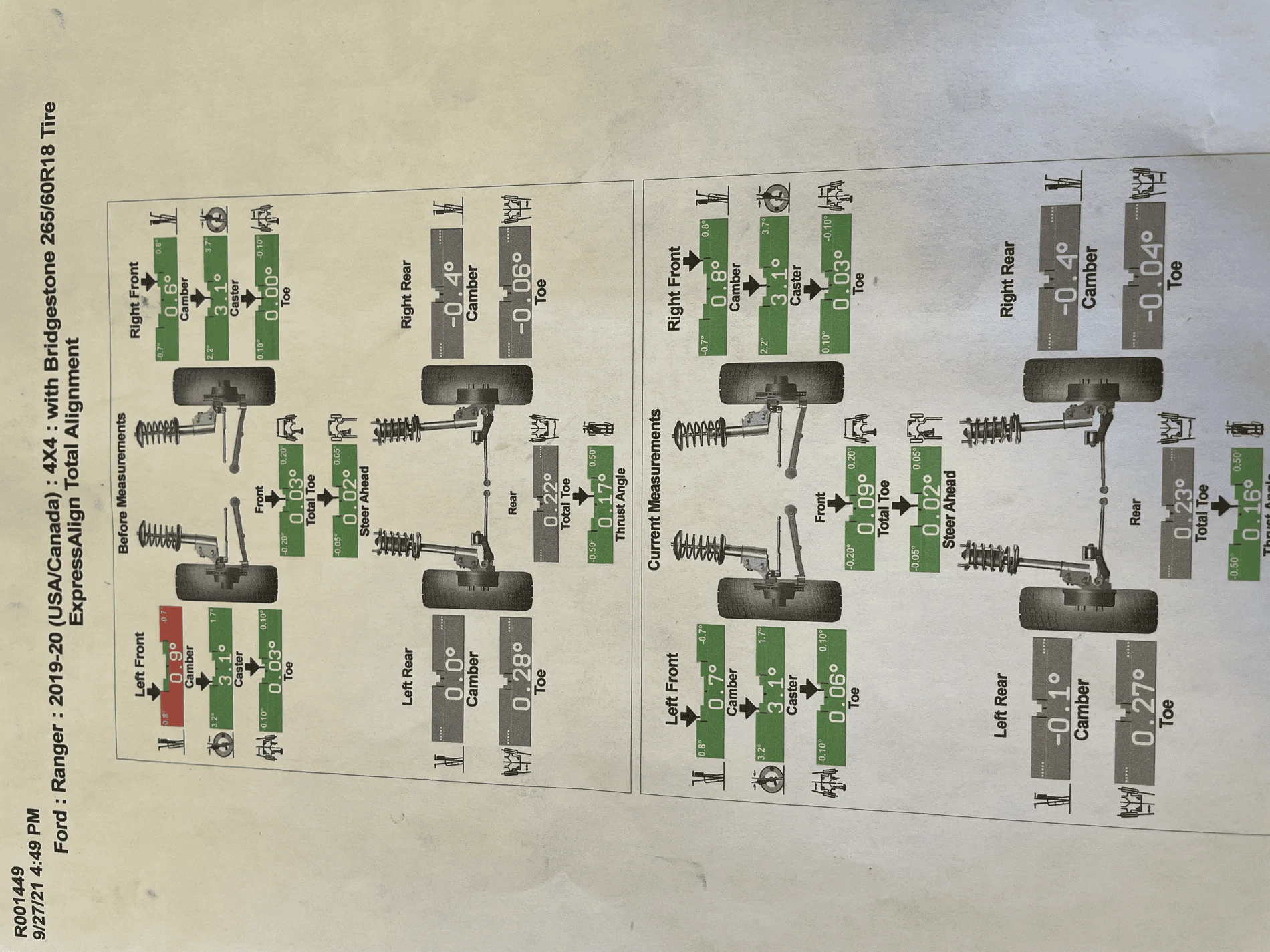

I just lifted mine with the 2" kit from Ranger Lifts... Tiresplus here told me that they could not adjust anymore and that the adjustments were centric.. not sure what that means. Here is the print out, I still feel some vibration at 60-75mph... I made an appt to take it to Ford for alignment , 2nd opinion and to perhaps re-balance the tires too and see if that alleviates it.
The vibration is not bad, is subtle and quite fast, maybe comes from the aggressive tires and I am being too anal about it. thoughts?

If your feeling a vibration at various speeds I would think it's a tire balancing issue. Plus if I'm reading it correctly your alignment specs seem very close to being within parameters.

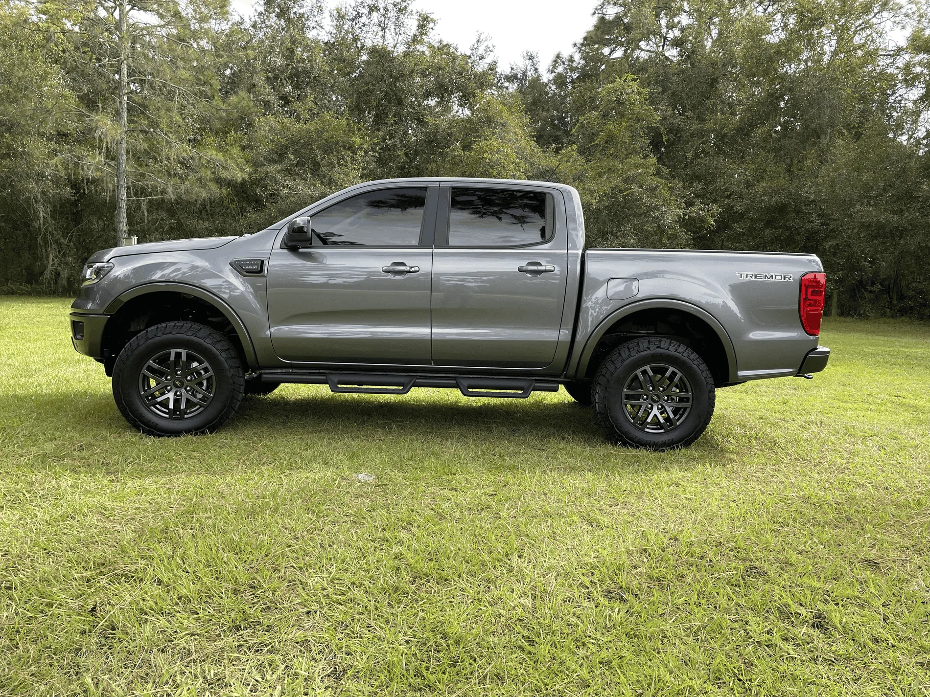

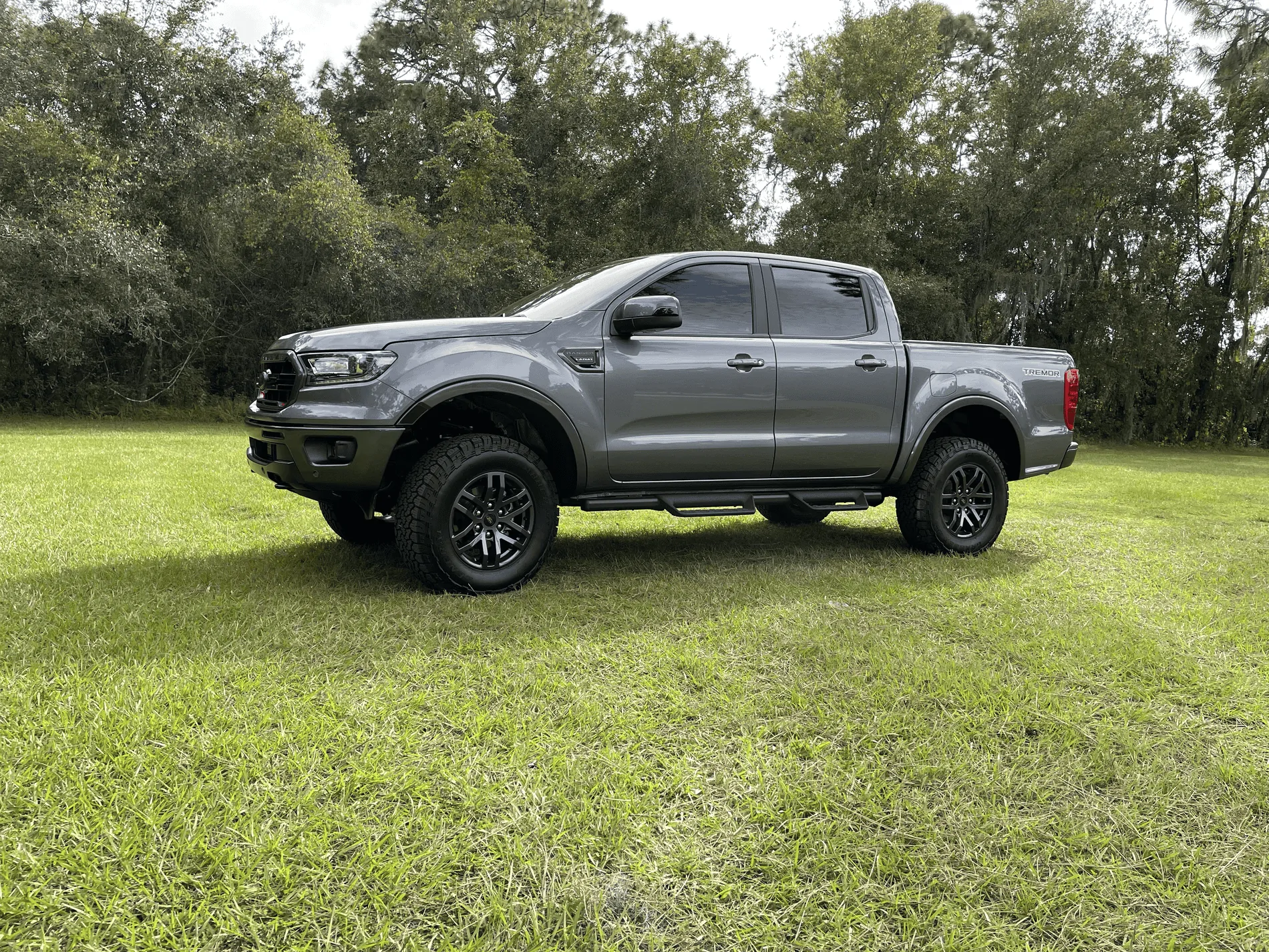

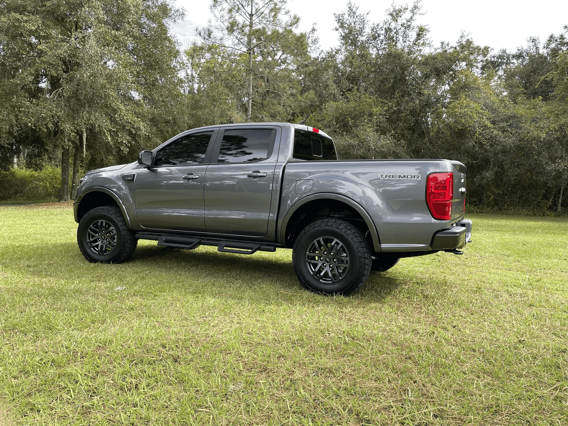

here is my Tremor with the 2'' lift kit.

wow ok.. never got to watch this video, if his pushing down on the arm to pull and place the strut back on, I am not going to worry on the off road use then.... that pulling and pushing was more than I felt comfortable to push down on the arm to remove that strut.... cool video. He is a cool guy, talked to him on the phone prior to ordering.
Your tremor looks great with the 2" level, & yes Robby has been awesome everytime I spoke with him. . . Did you remove the axle nut for install ?
