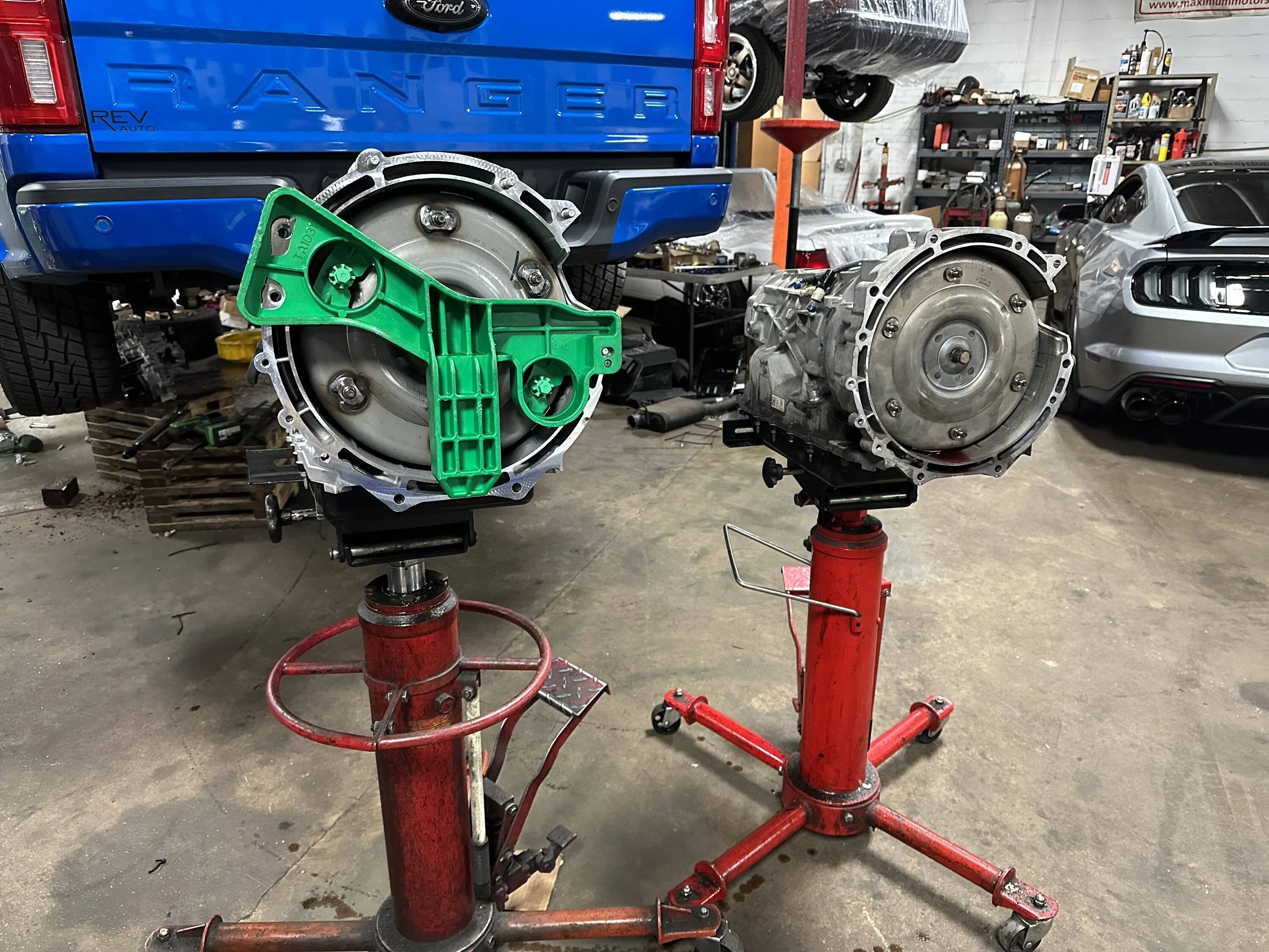

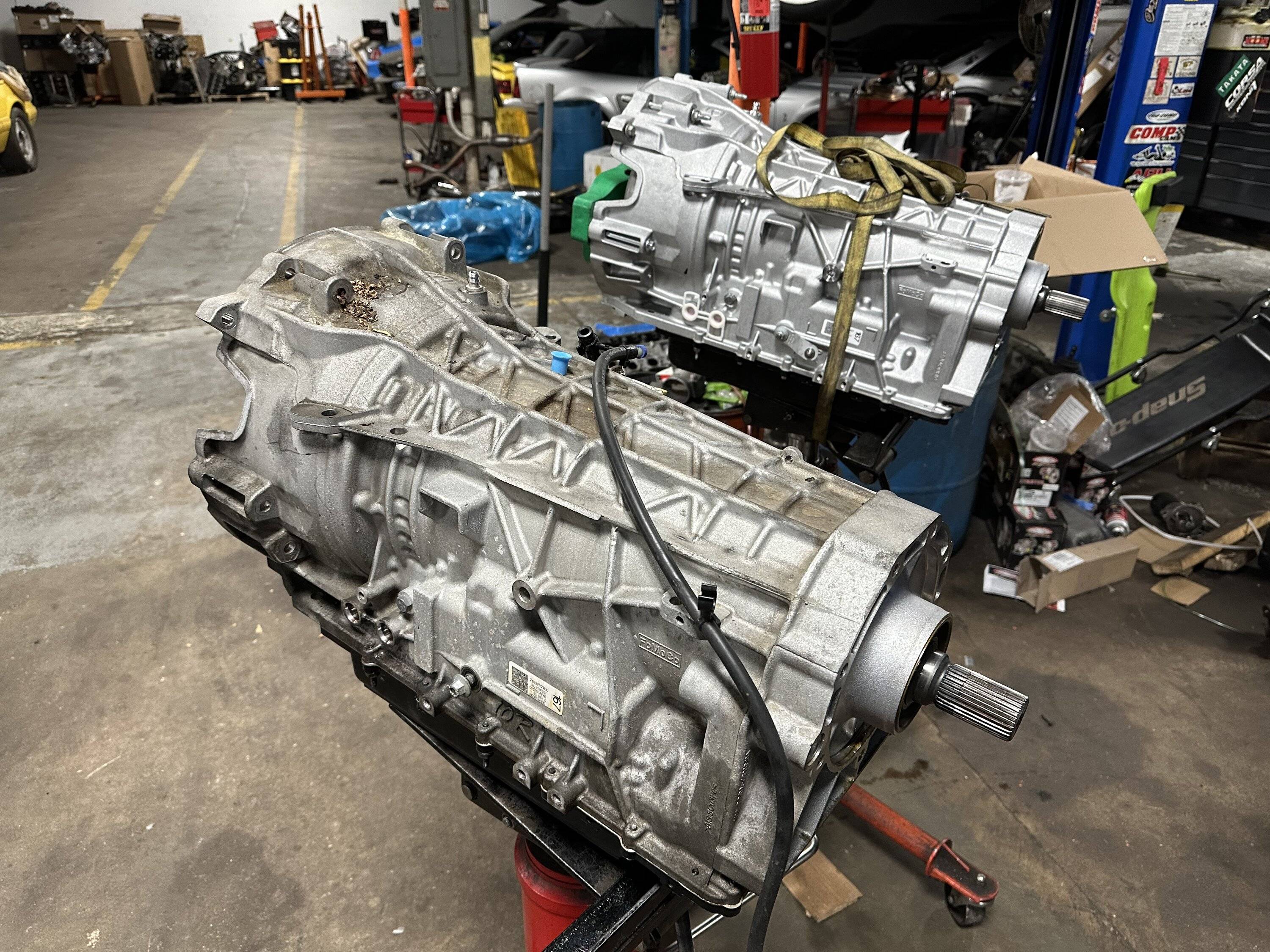

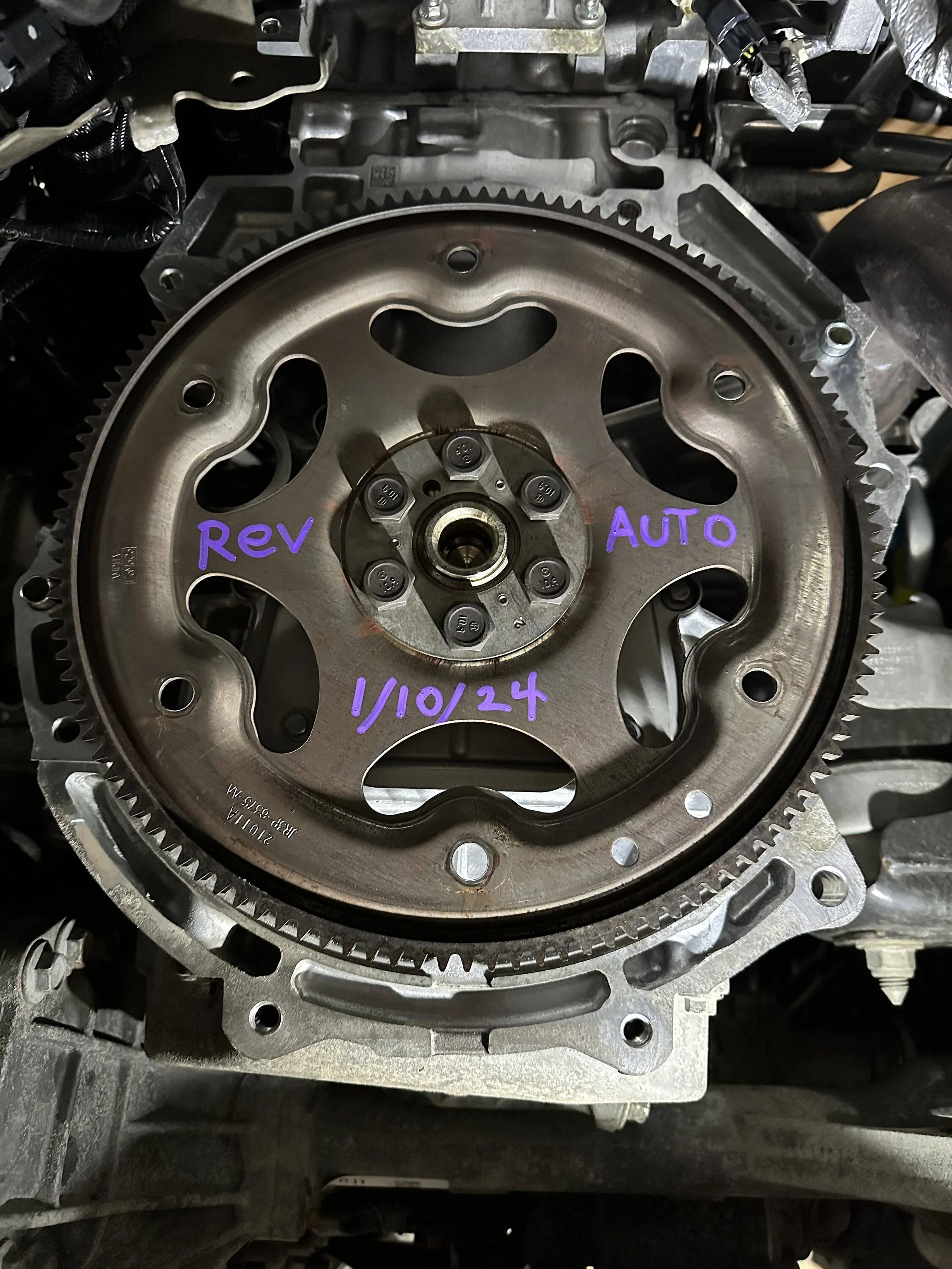

I replaced mine Wednesday night with a new unit from Ford. It was really weird at first but after a second reset and some miles it’s so nice! Every gear shift is nice and clean, so far so good. All of the issues I had with the old transmission are gone and I’m back to having a nice driving truck again.

man you got some nice toys and shop !
