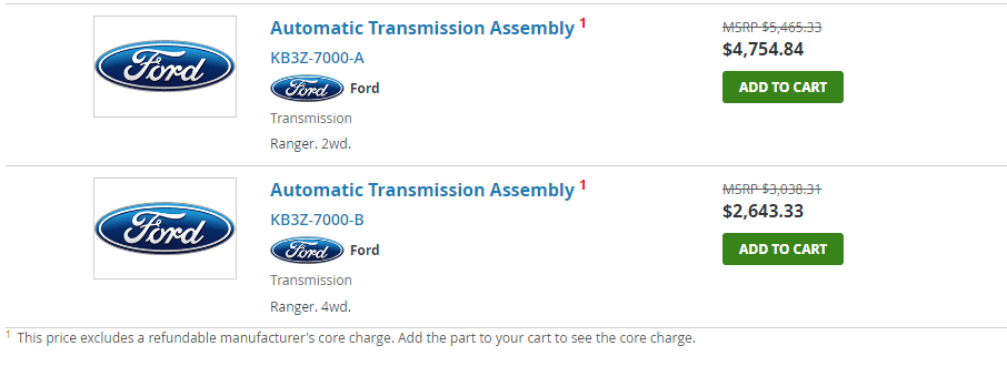

That is an insane price. Granted, I know there is labor involved in replacing it (And some supplies for flushing the coolers out, and possibly some time for programming), but the transmissions are not anywhere near that expensive:
Of course, they are out of stock, but still.
