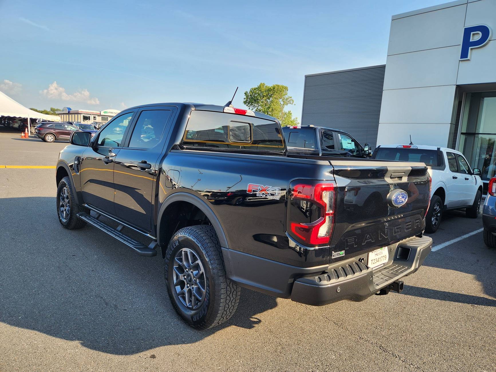

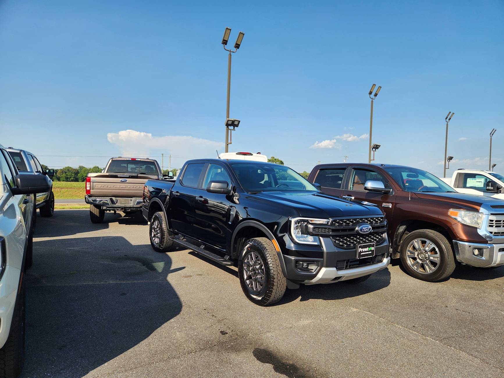

Been there done that on the rebuild. Mine needed replacement 25k miles later.
Doesn't matter as much now....traded in my 22 for a 25!! XLT FX4 with tow package.
Night and day difference with the new truck....its sooooo much nicer imo. I hated spending more money but I got a new truck (versus my 67k) with a long ass warranty and free oil/rotations for life for about $19.5k out the door. Bye bye 10r80. Fingers crossed the r60 holds up!
But for everyone else's benefit, keep this thread going for replacement feedback!
