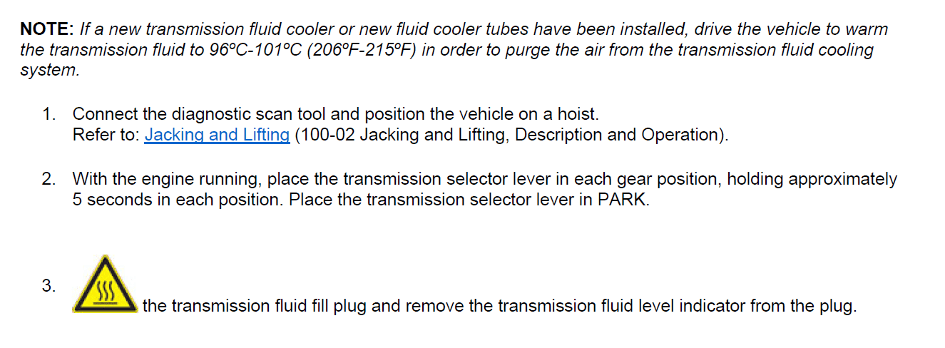

From the service manual:
Using the scan tool verify the transmission fluid temperature is between 96ºC - 101ºC (206ºF - 215ºF). The transmission fluid level must be between 4 and 5 on the transmission fluid level indicator.
The issue is to get the trans up to that temp, you have to drive it hard or tow.
The trans oil cooler, cools the temp down to engine coolant temp (that's its job)
So, some owners strive to get to that temp and then check the level.
As long as you have driven the truck and have it up to temp, the expansion level of the fluid is not going to GREATLY differ from 195 / 200 degrees (ECT) approx to the minimum 206 degrees it calls out for.
Mine from factory and checked for verification (including) the added Fitzstick is dead on 4.5 on the dipstick. (In the middle of 4 & 5 marks.
