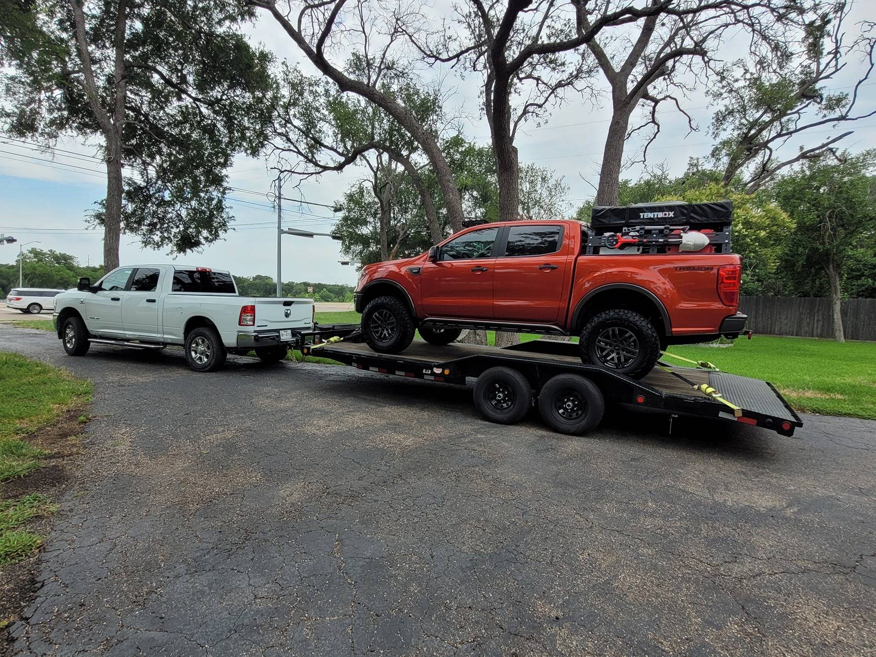

Boy, I hope they cover it. I'm having to rent a trailer and an F-250 to tow it to another dealer 30 miles from home. On my last visit, my local dealer told me they refuse to work on my trucks drivetrain due to the mods I've made (lift, 34" tires, etc...). We'll see what the dealer in Waco tells me.... fingers crossed.
