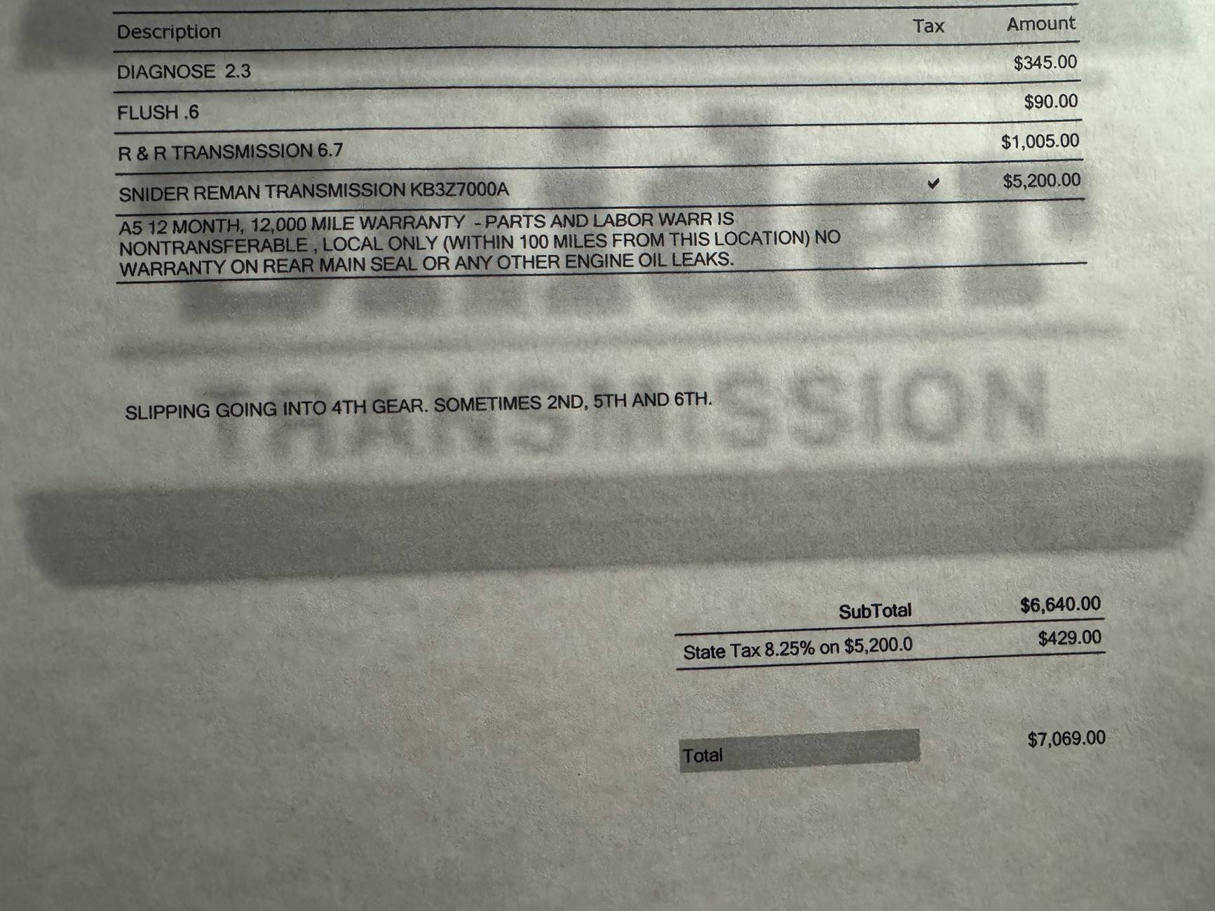

The same warranty price that they increased when they found out that ford was paying for part of the repair?
Yes which is very interesting the only reason I slightly believe them is that when I called another dealership as mentioned earlier in this thread and this time stating I have Ford assistance they also jacked up the original quote. It seems Ford charges more for the transmission if it is done under warranty.
Here is how much it should cost this is the official ford parts online store for a brand new transmission. ($5.9k)
https://parts.ford.com/shop/en/us/t...automatic-transmission-(at)-p-kb3z7000b?pdp=y
Dealership told me Ford’s warranty price is $8.9k which is an insane markup that negates the 40% help from Ford assistance.

I’m confused. You said you paid $4200 out of pocket. Was that just the transmission or the entire job?
Yeah seriously. I would actually consider reporting it to Ford. I have never seen it the case where a warranty job pays more than CP work.

I did have Ford customer service/warranty make note of the price charge from dealership and price online. I was going to report, but to be honest I'm just glad to have it over with and got it at the price range I expected.
BTW for anyone needing a new transmission for some reason the new one is being listed for $2.9K right now seems to be a pricing error as remanufactured is still at $5.3k.

Ford paid 4500 of mine and I covered the remaining $2200 last year. That was 16k miles ago. Shifts amazing and like butter now. But its still new. Doing fluid changes every 30k now.
Wow I thought I had a good deal. From your post history it seems yours was at 75k. Did you have any extra warranties?
Was it rebuilt or replaced with a remanufactured or new transmission?
Nope warranty was gone. I take all my trucks to 200k and do my own maintenance, no extended warranty I said…. Yeh.
New replacement unit. Took a few weeks, but based on the quality of shifts I trusted it again. It is pretty seamless now. Mild confusion at times like most 10 speeds. But smooth unless I floor it then its firm.
