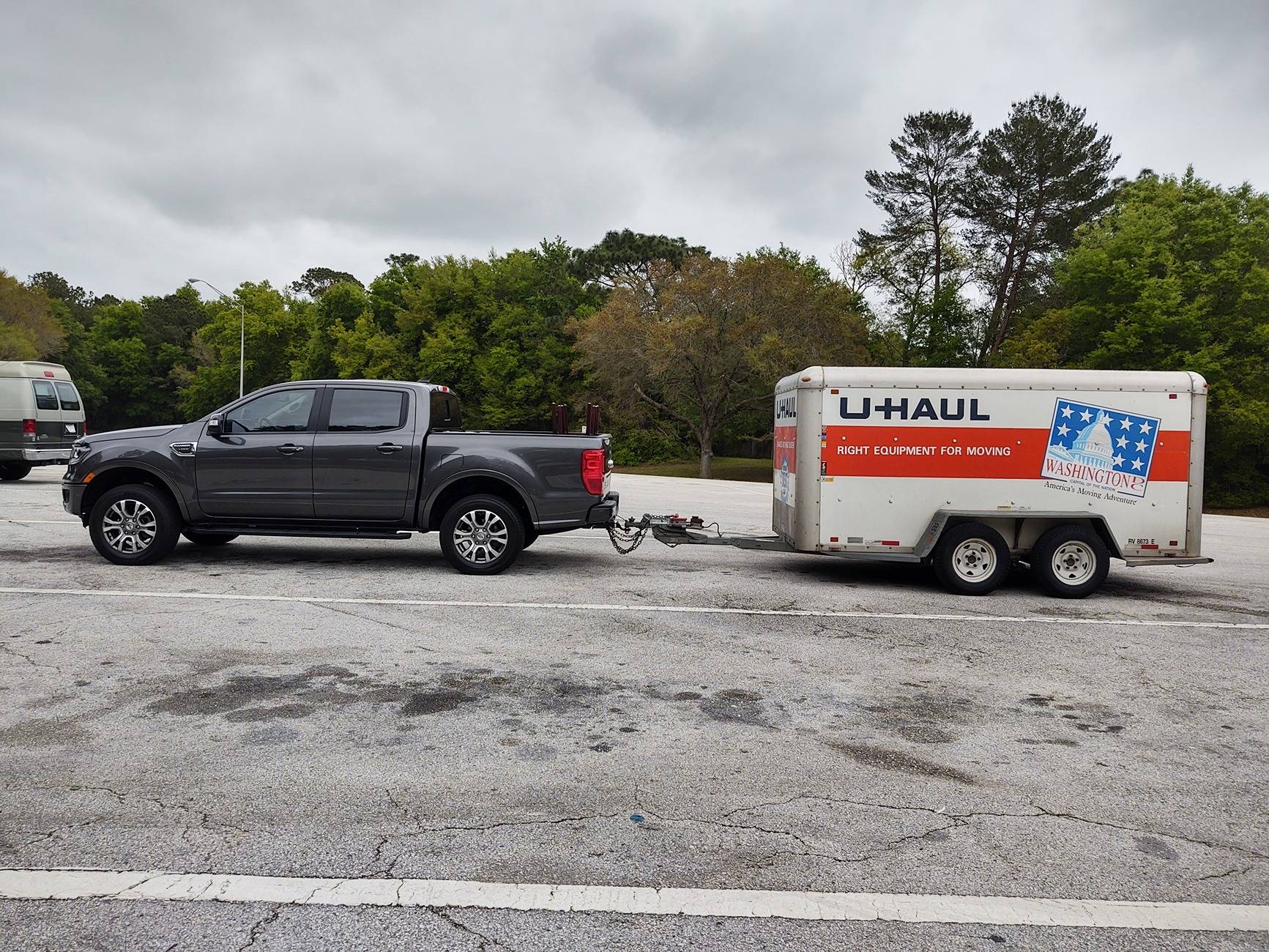

Transient
Truck barely noticed trailer was back there for a 650 mile trip.
Didn't climb any mountains though.
