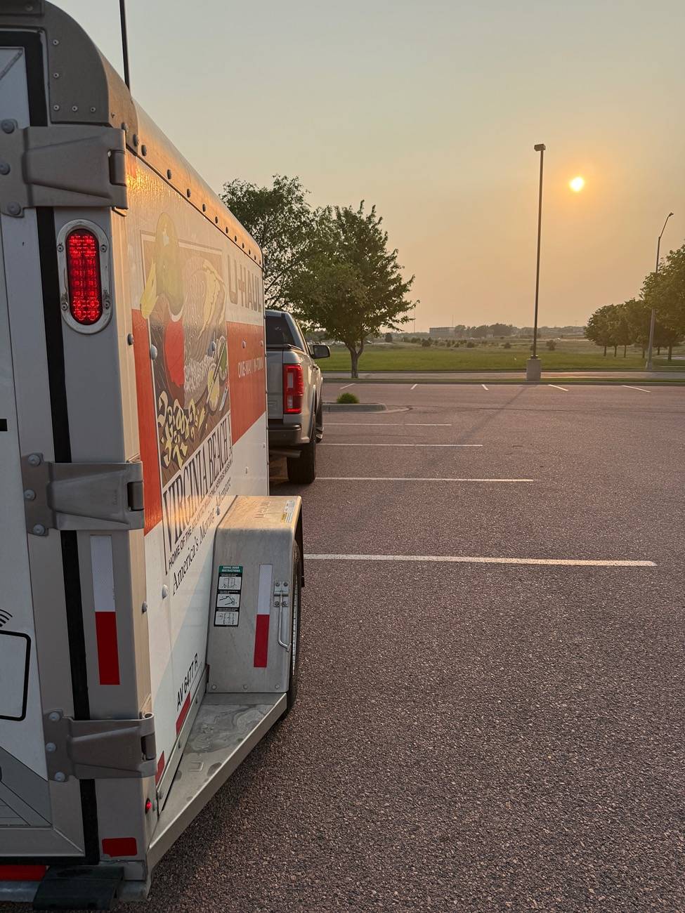

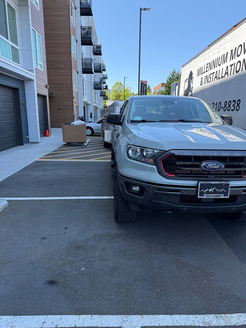

Hey guys! Sorry for the late reply, been busy but wanted to let y’all know I made it to Washington! 5.5 days, 3,000 miles, the truck was an absolute beast and everything with the trailer was solid, nothing happened and nothing moved. Nailed it!
THANK YOU EVERYONE!!

Well done, great you made it with zero incident..(boring is the goal… it mean everything went exactly right ?.)
