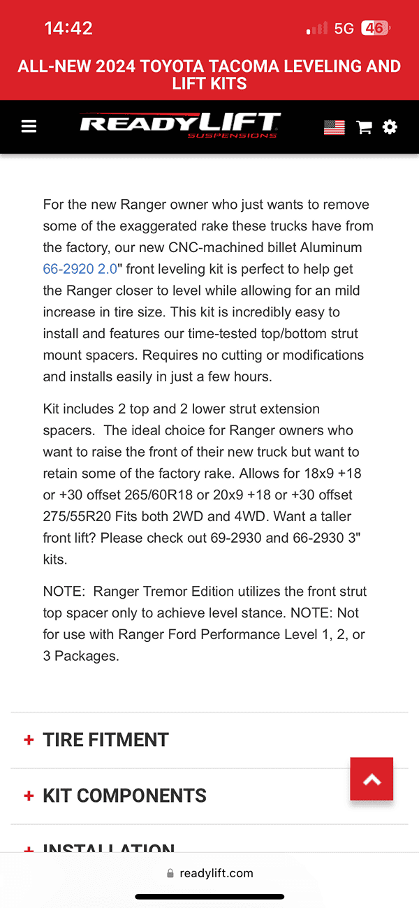

Do you know what part number ReadyLift kit y
Just posting about some updates on our 23 ranger xlt tremor. made some changes on tires from 31's to 32's 285 70 17 with 2" ready lift lift level kit.
Do you know what model ReadyLift kit you used? Did you use the top spacer plate only?
Could you please share a side view picture?
thanks!
thanks!
I used the kit with the top and bottom spacers and netted 1.5 inches.Did some research and found that was what everyone was getting.That is all the lift I wanted so I installed that kit and was easy for me to do.

So the bottom spacers fit around the fox shocks?
ResdyLift says not to use bottom spacers on Tremors.
can you please share pictures of the side view of truck and a picture of the bottom of shocks with spacer installed? I would love for another 1/2 inch or so lift in the front.

One spacer goes on top.The other spacer goes on the bottom were the shock mounts to the lower A-arm.readylift.com/2-leveling-kit-ford-ranger-4wd-2019-2023.html?gclsrc=aw.ds&gad_source=1&gclid=*
Got it, same kit I purchased, but I followed this guidance pictured below in the “note” section. When I was done, the truck wasn’t level for sure. Hence the question about seeing a picture of your truck from the side.
I then wondered if the lower adapter didn’t fit around the aluminum bodied shock, which is why I asked for a picture of that before I tear mine apart again.
can you please share pictures?
